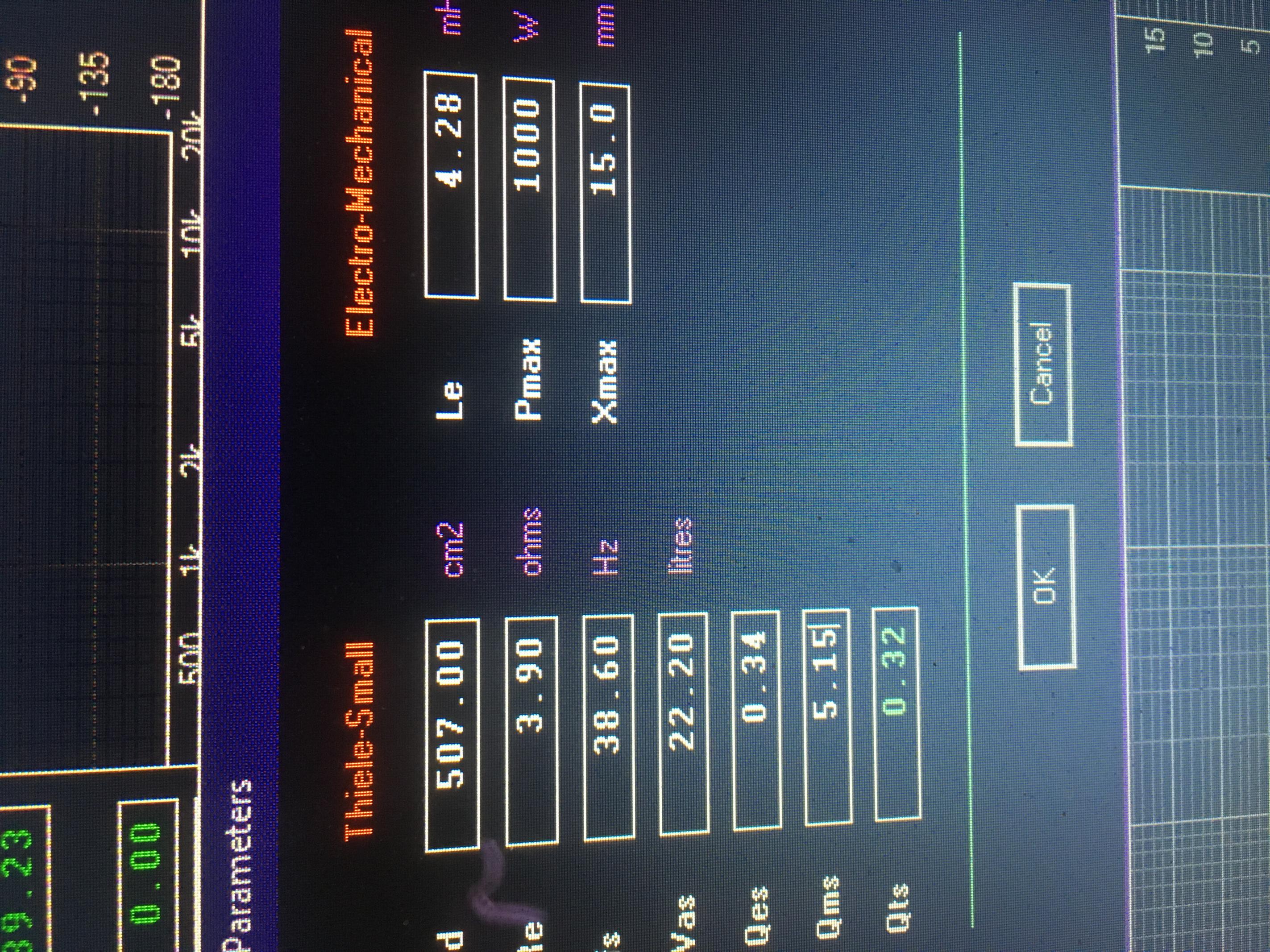

The dIY diydgroup 12 is intersting. I put it a cabinet I know and the sound I get out of it with a driver slightly different in two main TS parameters (pic) but things aren’t as far off as they might look if I enlarge the driver location to keep Vas happy and I engage a method to create the inductance issue with my Le. neither are particularly acurate, but I’m not arguing that. I’m Saying we might be similar, as this is in a very taped pipe sort of horn thing.. yet I’m spoiled by it and it’s hard to sometimes choose what to do in other areas ? but I have tried, and some with horn, pipe or TL I’m a lot of ideas, but non in particular, Or best. Just many ...
No, it’s the driver I have handy that’s similar in a few ways , but the larger Vas defines a need in sim that’s a large air mass into a smaller instead of of a long thin or consistent version of the same to get a similar result as response. Kind of. I have problem and it compounds an issue making my drivers Qes double nearly by horn response.... sim(inductance).
it’s hard to sim something because of the lossy inductance part of that sim. I m always looking for another 12 to replace this with, but only a handful have the motorforce, and not the inductance issues (B&C 12pg,tbx,nw100 and the Dayton rss315ho4) that I can find ..so far..

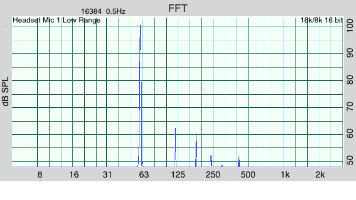

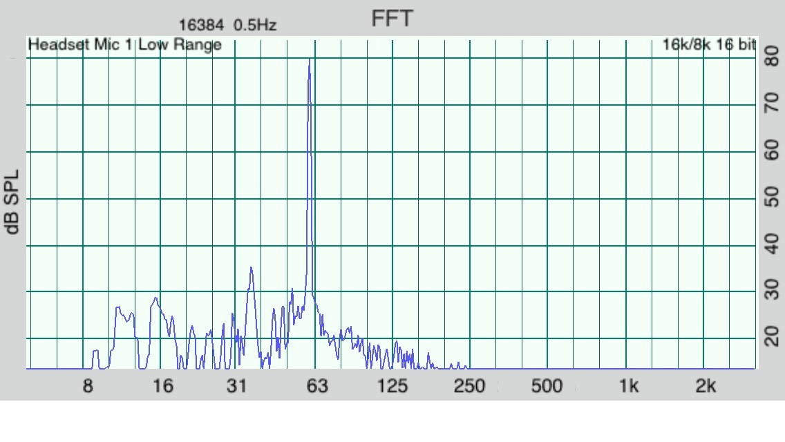

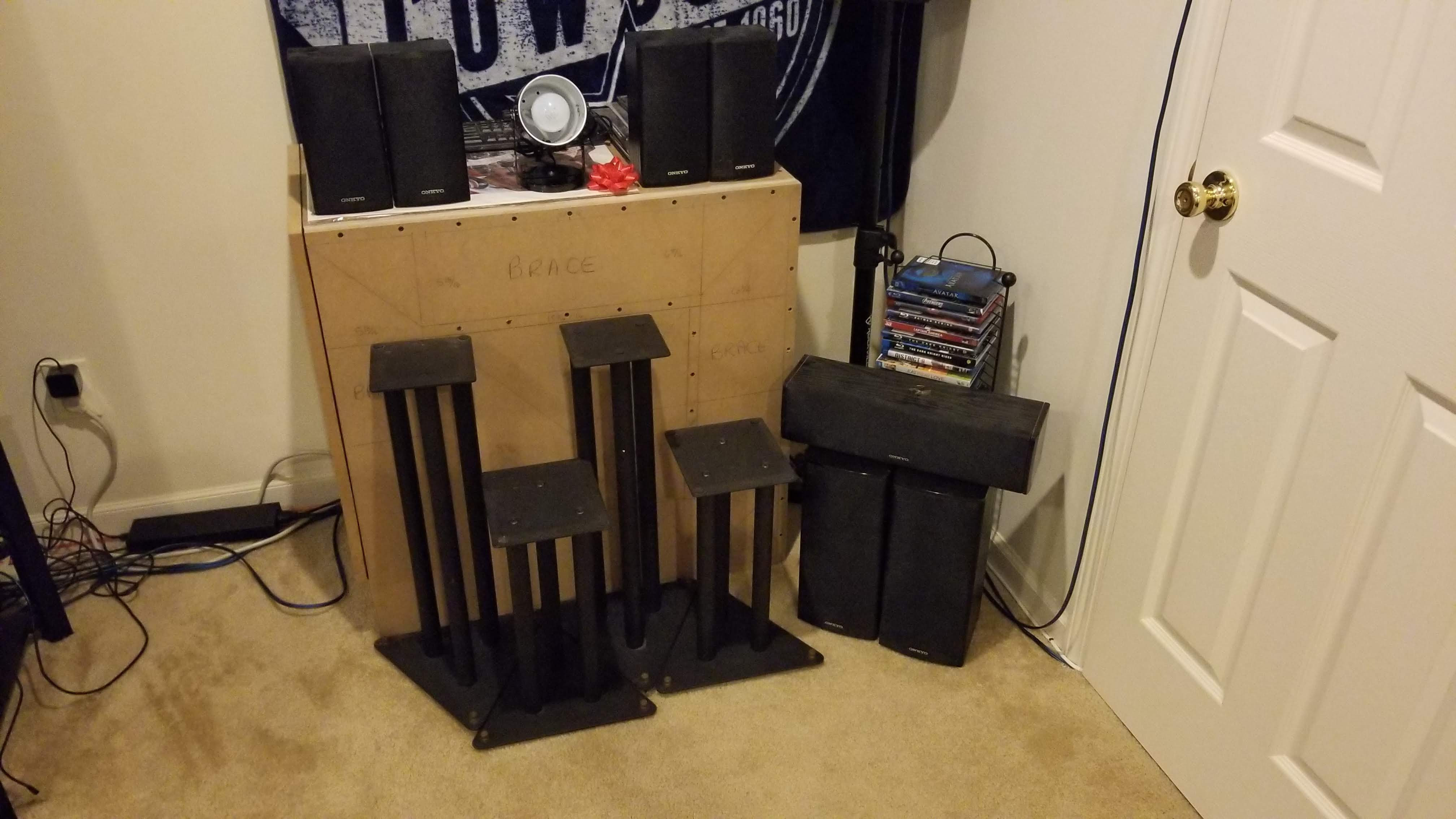

The next test is the diysg magnum 12 with 38hz port tuning. This required a little box surgery. The box originally had a 2.1 cu ft cavity and a .9 cu ft cavity for the plate amplifier.
I decided to cut two 7" holes in the board separating the two cavities. I now have a 3cu ft (85 liter) box. Reason for this is I had a an extra flared 4" pipe and the increased volume helped me a get tuning I was going for. My passive radiator has its weight glued in so I wasn't able to raise the tuning with that. I also plan to retest the radioshack 12" in the new larger volume.
Results for the diysg magnum in 85liters tuned to 38 hz were interesting. I thought I would enjoy the extra sensitivity in the 40hz-60hz range but instead my ear notices a timing issue. This could be because the group delay peak is pushed up to a more audible frequency (I'll post the hornresp group delay simulation later). Listening to Dancing in the Dark by Bruce Springsteen my feet where tapping along with the previous 60l passive setup but in this ported setup I found my self wondering why the kick drum sounded off.
Well enough blabber here is the max spl vs distortion test, lots of output near the tuning frequency as expected.
Frequency Spl of fundamental 2nd harmonic 3rd harmonic
16 60 -36 -20
20 68 -38 23
25 81 -30 -27
31.5 85 -21 -26
40 101 -25 -26
50 107 -27 -26
63 103 -24 -34
attached is 60hz @80db and 100db
