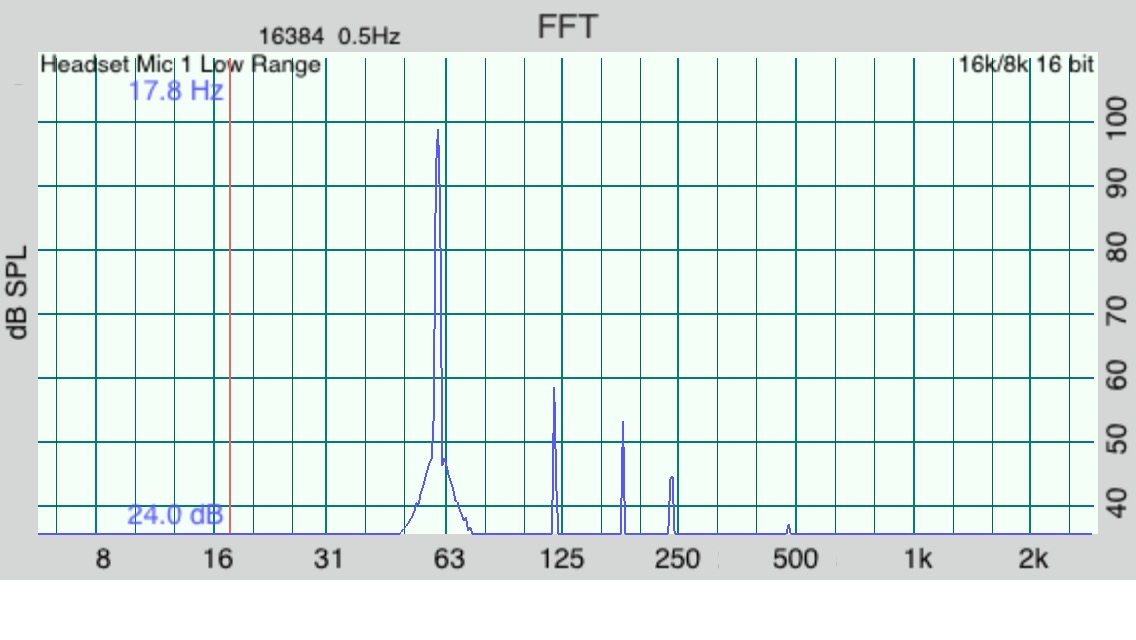

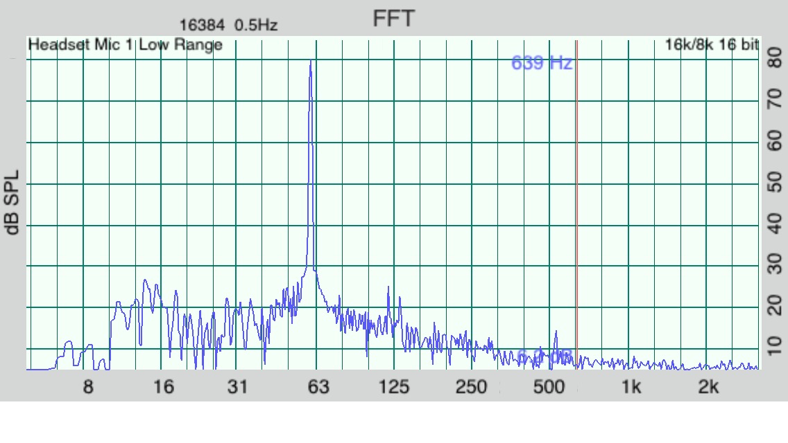

My next experiment was to run the ultimax 12 with only one of it's two coils.
As many know this will double the QES.
Here are my max spl before 5% distortion measurements.
Frequency Spl of fundamental 2nd harmonic 3rd harmonic
16 67 -41 -24
20 66 -29 -22
25 66 -23 -24
31.5 63 -23 -31
40 86 -23 -39
50 105 -29 -39
63 107 -37 -47
attached is 60hz@80db and 100db

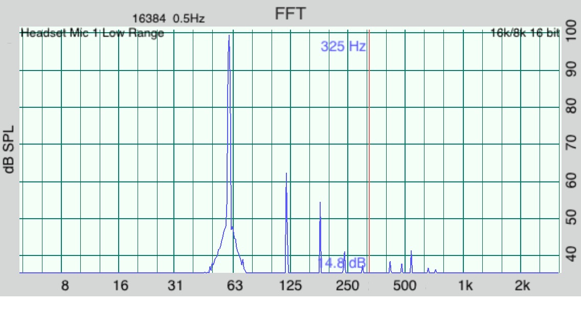

16 67 -41 -24
20 66 -29 -22
25 66 -23 -24
31.5 63 -23 -31
40 86 -23 -39
50 105 -29 -39
63 107 -37 -47

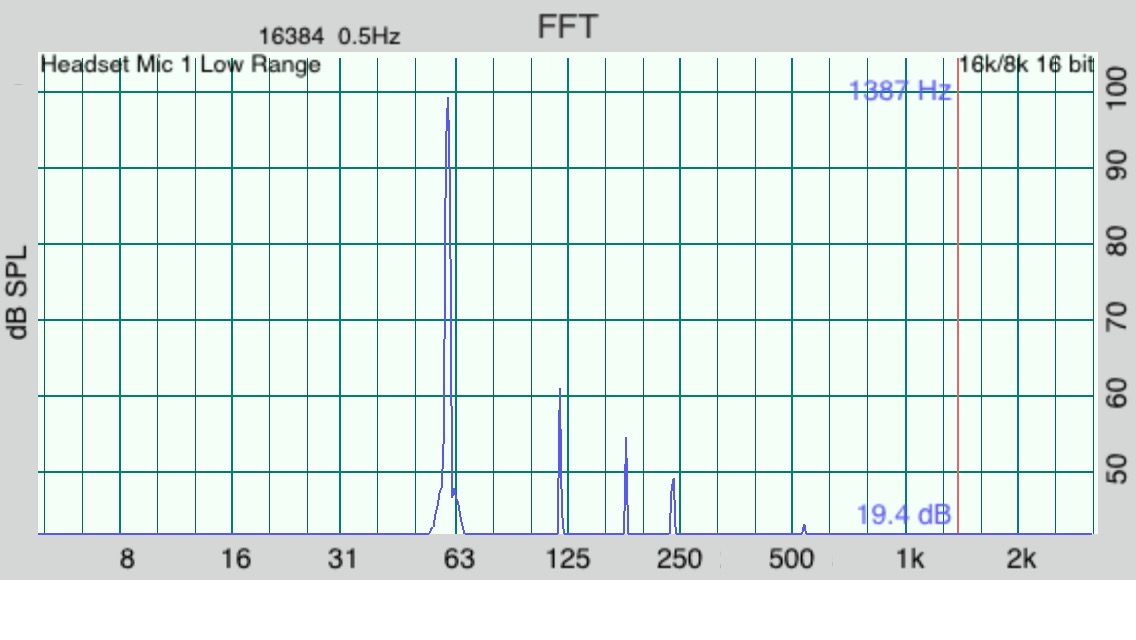

16 71 -40 -24
20 69 -34 -25
25 70 -30 -24
31.5 69 -24 -30
40 93 -27 -24
50 101 -35 -26
60 109 -30 -34
attached is 60hz @80db and 100db

my next test was to add a 300uF series capacitor to the magnum in the sealed box. Hornresp predicts this will bump up the output 6db at 41hz however the group delay peaks at 25ms at 38hz vs staying under 5ms from 20hz up for the standard sealed box.
I found this increase in group delay to be audible in the song "temple caves" by Mickey Hart. In this song there is a massive drum with a 35hz fundamental. In my horn loaded speakers I can hear the drum getting louder and then decaying with each hit. With the magnum and capacitor I getting an almost sustained tone.
Could also be the inertia and stored energy of a single 12 trying to do 35hz.

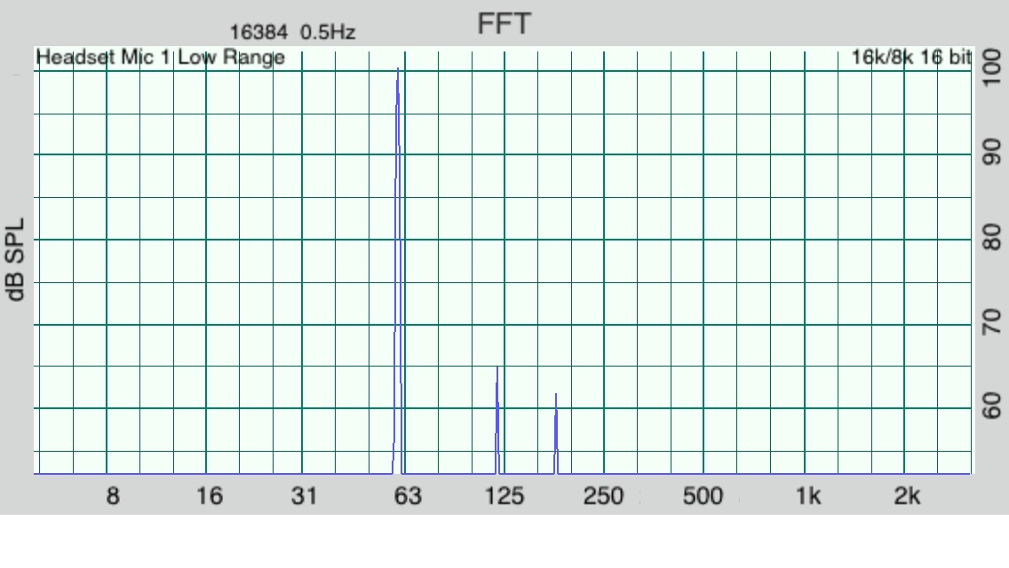

16 64 -45 -26
20 66 -33 -27
25 69 -28 -25
31.5 67 -23 -32
40 86 -25 -35
50 101 -35 -25
63 111 -25 -29
attached is 60hz @80db and 100db and the predicted group delay

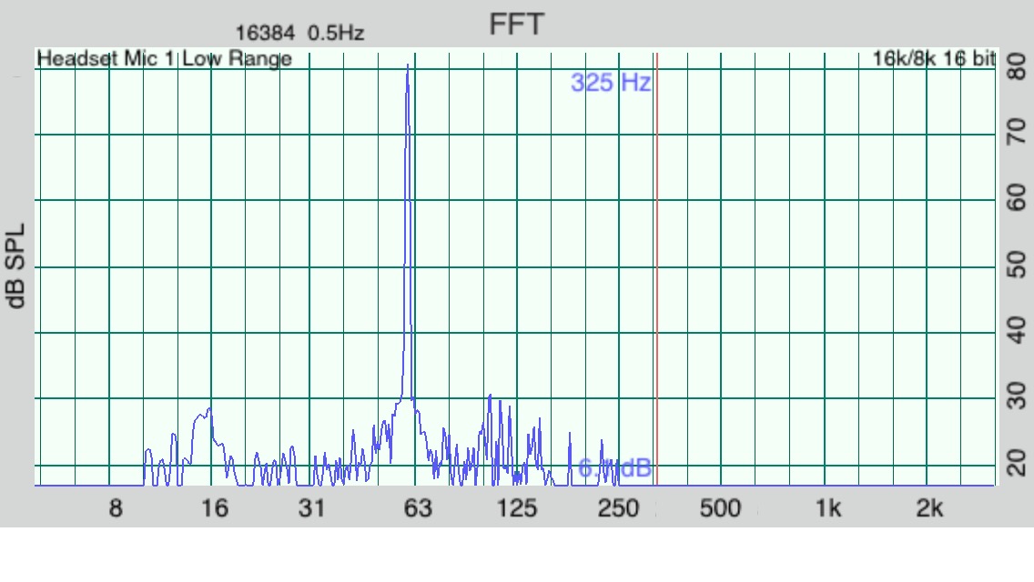

16 74 -23 -24
20 86 -32 -26
25 84 -28 -24
31.5 67 -20 -32
40 95 -25 -24
50 100 -35 -26
63 110 -25 -32
