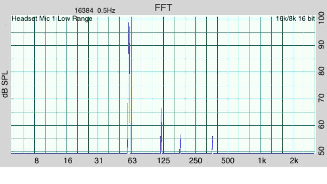

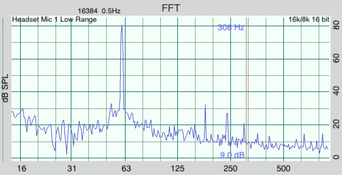

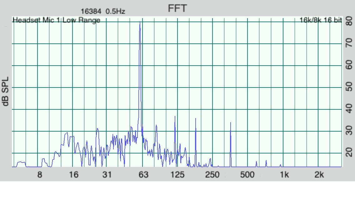

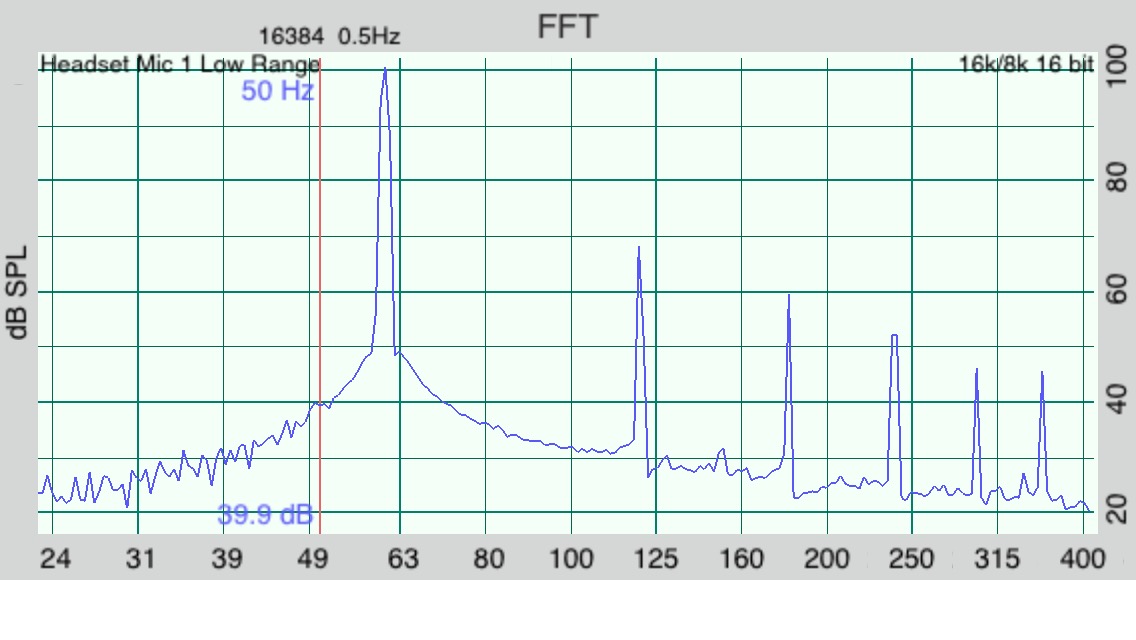

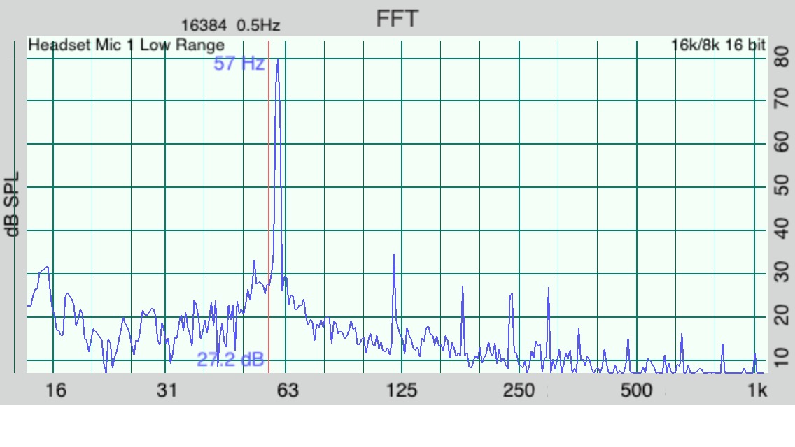

With the holidays I fell behind on posting data from the NE315.
Here it is in the 3cu ft 17.4hz passive. One thing I noticed about this driver is that when it's humming along at 80db@60hz it's very clean; harmonics are basically at the noise floor -60db down.
Here's the max spl at 5% distortion measurements:
Frequency Spl of fundamental 2nd harmonic 3rd harmonic
16 76 -23 -42
20 77 -27 -33
25 72 -23 -38
31.5 50 -15 -30
40 81 -25 -61
50 106 -37 -25
63 104 -26 -48
attached is 60hz @80db and 100 db

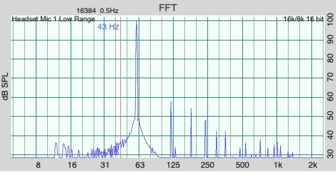

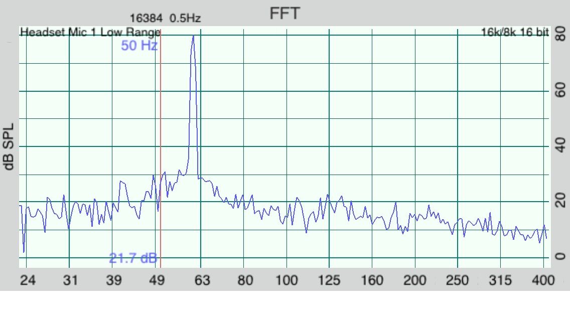

Next up is the Tymphany NE315 in 85 liters 38hz vented.
16 64 -28 -24
20 71 -23 -26
25 75 -24 -35
31.5 79 -24 -37
40 88 -24 -38
50 111 -26 -33
63 110 -25 -40

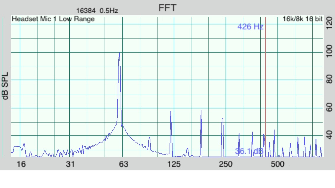

16 70 -36 -25
20 70 -27 -25
25 67 -25 -28
31.5 64 -23 -40
40 88 -24 -46
50 111 -26 -30
63 110 -25 -59

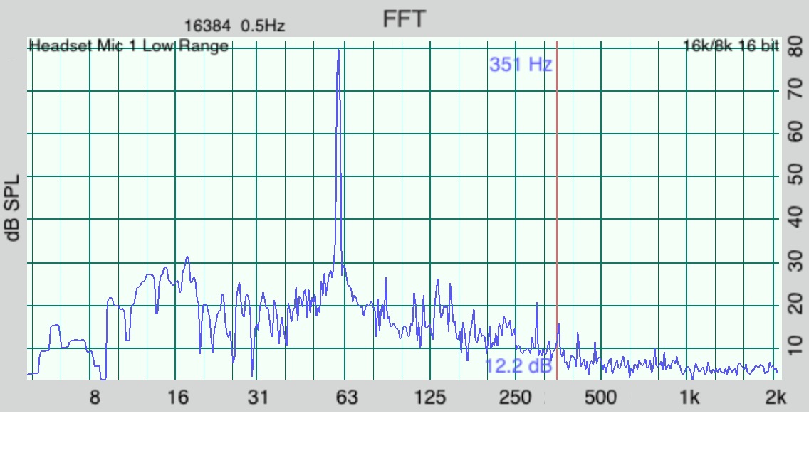

I also tested the AE SBP 12a in the 3cu ft 17.4hz passive radiator alignment. This driver sounds best in the sealed box and it is advertised and optimized to do so. But for consistency in my measurements I gave it a shot in the passive and I'm in the belief that you don't know until you've tried it.
One note is that the third harmonic is quiet in the 63 hz test (-60) but 4th and 5th harmonincs are louder (-53 and -49)

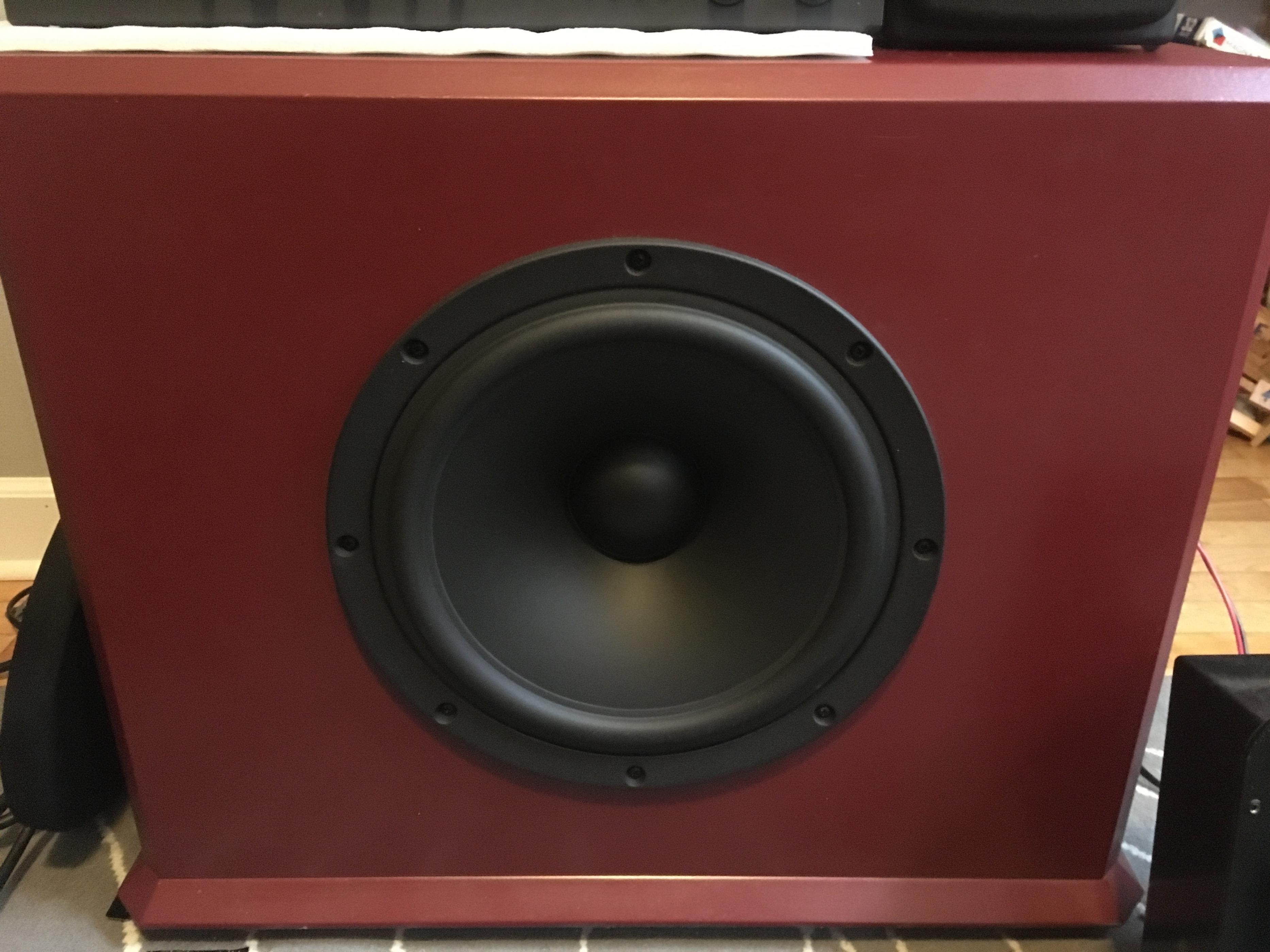

I also tried the AE SBP in the 85 liter 38hz ported alignment. I still prefer this is in the sealed enclosure.
This driver is the best of all I've tested so far in IMD distortion measurements. That is what distortion comes from playing two tones at the same time. More on this later.

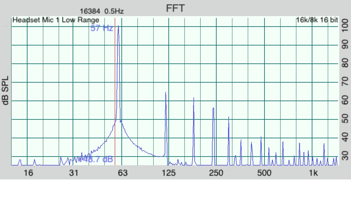

This first test is the SB in a sealed box. It's parameters are more geared toward vented enclosures but I was still able to get some good low frequency output due to a shallow roll off.
16 70 -42 -25
20 70 -32 -24
25 70 -26 -25
31.5 61 -25 -35
40 89 -24 -38
50 105 -26 -25
63 112 -26 -38
