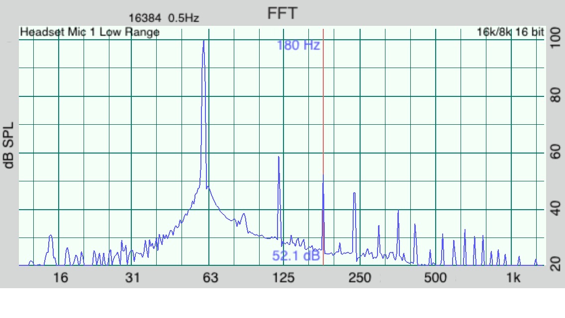

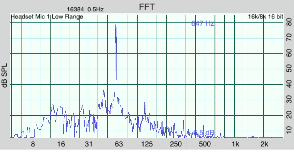

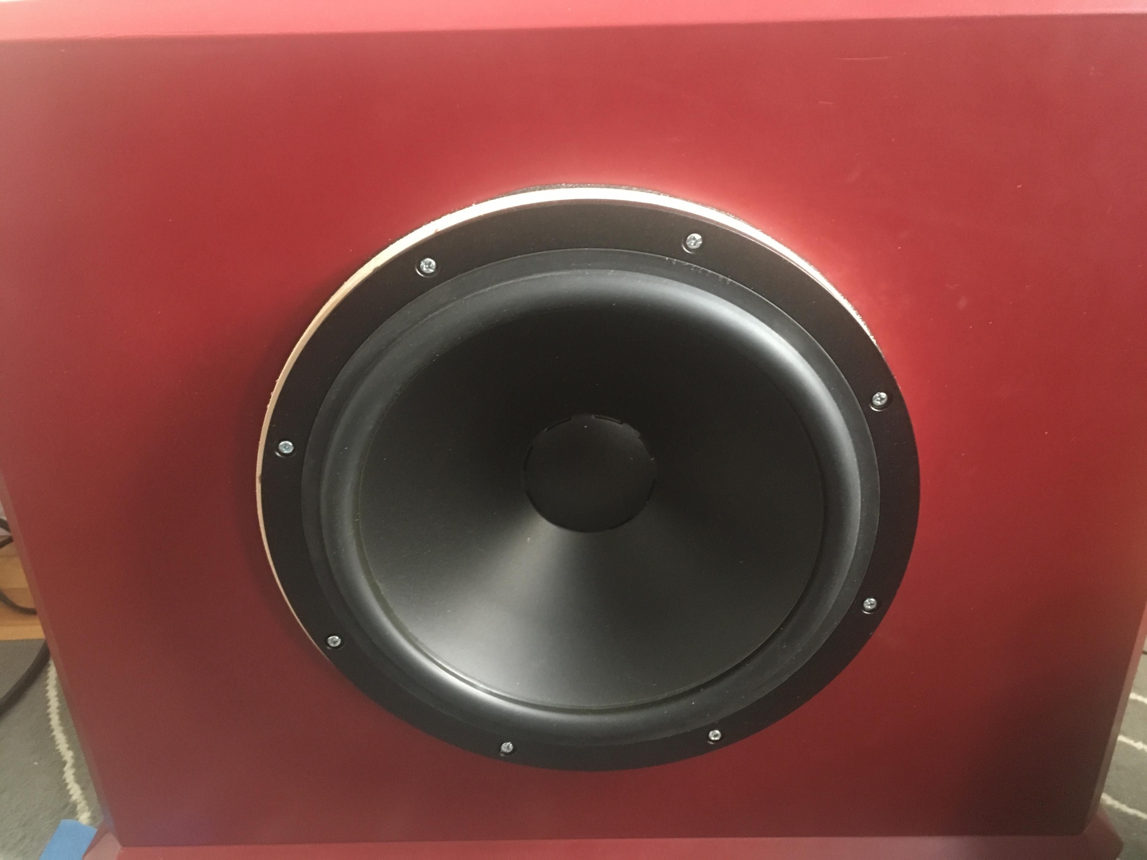

Next up in the test box is a Audio Technology Flexunits 12 B 77 25 10. Audio Technology is a diy speaker builders dream as they can tailor their speakers to your specifications, as long as you stay within the laws of physics.
This speaker I found out does a lot better in vented alignments but for consistency I will post the sealed box results. However, when within it's limits this driver has a super clean sound. It's low IMD levels are a good representation of this.
Here's the max spl at 5% distortion measurements:
Frequency Spl of fundamental 2nd harmonic 3rd harmonic
16 66 -35 -24
20 68 -27 -24
25 66 -25 -29
31.5 61 -21 -32
40 89 -24 -39
50 109 -22 -26
63 112 -26 -30
attached is 60hz @80db and 100 db

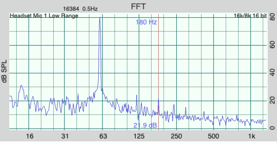

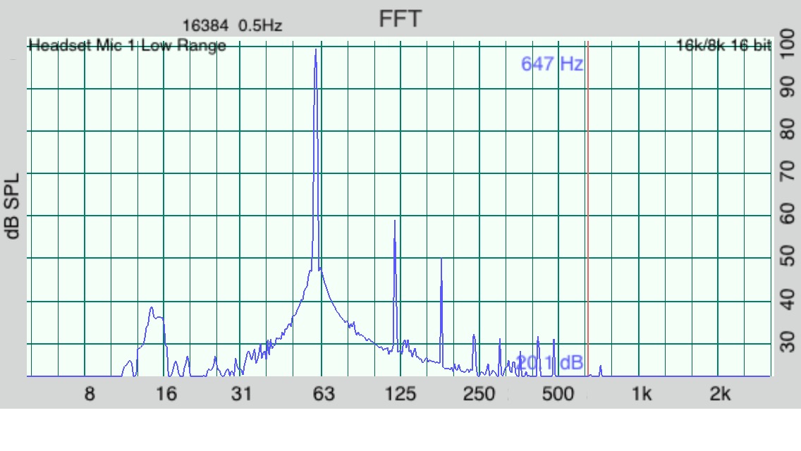

Now for the Audio Technology in the 38hz tuned 85 liter alignment. This is the right driver if you are looking for detail in the bass. For example my family enjoys the Hamilton musical so I've heard the soundtrack hundreds of times. In the song the story of tonight, I've always heard bass but wasn't sure if it was a keyboard or some synth bass, after playing the song through this woofer I discovered that there is a cello and upright bass in this song and I can now hear the texture of the string.
Personally I'd go with a lower tuning than 38hz but the audio technology seems to play super clean at low excursions and the port helps with that, and from 25-63hz this is probably the loudest average spl at 5% distortion. The seasl26 takes over at 40hz but the Audio Technology has 5 more db at 25hz.
16 56 -31 -20
20 66 -47 -26
25 90 -26 -25
31.5 94 -24 -26
40 94 -25 -33
50 110 -25 -42
63 112 -30 -47
I'd like to clear up two misconceptions I had with this driver. It has a very compliant excursion suspension (CMS) so I was worried about it easily bottoming out. However, there is a very high xmech (24mm) so in practice even with high listening levels I haven't been able to bottom it out. Also, it uses a poly cone and maybe some have experienced the mushy sound of a poly cones. This driver shows no sign of this, I would describe it as clean and detailed. My subjective description of clean sound is documented objectively by low IMD in post #199.
rhapsodee, To answer your question the xxls 10" is actually the driver that I've had for the longest and is the driver that started me down a quest for clean bass.
All in all it's a nice clean sounding driver but when low bass gets loud it seems there is too much momentum of the 134gram cone so that the decay is still noticeable between notes. I experienced something similar with the Seas 10. Maybe a 12" xxls would be better since there would be less excursion for a given spl and the 12" XXLS 830517 actually has slightly less MMS at 131g. As you probably know Peerless has changed to Tymphany and I've tried to contact Tymphany about their drivers that might be good for my test and I never got a reply. Maybe someone has a contact email?
