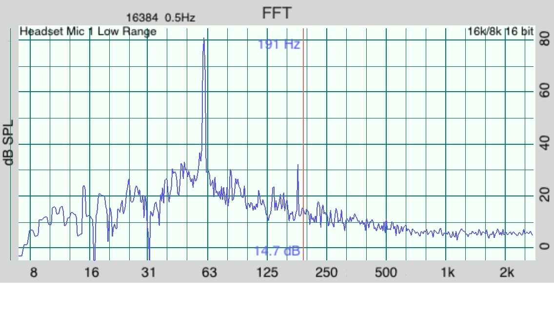

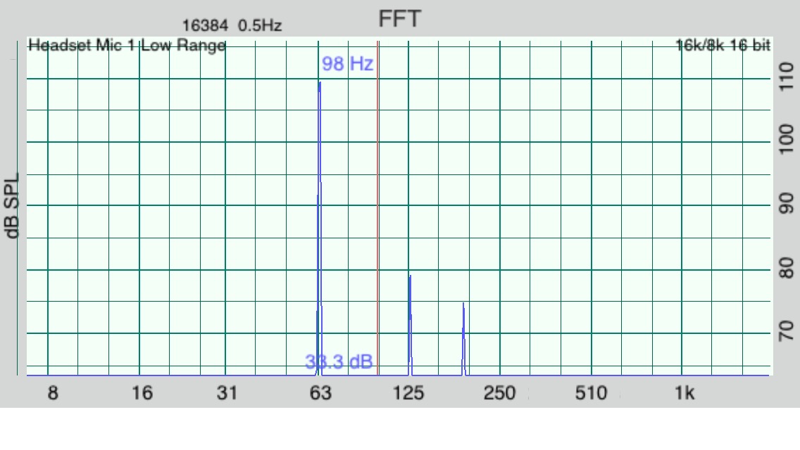

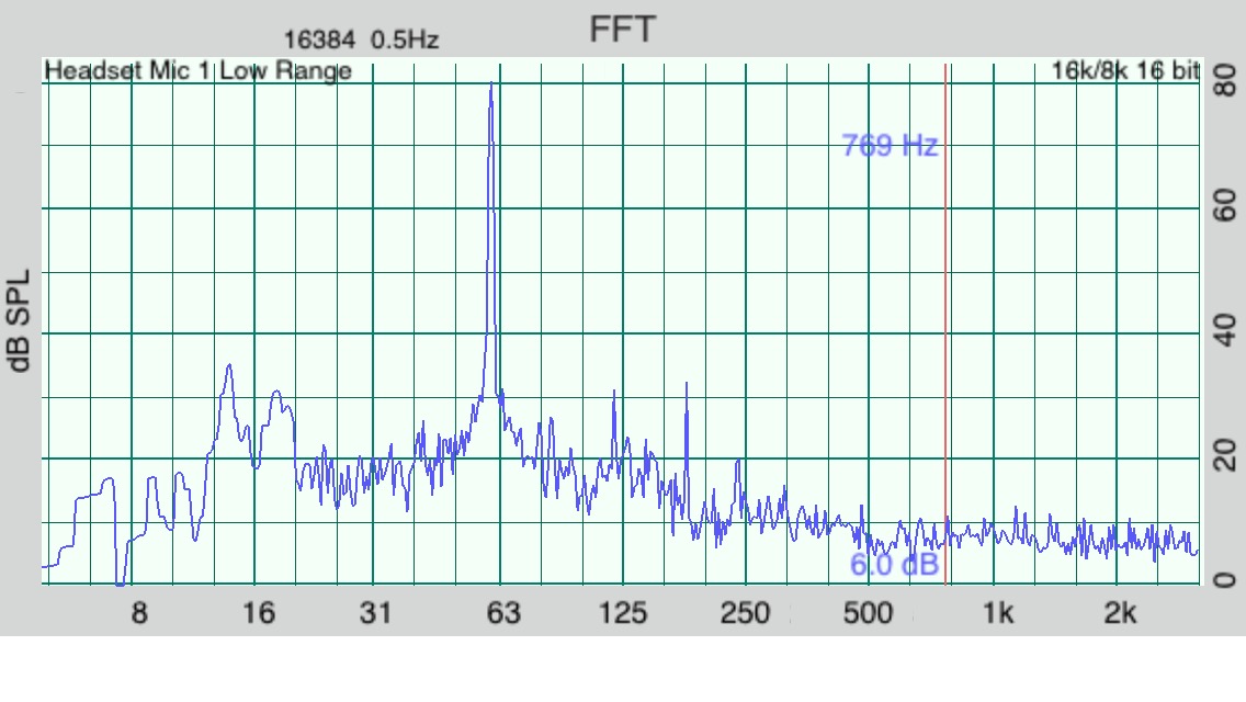

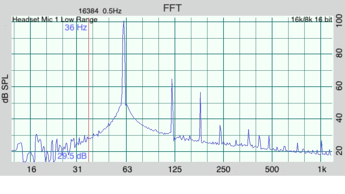

I then tried the B&C in the 85 liter 38hz vented alignment.
As most pro drivers it's t/s parameters are more for vented boxes.
Here's the max spl at 5% distortion measurements:
Frequency Spl of fundamental 2nd harmonic 3rd harmonic
16 58 -32 -19
20 66 -36 -24
25 85 -25 -26
31.5 86 -24 -41
40 93 -24 -33
50 110 -25 -27
63 112 -25 -36
attached is 60hz @80db and 100 db

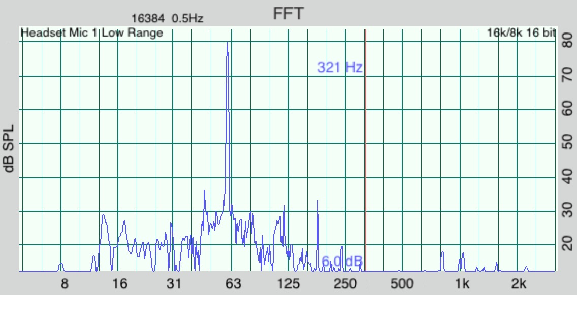

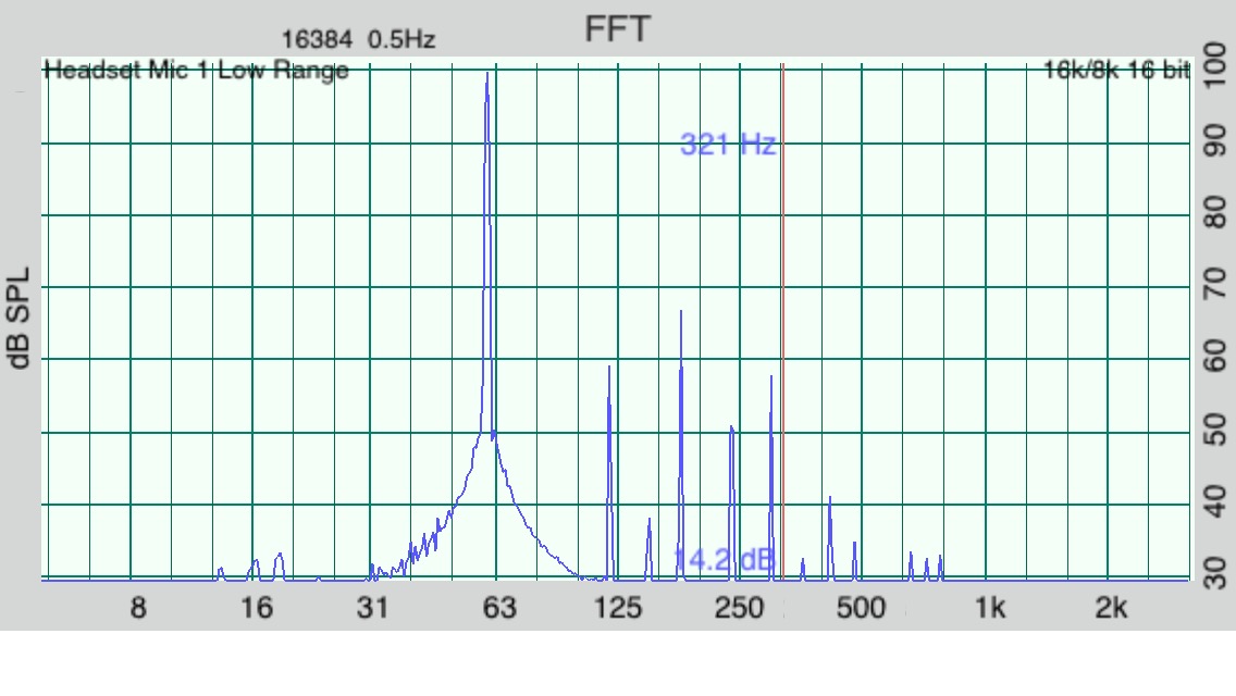

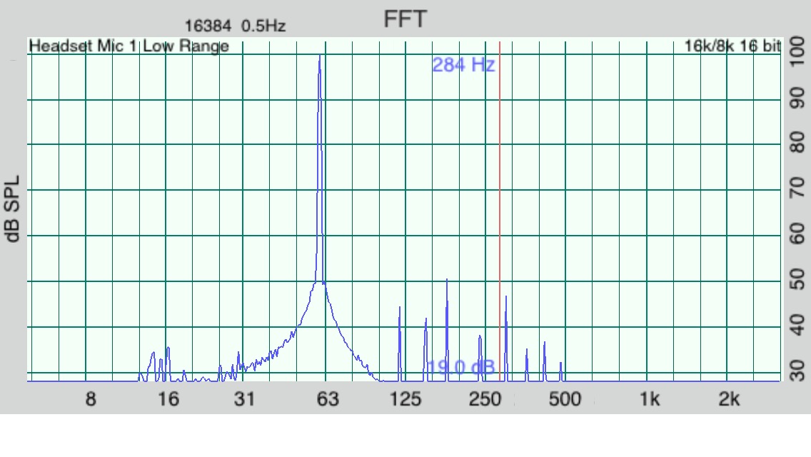

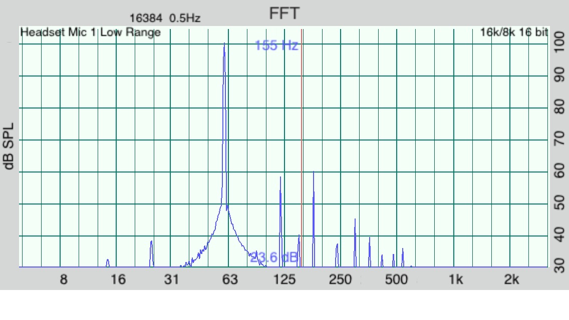

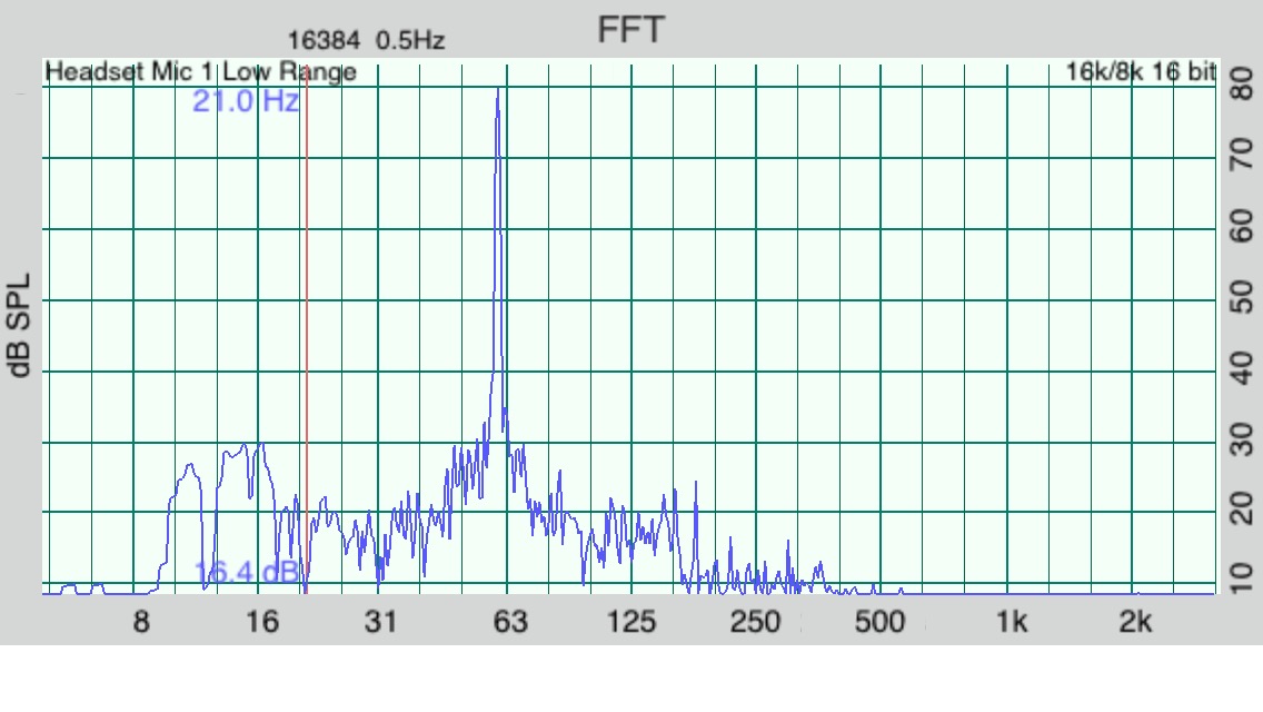

Last up with the B&C is the 85 liter 17hz passive tune.
One thing I noticed is the upper harmonics like 4th and 5th are lower than most of the other drivers, this can be seen in the 60hz@100db graph. The only driver that's cleaner is the Audio Technology (with passive radiator) in the 4th and 5th harmonics at 60hz.
16 71 -25 -41
20 88 -37 -26
25 82 -33 -25
31.5 65 -18 -25
40 87 -25 -29
50 108 -26 -25
63 111 -26 -40

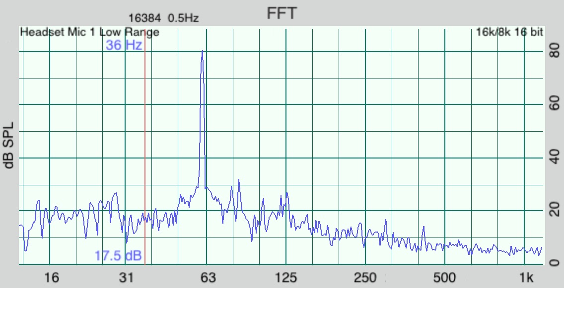

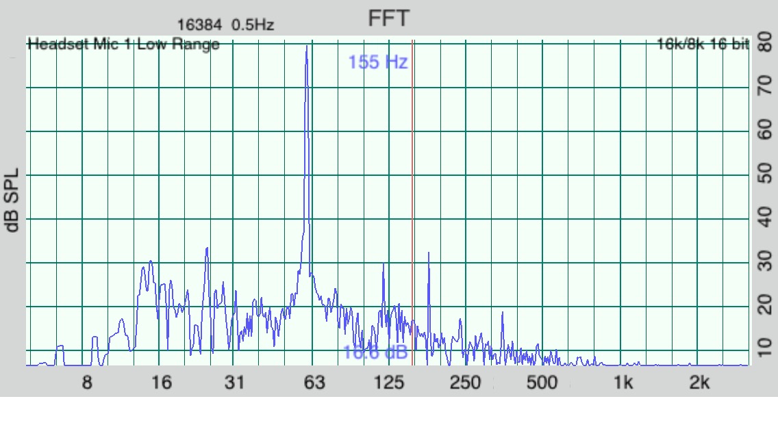

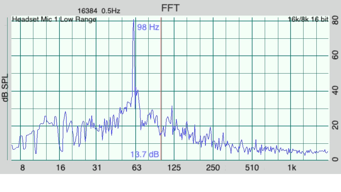

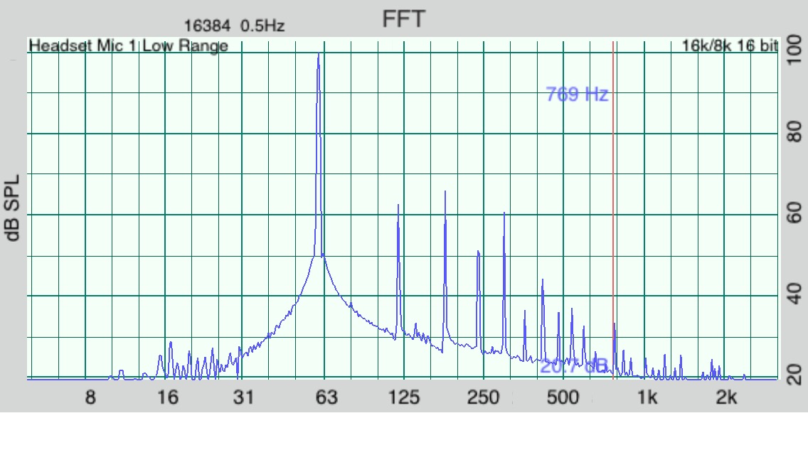

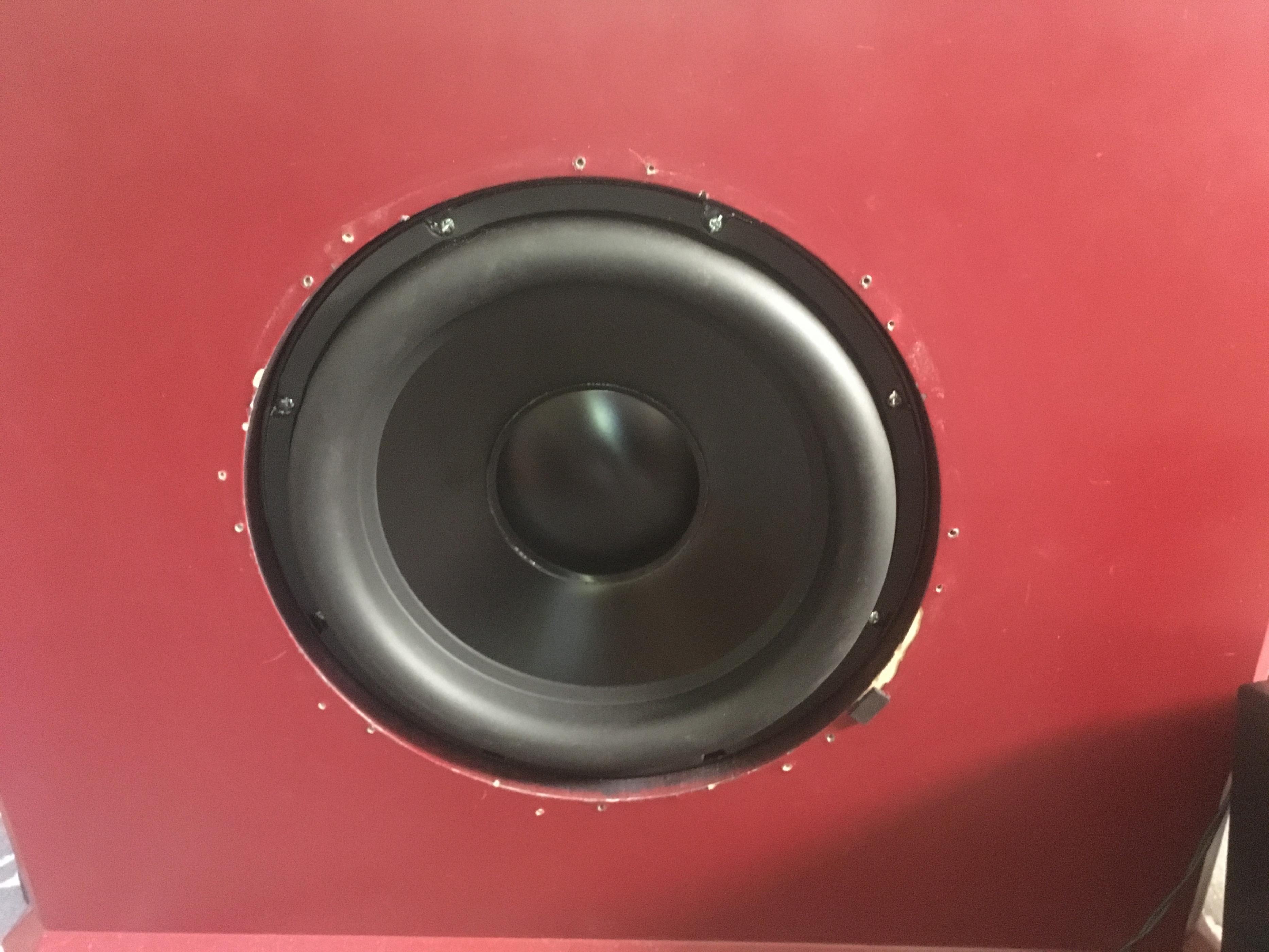

Next up is the Dayton Audio RSS315HE-22 a new high excursion model variant of the reference series. This driver doesn't disappoint and can really blast out clean deep bass even in the 85 liter sealed alignment I tried it in first.
In case someone asks, I prefer the sound of the this driver over the Dayton Audio RSS315HFA-8 12" Reference HF. After accounting for voice coil resistance the HE sub has a higher motor strength to weight ratio than the HF so it could be that. But as I've been learning you can't just pick out one parameter that provides better sound quality it's all the parameters working together. Also from my testing the HE has lower higher order distortion like 4th, 5th etc than the HF. See post #3 for more info on the HF.
The HE also has the lowest 30 and 72hz IMD (1.26%) at 80db of the eight drivers in total I tested including drivers 2 or 3 times the price. See attached graph for the spectrogram and compare this with the graphs in post #192.
16 79 -41 -24
20 75 -25 -25
25 67 -24 -35
31.5 66 -24 -35
40 95 -25 -40
50 112 -25 -40
63 112 -28 -40

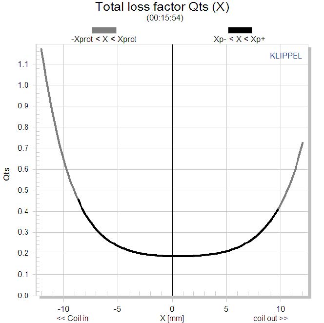

Tony, I think you have found the tradeoff between the HFA-8 and the HE. One of the sources of distortion is Current so the more efficient a driver is the less distortion it will have. The HFA-8 is more efficient than the HE but needs a bigger box. I think this is why the HFA-8 is putting out more db at my 5% distortion test especially in the low bass.
Of the three different alignments, I actually prefer the HE in a sealed box as I get a real shallow roll off that works with the boost of low frequencies by the room.
To answer your question about modelling, I think bassbox and winisd do a good job but you have to remember drivers are non-linear and as they start to move the t/s parameters shift. A good driver will show less of this but it's still there, I've attached a graph of the .Qts of a AE TDH6 midbass, the .Qts is almost double by 7mm.

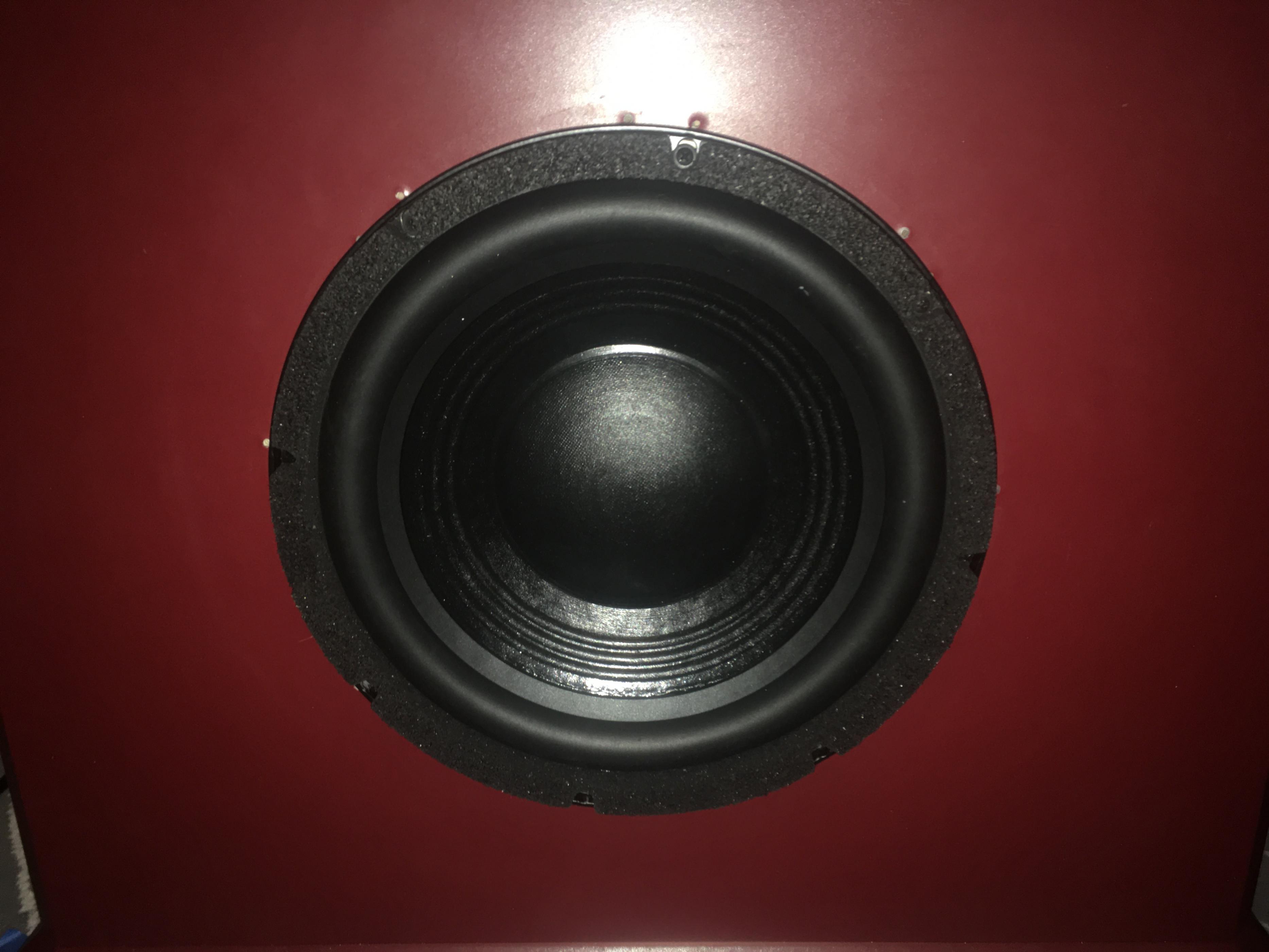

Next driver is the Morel TiCW 1258 ft. An easy route to good sound is to drop one of these into a sealed box. This driver is one of the best in all around music, jazz, classic rock, hiphop all sounded great. This driver did the best job of all the other subwoofers I've tried in reproducing one of my test tracks that contains a large Taiko drum. I've analyzed this song and it contains large simultaneous peaks at 60 and 105hz. I believe part of the reason the Morel did so well in this track is it's low inductance. A driver with high inductance playing 60hz might cause the 105hz component to be compressed.
This driver seems to have a different distortion profile then others when listening at moderate levels it sounds very clean but as it gets louder distortion sets in. This can be seen be in my measurements of IMD at 60 and 144hz. At 80 db it is nearly the best but at 90 db other drivers are cleaner.
Here's the max spl at 5% distortion measurements in the sealed box:
16 65 -43 -24
20 70 -30 -24
25 60 -24 -25
31.5 57 -22 -29
40 88 -26 -32
50 108 -24 -23
63 110 -25 -35

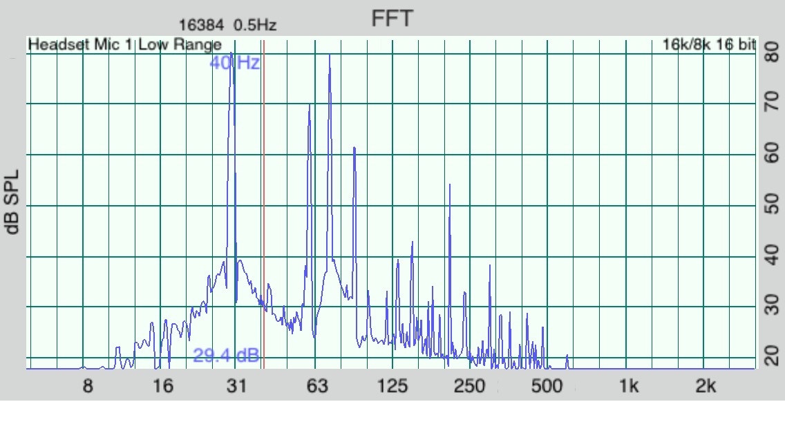

Attached is a spreadsheet of my Intermodulation distortion (IMD) results so far. I've found that a driver with low IMD sounds very clean. Since IMD products are not harmonically related to the signal they seem to stand out to the ear more than harmonic distortion.
