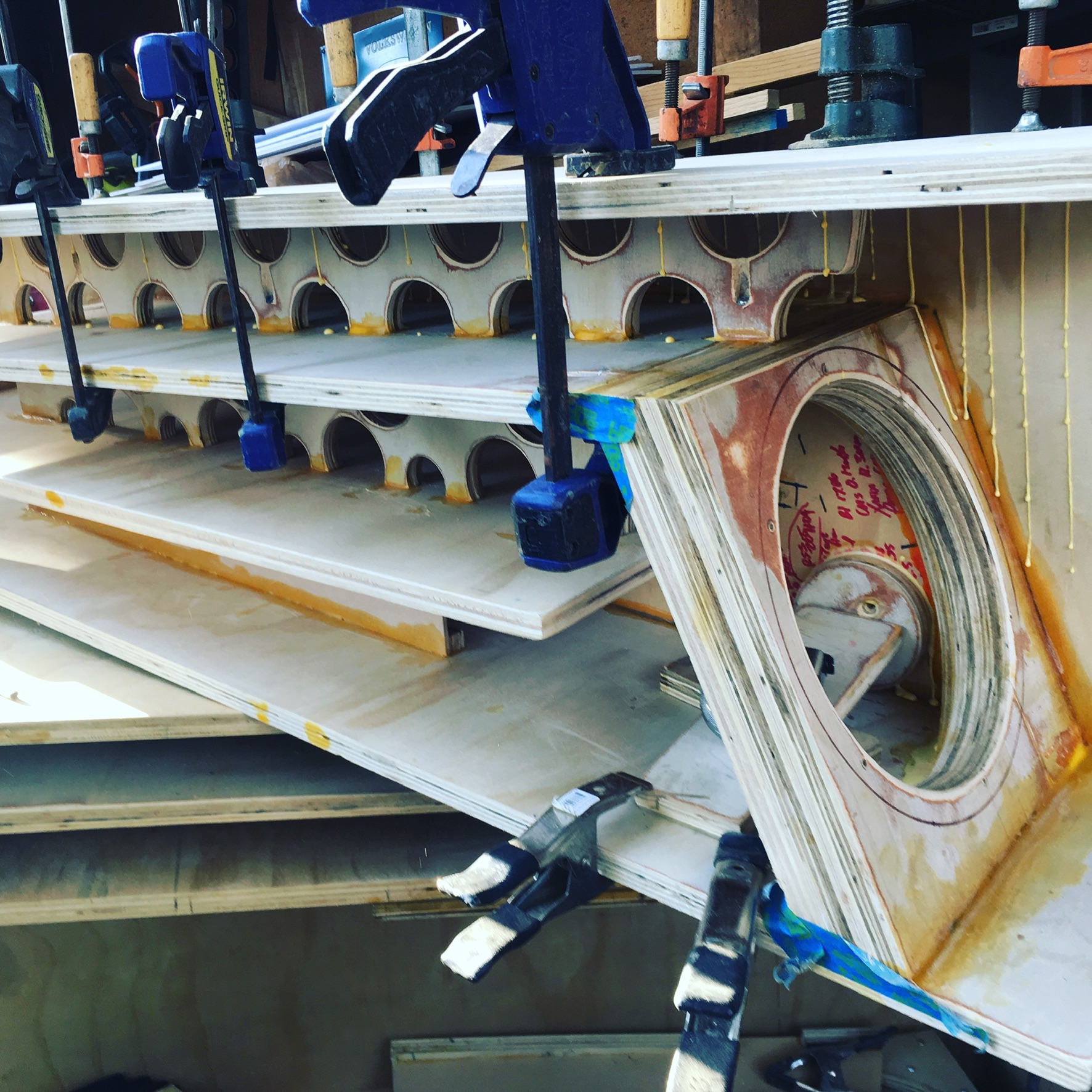

Wow, 17.5" wide x 32.25" tall x 31.75" deep / 1,728in3 = 10.37ft3! Those numbers represent the external dimensions of my T-TQWT (negative flare tapped horn for a square 15" sub).
A negative flare lowers the tuning versus a positive flare for a given volume. That also means the enclosure will be smaller and less efficient for a given tune.
Hofmann's law = loud, low, & small...pick 2.
I chose low and small. The enclosure is loud enough to crack multiple walls in the house with less than 140 watts going into each voicecoil from a Yamaha HTR-5730 in stereo mode.

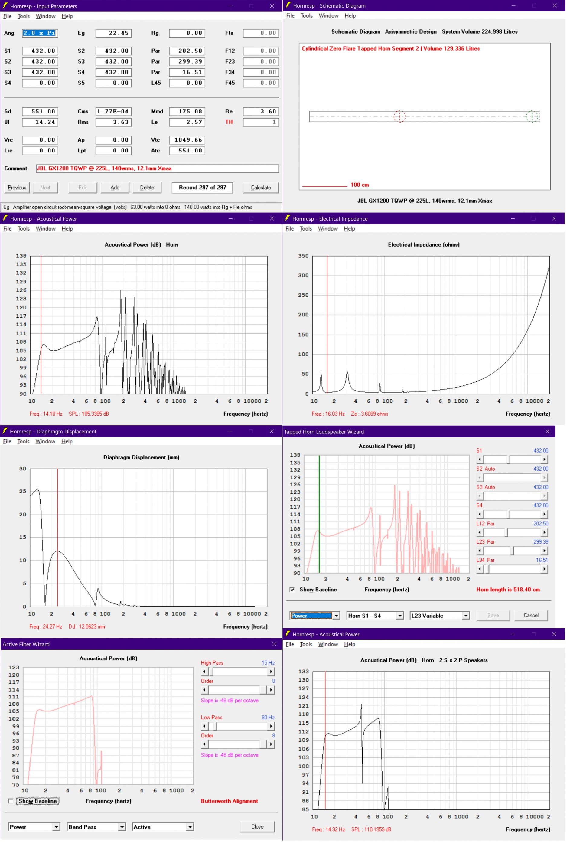

How are you not able to go below 16hz with a TQWP or TQWT (tapped quarter wave pipe or tube)?
I'm digging the 108, 216, 432, 864, 1728, 2592 cross section areas. Anyone that builds subwoofer enclosures should easily recognize those cubic inch volumes.
You right BW! I tried to stay within your CSA parameters. 16hz tuning is it.

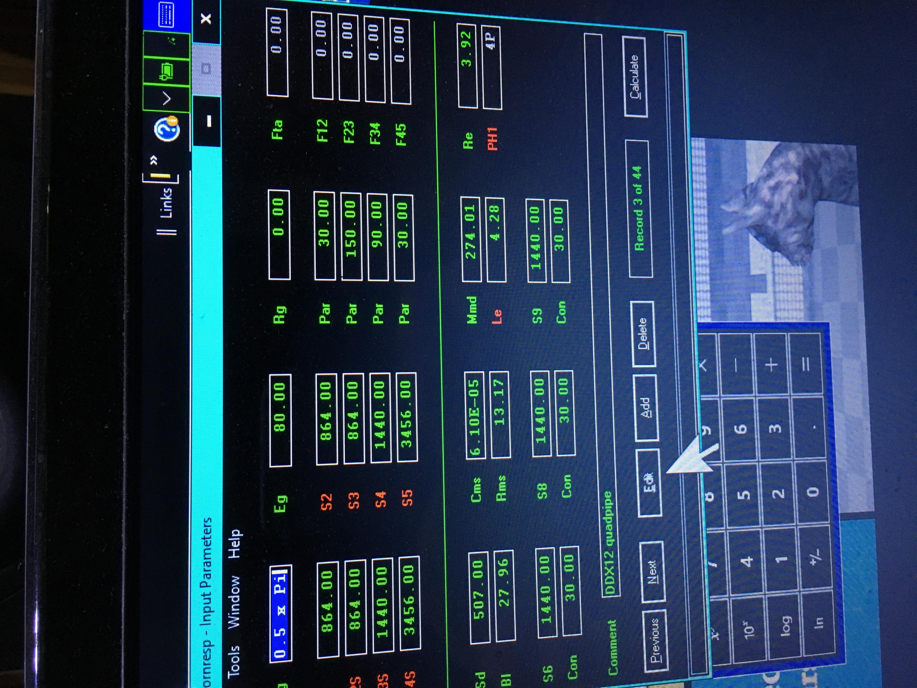

My 1st HR model in MONTHS!
2592 x 2 = 5184.
2592 x 2 = 5184.

No attempt made to be other than a proof of concept [POC] using the first ~20 Hz Fs driver I found in my HR files and using your 2592 to get acoustic gain up enough just to see the response plot 😱, so obviously a custom driver or driver array required if > 5 W power handling required. 😉
In short, either make a 10 Hz/whatever driver or calc an inverted mass corner:
[Flc] = Fs*Qts'/2
Qts' = 2*Fs/Flc
Hmm, I find this a bit surprising considering your cosmic 'awareness'. 😉
[Flc] = Fs*Qts'/2
Qts' = 2*Fs/Flc
