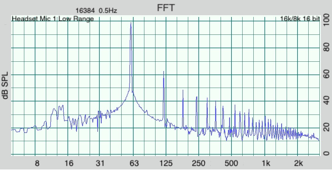

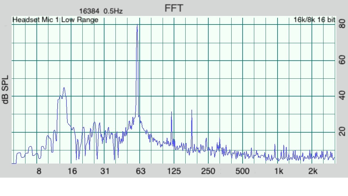

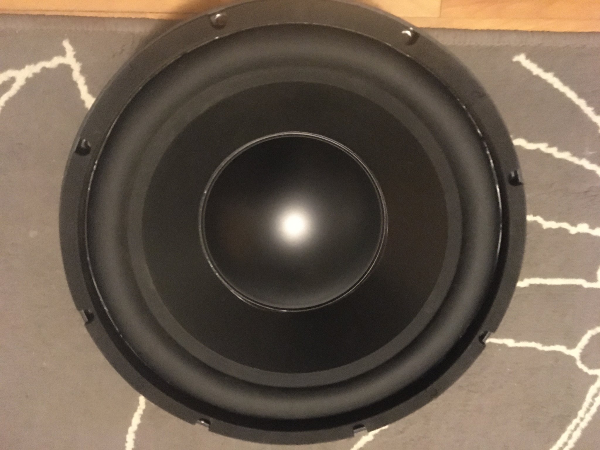

I helped my relative upgrade 20 years of subwoofer technology. He replaced a Dayton titanic 1200 from 1999 with a Dayton Audio RSS315HE-22.
The HE is much more punchy and clean sounding but I took the Titanic home anyway for distortion measurements of it in the sealed box. I will only test this in the sealed box as that's what it was designed for.
Here's the max spl at 5% distortion measurements:
Frequency Spl of fundamental 2nd harmonic 3rd harmonic
16 76 -29 -25
20 70 -25 -32
25 61 -24 -41
31.5 52 -23 -35
40 84 -23 -44
50 110 -29 -25
63 110 -28 -34
attached is 60hz @80dB and 100 db
