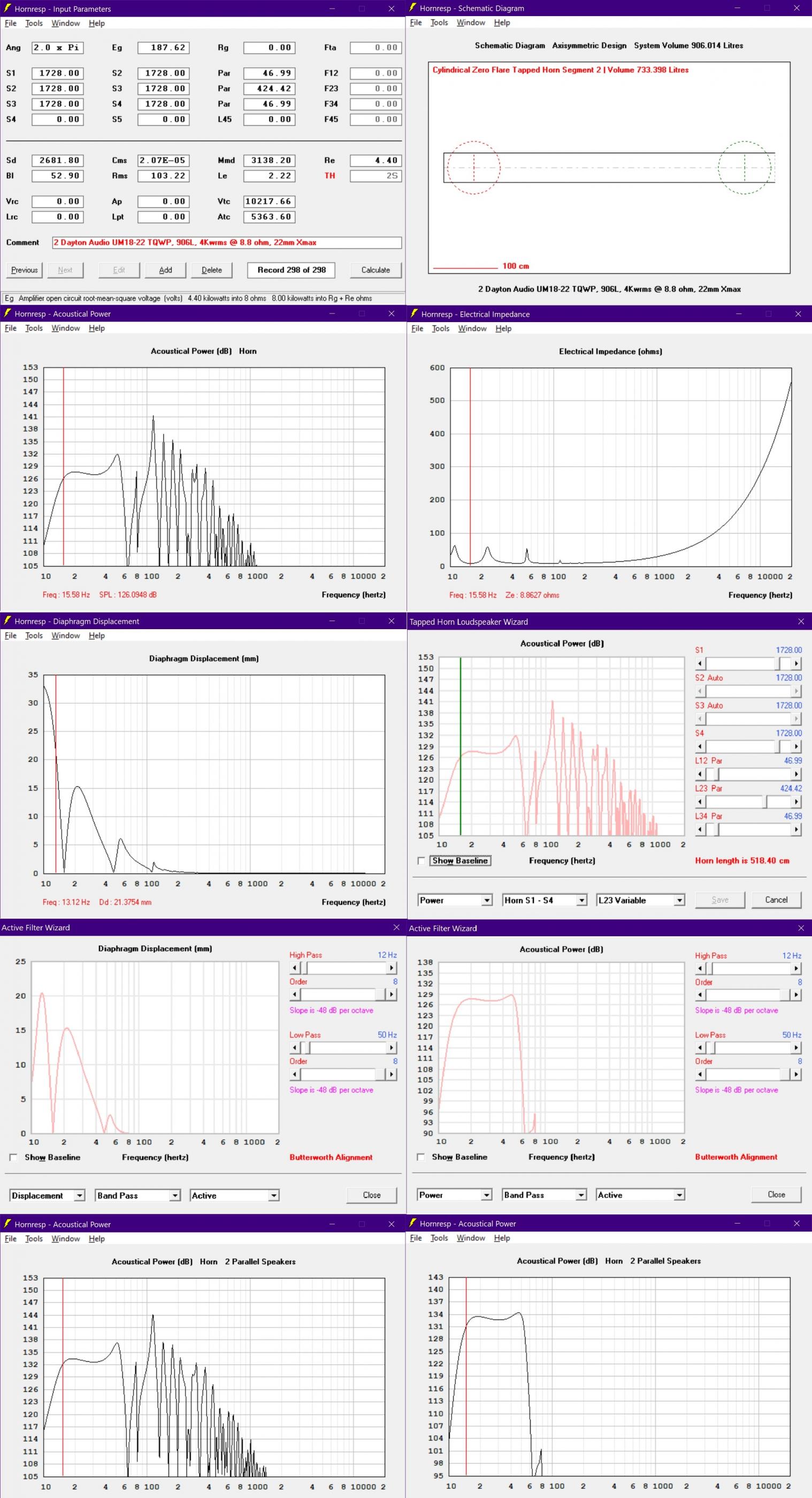

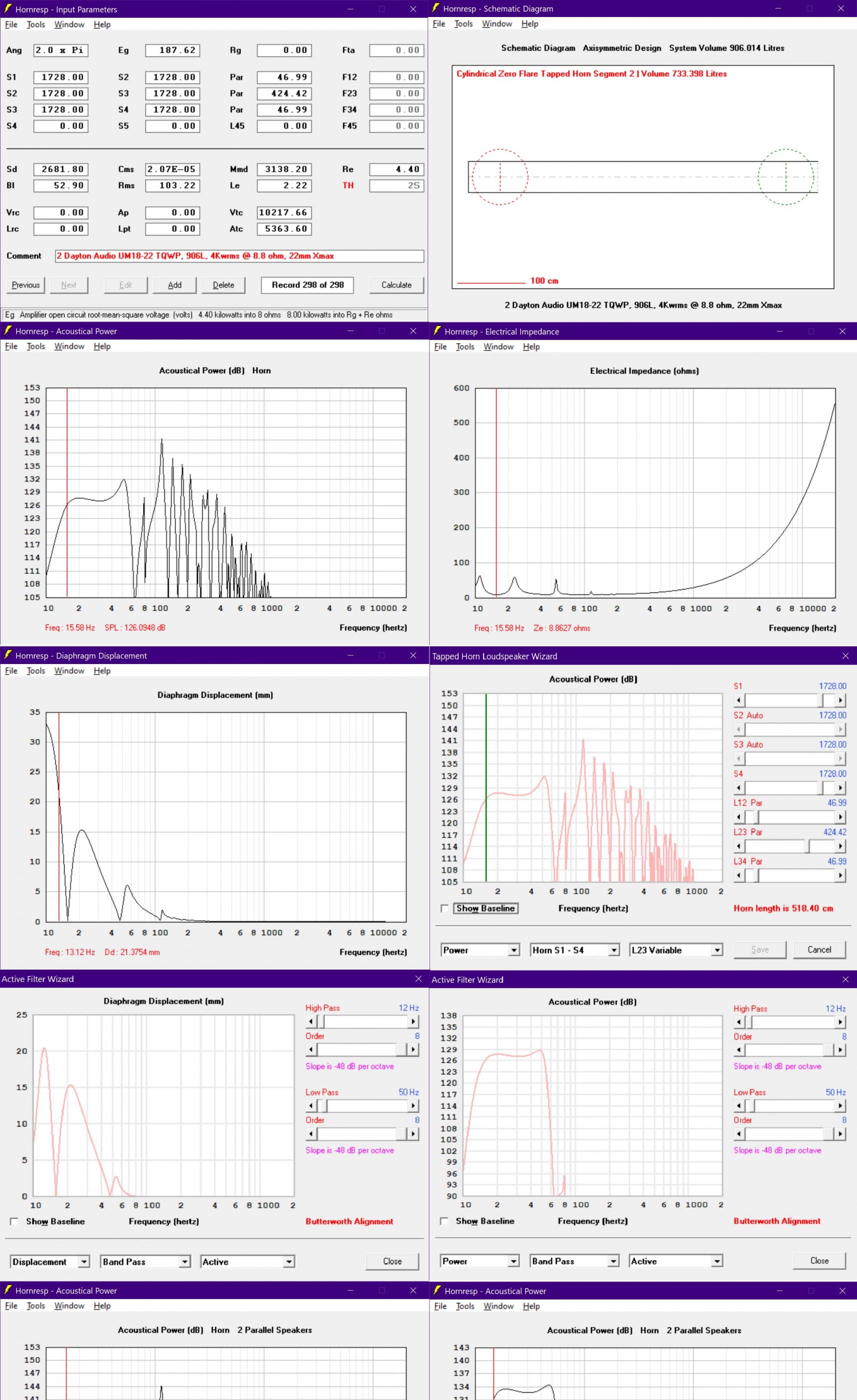

So the last 2 graphs represent 2 enclosures sitting outside running off ONE 4 ohm amp.
Each enclosure is wired series-parallel for a 8.8 ohm load.
The 2 enclosures are wired parallel for a 4.4 ohm load.
I see me and Paint are not getting along. The frequency and dB are cutoff on both graphs.
Graph 1 = 15.36hz @ 132.1344 dB.
Graph 2 (Active Filter) = 14.71hz @ 131.1124 dB.
Active Filter: High Pass = 12hz @ -48 dB.
Active Filter: Low Pass = 50hz @ -48 dB.
2 octaves!
2 octaves!

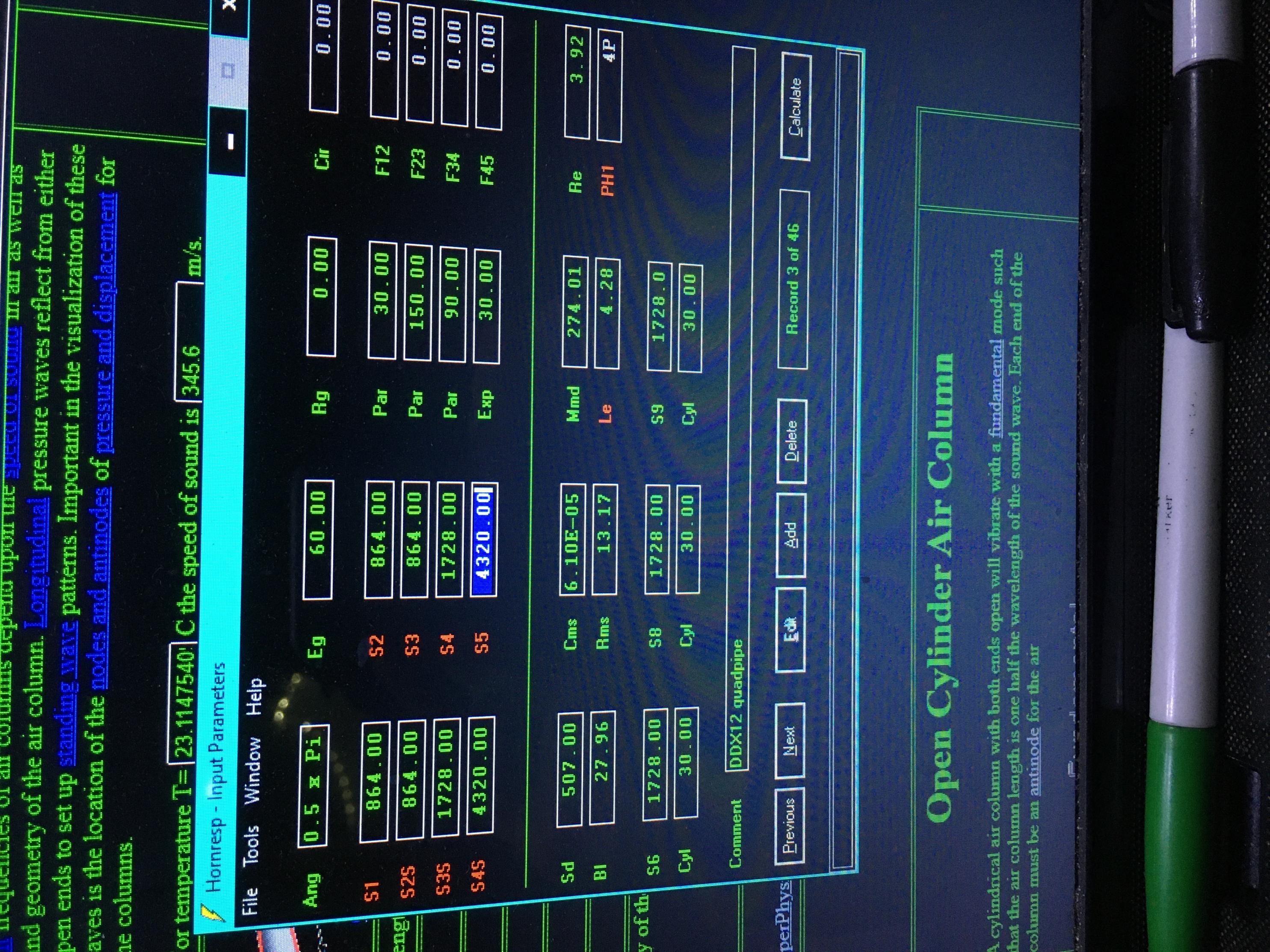

So are you basically saying all horn or TL lengths should be 12ft (365.76cm)?
304.80, 335.28, & 365.76cm are usually the TH lengths I model with.
I like the fact those 3 lengths provide a 30, 33, or 36in internal height when designing a double fold enclosure.
Man, you need to learn how to paste your screen prints to Paint, save as jpeg, and upload the pic to diyaudio.
Take a look at the simulation at 860 Hz and 8600 Hz and 18 920 Hz and anything in between which falls on 860 interval. You see how crazy is that?
Then please attach the HR record for download.
I think you know I’m talking about you GM😀
For sure I did more than my fair share of 'due diligence' and yes, I tend to dole out knowledge as I understand it in bits n' pieces same as my mentors did me and try not to intentionally misguide as so many did me when I joined the audio related WWW, so kind of backed into a personal Crusade of 'lifting the veil of ignorance' every chance I get.
As for the rest, no clue what you're trying to point us to, so might as well be written in Sanskrit. 🙁
