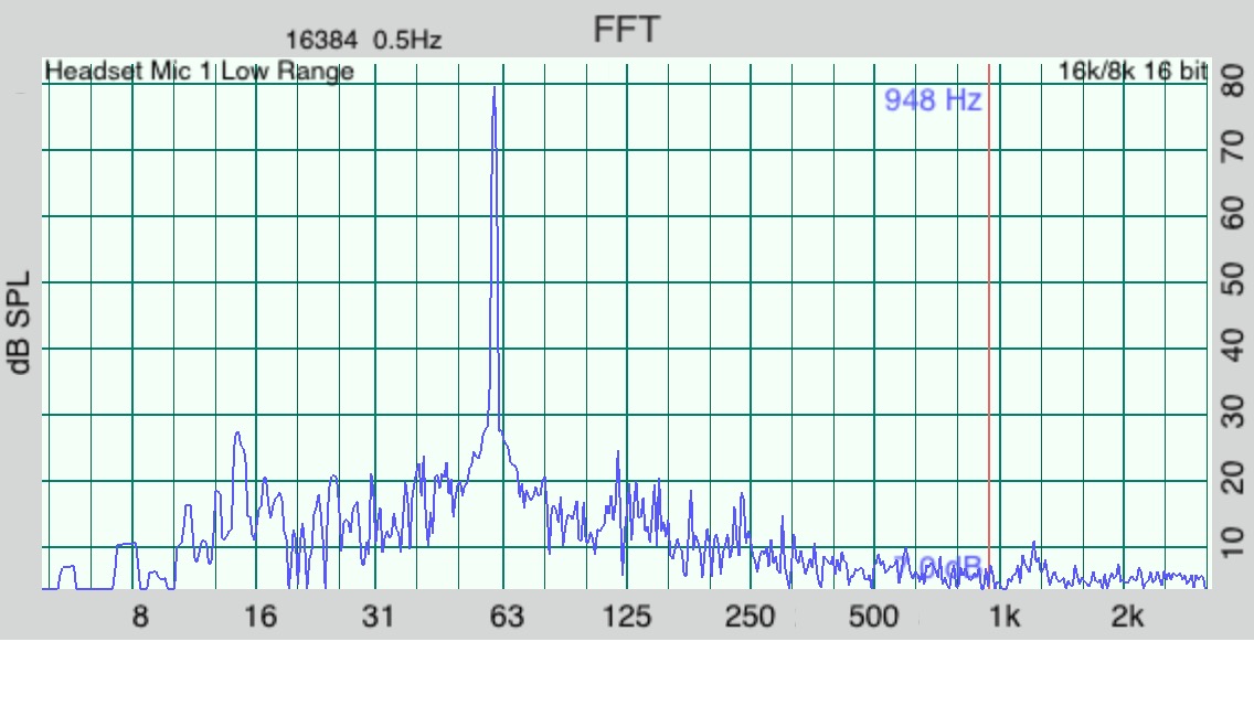

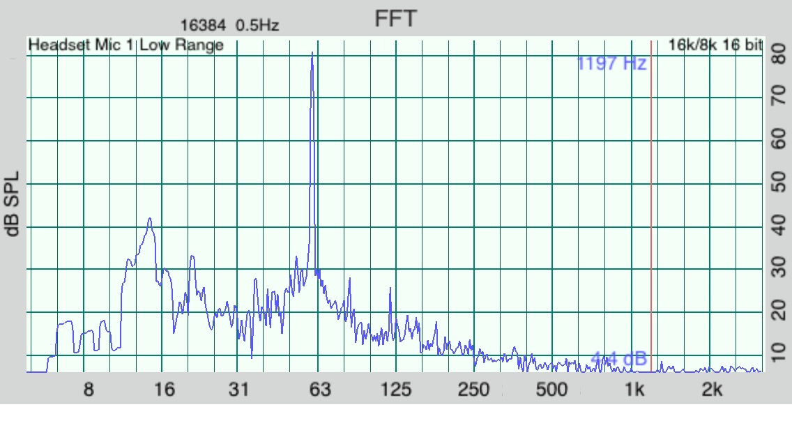

Next is the SB in the 85 liter 38hz alignment.
This gives a peaky response so I didn't do too much subjective listening in this setup but carried out measurements to see how well it drives the port. This drivers has a lot of clean output at 63hz and is pushing the limits of my testing setup. I pushed to 115 db and my microphone was clipping.
Here's the max spl at 5% distortion measurements:
Frequency Spl of fundamental 2nd harmonic 3rd harmonic
16 59 -39 -20
20 69 -37 -25
25 84 -28 -25
31.5 90 -25 -32
40 93 -24 -41
50 110 -24 -25
63 112 -30 -45

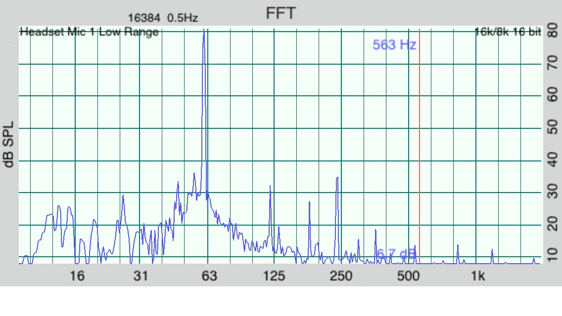

attached is 60hz @80db and 100 db

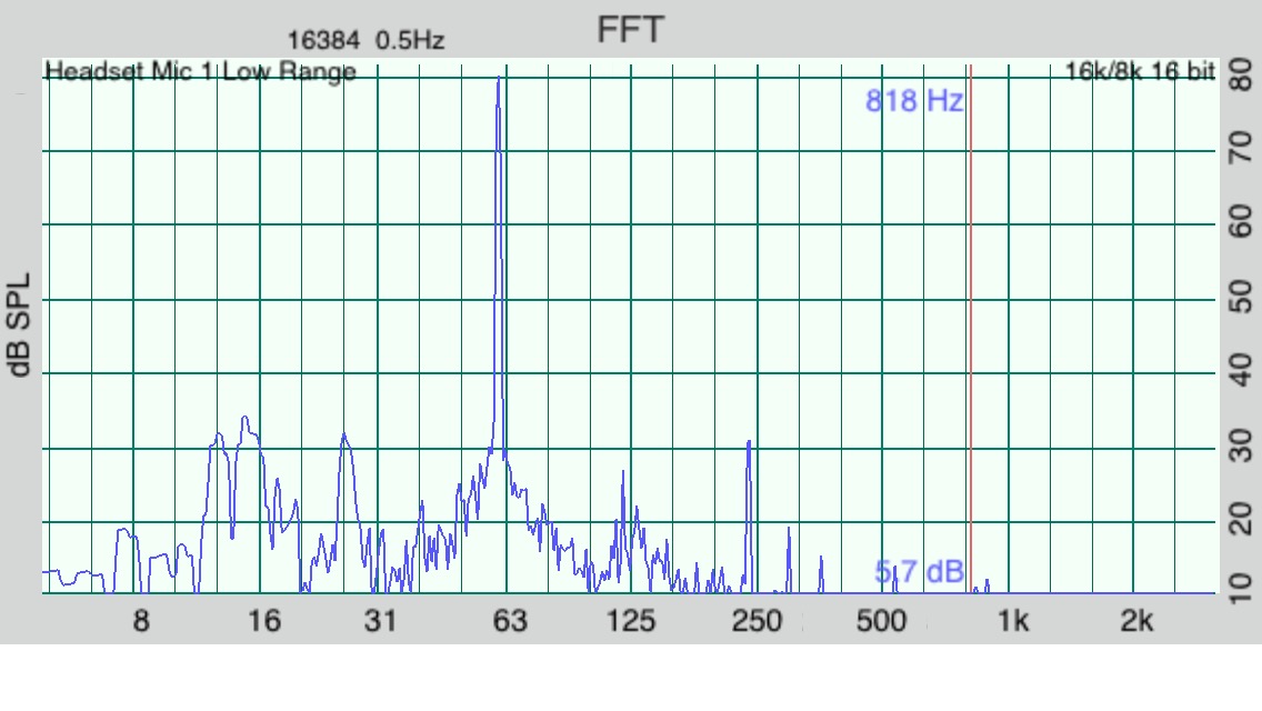

16 74 -23 -39
20 85 -28 -24
25 81 -26 -25
31.5 62 -22 -35
40 90 -24 -35
50 106 -25 -23
63 112 -31 -41

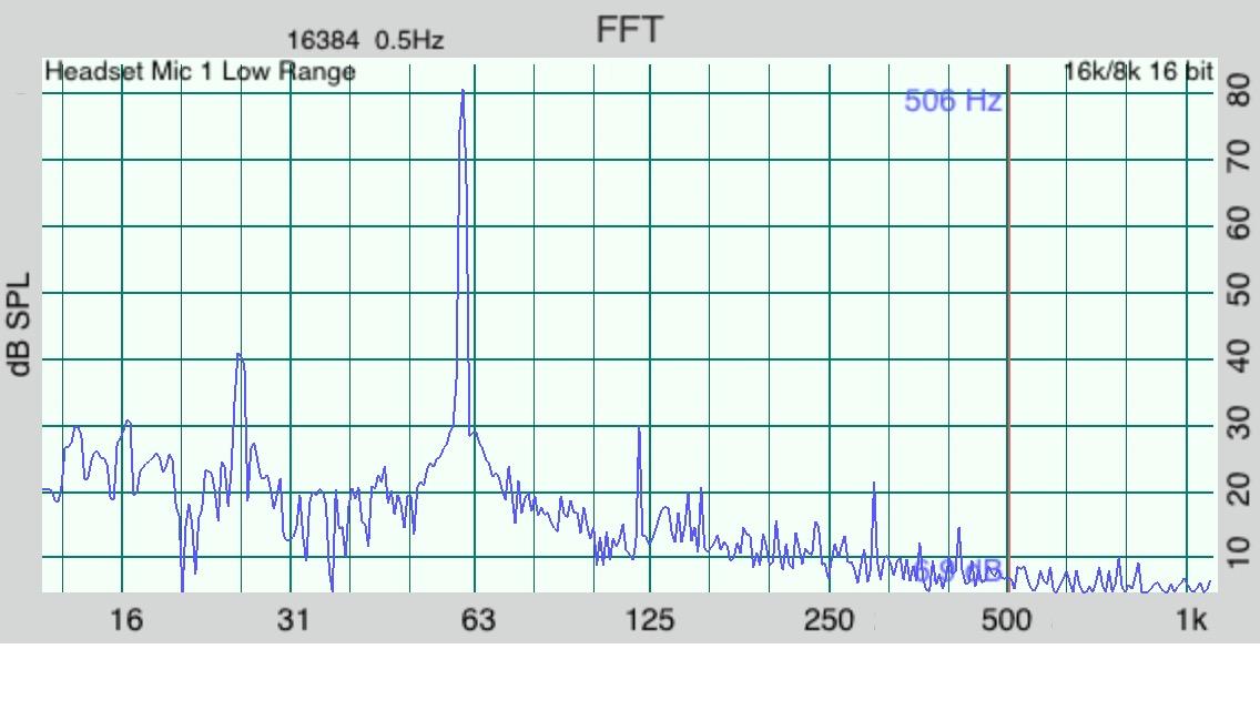

Next up is the Seas l26 in 85liters 38hz ported.
Tons of output in the 40hz range, however to me the group delay was noticeable around tuning as with almost all drivers I prefer this driver in the sealed or passive radiator alignments.
I made a mistake on the 63 hz reading and forgot to capture the 3rd harmonic since the scale was set for 50-110db and the 3rd harmonic was below 50db. In other words very clean sound at 50 and 63hz because the 3rd harmonic is way down.
16 54 -29 -20
20 66 -47 -23
25 85 -41 -25
31.5 94 -24 -25
40 105 -29 -26
50 112 -26 -34
63 110 -24 more than -60 db down

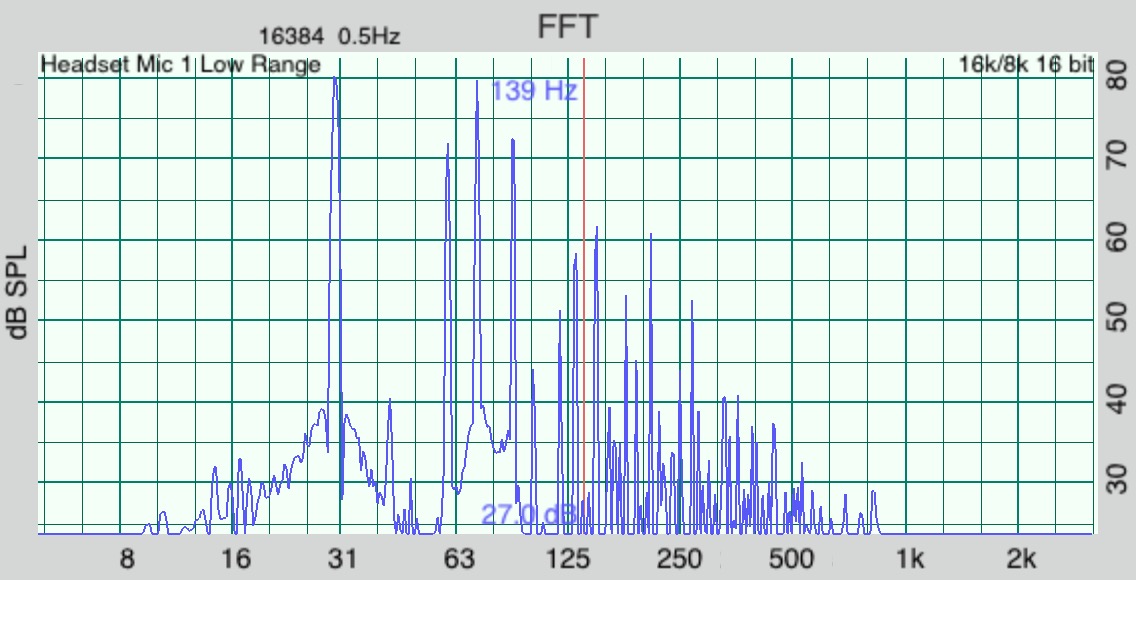

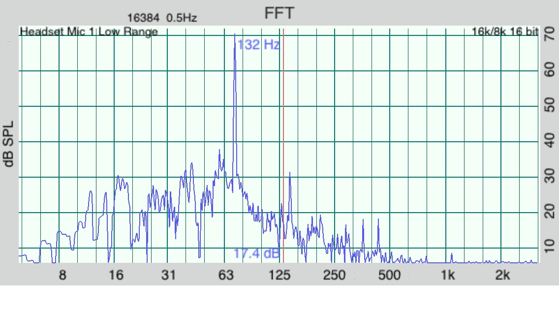

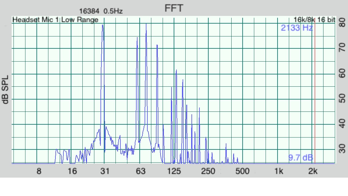

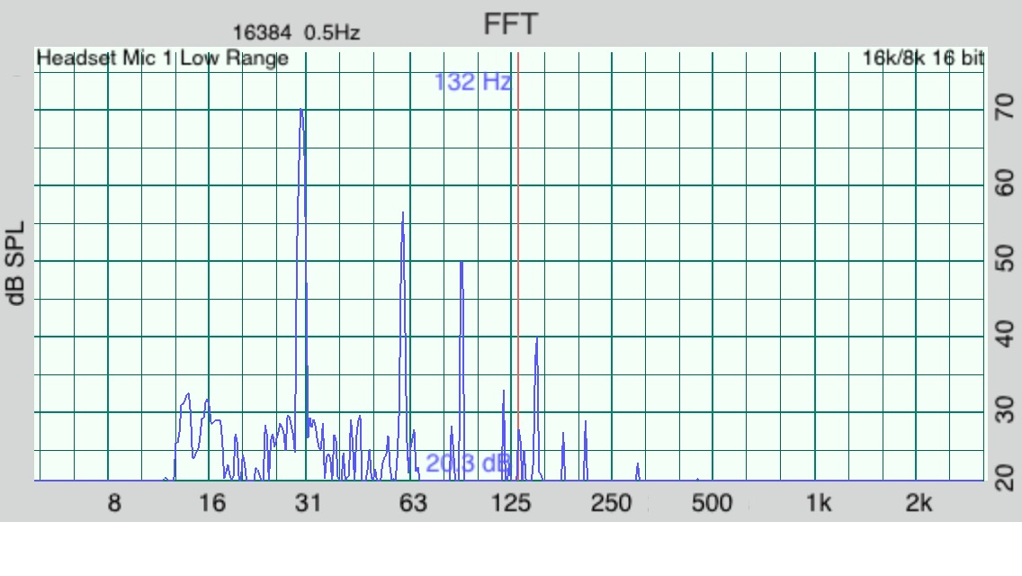

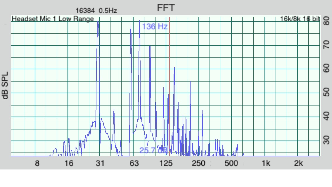

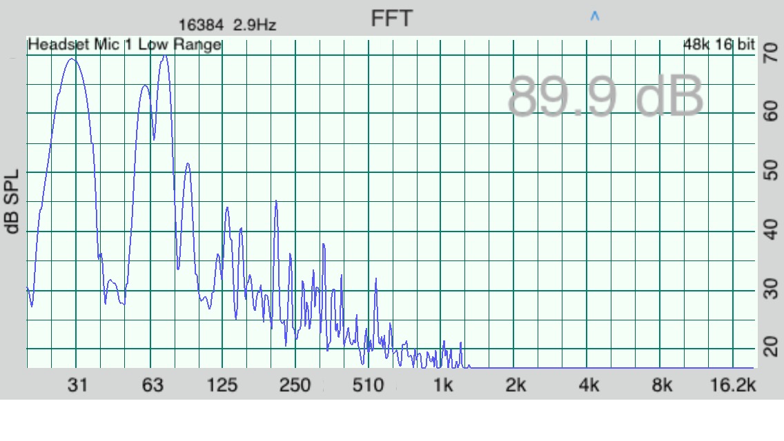

The next few posts are a study in Intermodulation Distortion (IMD).
IMD is a test done with two or more tones and when played through a speaker it will produce tones that are non harmonically related to the signal. I feel IMD tests are a more real world test that will mimic how a speaker responds to music more so than a standard harmonic distortion test.
For the IMD test I choose tones at 30hz and 72hz. These tones do not share any harmonics, which is important so that there is no cancellation of distortion products.

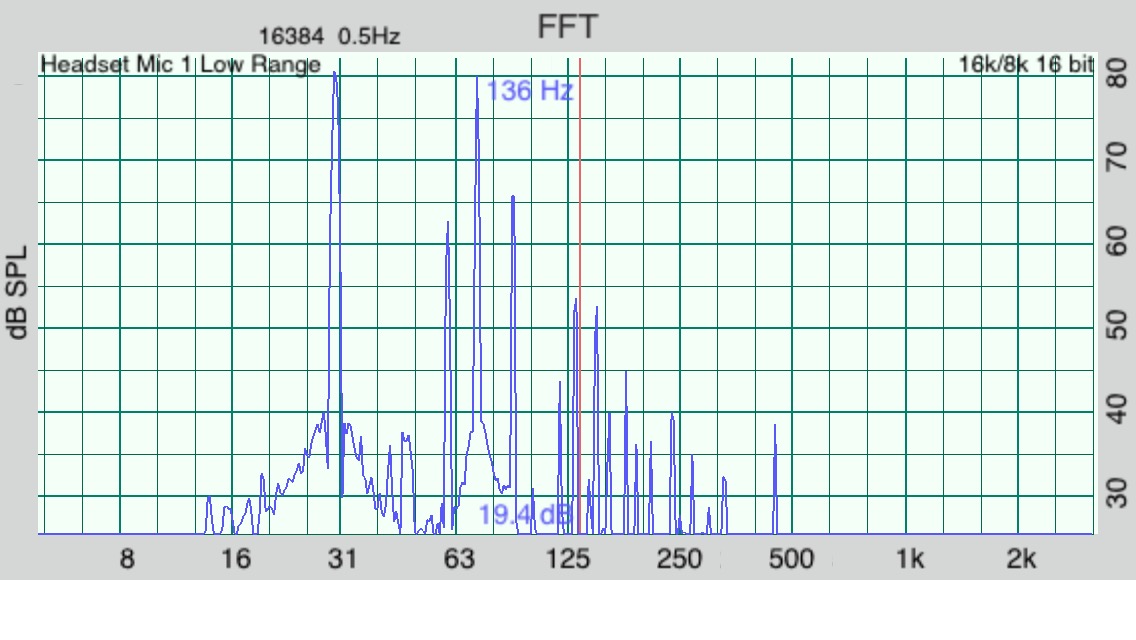

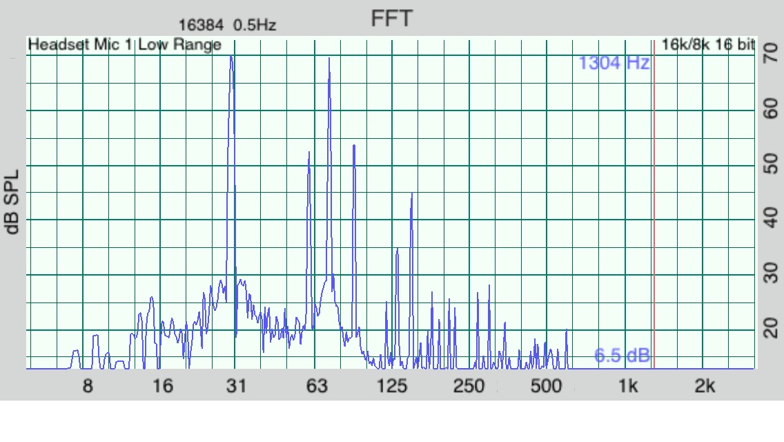

First let's look at the 30hz.jpg a SB34NRXL75-8 playing a 30hz tone at 70db. We see harmonic distortion products at 60hz and 90hz and some higher order distortion as well. Then look at the 72hz.jpg a single tone at 72hz we see harmonic distortion at 144hz and then most everything else is at the noise floor.

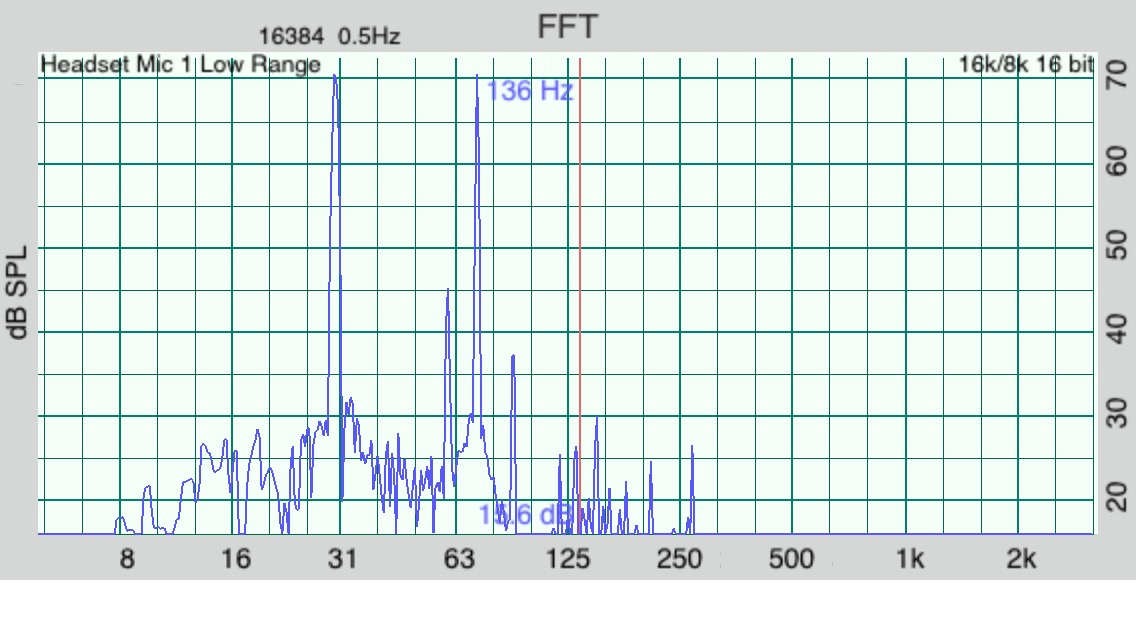

Next take a look at the SB30&72hzIMD.jpg this is two tones at 30hz and 72hz playing at once. The harmonics from the previous 30 and 72hz single tones are still present as well as a spike at 132 hz. This 132hz tone will stick out to ear as something that is not right or not musical. However, you will see in the next post that this is one of the better results.
Based on some IMD calculators there are other IMD products that will be produced but after testing a few drivers with these tones the 132hz spike is the most prominent one so I will focus on this.

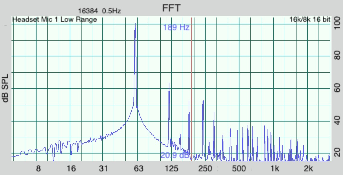

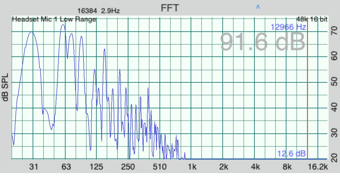

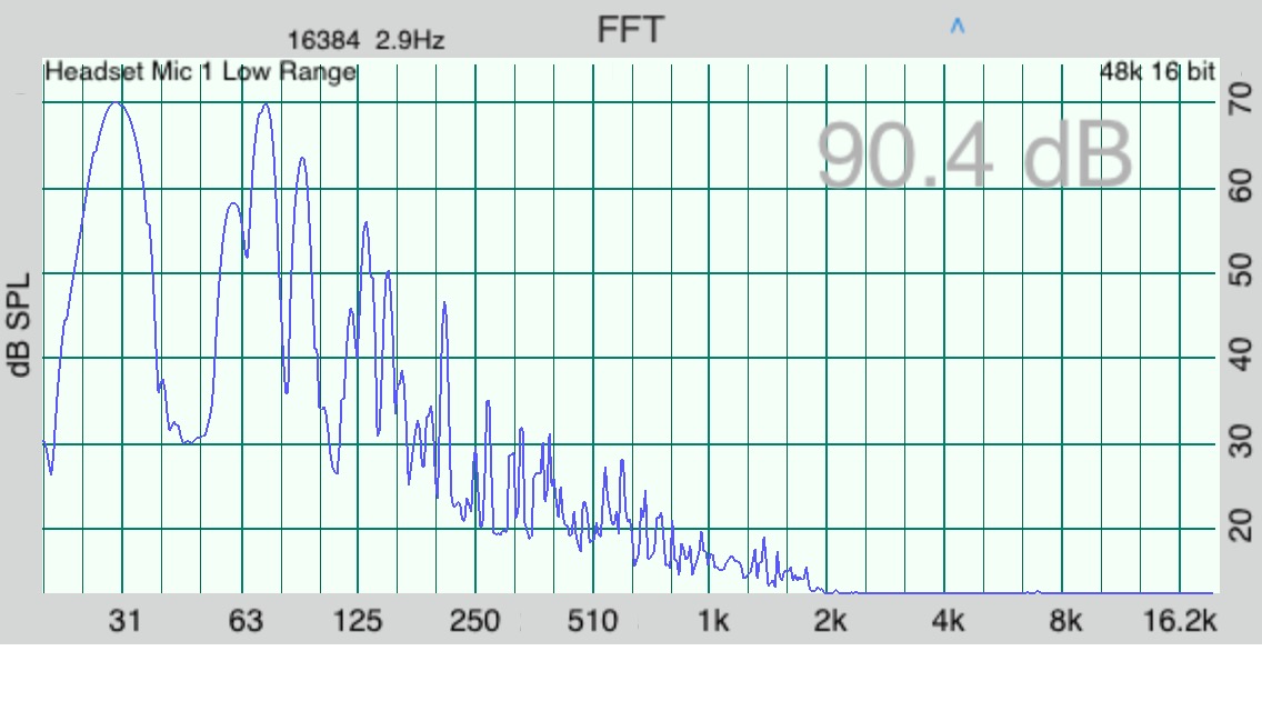

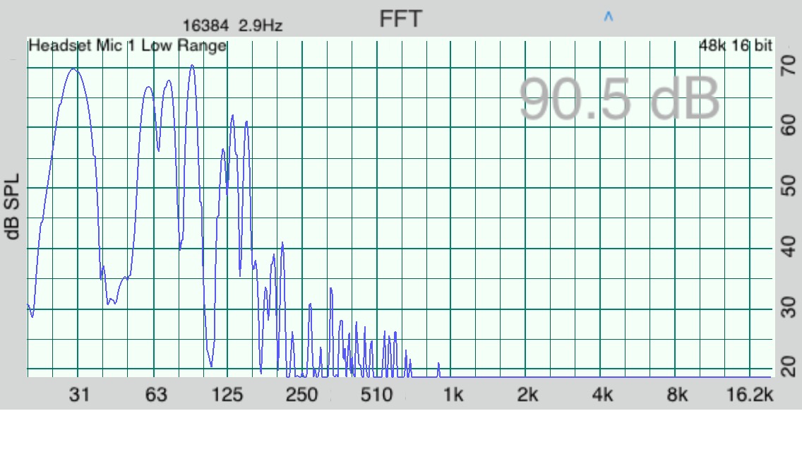

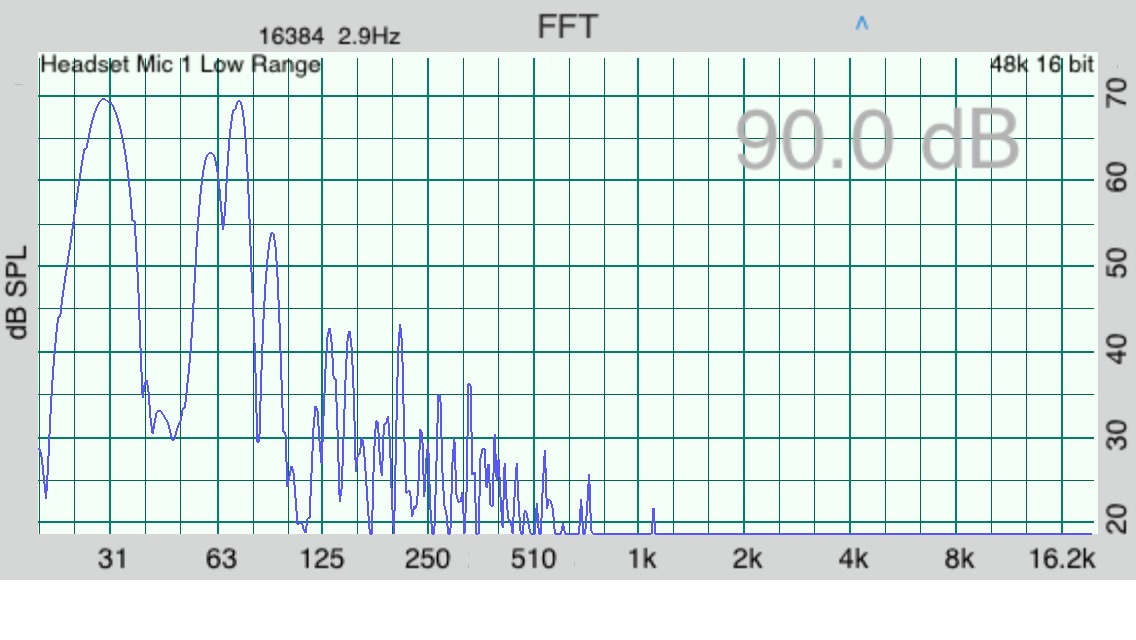

Sealed box 70db IMD comparison
Here is a compilation of IMD results for all drivers I was able to test.
Same as the harmonic distortion tests this is an in room measurement 4 feet from the speaker, the room definitely effects the results, but as the speakers see the same measurement conditions comparisons can be made.
The test is a 30hz and 72hz tone with all drivers in a 85 liter sealed box. I will list the drivers from best to worst with the level of the 132hz IMD product below 70db
Peerless XXLS 830842 -44
Acoustic Elegance SBP-12a -36
SEAS L26-X1001-04 -35
Audio Technology Flexunits 12 B 77 25 10 -35
B&C 12FG100-4 -32
SB SB34NRXL75-8 -31
Wavecor SW312WA03-01 -28
Eminence Lab 12c -25
Radio Shack 40-1350 12" DVC -22
DIYSG Magnum -15
GRS 12SW-4 -8
IMD graphs attached
If you read articles such as the Klippel causes of distortion you will find the drivers with a minimum change in inductance vs excursion will have the least IMD distortion. This is seen in my results as the Audio technology and Acoustic Elegance have shorting sleeves to linearize the inductance over excursion and as far as I know the Radio shack and GRS do not have shorting rings or sleeves.
From my listening tests I found that the drivers that did well in this IMD test are the same drivers that sound well as the music gets complex and there is a lot of simultaneous low frequency energy.
The peerless xxls was the surprise winner, especially considering that it is only a 10" driver. The aluminum shorting ring and aluminum spacer on the pole piece have been put to good use. After that a pretty close 2nd place. Let's see what happens if we bump up the level to 80db.....

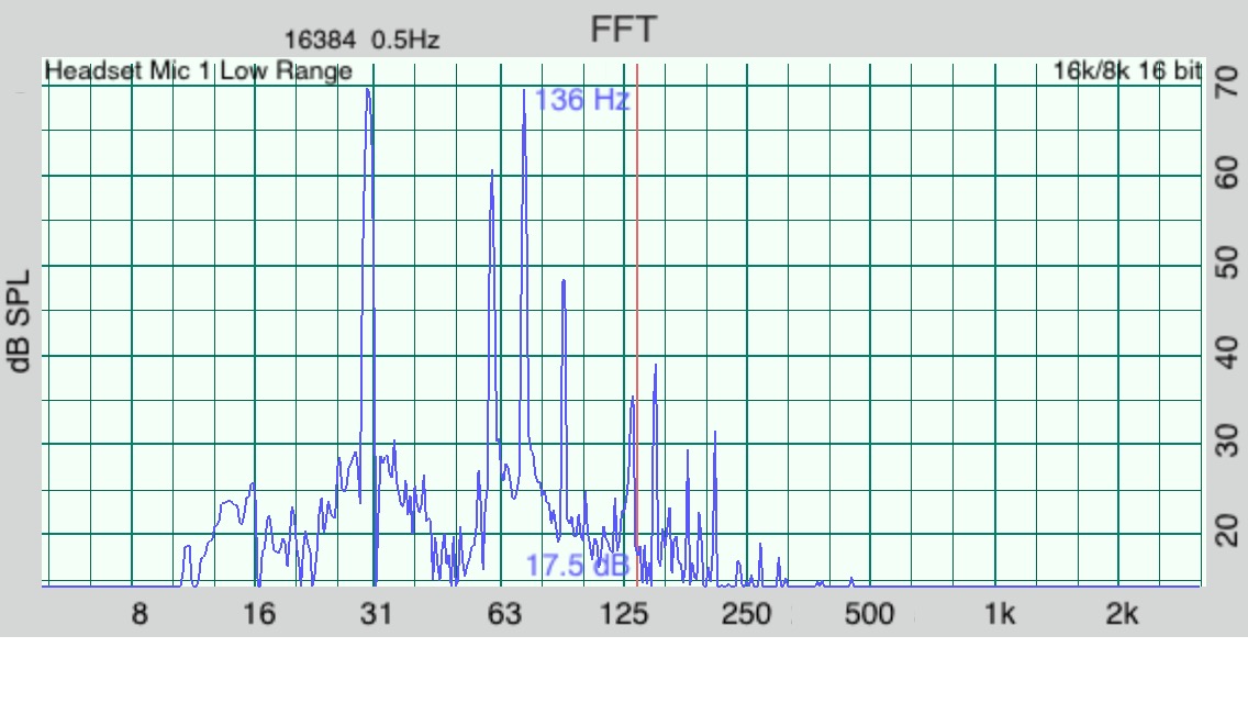

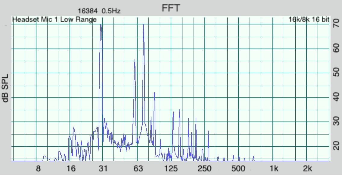

Sealed box 80db IMD comparison
Ok now for the same IMD test but bumping up the level to 80db. Some of the drivers didn't make it this far. My metric was to stop the test when the harmonic distortion overcame the level of the fundamental. With 9 feet ceilings I 'm getting a boost at 61hz so the 2nd harmonic at 60hz comes in higher than it would in an anechoic chamber.
Here's the results of the 30hz and 72hz IMD test at 80db in db below the fundamental
Acoustic Elegance SBP-12a -34
Audio Technology Flexunits 12 B 77 25 10 -30
Peerless XXLS 830842 -26
SEAS L26-X1001-04 -24
B&C 12FG100-4 -22
SB SB34NRXL75-8 -18
IMD graphs attached
As you can see the advantage of the greater cone area is seen here as the 10" XXLS are SEAS are losing position.

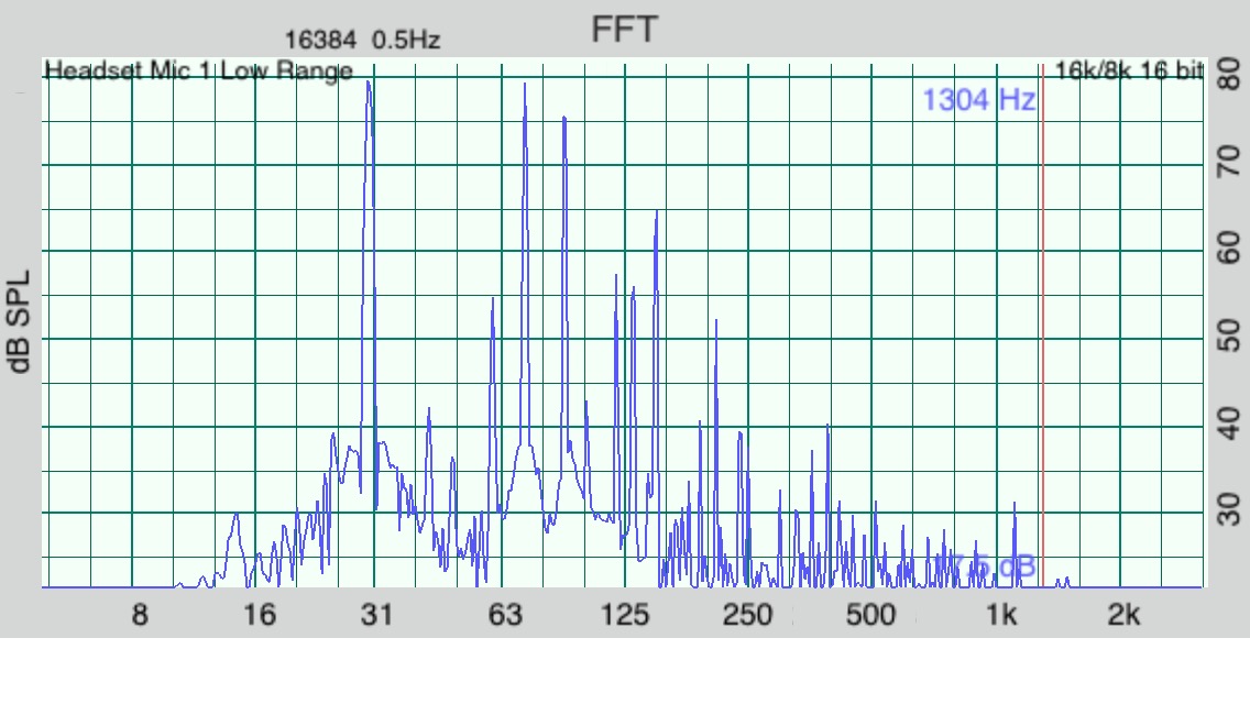

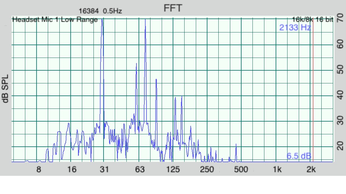

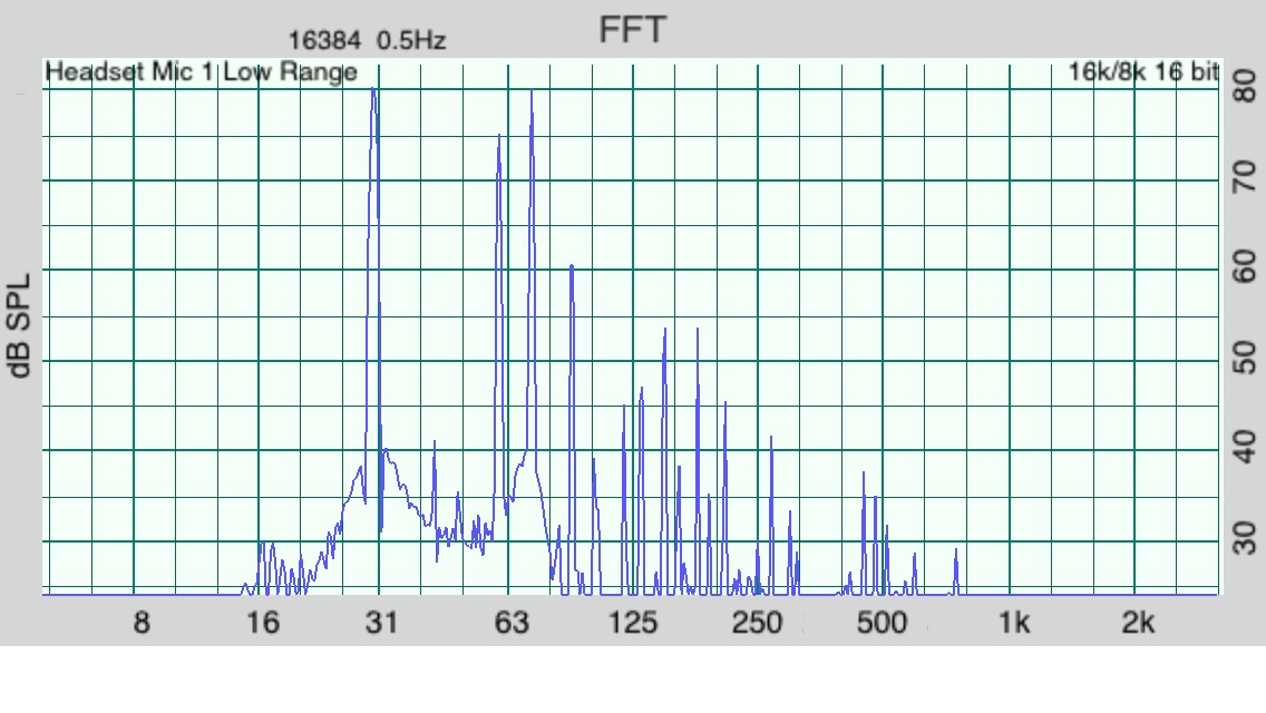

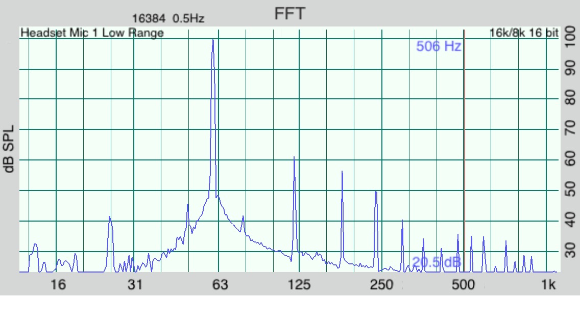

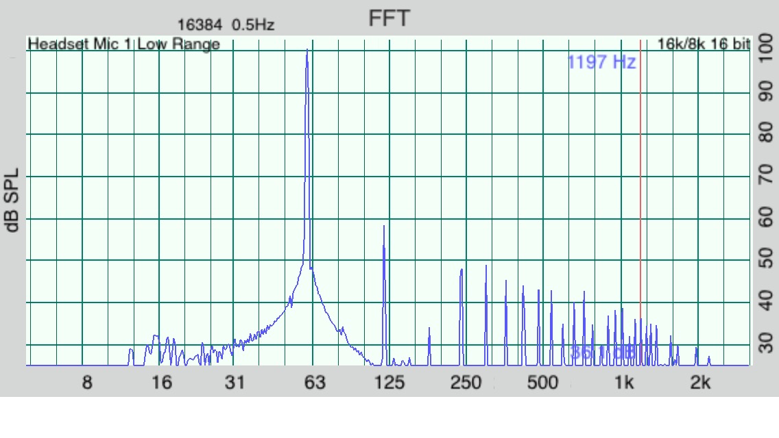

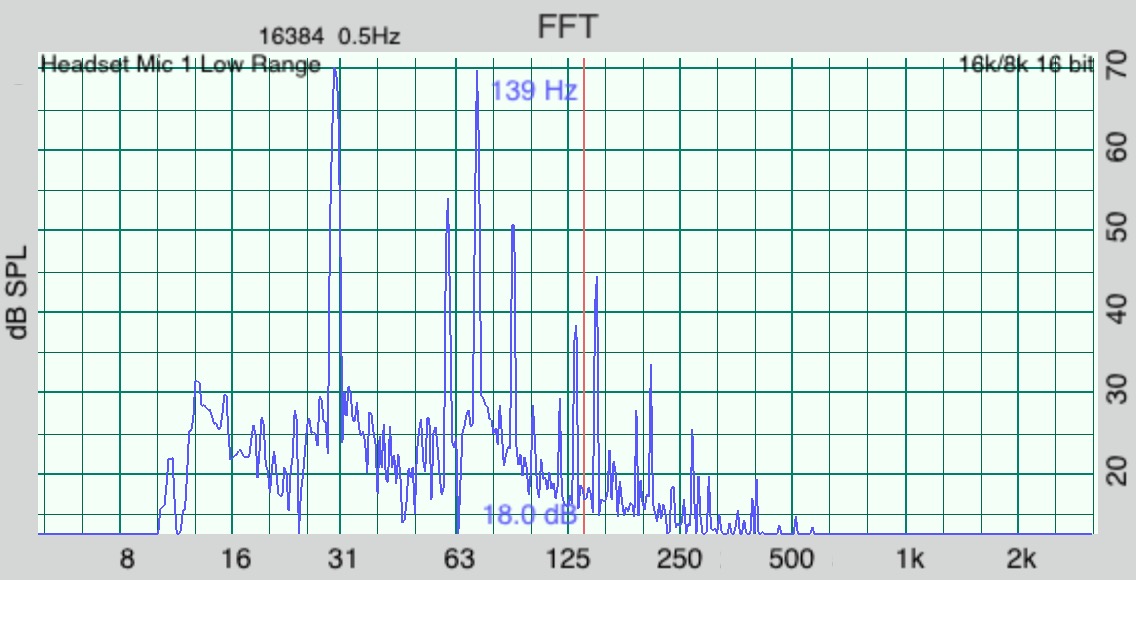

Here's the distortion measurements:
16 56 -36 -20
20 69 -32 -28
25 79 -38 -24
31.5 85 -26 -53
40 92 -23 -26
50 101 -31 -25
63 110 -26 -37
