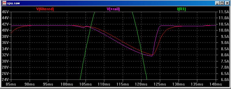

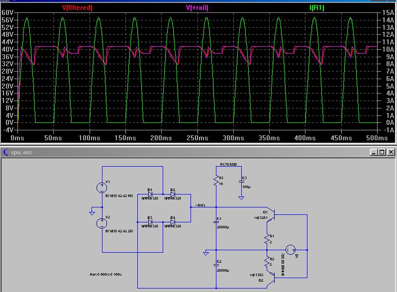

Pictured below is a screen shot of the sim I ran to investigate this.
It is basically a unregulated power supply connected to a class B power output stage to load the rails.
The green trace is the positive rail load current (at 20Hz) and the purple trace is the positive rail voltage.
The red trace is the filtered rail (15ohm / 100uF ~100Hz). As can been seen, 15A peak is not enough current to discharge 20mF fast enough to cause an issue with tracking.

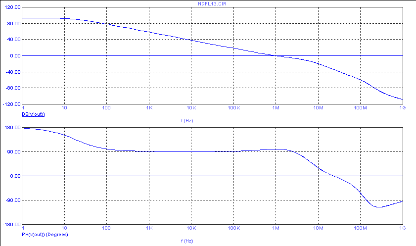

Edmond Stuart said:
NO! NDFL neither TMC does NOT overshoot and the global NFB loop doesn't dip.
Who is talking about overshoot? NDFL DOES cause the mid-band phase shift to dip towards 180 degrees just as TPC does. Do a loop gain probe on TMC and similar behaviour can be observed.
Edmond Stuart said:YES, but there is overshoot. Maybe not a problem for you, but I just don't like it.
And I've shown that overshoot about 5 times already. BTW, with a 1MHz ULGF a squarewave input bandwidth limited to greater than 350kHz is required to generate any overshoot.
I don't know of many audio sources that will excite this.
Also, I've decided to live with the overshoot, as a 500-1000 ohm resistor at the amplifiers input (for the low-pass filter) introduces too much hum and distortion.

EDIT attached below is the loop gain / phase for my Cherry style NDFL amp, as discussed here:
http://www.diyaudio.com/forums/showthread.php?postid=1770209#post1770209
NDFL doesn't cause the phase to dip??

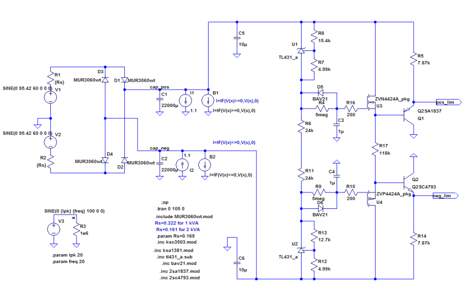

Re: Re: sudden supply drops
I was looking at something like the pic below. Not sure what you mean about headroom. Sure, it's reduced by the ripple amount, which is what you pay for the ripple not being superimposed on the clipped portion of the waveform with clipped low frequency signals.
G.Kleinschmidt said:For this scheme to work, you need a rather large value resistor, which drops a significant voltage (say, at least 5V under normal operation)
So there goes your headroom!

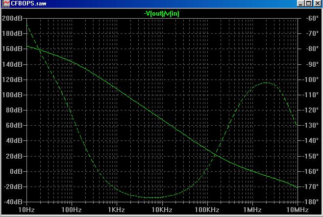

TMC
Yes, Sir! Yes.
Below the global loop response of a blameless amp with TMC.

Re: TMC
When did I say "global"?
Yes, Sir! Yes.

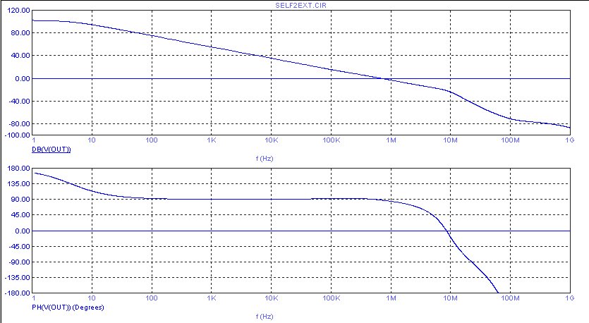

Re: Ndfl+etmc
This is not a phase response of NDFL.
Edmond Stuart said:And here the global loop response of an amp with NDFL+ETMC.
In both cases I got NO overshoot and there is no phase dip around 30kHz or so.
Edmond.
