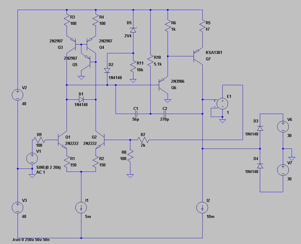

G.Kleinschmidt said:OK, but you still need to add a diode to your VSOP amp active clamp to stop Q2 from saturating, here:
That would be a safety net, however bipolars do not saturate at Vcb=0.7V. Not much of gain there 😀 but definitely not the point at which a transistor needs time to recover. BTW, it works great on the breadboard 🙂

Who said that transistors saturate at 0.7V?
If the anode voltage of D5 is to be limited to the base voltage of Q2 then the base of Q6 must referenced two diode drops below the base of Q2 (to account for VbeQ6+VakD5). As drawn in your schematic, you only have it tied one diode drop lower.

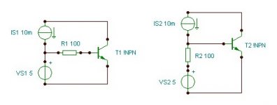

However, there is a nonnegligible difference between the resistor placement below.
Are you really convinced about the superiority of two-pole compensation?

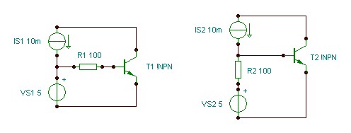

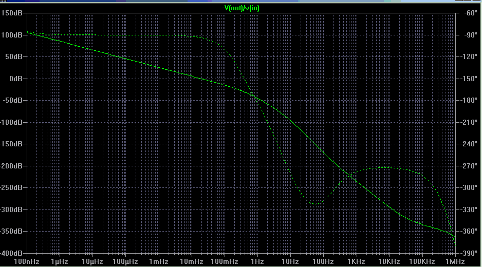

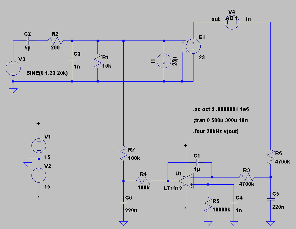

And here is the servo loop phase margin. There are 3 LF poles in the servo loop (4 including the interaction with the 5uF input coupling cap) giving a great deal of attenuation at audio frequencies.
The unity loop gain frequency of the servo loop is 18mHz. The phase margin is 94 degrees and the gain margin is a healthy 43dB. These figures do not change significantly with the input unterminated.
Revised clamp
Attached is a simplified schematic of some further (final) revisions I have made to the LTP diode clamp for this design.
This version does not need a trimot (which I really dislike) to balance the LTP collector voltages (which are no longer critical at all) and eliminates the clamp diodes as a possible source of non-linearity by running them (a-k) reverse biased by several hundred mV.
The limited/peak VAS current during clipping is now clamped by D2 and D5.
D1 remains as the current mirror anti-saturation clamp, which reduces the sticking time of negative rail clipping slightly.

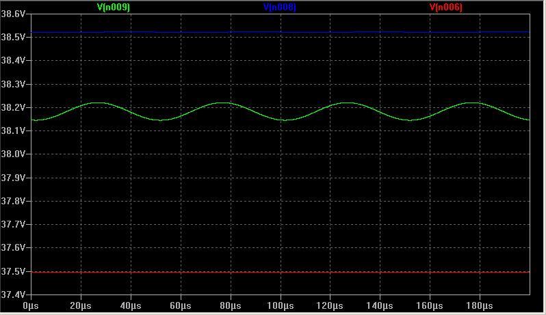

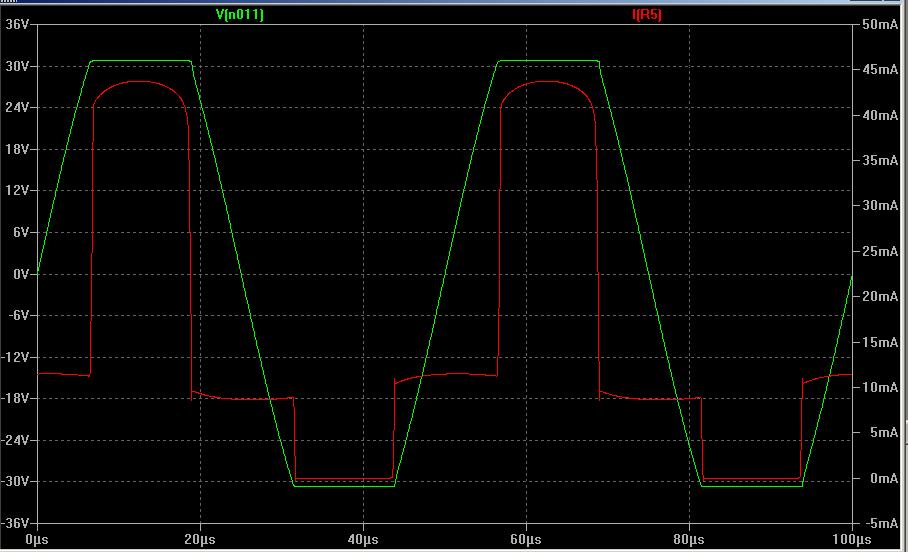

These plots show the relavant voltages across clamp diodes D1 and D2 during normal operation (in this case delivering a full amplitude 20kHz sinewave output without clipping).
The green trace is the base voltage of the emitter-follower VAS buffer Q6.
The red trace is the anode volatge of D2 (reverse biased ~700mV)
The blue trace is the cathode voltage of D1 (reverse biased ~300mV).

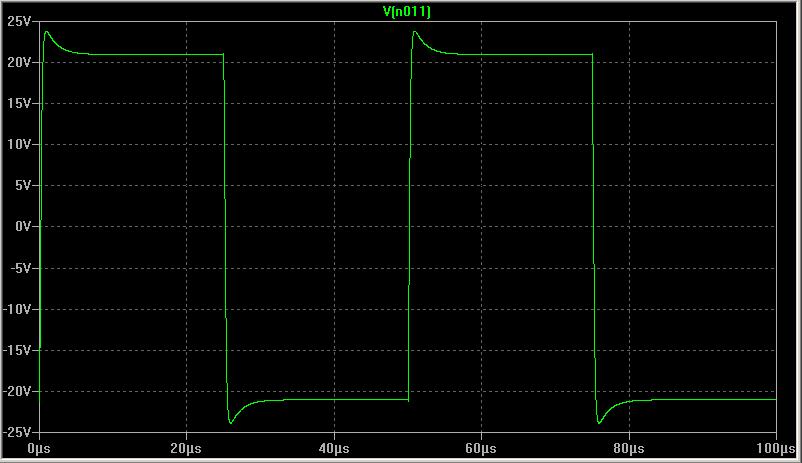

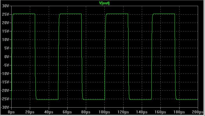

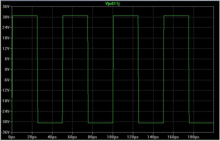

And finally, just for good measure, here is the response when driven into clipping with a 20kHz square wave. The overshoot is no longer visible as it has been chopped off,but even under these adverse operating conditions, the transient response is still as clean as a whistle.

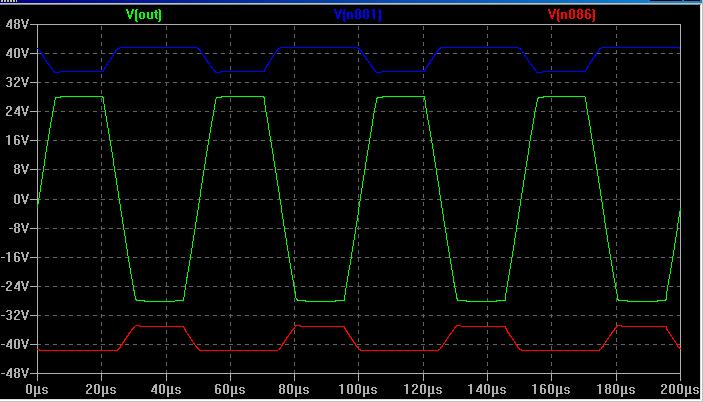

Yes, I'm using separate rails for the CFB OPS and the input stage/VAS, which means that the VAS clamping arrangement is a little different.
The problem with the nfb clamp and the unipolar VAS is that while the VAS transistor can supply all the current the feedback network requires on positive clipping, the current on negative clipping is limited to the VAS CCS current.
I was worried about the VAS voltage clamp referenced to the power output stage rails feeding high frequency switching spikes via the diode junction capacitances into the VAS output, but the issue is rather small and can be, for all practical purposes, completely eliminated with just some light RC filtering between the OPS supply rails and the VAS voltage clamp.
A LF pole of one hundred Hz or so is ample and the clamp will track any supply rail droop occuring with any bass transient.
