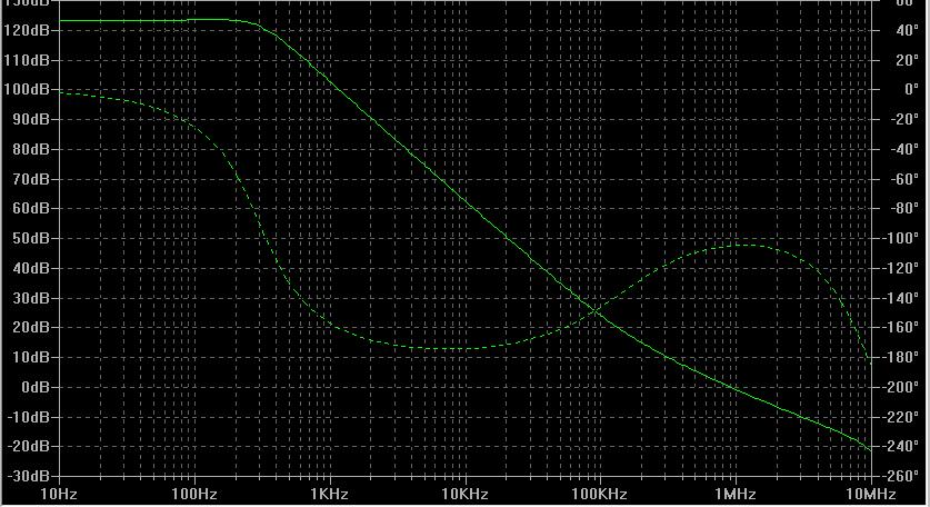

Hi, here is the loop gain plot. There is a small peaking but it starts rolling off a lot earlier than 20kHz!.
The roll-off starts at -12dB/octave (2-pole), accumulating approximately 180 degrees of phase shift, reverting back to a single pole response (-6db/octave, ~90 degrees) at approximately 1/5th the unity loop gain frequency.
Glen

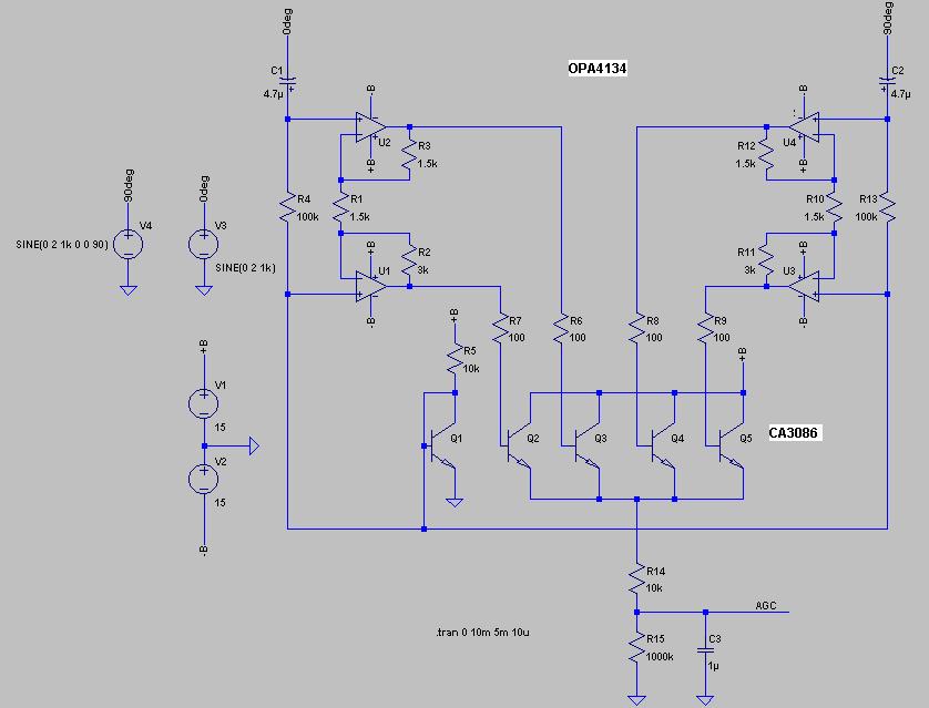

On an entirely different note, here is my 4-phase rectifier for the AGC loop of the State Variable oscillator. Uses one OPA4134 quad jfet input opamp and one CA/LM 3086 five NPN trannie array.
For the 4 opamps that make up the state variable oscillator, I'll use a pair of LM4562 duals.
Glen

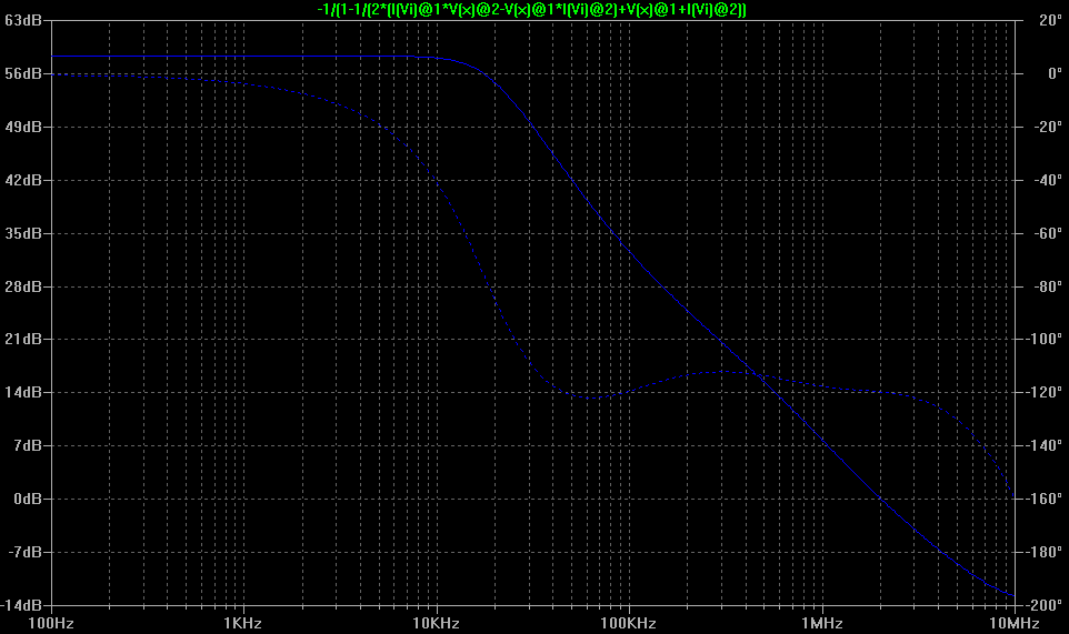

Thanks for the reply. Wow thats a lot of open loop gain! Looks similar to my 2 pole plots. One more question: Dont you measure the phase margin as the minimum margin before the 0db crossing, ie. about 10 degrees? Do lower freq square waves ring? or does the large amount of feedback take care of these prolems? Sorry for all the questions but I have been trying to figure out a way to get rid of this first phase dip; am I wasting my time?
phase dip
Most likely only overshoot, so no ringing
No.
Use TMC instead of TPC.
It depends on your goal. TPC lowers the distortion from the VAS and the OPS, while TMC only reduces the distortion from the OPS.
Edmond.
cbdb said:Thanks for the reply. Wow thats a lot of open loop gain! Looks similar to my 2 pole plots. One more question: Dont you measure the phase margin as the minimum margin before the 0db crossing, ie. about 10 degrees? Do lower freq square waves ring?
No.
Edmond.
Maybee Im looking at this the wrong way. In Glens loopgain plot, I thought the almost positive feedback with alot of gain between 4k and 20k would make it unstable, why not? Isnt the phase margin only a few degrees?
I don't like that small phase margin either. But what really matters to prevent spontaneous oscillations, is the phase margin at the unity loop gain frequency, normally at 1...2MHz.
Edmond.
Edmond.
