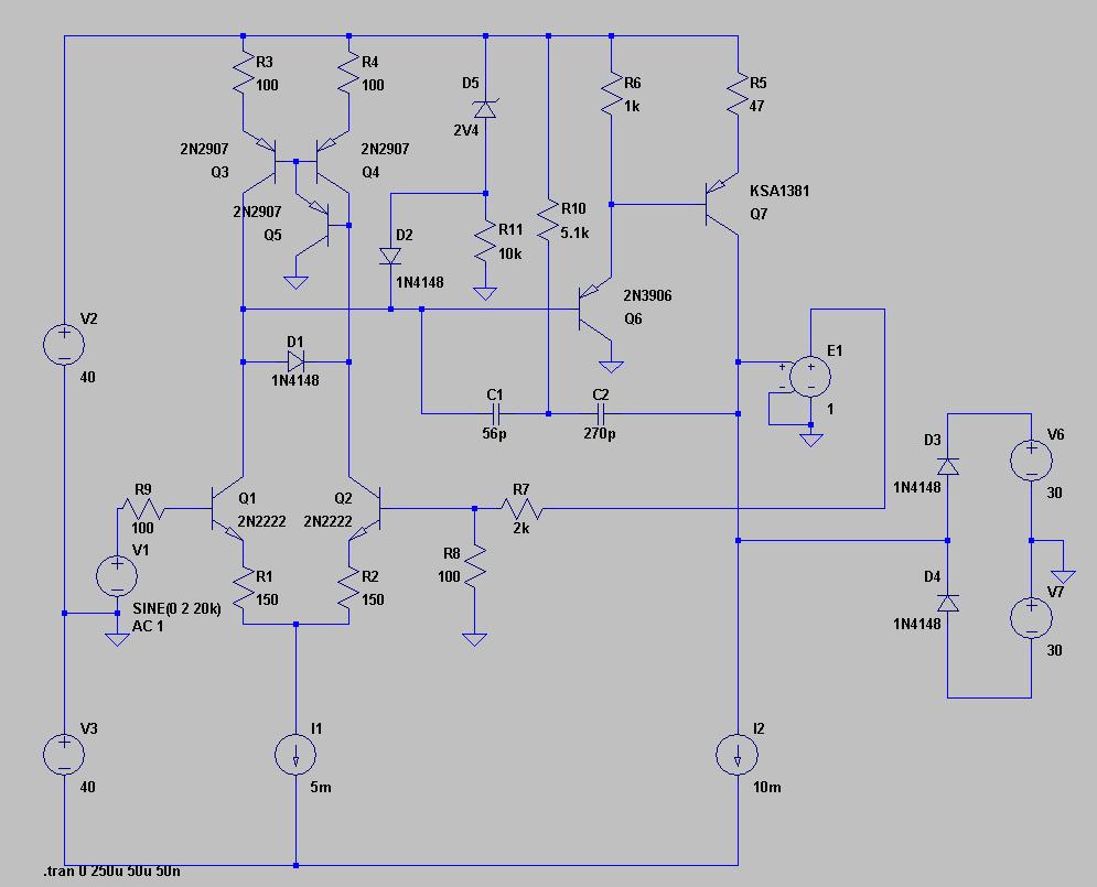

With regard to post 33, can somebody tell me what Q5 does. With the usual current mirror, Q5 is normally just a piece of wire.
My thought is that using Q5 equalises the Vce of the current mirror transistors. Am I correct?
Also are V6, V7, D3 and D4 required in order for the circuit to clamp properly.
If not, why are they there?
It is a current mirror with a beta enhancer which will mirror within a few nanoamps, my friend.

Hi
The schematic in post 33 is very simplified (ment for simulation only), so you should have a look at some of the other schematics to understand the circuit.
Q5 is a so called "helper" transistor. BTW: it should have been a resistor from the emitter of Q5 to Vcc, I guess Glen just forgot to put it there. 😛
D3 and D4 are clamping diodes, forget about V6 and V7, they are just meant for simulation (see the other schematics in this thread)
Hope it helped

Thanks ostripper,
Simulations suggest that it clamps just as well without Q5 (replaced with a piece of wire), although D1 is now reverse biased typically 0.5V, depending upon the value of R5. Have you any reason to sugggest the circuit would not work as well without Q5?

Simulations suggest that the current through Q5 looks ok without any additional resistor (presumably you meant in the collector, not the emitter?).

Almost as well. Q5 just improves the mirror a bit, hopefully improving DC offset a little, maybe reducing distortion a little...Have you any reason to sugggest the circuit would not work as well without Q5?
The resistor Stinius suggested is to get some extra current flowing through Q5 to improve it's performance e.g. current gain and speed.
btw: D1 and D2 are to limit the voltage swing at the base of Q6.
I now understand why Stinius said a resistor from emitter of Q5 to Vcc - give it more current.

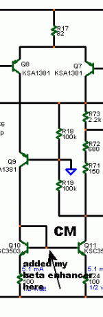

I don't know , but when I used the beta enhancer on the CM of my balanced VAS (symasym type VA) It nearly broke out in oscillation.
Upon investigation in the simulator the VAS as a whole achieved 6db more OLG.
and it's unity gain point advanced by a couple hundred Khz. Upon removing the 3' rd tranny and resistor , all was stable. ???
OS

you know... the symasym VAS (VA) , with its current mirror at the bottom. Standard stuff. 🙄
Ok.. picture..(below)
OS
Please, come on!you know... the symasym VAS (VA) , with its current mirror at the bottom. Standard stuff. 🙄
OS
BTW, "standard stuff" don't oscillate with a slightly improved current mirror. 🙄
Weird indeed, but...
I'd expect the performance of the mirror in post 117 to be dismal without a cascode on Q11.
DC voltage on the collectors of Q10 and Q11 is badly mismatched and Q11 has full output voltage swing on it's collector. (Consider Early effect, Miller effect etc)
The 6dB increase in overall gain at HF is probably just the result of bringing the mirror from near death back to normal operation.
e.g. Having the helper transistor drive Q11's Miller capacitance is a big step forward.
