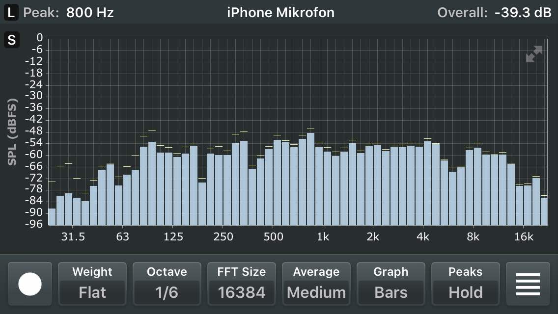

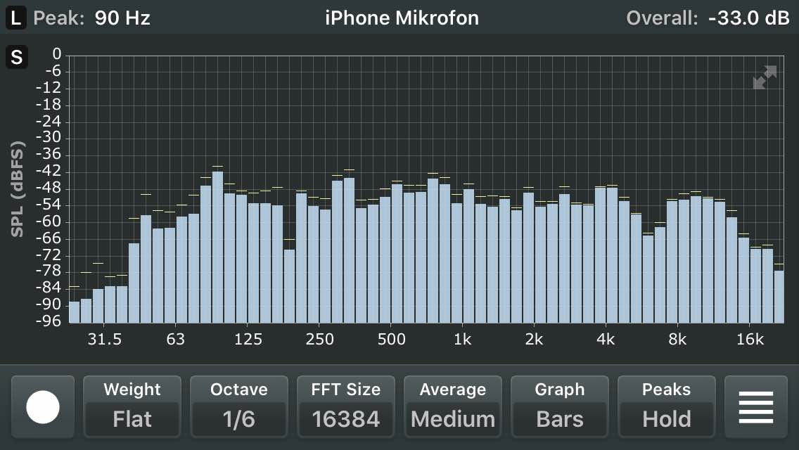

yesterday one speaker on Swap (honeycomb cardboard) mounted.
The panel measures 390 x 810 x 13 mm and the weight is 480 gr. The exciter (Visaton EX 60 R / 8) is mounted slightly off the center in the diagonal. The clamp is made with MDF and one thin woolen felt jacket used for damping.
The soundstage is amazing. The sound balance I'll try to improve ; )
Pictures show the speaker with clamp, pink noise at 30' and 10' (approx)

details about the frequency chart (10 inch distance / peak hold):
- 82.9 dB/35.5 Hz
- 41.6 dB/90 Hz
- 69.8 dB/180 Hz
- 44.1 dB/315 Hz
- 64.6 dB/5.6 kHz
- 65.5 dB/14 kHz
100ohms
The dip at 180hz can probably be filled by sliding something like an AA battery around the panel surface until the cancellation spot is found,wouldn't be surprised if this was going towards the top left of right corners from the exciter ,but it's different for every panel type,so check the whole panel.
The dip at 5.6k might be filled by using my strip of paper technique,by sliding a 1inch strip of paper across the exciter central point,usually when one edge of the strip of paper, is on or near the centre of the exciter coil,while monitoring the response in the exciter area ,this will also alter the HF,try to get a flat response.
Hope this is of some help.
Steve

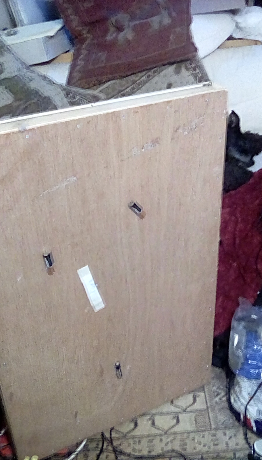

The frame I use is quite substantial 2 1/2 x 1/12 inch studwork ,it was very cheap,a more expensive harder wood would have been better.
Extra bracing on the larger panels(first pic).
So this could be a problem for you?
Although if you have enough clamps you could test?
Steve

100ohms.
Steve
