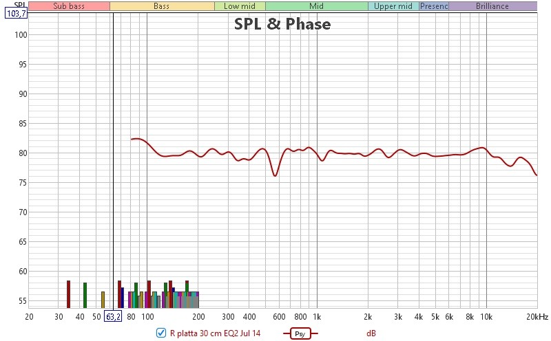

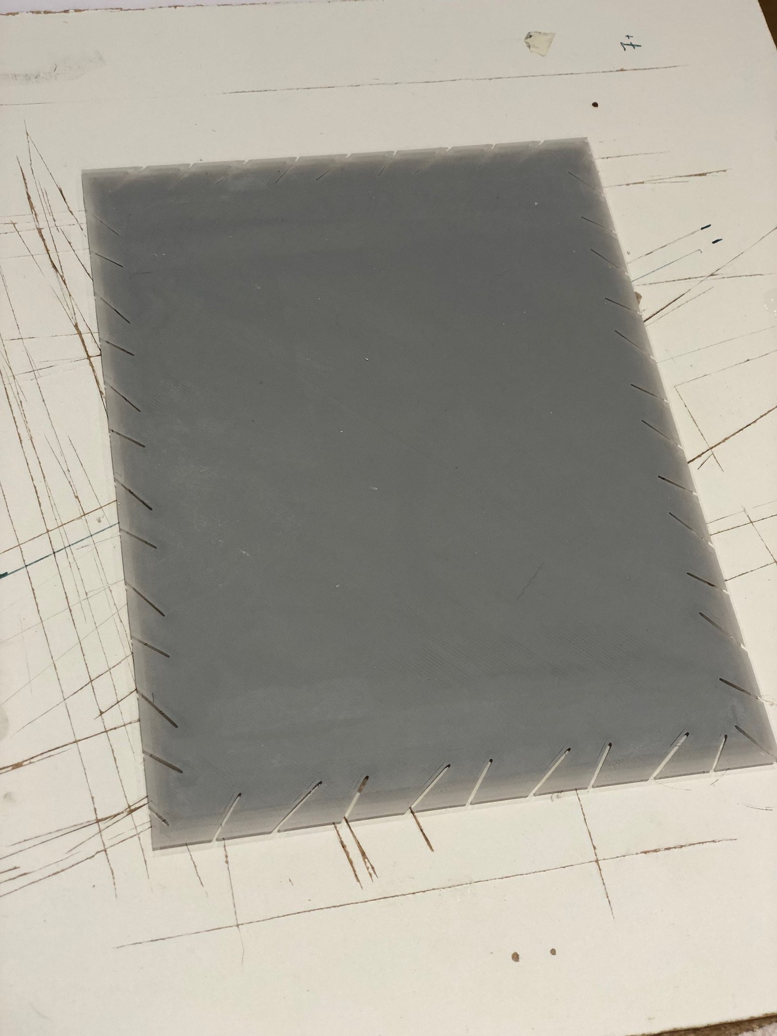

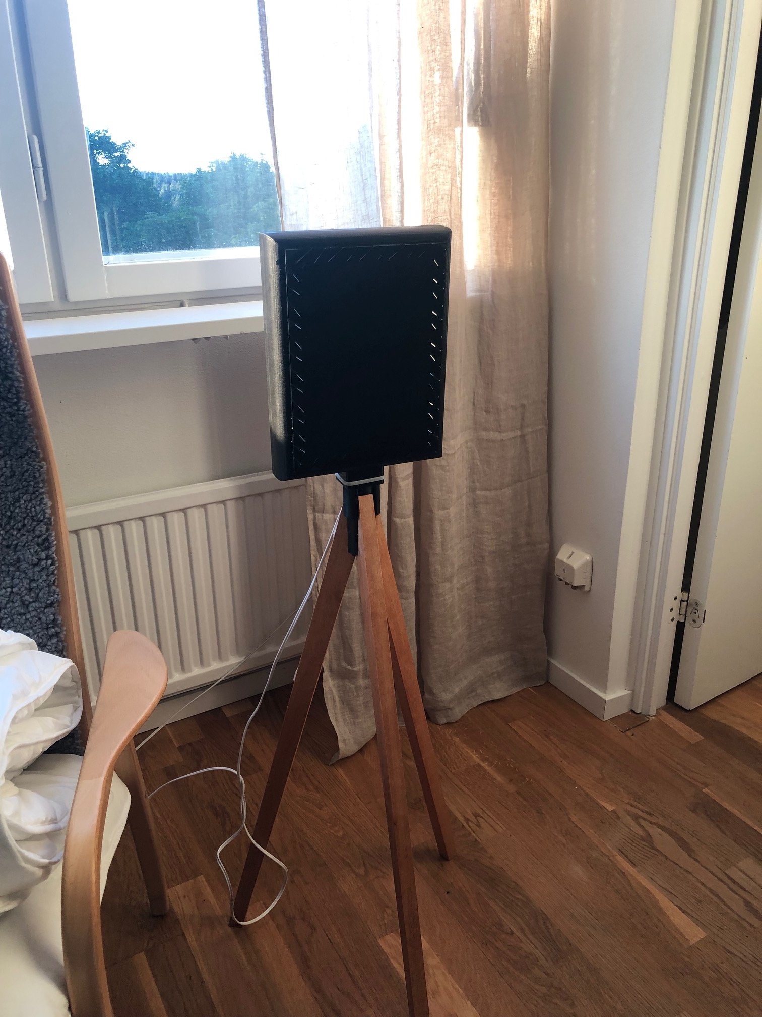

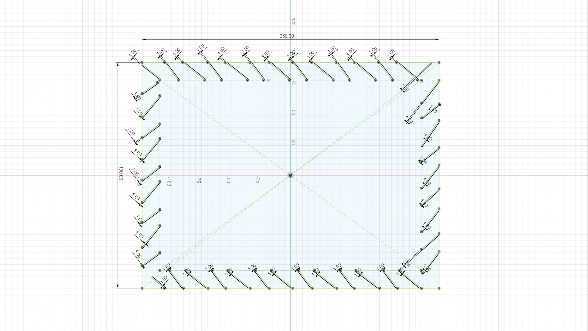

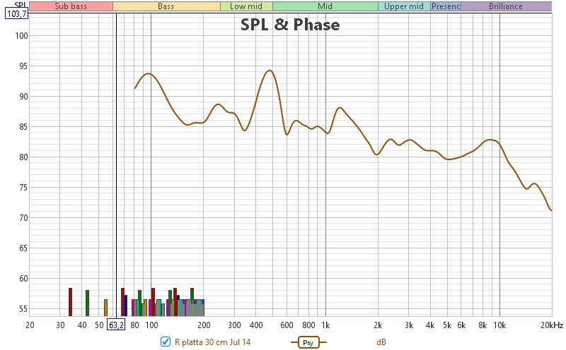

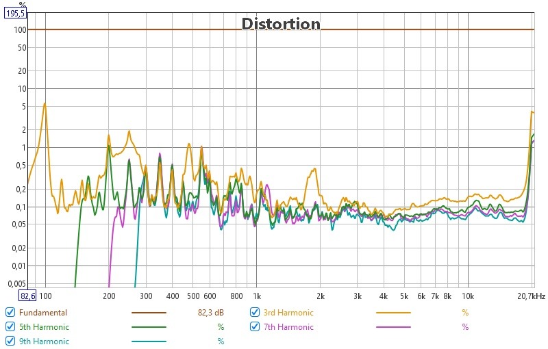

I've been testing 3D print panels with intresting results. I prefer to keep my speakers fairley small in order to use them in the living room without to much complaints...
I'm using simple PLA for the panel and frame, The panel has 20 % infill and the top an bottom layers are 0.2 mm. The layout of the panel is inspired by the Goebels high end bending wave. The frame is also 3D printed and filled with plaster for stabillity and weigth.
It sounds pretty darn good after a bit of EQ. I'm using Camilla DSP. I'm also using subwoofers below 100 Hz.
They are almost as good as my Carbon fibre panel with cross grain balsa core (2mm). See earlier posts.
I'm using a Tectonic exciter TEAX 25C05.

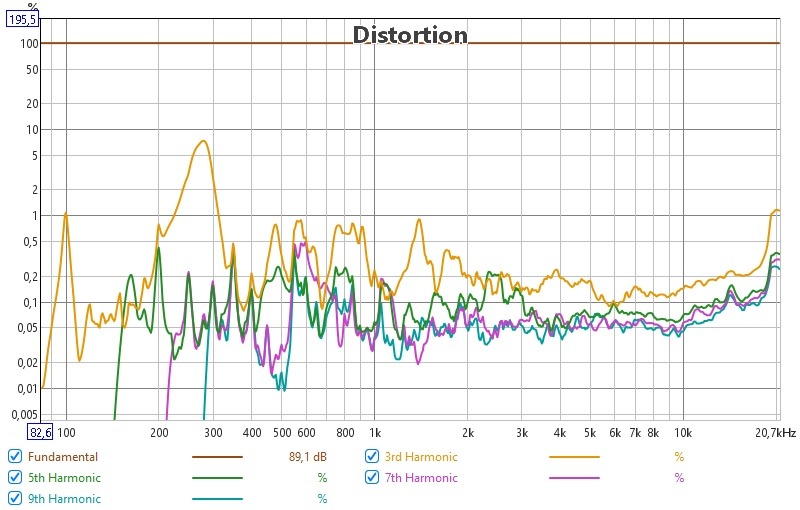

I've included 2 FR measurements and 2 Distorsion measurements. There are, as you can see, some resonances that needs to be controlled. This is quite easy with EQ as you can see.

Very nice Sandasnickaren! Response looks much better than I got with my attempts. I never tested them suspended though I realized now, which I think can make a big difference for the low end response. But you seem to get decent high frequency response as well. What brand of PLA? You have any idea about the sensitivity compared to something like EPS?
It’s Creality hyper PLA.
They are suspended on 2 mm EPDM foam. I’ve been using EPDM on all my panels.
I haven’t tried EPS lately so I can’t compare to those.
However the sensitivity is ok for my living room. I can do a measuremen of sensitivity after the weekend.

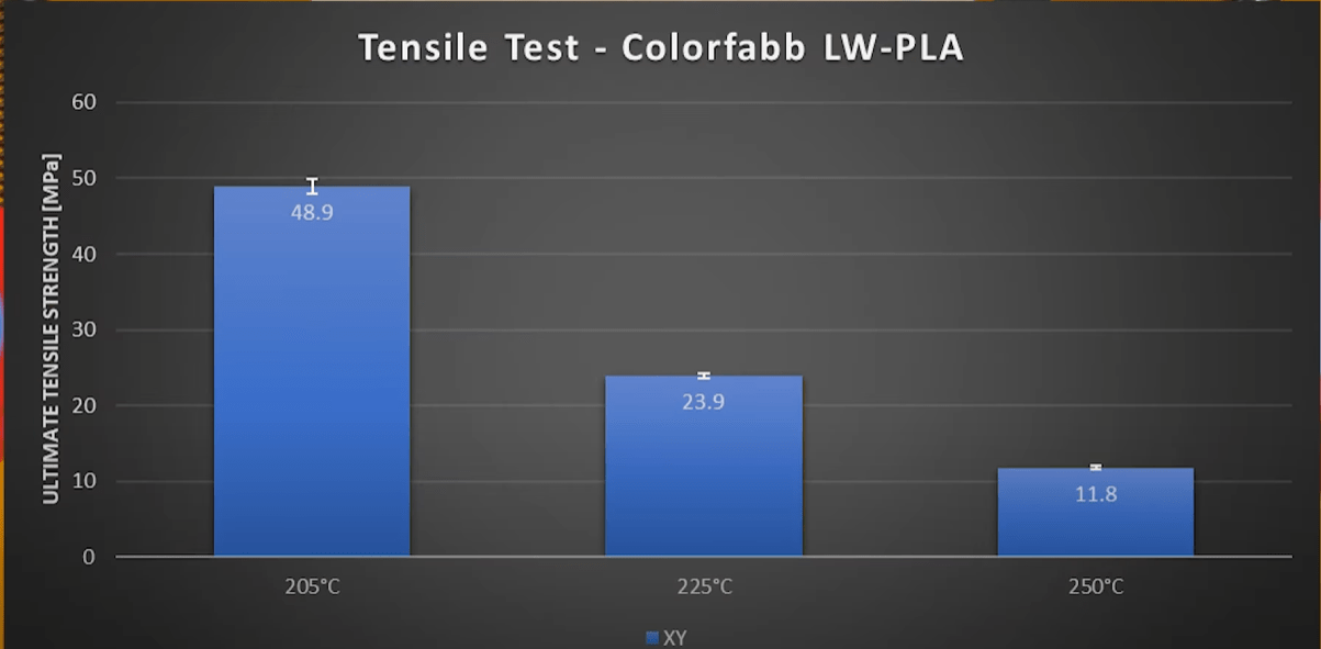

According to tests by Stephan at CNC kitchen, the LW PLA is a lot less stiff when you print at temps which gives around 50% density:
But enforcing it with a little resin seems can hopefully can get a stiffness to weight ratio that improves on regular PLA. Of course the infill cannot be treated the same way, and I think the LW PLA doesn't fare too well on its own when it comes to compressive strength either, so perhaps using regular PLA for infill would be preferable.

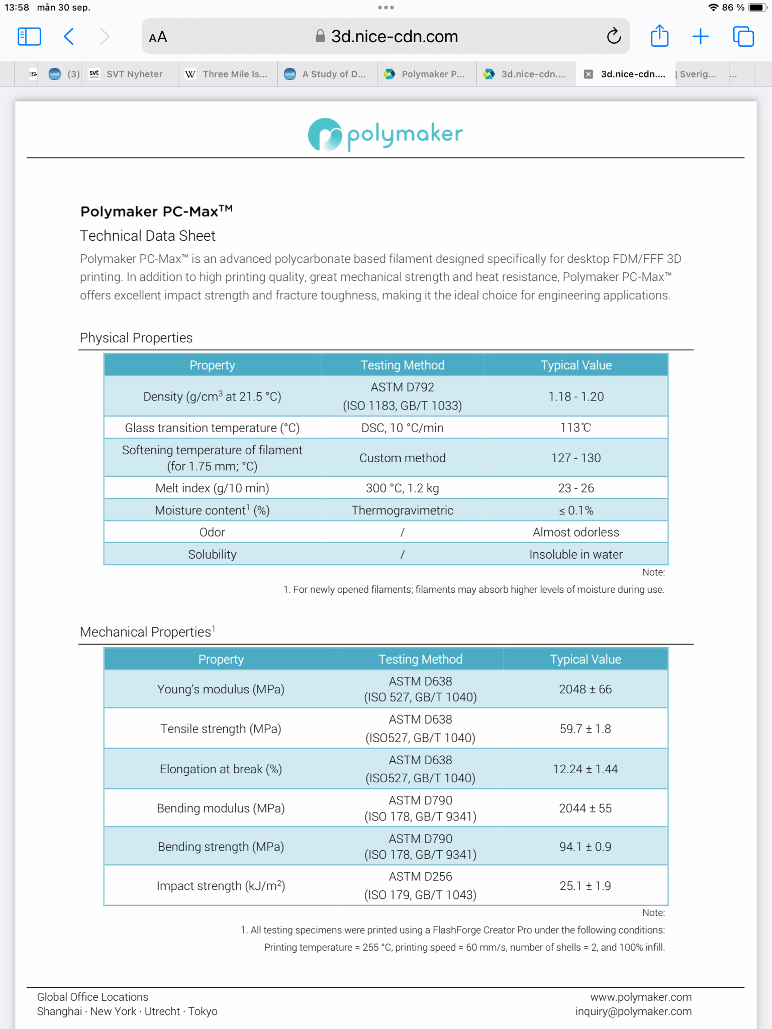

I think this material is worth a try
https://www.amazon.com.au/Filament-...7063f28249173bd99079e6e77d0facca&gad_source=1
(For the core)
Available in white also
Unfortunately, PLA probably can't stand the PC temperatures, so can't be printed together...Edit... Not so sure about that... There's a Reddit post where someone printed a PLA raft and then finished with PC on top

Thanks for the tip! Seems to be the same as available on Amazon.se...very affordable for a PC blend filament.
The LW PLA can print up to 280c, and I have a printer with multiple extruders to test on. Question is if the materials will bond. PETG and PLA does not, so works well to combine for rafts or supports that you don't want to adhere, but would be bad for this application.

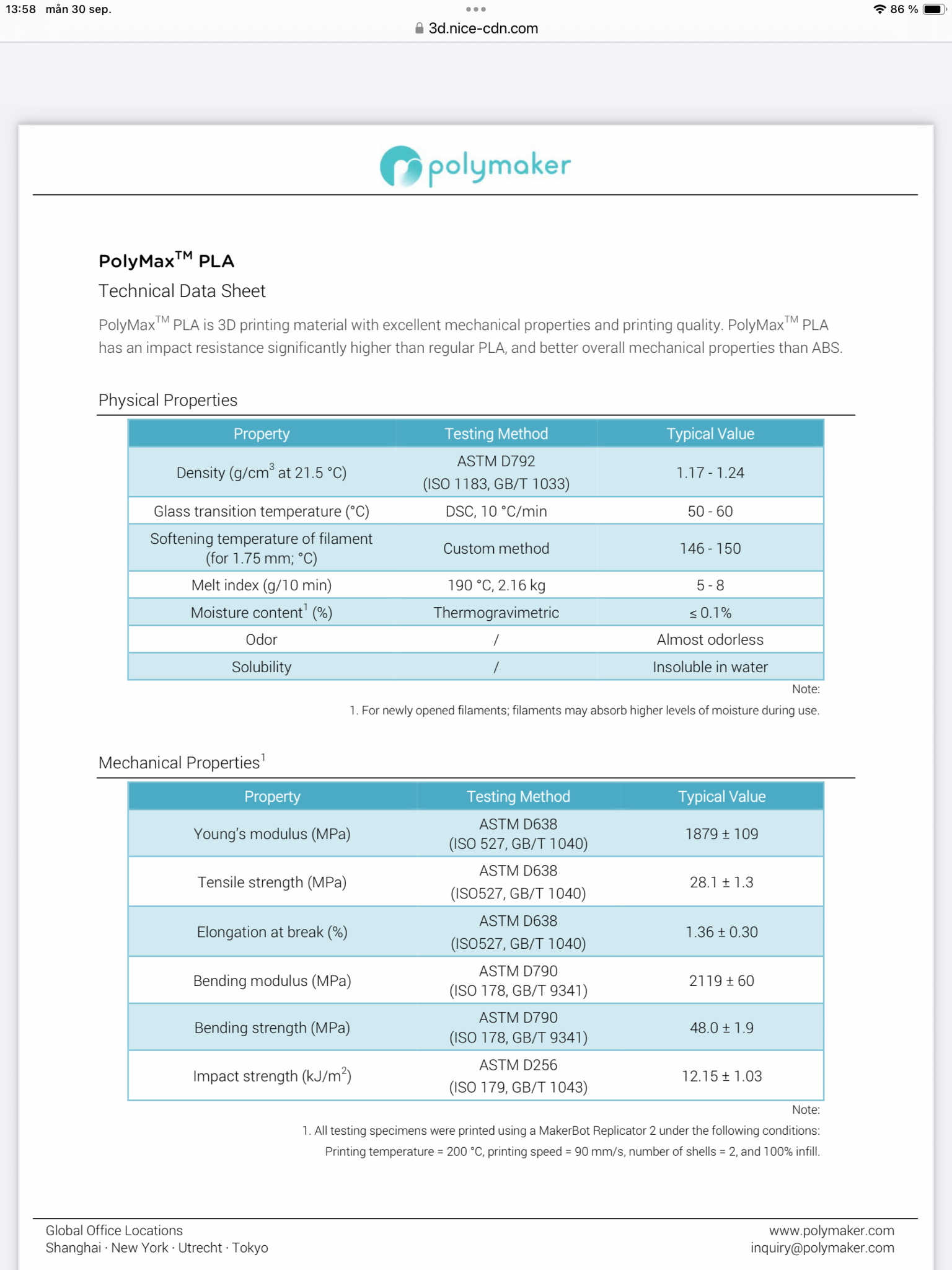

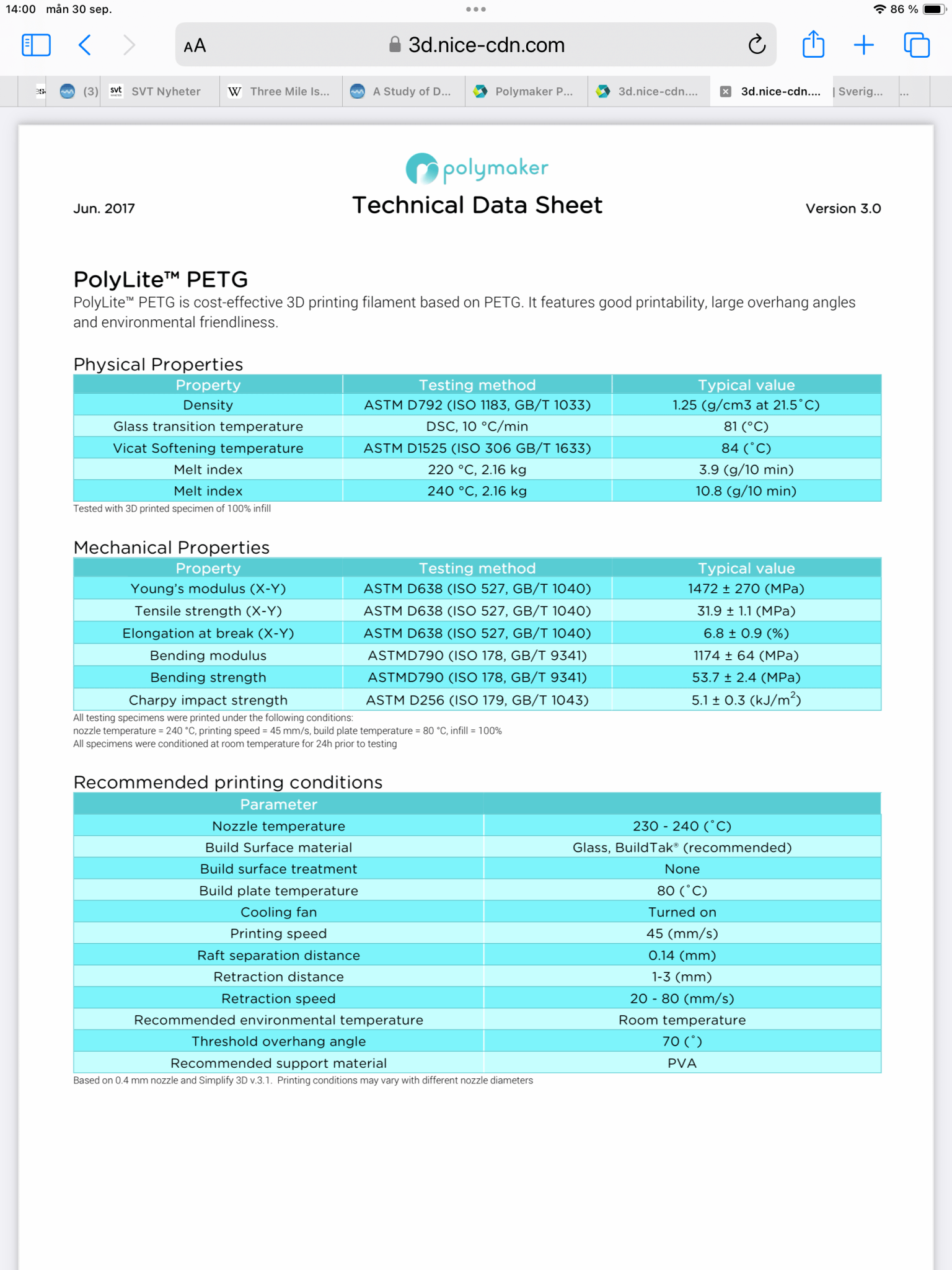

Some thougths on 3D printed panels/membrane
There are three different aspects to consider. One being the filament and its mechanical properties (young modulus, tensile strength and compression) secondly being the design of the panel/membrane i.e. the size, ratio and the thicknes thirdly is the printing properties i.e. the thickness of the skinns, the amount of infill and shape. Of the infill.
all of these combined will determine the mechanical properties of the Panel/membrane and how it sounds.
There are quite a lot of theory in patents and research papers on how to optimize a DML/Bending wave panel considering both size and mechanical properties. Unfortunately they are not really very conclusive And leaves room for experimenting.
I choose PLA for my first attempt as reported in earlier post the size, thickness of the panel, thickness of the skins and infill was based on my earlier experiences with balsa and carbonfibre. The interesting thing is that the 3D panel i less efficient compared to the CF panel but has a wider frequency response both low and high 80-20000. 3D panel does also generate a bit more distorsion.
I intend the continue experimenting with other material using the same design and printing settings in order to be able to compare the different materials. I’m planning to test polycarbonate, PETG.
