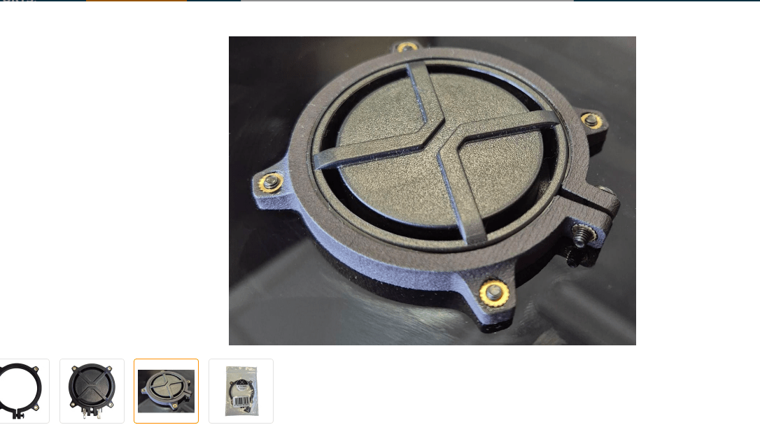

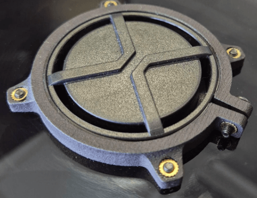

I see Xcite now have a mounting ring for there exciters, seems odd that the picture has it screwed to the panel it's attached too, I'd think that would constrain the movement and sound output?
They also have an 8ohm version which I guess could be good for other options of multi exciter panels.
It's attached to a bracing panel behind the driver, and not to the moving membrane.odd that the picture has it screwed to the panel it's attached too
I’m not finding those images on the website. Can you share a link or direct me to the menu item under which to find them?I see Xcite now have a mounting ring for there exciters, seems odd that the picture has it screwed to the panel it's attached too, I'd think that would constrain the movement and sound output?
The key point is to avoid the loose screws! The vibrations at the exciters are terrible. Strange design (but no other choice?) with one screw axis in the membrane plane in addition with metal insert.. In the bottom mounting (see the spec linked in the above Sound Import page) the 4 screws are no more accessible but the fifth one yes. In the top mounting, it is the opposite. Some advice about theadlocker might be welcome. Why not having 4 small brackets with hole like in DAEX serie directlly from moulding? In my last design which is a sound reinforcement panel (reduce bandwidth PA?), with a DAEX30FHE, I glued a stud at the exciter central thread and then a nut. After a 2 hours test, one nut was lost, the other one loose. Next test with self-locking nuts (nilstop?). Good point, the 3M adhesive is also available as spare part at Sound Import for Xciter exciters.
The photo shows the screws inserted from the front of the driver, from the panel side. But there's no reason they cannot be inserted from the brace side.

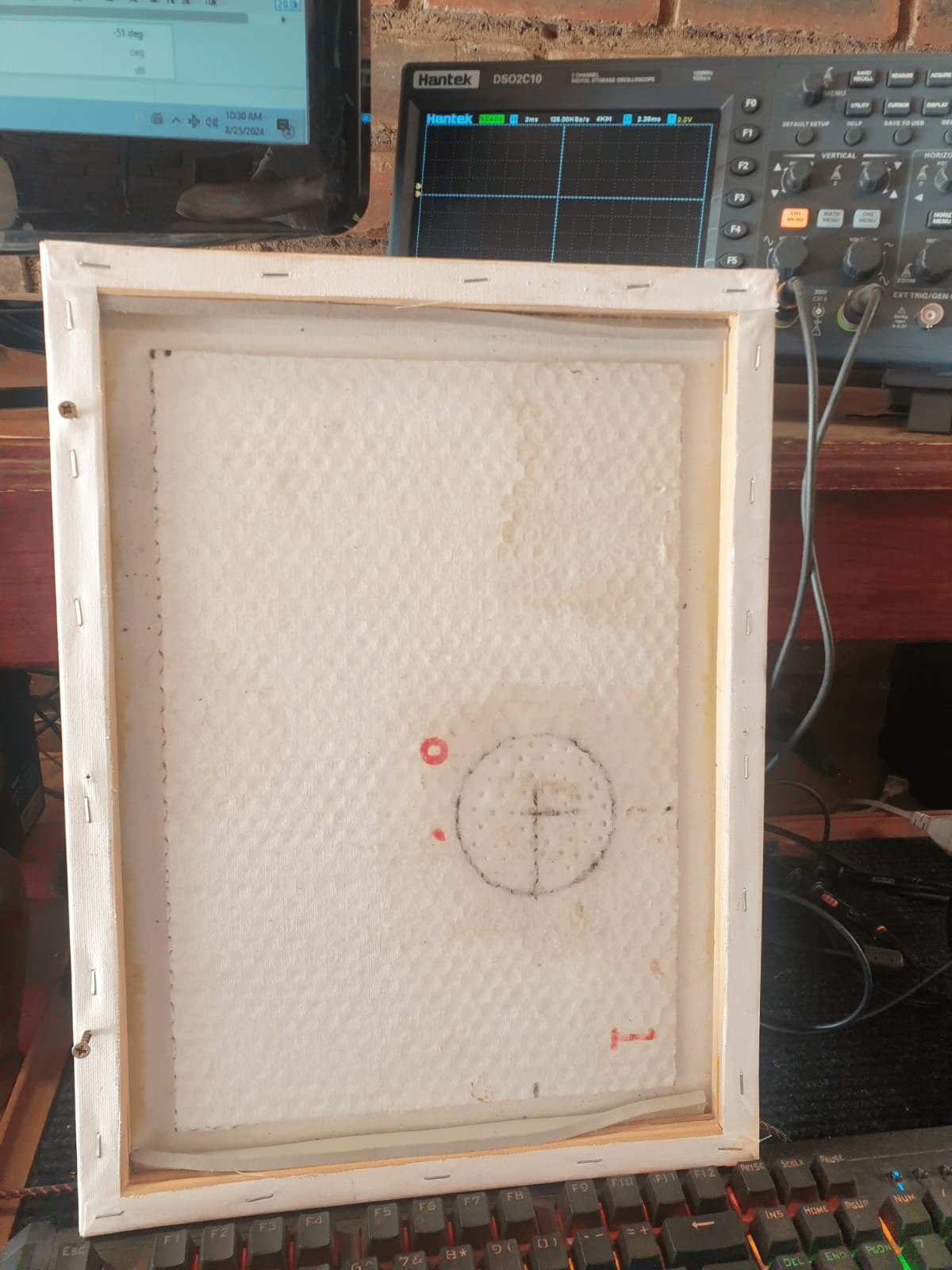

Hi Andre,Here's a photo of the panel itself. This panel is 30 x 40cm, outside dimensions. Yes, it's a bit battle-worn from all the mods I've tried... 😬 You can see the foam damping strips are coming off the top and bottom edges.
The insert is Nidaplast. Inside the larger circle drawn there, are multiple little holes punched through to the front face, and which are all filled with resin.

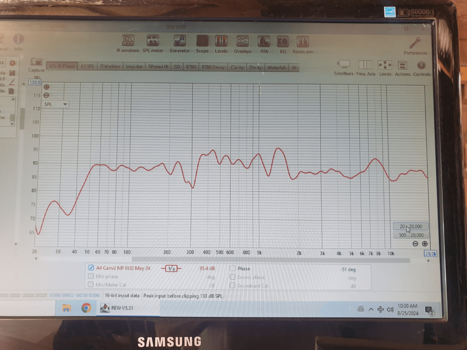

Here's the FR. 1/6th smoothing.
This panel sounds REALLY nice with a decent, punchy bass that out-plays my larger panels.
Is this one you used with a single exciter or 4 of them? What does the foam around the edges help with?

When you say it has nice punchy bass I assume it can play at a loud volume nicely? I am lacking in that from my current workshop panels. These are HD Eps 300/500mm in a frame held in place with epdm foam and pressure in a few places. The panels measured to around 110hz before dropping off in close measurement but at 3m in the room they had less output below 200hz than I am wanting.

Hi Joska,Is this one you used with a single exciter or 4 of them? What does the foam around the edges help with?
Yes, this was the small single-driver panel. There was too much ringing on the panel, so I shoved the foam strips in between the canvas and the frame to damp it a bit.
I put a spacer, a thin dowel, all all around between the canvas and the wooden frame, both to pull the canvas a bit tighter, and to stop the canvas flapping against the frame. The tightness of the canvas will determine the fundamental resonance of the canvas/insert assembly.On my quick dirty canvas test panel I did have much improved bass response but at louder volumes there seemed to be distortion coming from around the edges, I'm not sure if it was the canvas to wood edge or the EPS canvas edge.

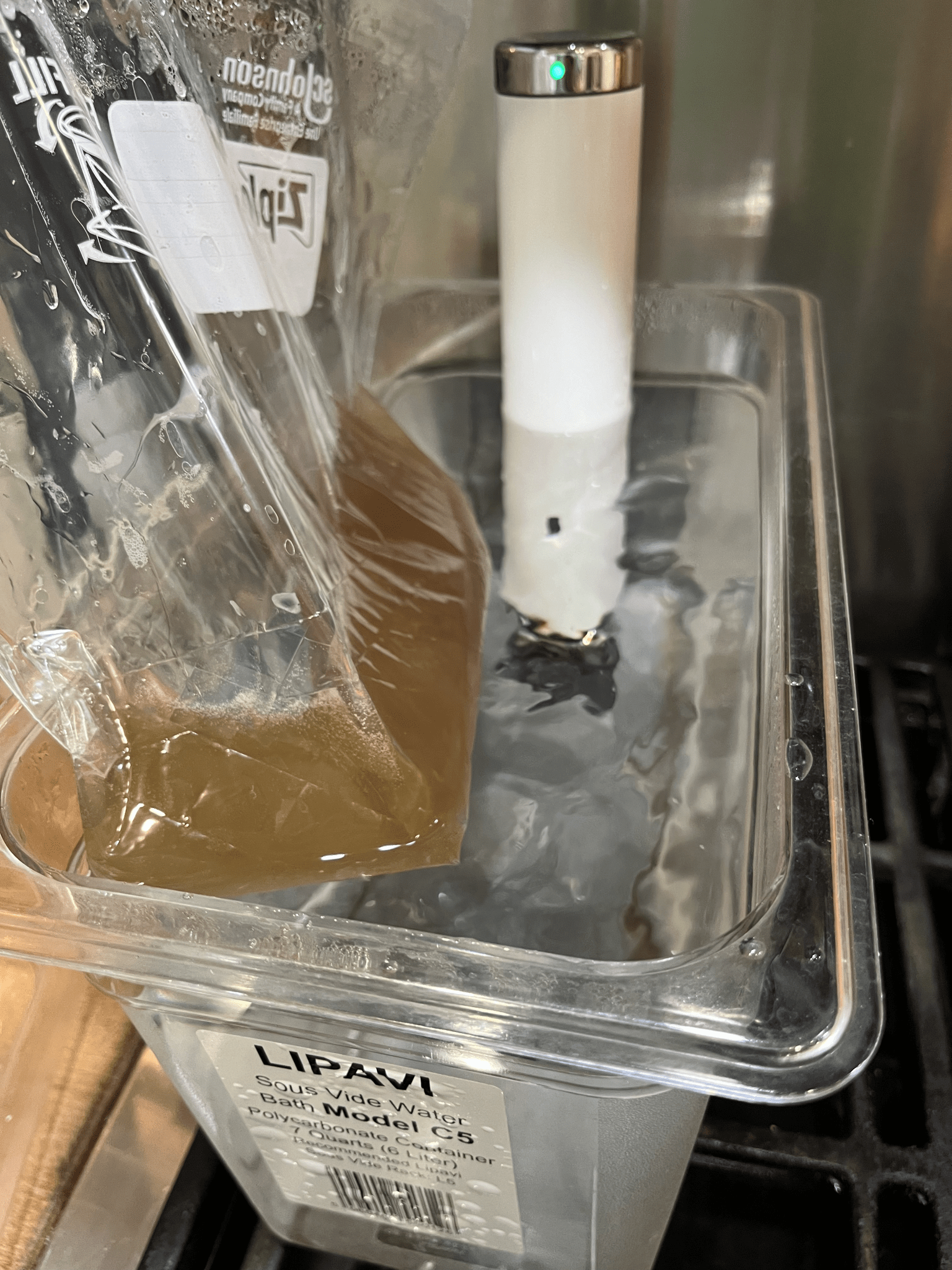

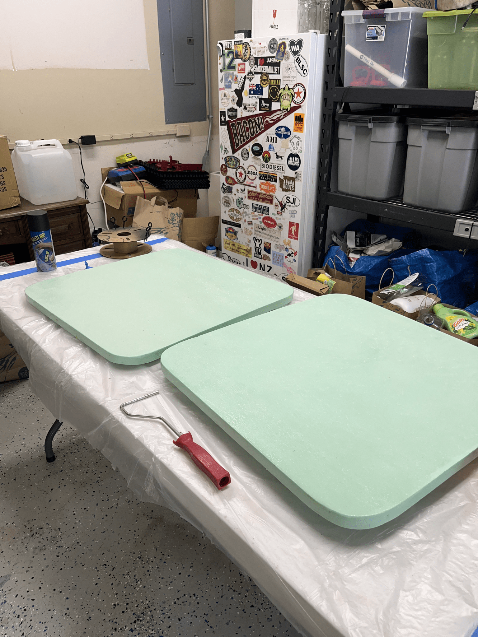

I'm in the process of trying my fist set of DMLs... going with the Lowes EPS 2'x2' panels lightly sanded then a coat of Hyde glue then Shellac. Excited to give them a try...
P.S... I found a new use of my Sous Vide machine... warming Hyde glue to the exact recommended temperature.
