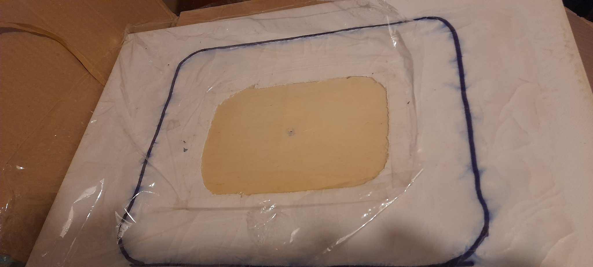

And whoever else has experimented with canvas suspension. Just wondering if you remove most of the face canvas to expose the panel (ply, Eps etc) or do you leave the canvas intact. I'm just thinking it is a pretty heavy coating for the panel compared to 1/2 strength PVA or similar and would it lower the sensitivity significantly or damp high frequency too much? Or is this not the case?
On my ply canvas panel I eventually removed the canvas from the ply surface, this does give some more detail to the sound similar to the ply only panel.
For even better results I use thin film to cover the surface, making sure to leave a couple of mm between surface and film.
As in picture.
Steve.

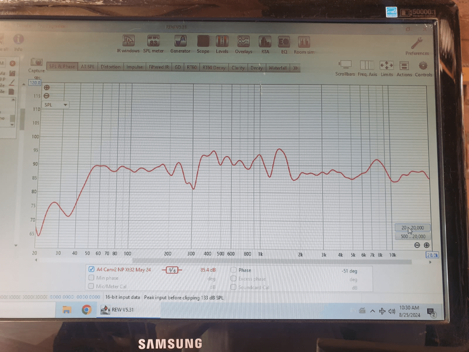

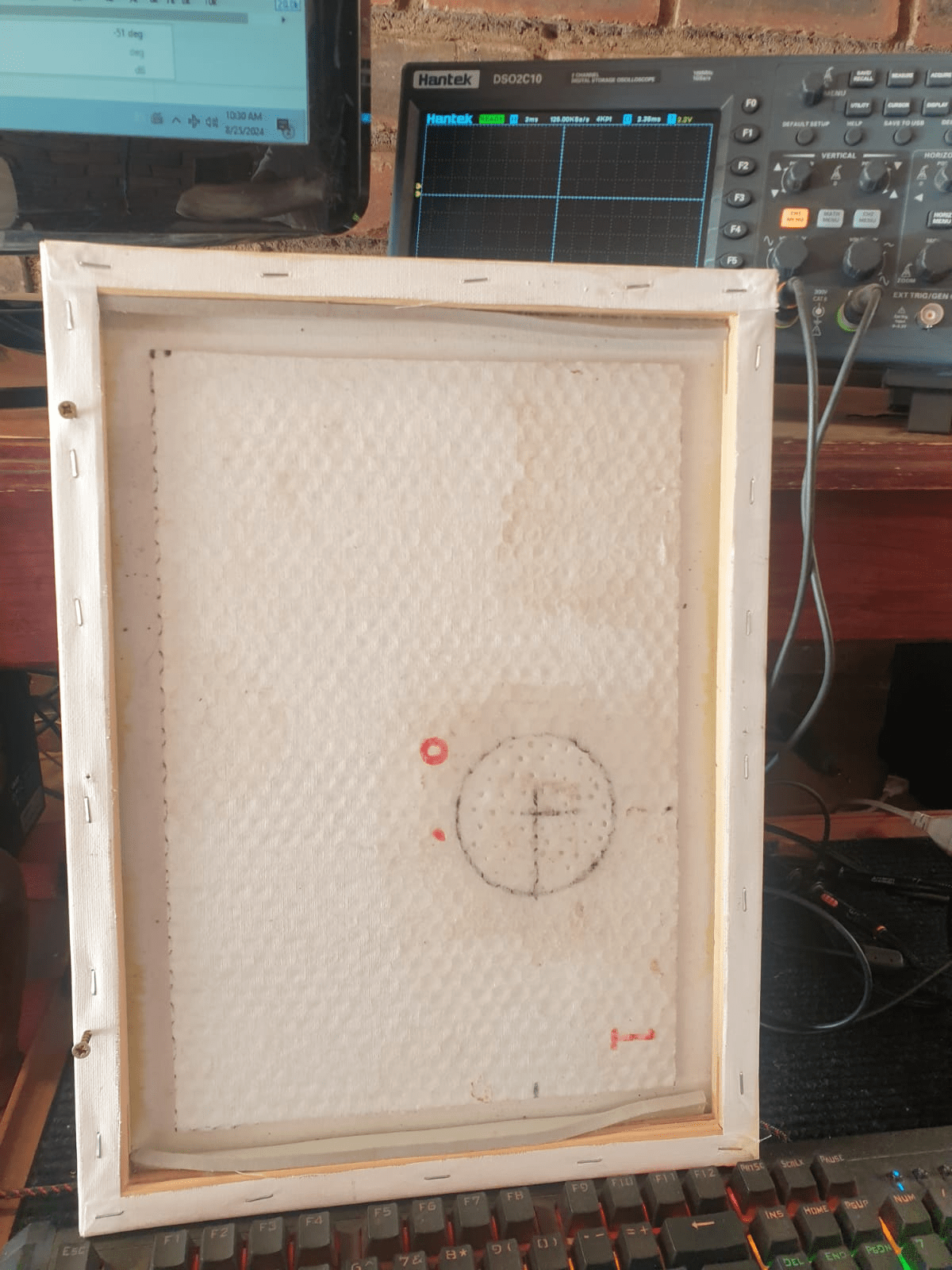

Here's a photo of the panel itself. This panel is 30 x 40cm, outside dimensions. Yes, it's a bit battle-worn from all the mods I've tried... 😬 You can see the foam damping strips are coming off the top and bottom edges.
The insert is Nidaplast. Inside the larger circle drawn there, are multiple little holes punched through to the front face, and which are all filled with resin.
Here's the FR. 1/6th smoothing.
This panel sounds REALLY nice with a decent, punchy bass that out-plays my larger panels.
Andre! Really great FR you have here! I tried using cotton canvas but while low frequency output gets better i get less high frequency, so I have bought some acoustic fabric (the one you use to cover cone speakers) that should help me preserve treble frequency. I know you are far away from me but where did you buy the nidaplast? in europe it seems impossible to find.
