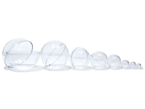

anyone tried a big polystyrol ball with a sound exciter and dsp?

Are these meant to be pistonic or DML devices?anyone tried a big polystyrol ball with a sound exciter and dsp?
https://www.diyaudio.com/community/threads/diy-spherical-esl.415610/post-7747796
Two opposed pistonic ones would be sort of like Devialet in concept.
Two spherical DML’s would be interesting. Although the modes may be very different and rather high - more of a tweeter.
You need a thinner shell - able to flex and bend - spherical paper mache might work. Use the shell as a mandrel and layup some plaster of Paris soaked paper - tissue or newsprint etc. But keep it thin.
Those more adventurous might try layup of very thin carbon fiber.
