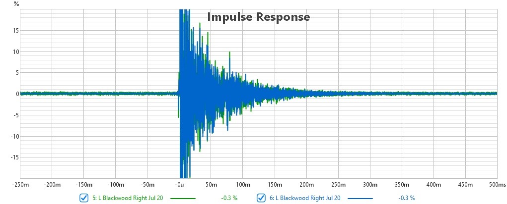

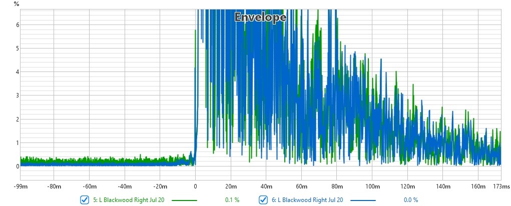

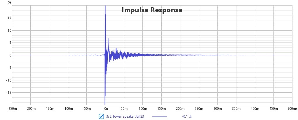

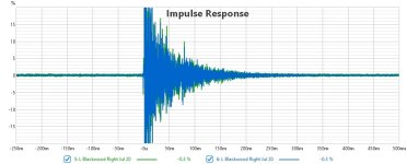

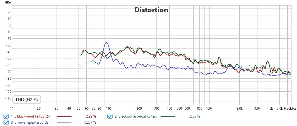

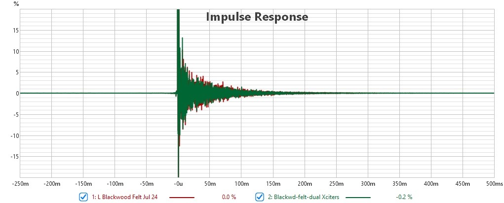

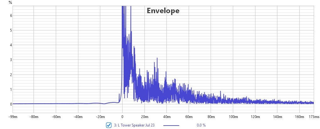

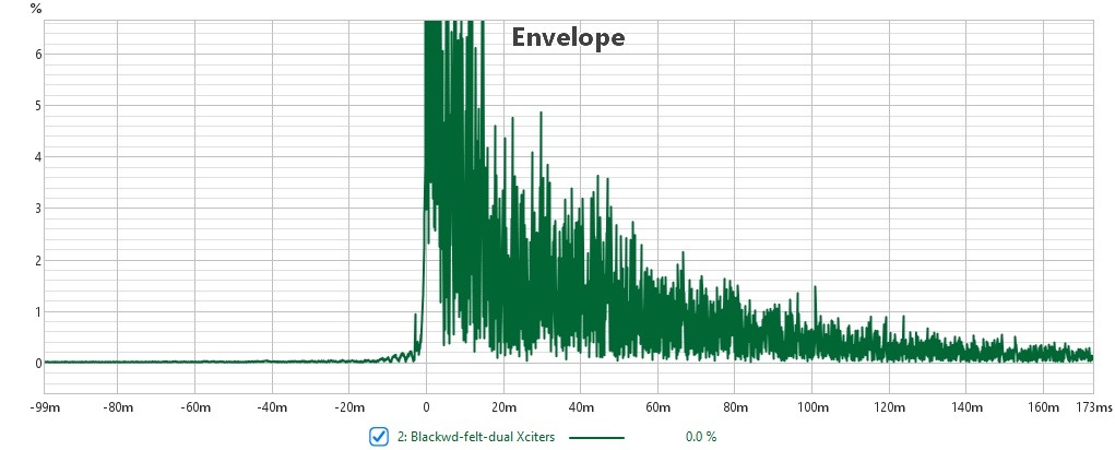

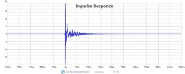

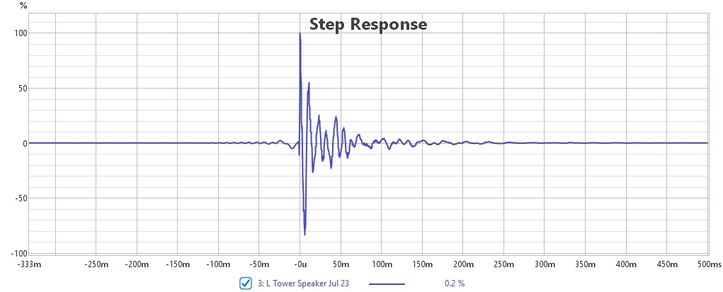

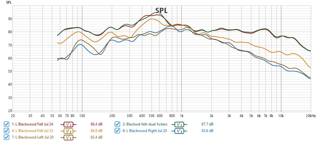

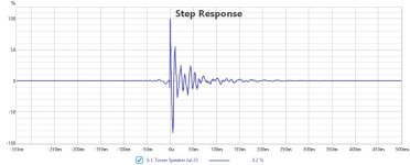

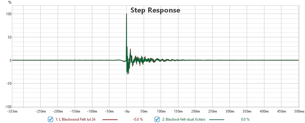

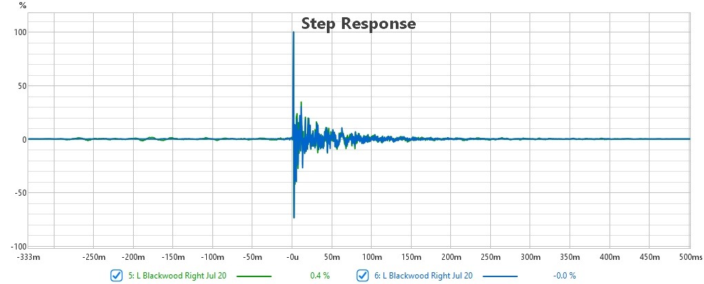

Having moved house and state, I've only recently been able to re-establish testing in any meaningful way. I've now put in place an EMM-6 mic coupled with a Behringer UMC22 interface with loopback timing. All good - excellent in fact.
So I was dismayed when I saw the results of the Blackwood panels and I couldn't perceptually align the results with previous tests on the same material. I have been mostly using a Fosi Audio BT30D Class D bluetooth amp, but recently also hooked up my old Sony Class A amp. Even with my poor hearing, I was struck by the difference in warmth between the Class A and D, with the A seeming much more warm and lively.
Anyway, the alarming tests were carried out using the Class D, and these are shown traces 6 and 7 in the attached graph.
I then switched to the Class A and that is shown in trace 4 - a significant difference in slopes on both bass and treble, but still a lot of roll-off in HF. The large hump at approx 550-600Hz is also notable (yet to be tracked down). I have another Fosi amp so I'll get around to do a comparison test but the results indicate an issue with this one at least.
I began to ruminate as to the likely cause of HF roll off in this and basically all panels shown and discussed in this thread. My belief is now that it's really related to the shifting of HF response towards the exciter as frequencies rise, to the point where there is simply not enough energy across the panel to maintain sufficient SPL. This can be addressed by using multiple panels or EQ, but is there another way?
Now we generally understand that multiple exciters will interfere with one another at certain frequencies, and so the preference is to use a single exciter. In this case I'm using the DAEX30HESF-4 (40W-30mm VC). There is also a generally accepted viewpoint that smaller VC diameters are better at HF than larger ones, and others (Andre?) have commented on VC collapse of the DAEX30HESF at high frequencies, a possibility which may be exacerbated by relatively high stiffness of the Blackwood, despite it being only 2mm thick. So maybe the exciter comes into play as well, but I do believe that the roll-off is mainly caused by the migration of impulses towards the exciter at HF.
To test this out, I decided to try a second smaller exciter (DAEX25FHE-4- 24W-25mm VC), but positioned in a way which hopefully mitigates interference.
I connected the second exciter using A-B speaker outputs on the Class A amp, sent a 3kHz test tone to the panel and moved the exciter around to maximise the output. I concentrated on the upper section of the panel for practical purposes, and the best location ended up to be near the top corner of the panel on the same side as the offset main exciter. So it ended up being about 300mm or so above and 70mm to the side of the main exciter.
Initial listening tests didn't show any detrimental effects (maybe my hearing LOL).
I then did 2 measurement sweeps and these are shown in traces 1 and 2. Immediately noticeable is the 10dB gain @ 10k, but also surprisingly measurable gains across the bass and mid frequencies. The second exciter has in essence flattened the curve significantly (again ignoring the 600hZ hump)
In addition, and again surprisingly, THD was reduced, and Step and Impulse responses both improved over the single exciter case.
I'm certainly not an expert in the use of REW but these results indicate that a significant improvement has been achieved here.
Comments welcomed
Eucy
Comments welcomed
Eucy
