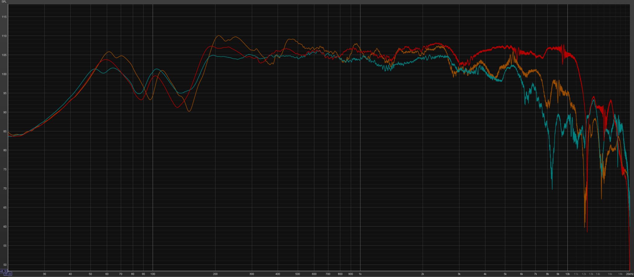

I made a panel a few days ago that I had to test tonight for curiosity's sake. I wanted to see how a panel with PVA applied that is the same weight as rubberized undercoating would perform. I made a panel that started same size and weight (48g) as Dupli-Color x2 panel. Dupli panel is 71g after treatment and PVA panel ended up at 87g after treatment. I bit heavier, but ok. Guess I should have weighed the PVA before applying.
On the IR graph the PVA is almost as good as Dupli. Heavy PVA is better damped than light PVA, but heavy PVA is only about as good as light Dupli. Heavy Dupli is a little better. The HF on PVA tanked sooner than light PVA and much sooner than heavy Dupli. FR below 7k is about the same, though PVA is a bit more hairy at 1m. Distortion is about the same. GD is also a little better on Dupli.
The PVA makes the panel a good bit more rigid than Dupli, but it seems like maybe that rigidity is not helping.
Red is heavy Dupli-Color, teal is heavy PVA, copper is light PVA. Very close mic.
I keep circling around this idea that the panel needs to be more like jello; be able to jiggle well. But also stop jiggling as soon as the initial impulse stops. When the panel is too stiff it shows up in the loss of HF because, it seems to me, the stiffness prevents sufficient jiggle / ripple of the panel's surface.

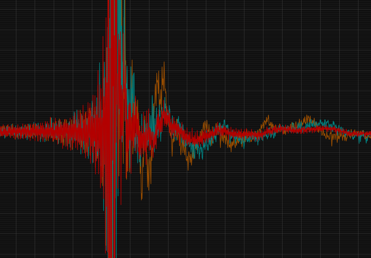

When it comes to directivity, I find that the tail of the sound matters much less than the initial transient. That is the ques our ears use to determine from where a sound comes from. Looking at your responses, it looks like the DML has a weaker initial transient than the other speakers. If you want good imaging I would focus on improving that instead of reducing the tail.
That is a great point, thank you for mentioning that. I think lightness of panel must be required to improve that, but the heavy exciter hanging from the light panel surely complicates the settling time. I did order a huge magnet last weekend so I am obviously going to have to test it this week with just a coil taped to panel 😛

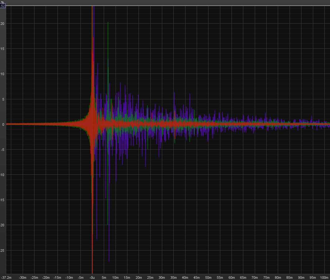

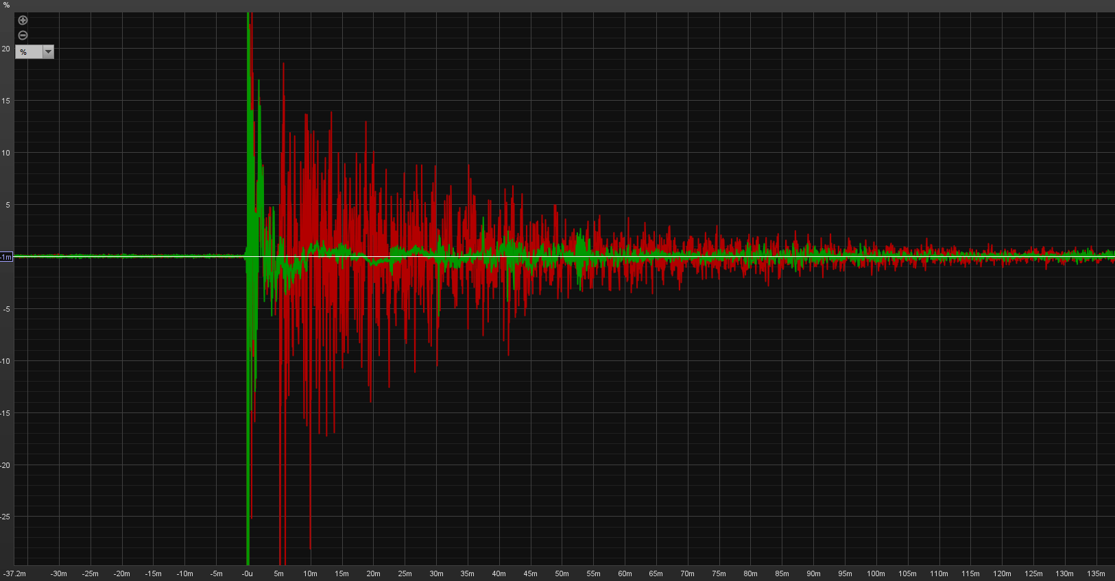

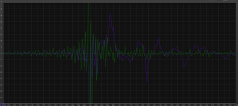

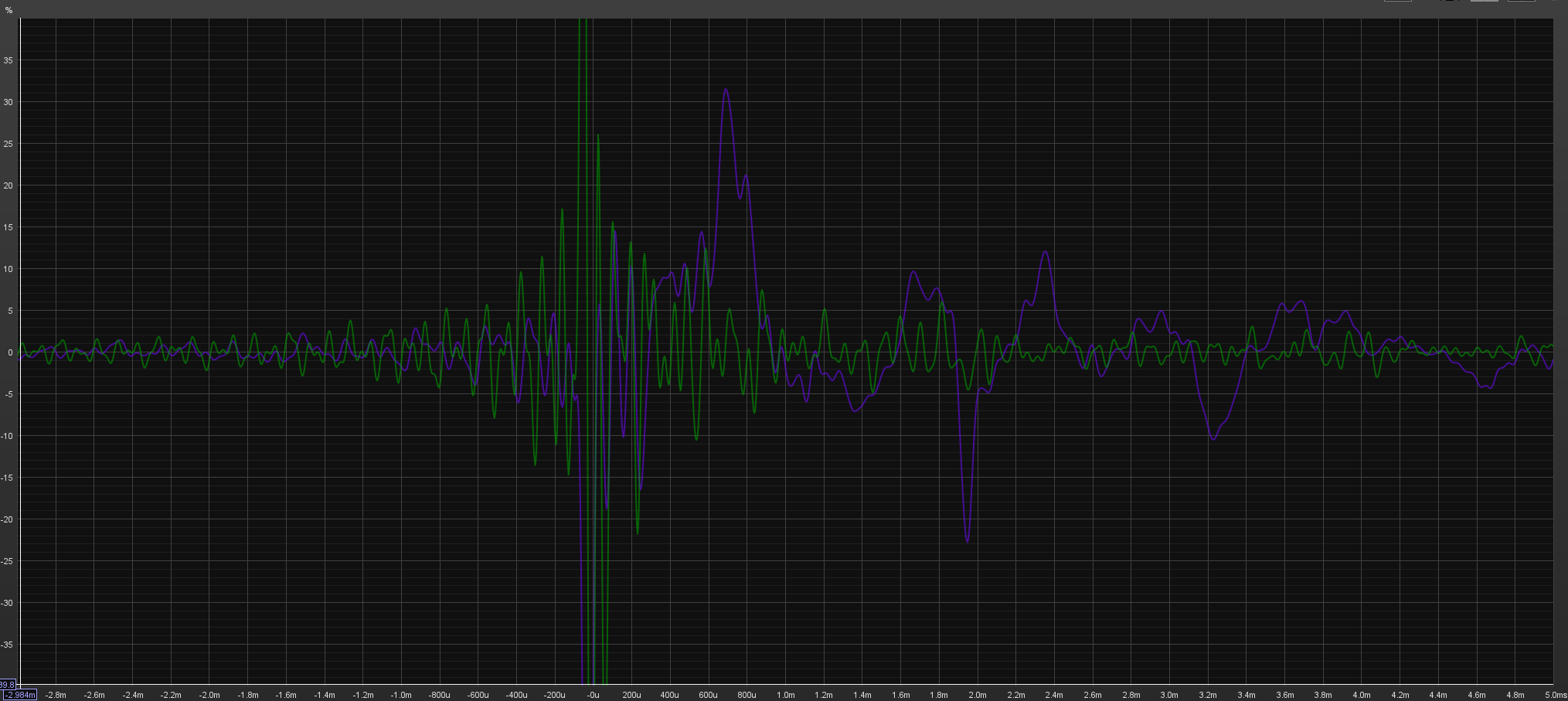

For initial transient analysis I zoomed in on the no-baffle planar IR and the dupli x2 panel at 1m mic:
Green is planar at 1m, purple is Dupli x2 rubberized at 1m

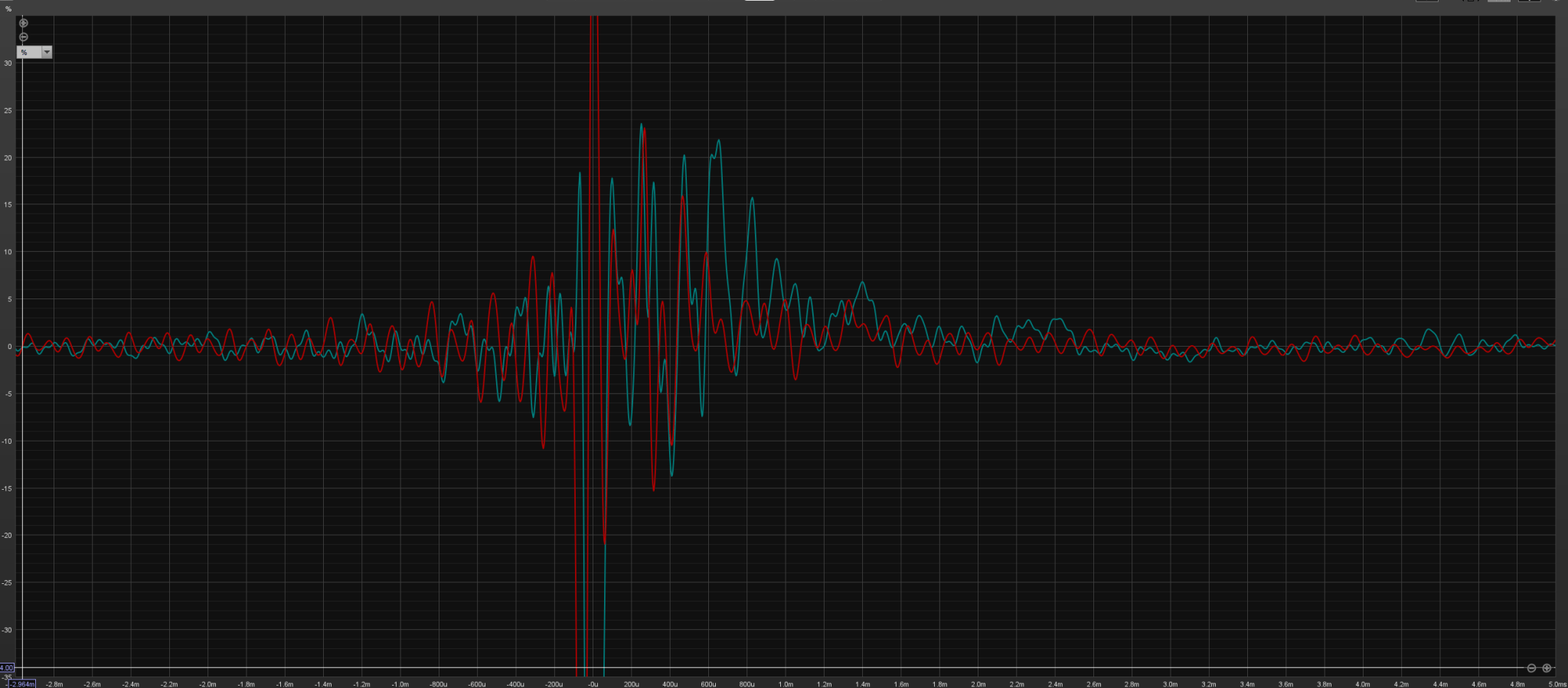

I did not take a close-mic measurement of no-baffle planar, unfortunately, but even at 3ft its IR looks better than the best DML at close-mic. Here is a close-mic comparison of heavy PVA and Dupli x2. Dupli looks significantly better here.
Blue is heavy PVA close-mic, red is Dupli x2 close-mic

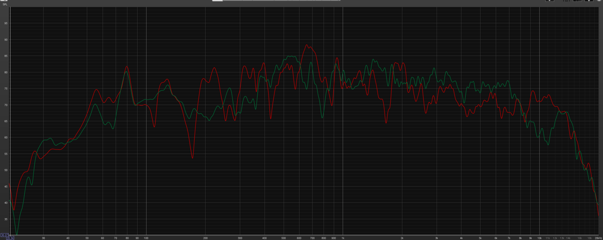

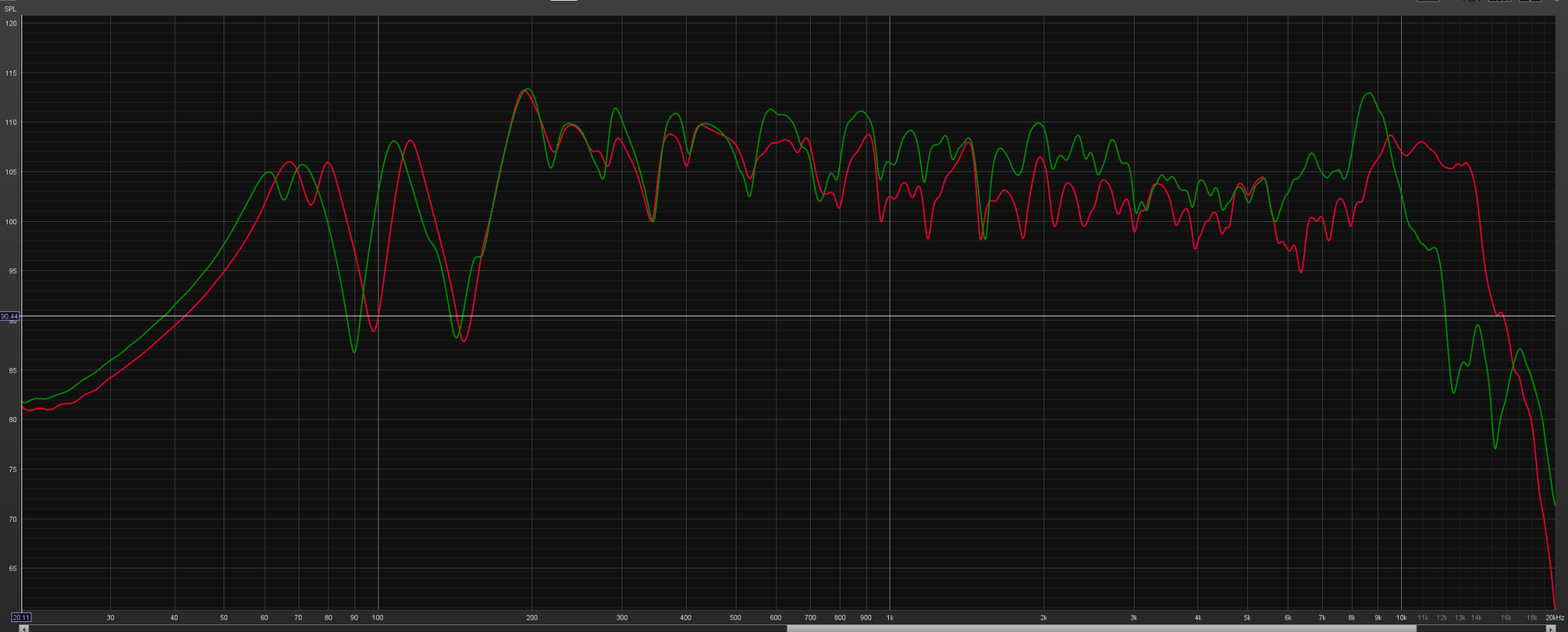

Here's a comparison of DAEX32EP-4 and XT32-4, close mic, each on the same panel in same frame with no driver bracing. Only thing that changed was the driver. Every time I remount a driver there may be a slight change in the exact mounting point, but they were pretty close:
Red is EX32. Green is XT32
I only did this one test with an XPS panel, no other materials. My summation is that there isn't much difference between the two in these measurements. The XT32 may have a little better HF or that could have been caused by placement. The XT32 feels better to work with though, seems more resilient than the EX32 and less prone to getting damaged be remounts, but XT32 has a smaller foot ring which does not stick as well to the panel with tape. Less surface area to bond over.
Reactions: Philimon
Oops, I meant EX32 may have a little better HF in that measurement but idk if it is actually the driver or the placement because I think I've seen others post measurements with the XT32 having improved HF. The 3ft test suggest the tiny difference in placement is likely involved here because EX32 has bigger peaks and dips:

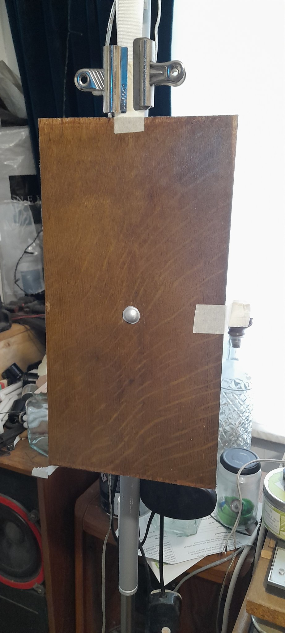

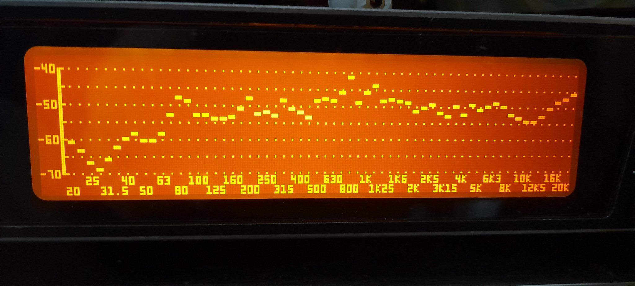

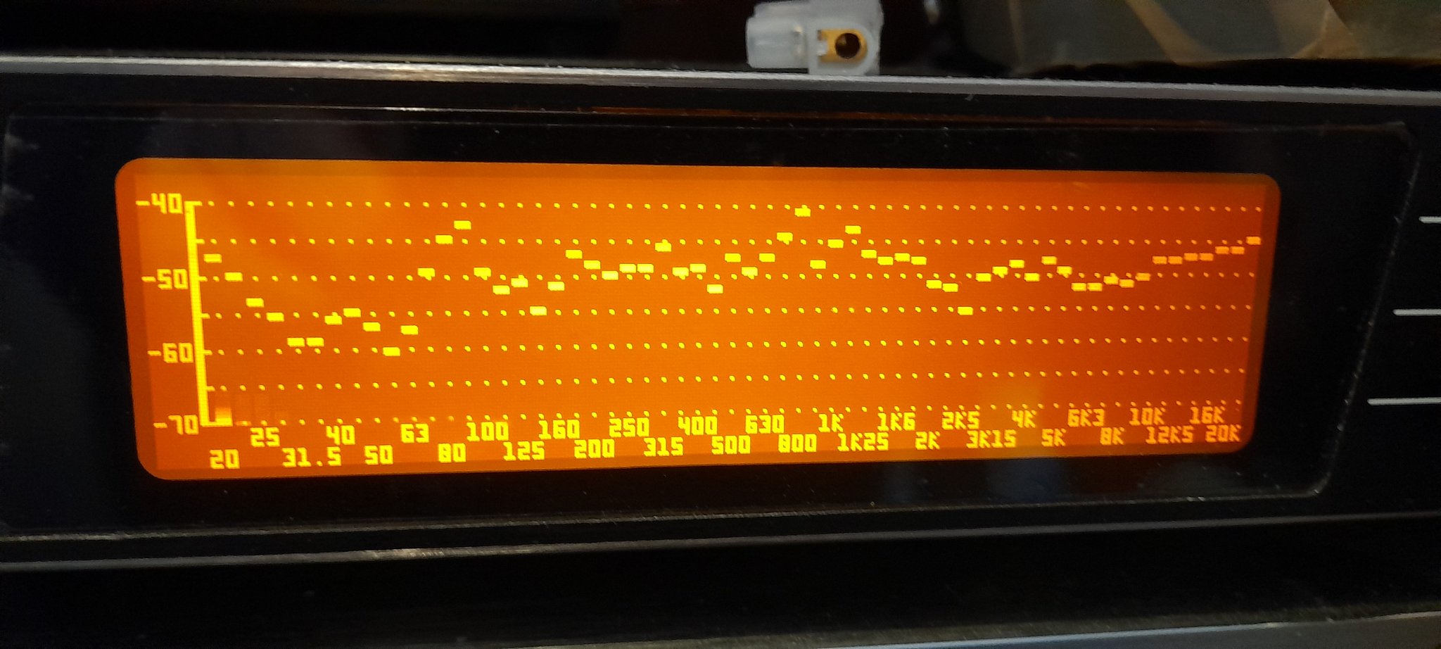

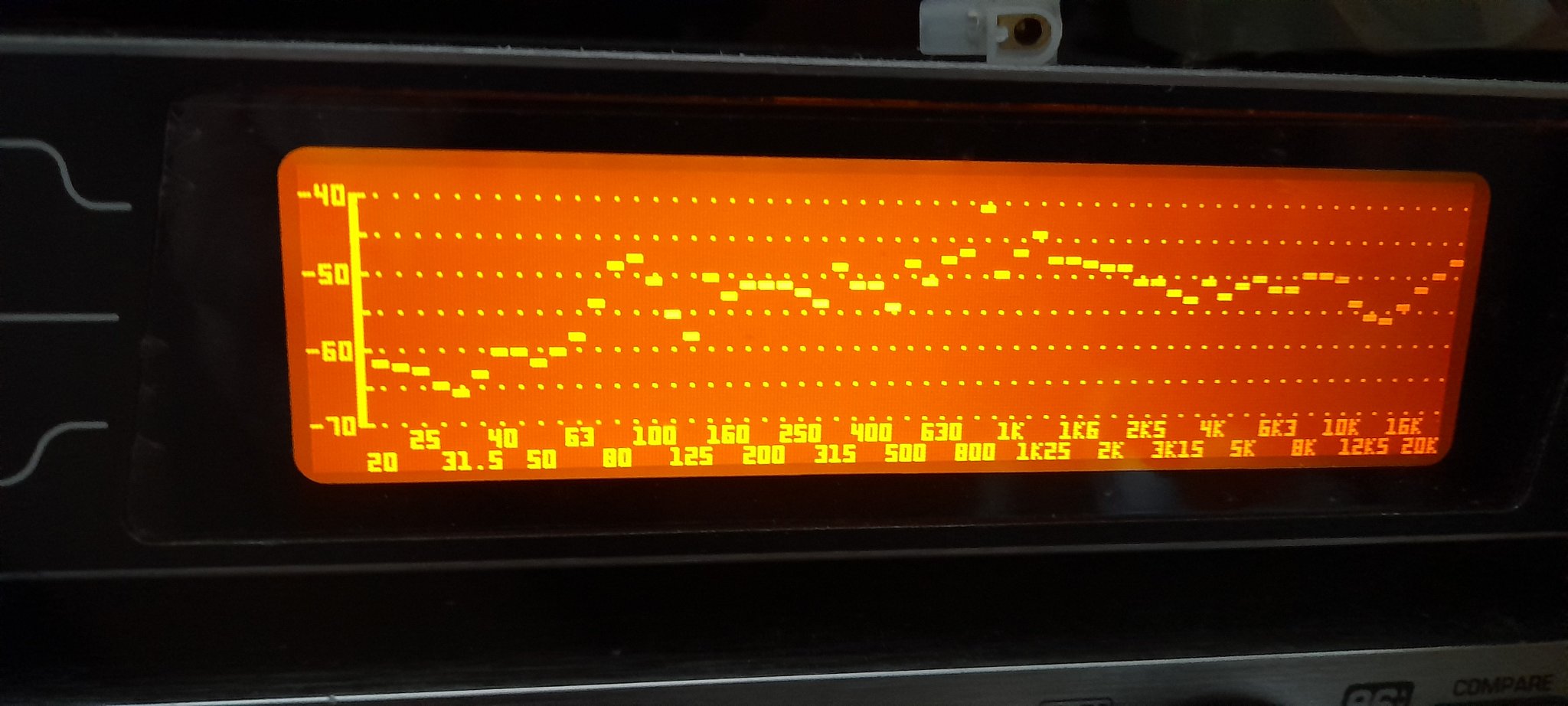

Pic 1 is the veneer panel with a small dot of blu-tack in the centre of the coil area.
Pic 2 is with a small plastic dome taped to the coil area using double sided tape.
Pic 3 was with the tape only to see what affects it was having.
Pic 4 is with a 14mm hole drilled in the coil area , and the same dome glued into place.
Pic 5 is the picture of the dome in place.
Although the small dome does give a slow rising frequency response from 6k up to 20k of about 6db without any major dips and peaks.
It does not have any impact on the peaks in the 1k area , as the coil cavity is unaffected.
It looks like I will have to make a soft dome and see how this affects this 1k plot.
And what happens above 6k.
Steve.

Moray.
I just remembered that I was going to try the cling film method first, before cutting the hole 🙄
Never mind,
I'm not sure if the dome is big enough, I usually cut the hole the size of the coil foot.
I know that at some stage I am going to lay the panel down and flattened the dome.
It is inevitable.
Lets hope i can do some tests first.
I will then have a concave dome .
Maybe tomorrow.
Steve.

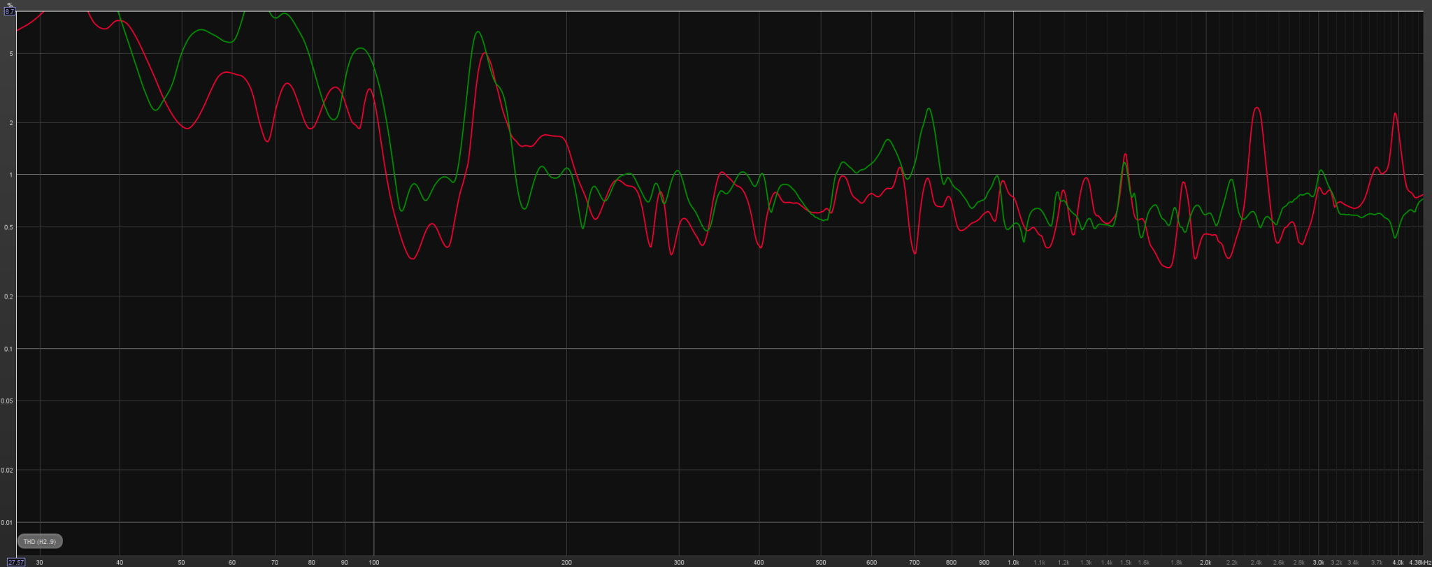

Yeah, I think the issue is too much reflection from everywhere, and DML have really wide directivity which makes that problem even more apparent. If I put lots of absorption on the walls that might resolve the problem, as could having a much wider room, but I can't do either right now. I'll move in a year though and maybe then I can revisit this.
I just realized that the inside vs outside test showed this problem pretty clearly on the IR graph, as does the close-mic vs 1m-mic:
(green is outside, red is inside, both 6ft (2m) mic distance)
When measuring a DML in the test position from 3ft (1m) and comparing to a 3" planar there is a big difference in the room effect on the impulse graph:
(red is planar in a box, green is planar no-baffle, purple is DML)
When I changed the DML freq sweep to 1kHz-20kHz this impulse response got a bit worse, so it's not LF causing this.
