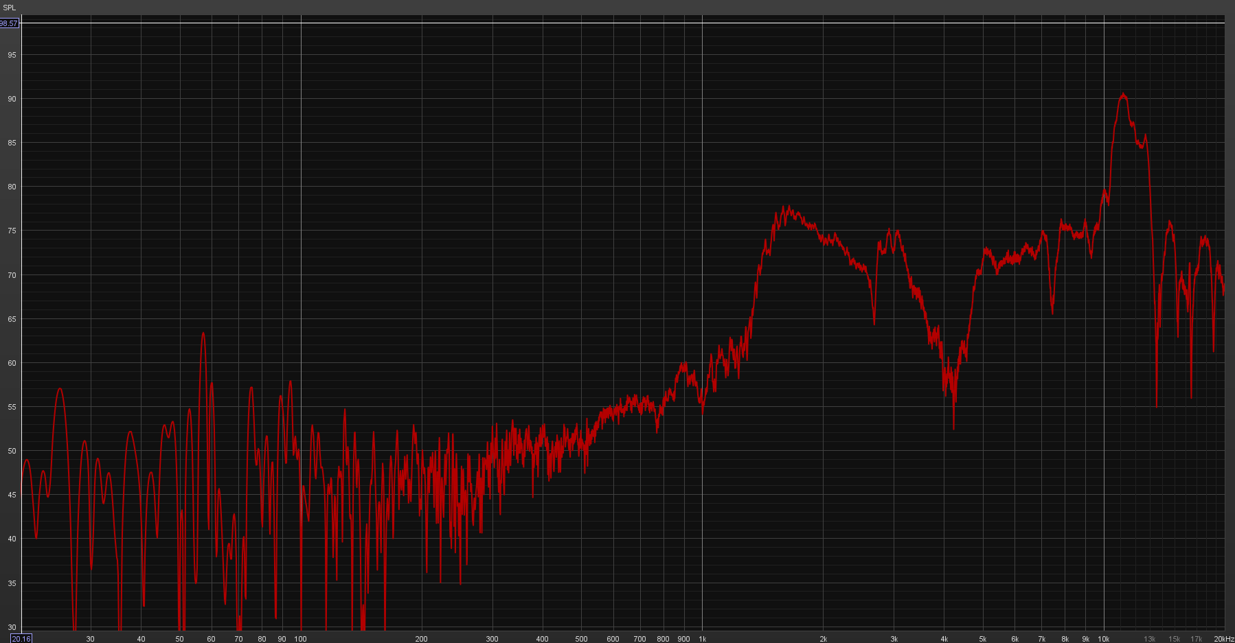

My guess is that the "hairy" response comes from the comb filtering that happens when the multiple modes combine. That is part of the nature of DML, and that kind of very fine comb filtering is something our hearing is very used to since most natural sound sources would behave the same. If you record for example a violin, I think you will see the same "hairiness".If I had used smoothing in that FR it wouldn't have shown the correlation between the ringing on the impulse graph and the hairy-looking nature of the FR. I believe that if the impulse response can be cleaned up to look more like the planar (or any other cone speaker) then the FR extreme swings will also be cleaned up. There will still be lumps from the modal nature of course.
I don't know if myself or anyone else can hear those unsmoothed spikes directly, but they are a sign of what is going on underneath and I believe that can be heard. Additionally that high variability could cause more intense interference issues, I suspect. In this case I am pretty sure it is ringing in the panel and that muddles the sound clarity and paints those long tails on the FR graph.
When doing A/B test between this panel and this planar I can hear a slight difference in that clarity. It isn't a huge difference that I hear, if I didn't do the A/B I wouldn't know which is which (if I ignore the planar giving a 'small' sound while DML gives 'big' sound), but when switching to planar there is a little more 'magic' to the sound which makes the tingle response come more easily. This comes from clarity, I am certain.
The planar I tested is a GRS PT2522 mounted in a cardboard box with a jacket in box for damping... lol. It was a mockup for a center channel I was going to build but I decided to do DML instead.
Longer tails are also part of the nature of DML. If you want it to measure like a cone or planar, then why not just use a cone or a planar? If you do like the sound of DML, then I think you need to accept hairiness and a bit longer impulse response since that is part of the nature of DML sound.
I do try to ensure that response is reasonably short and even over frequency and time, but I move my frame of reference what even and short is for a DML speaker.

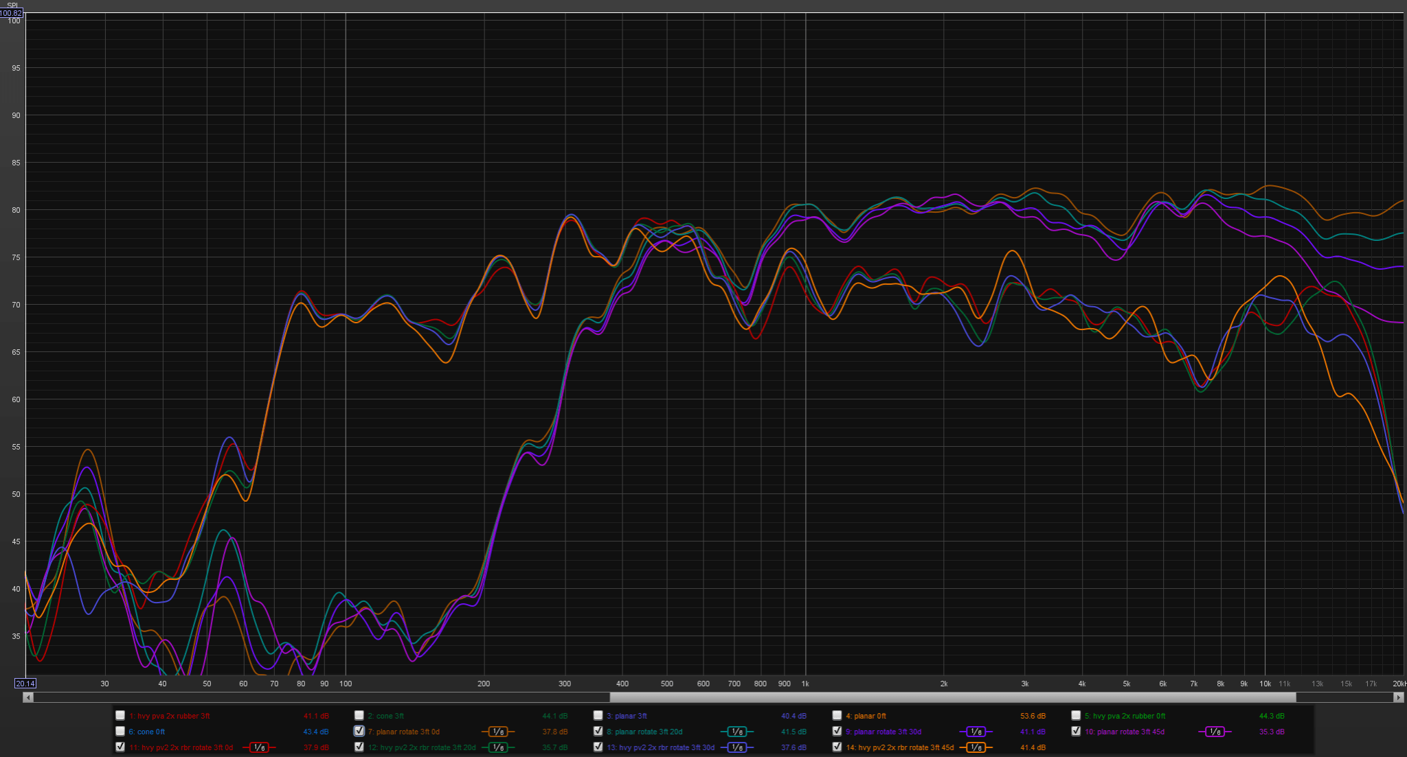

Here's some measurements, in case anyone else is interested, comparing off-axis FR for planar and DML from 3ft away at 0 degrees, 20, 30, 45. All done with same settings as my last post (EQ for different positions in the room, crossed over, other channels muted). Planar is 3" GRS, DML is 9"x19" exposed area of heavily PVA'd XPS with two coats of rubber.

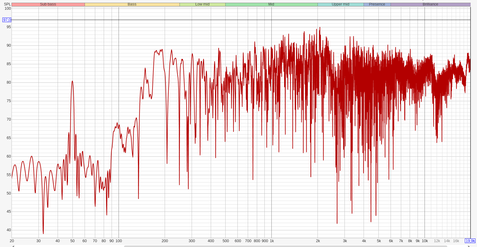

Hello SapphireSloth,I decided to compare the heavily PVA'd XPS with 2 coats of rubber to the small planar magnetic speaker I've got tonight. My goal is to get the DML 'as good as' the planar speaker but it needs a lot of help. Here's why I've focused so much on damping:
I already gave you my opinion your DML is too ringing. I understand you design constraint about the width but with that your are not in good condition to stop it bouncing. The oscillations in the DML IR are in beginning of its FR, probably much below 2k.
About the close mic measurement technique, it is used for pistonic loudspeakers in order to get their low frequency response. This technique has a limit in its upper frequency. It is clearly defined in the case of a pistonic loudspeaker. When the frequency increases, the phase of the point of the emitting surface distant from the mic becomes too high leading to cancellation. In the case of the DML, it is a convenient measurement to have an idea of what happens locally but I don't know if their is a study showing the limit of this technique.
Below is the measure of a small 8cm wide range (Visaton FRS8 in a 1.2l closed box) at 1m without smoothing. Hairy too but not for the same reason. A DML is by nature "hairy" because working on modes, the pistonic speaker becomes hairy because of the reflections in the room. At the end, as Eucy wrote, our hearing system filters that and then has the illusion of something much more smooth.

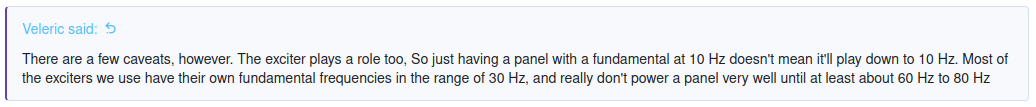

+ @VelericI agree with this entirely... :
Hello,
2 points,
About the exciter fundamental, I don't fully understand...
We can evaluate the modes of a panel. When the exciter is glued on it, it adds locally a mass (its voice coil) and a stiffness (its spider) which will shift up the panel modes. It is a new system which has 2 variants depending if the magnet is free or almost blocked by a spine.
In an other hand, for the exciter alone, it is possible to define 2 resonances. One of the voice coil, the magnet being blocked, one of the voice coil, the magnet being free and the voice coil blocked but this not the panel plus exciter system.
So is the proposal here to use the exciter magnet mode as to be lower than the first panel mode? What about the case of a spine which is mandatory for a long term design?

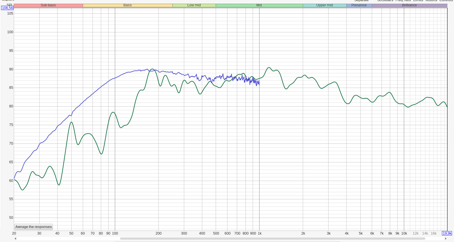

The second point is about the "low frequency" measurements. Those last days, I made measurements of almost all the speakers I have here, DML, pistonic. I did that as almost all my DML measurements, same room (my kitchen!) speaker and mic at their usual positions, 1m between them... and I rediscovered a fact that I completly fogets with DML : measuring low frequency is not easy, . Below are the FR of a pistonic 2 way speaker
- green : the FR at 1m
- blue : the FR at close distance of the woofer.
For a pistonic speaker, the way to merge the 2 measurements is a topic in itself covered by papers.
For DML, I don't remember reading something about that.
It opens to new questions :
- what the papers say about the frequency under which a measurement is at distance is not correct (related to the room, the Schroeder frequency?)
- is the close distance measurement of DML relevant as for a pistonic loudspeaker?
- the room transfert for the considered set can be estimated from the 2 curves below but will it be the same for a DML? A close box is a monopole at those freqneies, a DML is a dipole. Do we have to compare to a open baffle pistonic loudspeaker ?
All this second point to say to be cautious with the DML FR let say below 250/300 Hz?

Christian,About the exciter fundamental, I don't fully understand...
I'm not sure I understand exactly your question. But I agree that everything you say here is true. As you say, the panel modes will be shifted to higher frequencies when the exciter is added. And I will add for clarification that the fundamental panel frequency is shifted the most, by up to about 20 Hz, but higher modes are shifted by much less, and by, say, the fourth or fifth mode any shift is negligible.
Concerning the two resonances of the exciter, the one with the magnet free and voice coil fixed is the only one that appears in the impedance curves after the exciter is attached to a panel. I suspect that the resonance with the magnet fixed is useful for determining the voice coil mass, but otherwise I don't see direct evidence of it once it is attached to a panel.
Tentatively, I would say yes. And not just a little, but that the first panel mode should be 2x or 3x the magnet mode. But I'm not sure I can really state this as a good general rule. I can only say that when I have tried panels with a fundamental closer than that to the magnet mode frequency, the fundamental is not excited very well. But once the fundamental is over 2x or 3x the magnet mode, it can be excited very effectively. I once thought there might be an advantage to making larger panels, in order to increase the modal density, but when I tried it it was never better than if the first panel mode was very close to about 100 H, or about 3x the exciter magnet mode frequency.So is the proposal here to use the exciter magnet mode as to be lower than the first panel mode? What about the case of a spine which is mandatory for a long term design?
That said, I must admit that most of my prototyping is done without a spine to support the exciter. And when I have compared results with and without a spine, they are almost always virtually identical. But I have almost certainly made those comparisons for panels with fundamental close to 3x the magnet mode. Would I get a different result for larger panels with a lower fundamental? I don't know! Maybe.

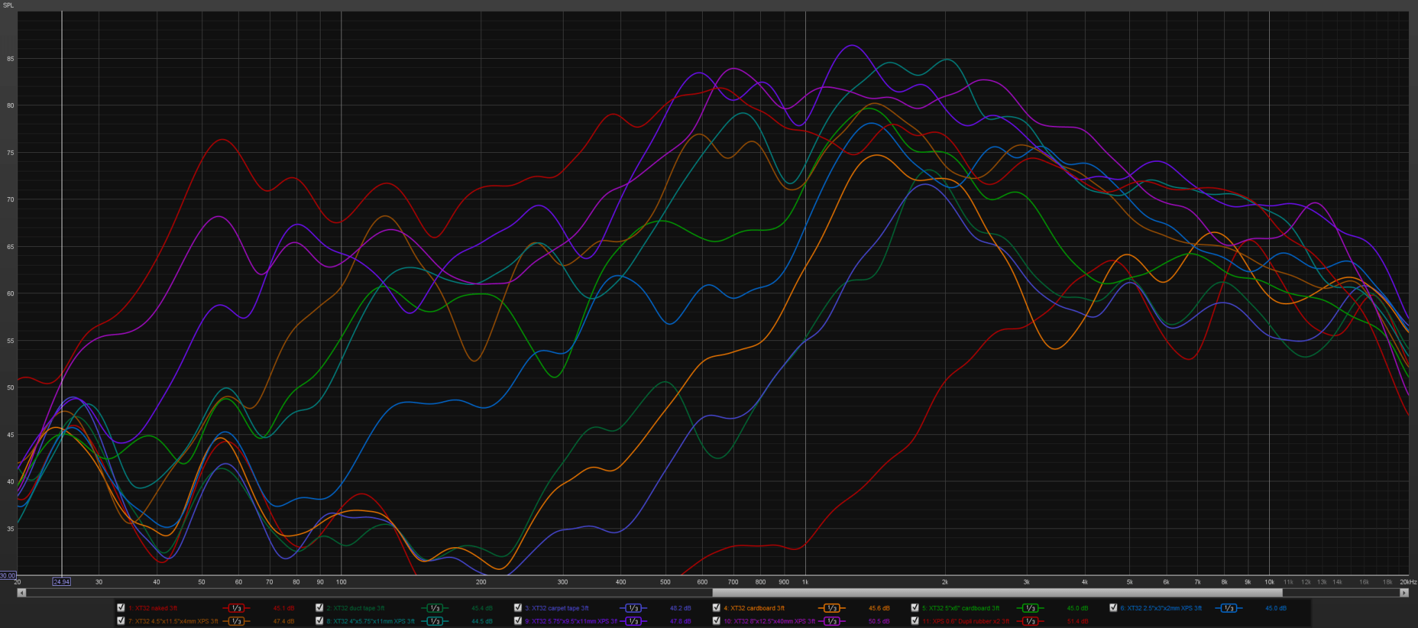

I did some tests today starting with the naked XT32-4 driver, held in my hand, 3ft from mic, at the same amp volume as all my other recent tests. I tried small materials on it, as well as varying thicknesses and sizes of XPS.
Naked the driver averages about 60dB in HF. The highest average was from a 8"x12.5" (200mm x 320mm) XPS panel 1/2" (11mm) thick, averaging about 69dB over the same range (5k-20k):
I completed a bunch of tests with rubberized undercoating, here's the mdat: https://ninjafiles.io/eYj/1x3-frame-xps-rubber.mdat
It's too big for this forum and I don't want to split it up.
This shows close-mic and 3ft measurements for every panel test. All panels mounted in the same test frame which has a 9"x19" (230mm x 480mm) opening in front and back and clamps the panel tightly with foam full length of short sides, long sides free. Panels are about 10.25"x21.75"x0.6" (260mm x 550mm x 15mm) inset into the wood frame so that only 9"x19" is exposed. Exciter is mounted approximately 3/5 x 3/5.
Many previous tests in this frame have shown that clamping panels very tightly with exciter at 3/5 position yields the best results, so that's what I did for every panel in this test. All panels in this test are 0.6" (15mm) thick. I used 2 panels cut from the same stock, tested after each change in coating. One panel weighed 2g more than the other, but they're close enough.
Panels I test were:
To summarize briefly, PVA does add damping but the 13g heavier Dupli-Color rubber provided more. Adding second coat rubber improved it more. 3M rubber requires PVA to protect the foam and mostly the Dupli-Color of same weight seems better.
I should probably test a second coat of 3M, and separately test a heavy coat of PVA. It would be interesting to see if PVA of the same weight as Dupli-Color could provide the same improvement.
This 2x coated Dupli-Color XPS panel is the best one I have right now. Heavier coatings have slightly lower distortion and flatter FR, but this panel has much better impulse response.

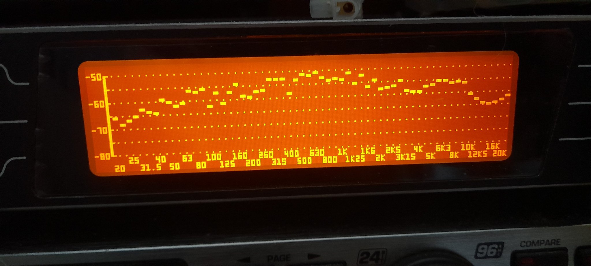

This is a plot of the only epoxy coated 5mm xps panel I have left.
In the first picture the microphone is at about 30cm in front of the exciter area.
The hf holds up to 10k before dipping down a little.
The second picture is with the microphone at the top of the panel it still reaches 10k, but with a bigger dip above this.
I have low density EPS that reaches 20k.
How is this possible, if supposedly, only rigid high density panel are able to reach such highs ?
Steve.
