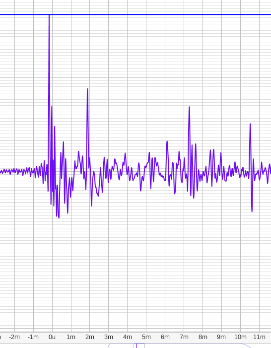

I downloaded your measurements and found one think that should not help in understanding/improving those panels : in the IR view, the 1st reflection occurs at 2ms when for about 1m distance, it is expected at about 4ms (see here Floor/Ceiling Reflection Calculator )
This reflection enters dips and peaks in in the FR at frequencies higher than expected. In which quantity, I don't really know...
Is there some wall 50cm from the sound path or is the panel close to the foolr?

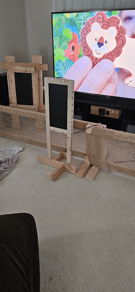

The frame when testing has panel 20" (50cm) above floor and 4ft (120cm) in front of TV. I do have this fence to keep the toddler out right behind panel which has been present for every recent test. The mic sits on the corner of the couch cushion seen in the pic, but centered when testing and 3ft (1m) from panel. For close-mic I hold the mic with one hand about 5mm or so from panel with two fingers against frame to steady my hand.Hello Sapphire Slot,
It explains the 2ms. It would be better to have the panel and the mic about 1m above the floor to avoid confusion between the panel behavior and the reflection from the floor... but this might be not easy in your environment.The frame when testing has panel 20" (50cm) above floor and 4ft (120cm) in front of TV.

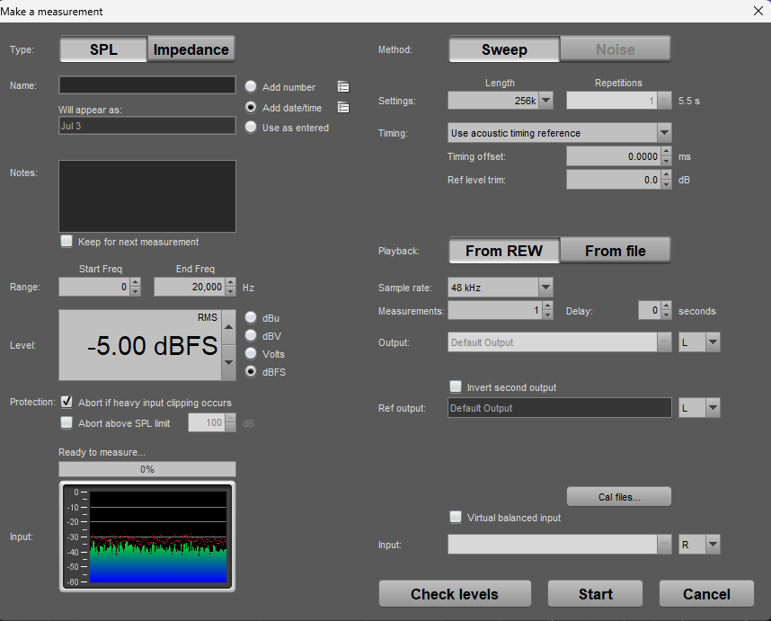

Advice please anybody who's got a USB mic.
I recently acquired the Dayton UMM6. I've loaded the calibration files and the measurements are good compared to the previous mic I was using.
But how do you set up loopback for timing references? I've tried everything!
Thanks SS, but that doesn't give an accurate enough time delay calculation for the mic/speaker distance.
The problem is that the USB mic hogs both the right AND left inputs. Previously, using a phantom-powered measuring mic, I could use a USB convertor, I could feed the mic into one channel, and then loop the other channel input to the left output, and get a solid timing reference.

The loopback thing has always been a 'just-so' issue for me ever since using the original LEAP/MeLLiSSA/CLIO and CALSODs pre-Windows on DOS in the 1990's. I've always used loopbacks by default—never even considered doing measurement of any kind without a fixed timing reference. Also, because of the various delays through the sound cards and converters and things, it's impossible to line up phase measurements correctly without it.
Update:
It's not possible to do loop-backs with USB mics.

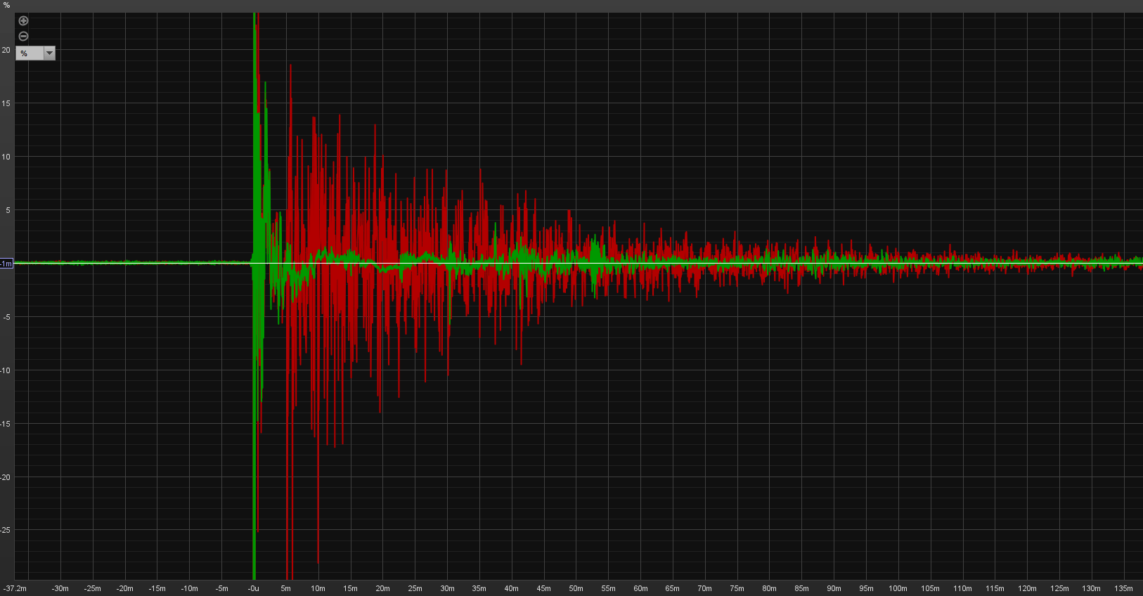

Yeah, I think the issue is too much reflection from everywhere, and DML have really wide directivity which makes that problem even more apparent. If I put lots of absorption on the walls that might resolve the problem, as could having a much wider room, but I can't do either right now. I'll move in a year though and maybe then I can revisit this.
I just realized that the inside vs outside test showed this problem pretty clearly on the IR graph, as does the close-mic vs 1m-mic:
(green is outside, red is inside, both 6ft (2m) mic distance)

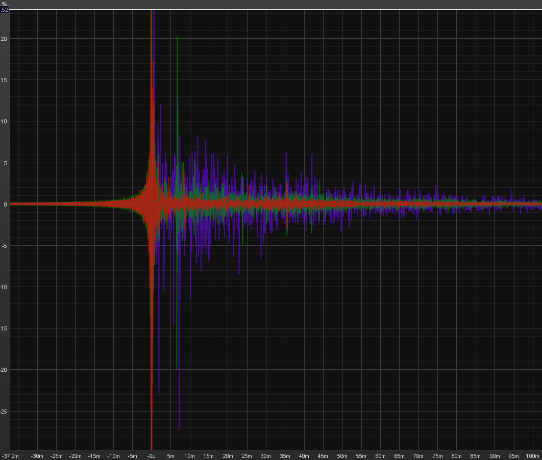

When measuring a DML in the test position from 3ft (1m) and comparing to a 3" planar there is a big difference in the room effect on the impulse graph:
(red is planar in a box, green is planar no-baffle, purple is DML)
When I changed the DML freq sweep to 1kHz-20kHz this impulse response got a bit worse, so it's not LF causing this.
