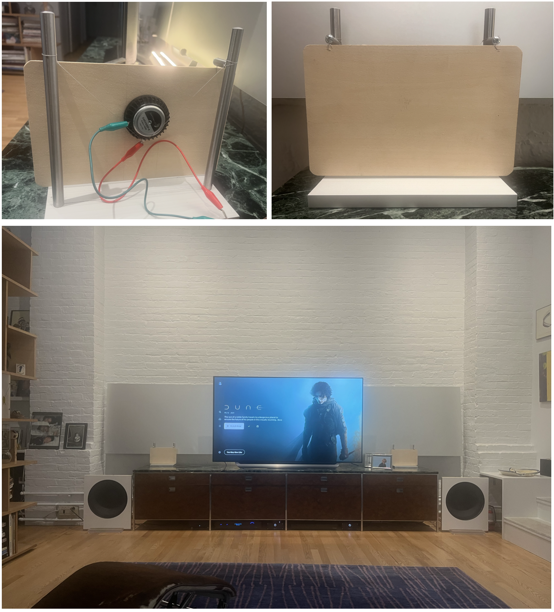

A while since I've visited/posted, but I thought that I'd show my latest DML experiment (see snaps attached).
Home theater / audio setup.
Several earlier posts have followed the experiments with my found aluminum honeycomb panels.
Their performance (using a single Thruster on each panel) still astonishes me every time I play music.
I've found the biggest challenge to getting the full audio on films comes from center channel speakers.
I've experimented with using a pair of speakers rather than a single one to reproduce the center channel.
Magnepan had explored this idea some years ago.
It works.
I have gone through a number of iterations of DMLs for these center channel speakers.
Until this latest iteration, mounting the DMLs whether by clamping one edge or trying to clip them to a frame (both with foam between the clamp, clips and panels) still transferred far too much energy to the supporting frame.
This latest experiment has the panels hanging by thread.
You can also see how I've support the Thrusters.
The Thrusters probably overdrive these small thin bass wood panels and the earlier versions had a harshness to them as variously clamped.
These seem lovely. Clear. Efficient. Curiously well matched and integrated (at least by ear) with the rest of the system.
No measurements yet, just going back to listen to passages in films that I've missed because of poor centre channel reproduction.
I made my little stands from stuff I had in the workshop:
Next thoughts - I might switch out the wood for thin aluminum with silicone dampening (silicone adhesive + acetone -> sprayed on) as I described in an earlier post.
Just having fun.

. View attachment 1365137
Can you give information of the construction of the panel and its thickness?
I tried to look back but couldn't find this information.
Steve.
Center channel speakers:Hi aagas.
Steve.
- Basswood
- 3 mm x 260 mm 165 mm.
- Aluminum honeycomb core with aluminum skins
- 10 mm x 1800 mm x 720 mm
Each aluminum panels weighs 13 lbs (5.91 kg).
Room has 12' (365.75 cm) between the pilasters in the photo.
TV sits in front of the aluminum panels.
Panels sit on 4" L-brackets and angle towards the wall with a single bit of dense foam at the top.
Just easy to do and may prevent standing waves with the DMLs so close to the wall.
In earlier incarnations I had the panels oriented vertically and placed about 2.25' (68.58 cm) from the back wall.
I don't have an explanation, but they sound (to the ear) better now.

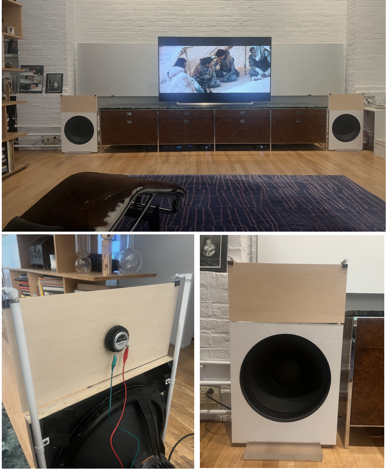

Had a little time today and rethought the center channels... (still playing ;-)
aagas have you considered moving the DML panel backwards to vertically align them with the centre of the woofer top plate? this ought to provide time alignment with the woofer. so I assume that you prefer this new set up over the previous one? thanks for posting.
I have (following fond memories of my first Dahlquist DQ10s).aagas have you considered moving the DML panel backwards to vertically align them with the centre of the woofer top plate? this ought to provide time alignment with the woofer.
That said, I have the capacity to time align outputs electronically if they need it.
Note, both DLM sets and the woofers stand in different planes.
I've already time aligned the woofers and the large panels.
I'll tweek time alignment for the center channel DMLs once I've settled on them.
Currently preparing an aluminum alternative to the Basswood.
Too early to tell, but even just clipped together they sound pretty good.so I assume that you prefer this new set up over the previous one? thanks for posting.

Can you feel the difference in bending in different directions.
The crate ply could bend very easily in the short direction but harder in the long direction.
I did show pictures.
Steve.
Steve.
Similar to your crate ply.Can you feel the difference in bending in different directions.
Far more flexible parallel to the grain.
Hardly moves bending against the grain.
I noticed the other day that the art supply store I mentioned had some thin basswood ply.
Number of plys would matter if one wants equal bending in all directions.
I'll go visit them later today.

This was the sort of flexible ply that I was thinking of.
3mm would be my choice for a small panel ,say 6x9 maybe slightly larger ?
The crate ply was a very lively sounding panel, but needed small weights to damp out the panel exciter self noise.
the weights sorted out this problem and also filled in the suck outs in the lower midrange .
Steve.
