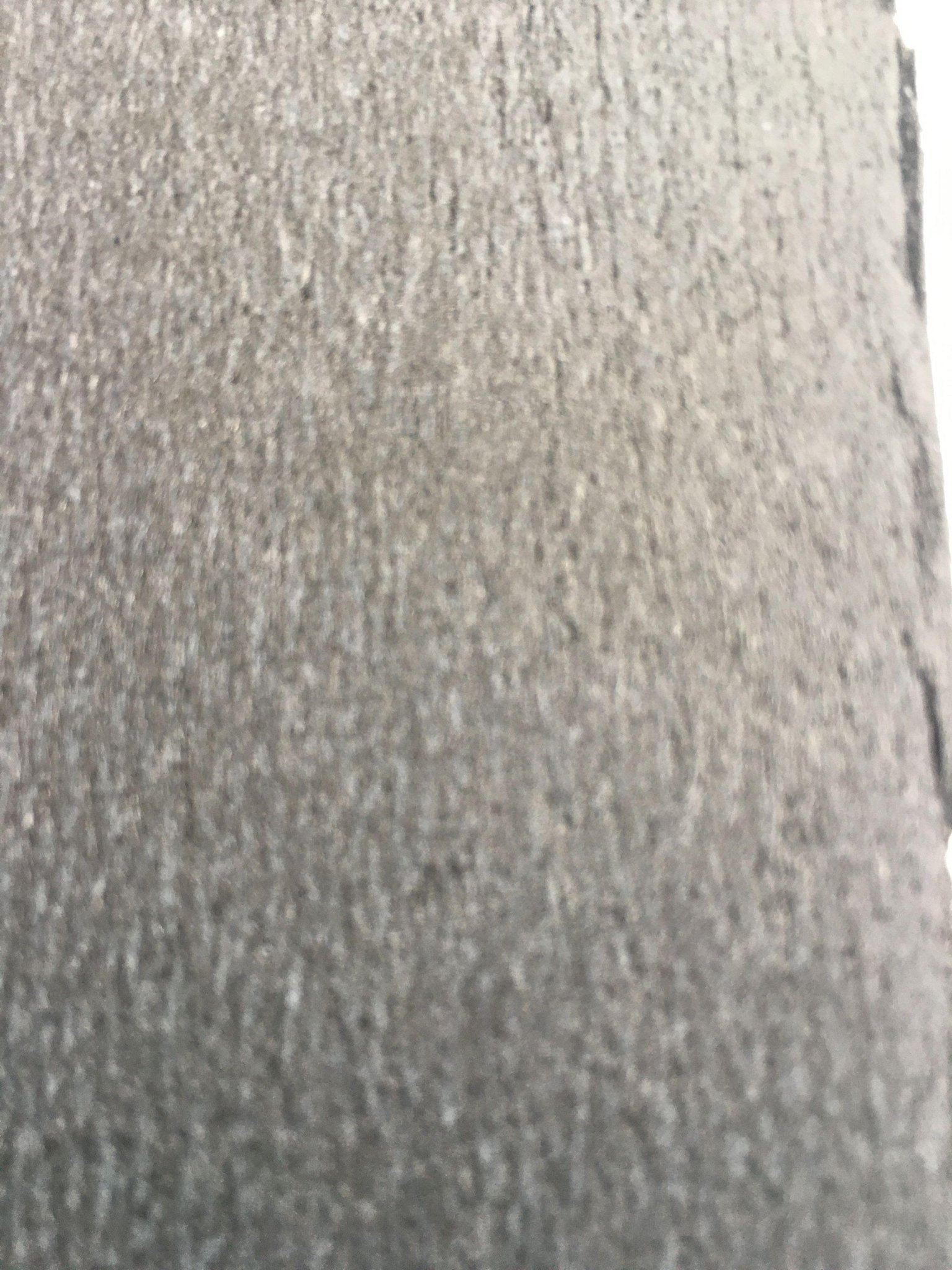

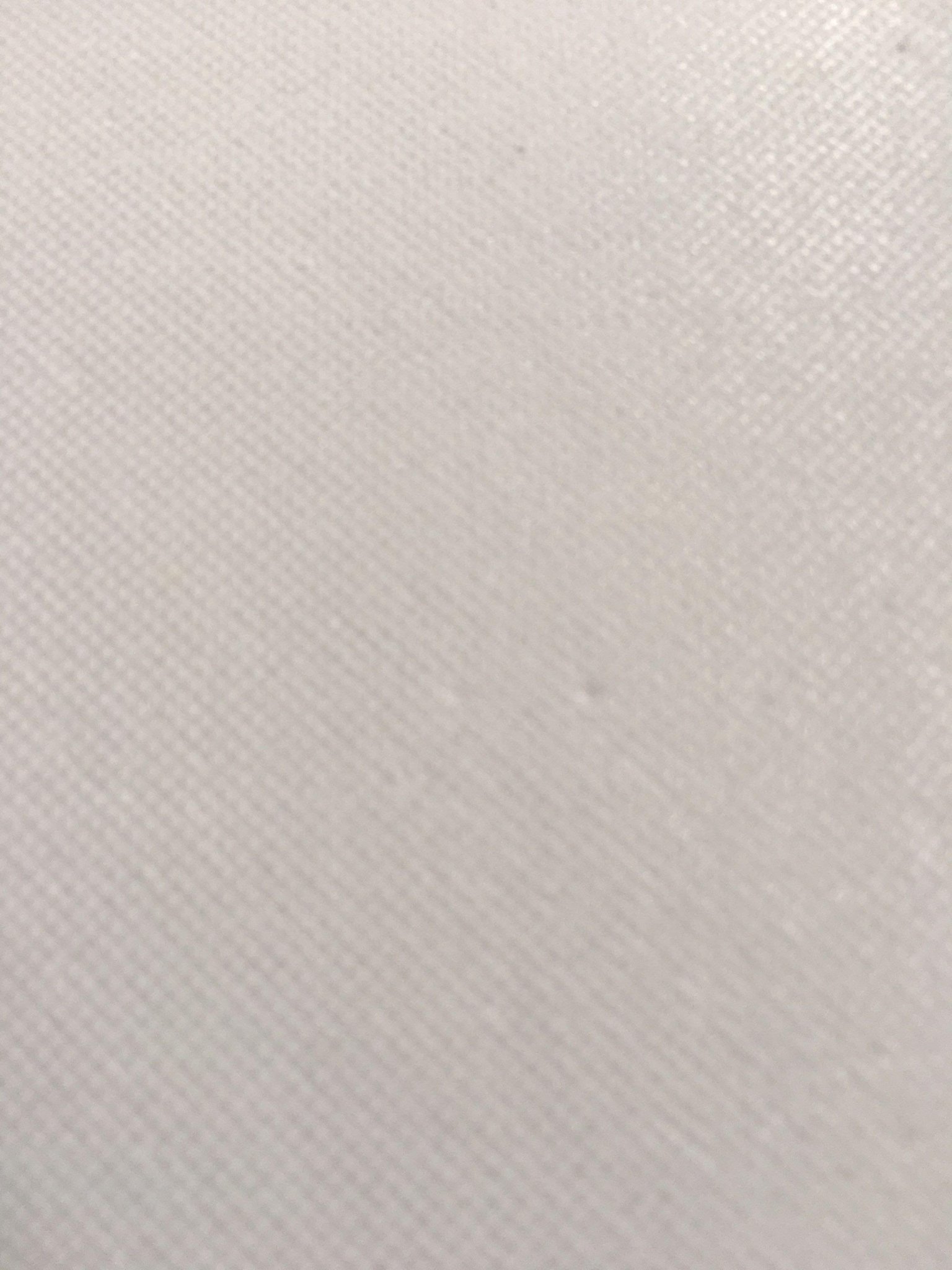

Can you take a photo of the textured surface ?
I seem to remember that the foamcore had a couple of different layers before you reach the xps ?

hope you can see these both skins can be sanded off. for the standard foam-core board the white core looks the same but the black core had better contrast in the photo. Hope this helps.Can you take a photo of the textured surface ?

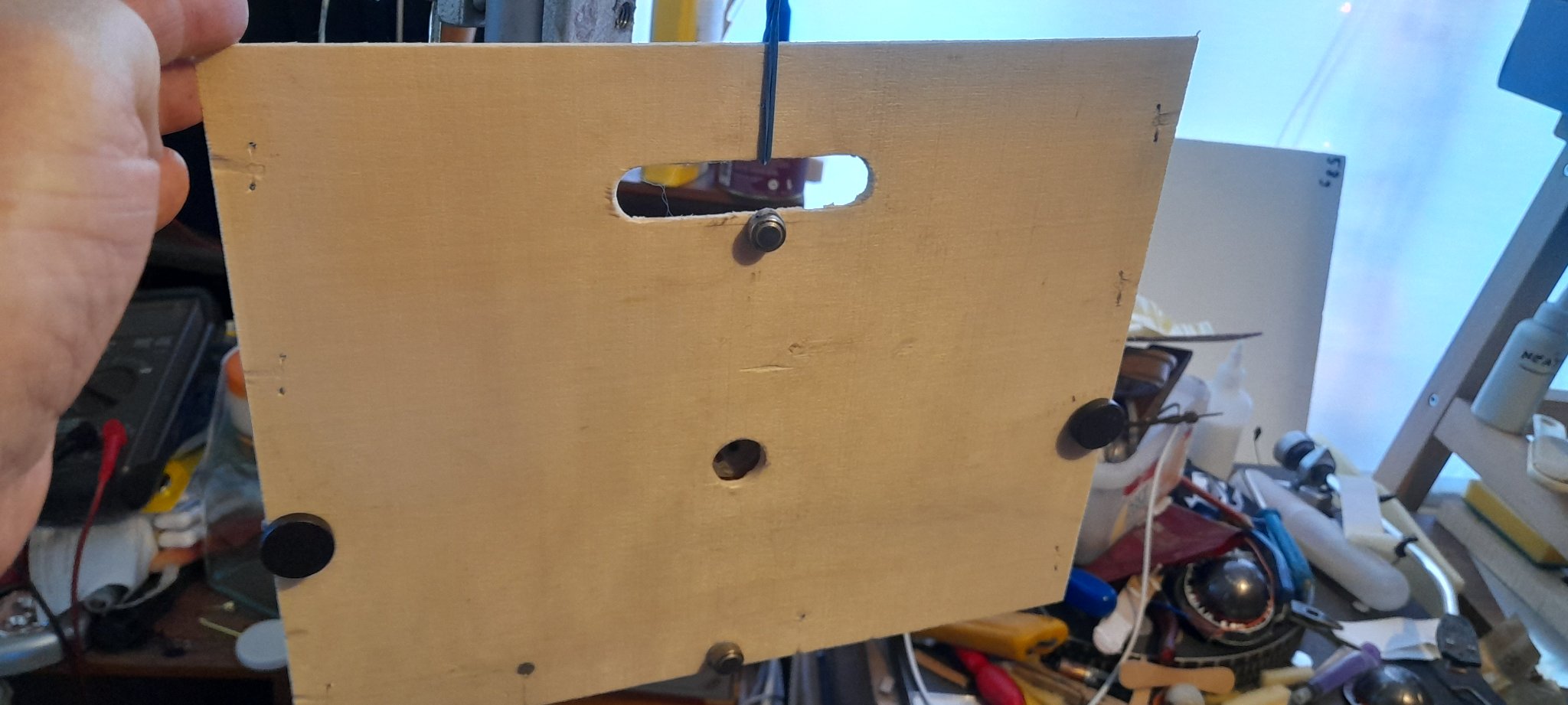

You could try these weight positions on your centre channel panels.
This will hopefully increase the response in the lower midrange and reduce some of the panel and exciter noise.
This works well with my crate ply panels.
Mount the weights at the first four reflection points .
I used magnets to slide the weights around the panel.
You could move them around to find the ideal positions if you have a way of measuring the response in real-time.
Or just use your ears to listen to the increased lower midrange response and the reduction of noise.
If the panel is small enough you can use your fingers around the edges of the panel.
This is easy and it is free, if you do not like it, you can just take them off.
