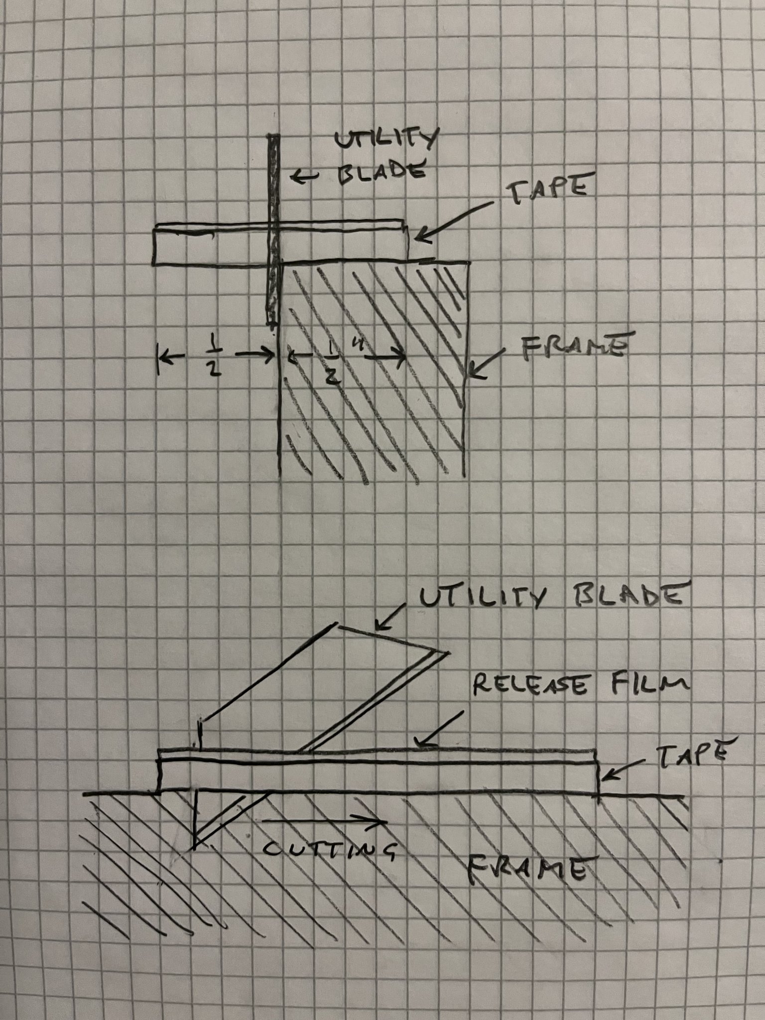

Where I initially got stuck, was on 2 layers of that tape -- I have to somehow cut 100+ inches of the stuff down the center and then layer it? I have a hard time just making a small square that works to stick an exciter to for testing.
Oh, haha, yeah. I've been doing that for so long I forgot it's not so obvious. See below for two section views of how to place and cut the tape. Just mark a line 1/2" from the inner edge of the frame, and apply the tape along the line. At this point the tape is still the full 1" wide, and 1/2" hangs over the inside edge of the frame. Then use the blade of a utility knife to slit the tape in half, using the inside surface of the frame as a guide for the knife blade. It cuts like butter with a sharp blade. Tilt the blade ever so slightly toward the surface of the frame and the frame edge will guide the knife to make a perfectly straight cut along the inside of the frame. Then remove the release film from the tape already attached to the frame and apply the cut piece on top of that. Finally, remove the release film from the second layer, and stick the panel in place. You will want to use some kind of guide blocks to position the panel in place before sticking it to the tape. Place it gently on the tape and make sure it's lined up all the way around. If it's not quite lined up perfectly you may just be able to lift it and reposition it, but maybe not as the tape is really sticky!
Absolutely. I'd never say anything about your design without first having executed the build to specs.
Some details are not that critical, as the design is pretty robust. A single layer of tape works fine (instead of two), and it can be a little wider or narrower and have little effect. What's most important is

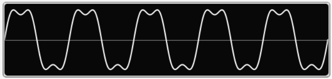

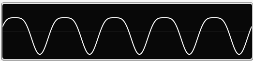

Having a 2nd order means the displacement is not the same when coil pushes or pulls
Yes, agreed. Here's exaggerated 2nd harmonic distortion at -12db@90° to the signal. This is a sig-gen waveform for demonstration only.
For this reason I prefer to place foam tape on both the front and back of a panel, and gently clamp the whole assembly in its frame. The other problem, of course, is that exciters drive only from one side, and 2ndHD might be compounded not only by changing of BL as the VC moves in and out of the magnetic field, but also from possibly varying panel/edge/skin differences in the forward vs backward directions. I'll have a design, somewhere in the future, where the drivers would be placed both sides of the panel, but this could create the problem that the motor magnets interfere with each other... drawing board here we come...
3rd harmonic, -12db@0° to the signal.
It's the lack of 3rd harmonic distortion that makes DML panels sound as-if they go into over-drive without warning. Cone speakers generally increase in 3rd harmonic as they get near their excursion limits, and then gradually go into full-blown over-drive. But (thanks to VC driver limits) a DML can go directly into excursion limiting without warning when you over-drive the exciter. This might be why DMLS might not sound "as loud" as cones do eventhough the SPL levels can be measured to be the same. The gradual increase in 3rd HD in a cone can make it sound "louder" than it really is because of the onset of excursion limiting.
What I'm saying in my previous post, is that if a panel is designed incorrectly, especially if the edges are not properly damped for example, then 3rd HD will quickly become an issue because of over-excursion in the panel material. I also suspect that if some the panel anti-nodes are allowed to over-resonate because of improper driver placement, then 3rd HD might also be an issue.

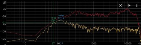

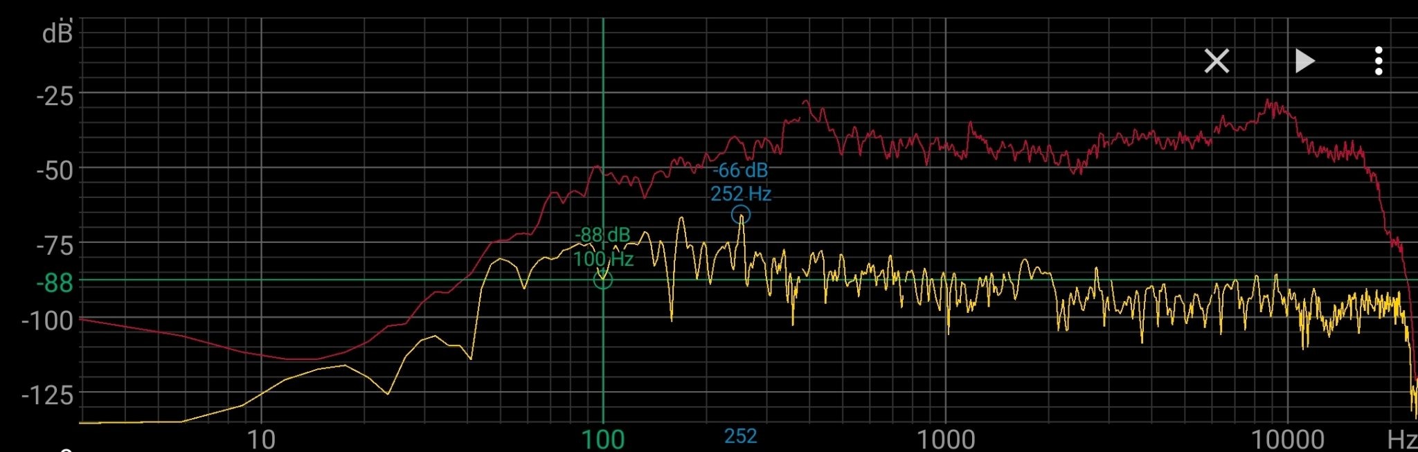

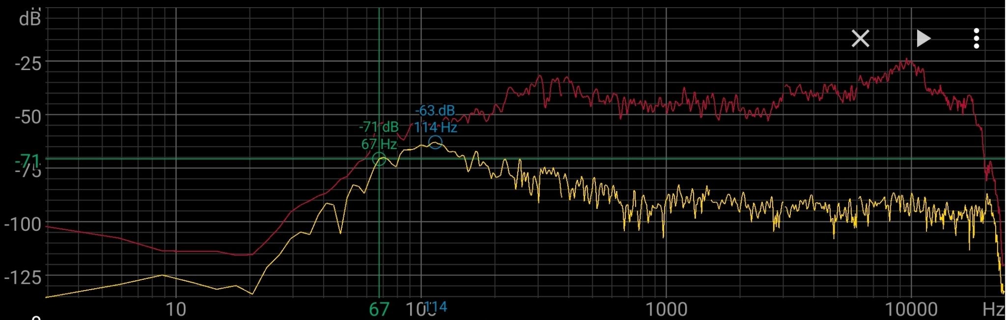

I have a pair of those also, will also test then this weekend against my other panels with Dayton DAEX32EP-4
Current setups that I'm "running" now are :
45cm x 70cm, 5mm PPP Celular panel on wood frame, 1x Dayton DAEX32EP-4
40cm x 60cm, 4mm Plywood "floating" on Cotton/Linen Canvas, 1x Dayton DAEX32EP-4 (I think that I've never seen this kind of "setup" here in the forum)
They both sound amazing (to my ears, at least), lets see how those Xcite drivers perform on EPS with Kraft paper on both sides (current built)
Attached some frequency sweeps plots (done with my phone spectrum analyzer) from my panels, ignore the yellow line (that was the real time feed), the red line are the "tops" registered (panel response).
I currently don't have a reference mic to do some plots, but next time I'll try to use my tablet built-in mic with REW to share with you all my efforts.
Stay tunned ;-)

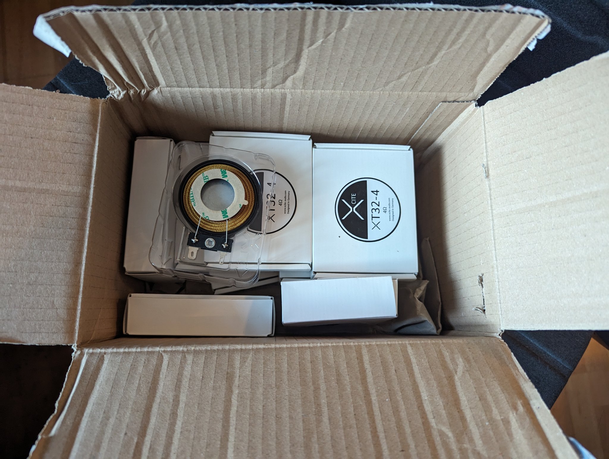

Unfortunately it will not be all fun and games. Soundimports wants me to test each exciter and record a video with the ones with issues for the warranty claim. They will only accept warranty for the exciters that already developed the issue. I guess that is fair enough, but not sure I'm confident to bother mounting those on new plates.
Just removing 64 exciters glued to their plates will probably at least keep me busy most of the weekend 🙁
Put together a test plate with a scrap GPS plate where I removed old exciters and put on some X32-4 instead, just using the provided VHB tape.
I improved suspension compared to old plate, so not really and A/B test against the Dayton's, but it is like night and day. X32-4 plates sounds so much clearer and punchier! The old plates really sounds like a smeary mess in comparison...and I used to think they sounded great 🙂
Will do some measurements eventually, but have a lot of work with scraping off old exciters this weekend...
But the difference is so clear I don't need measurements to decide that I'm definitely going to replace all the Dayton's.
