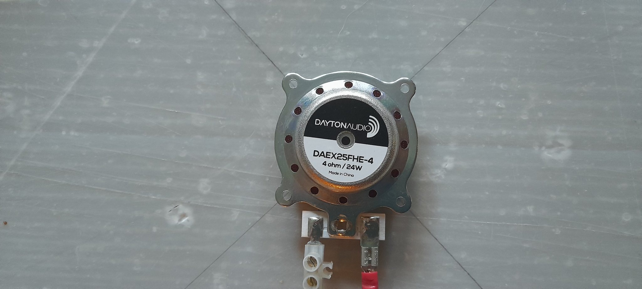

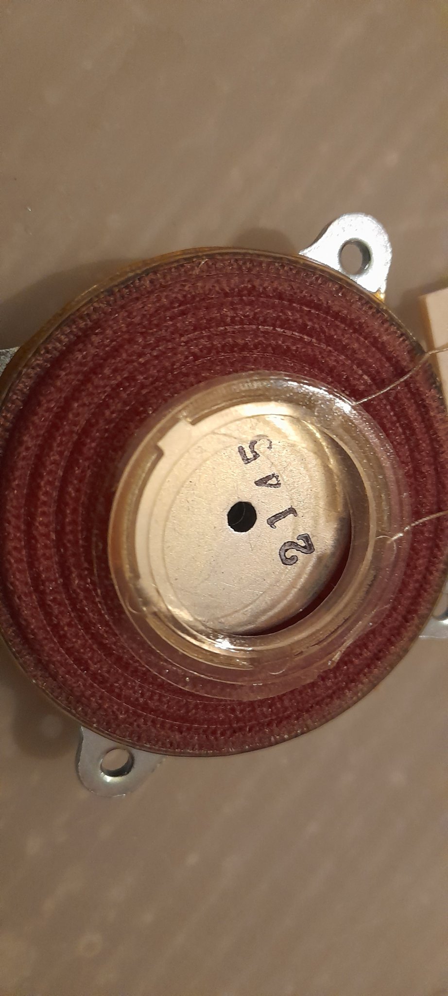

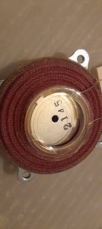

I just attached my new exciter to one of my panels, to compare the performance against my 10 watt exciters.
One thing I did notice was the rubbery , sticky tape that sticks the coil foot to the panel.
It was a little too rubbery for my liking, this does not bode well for hf, I think, we shall see.
Also in this picture, you can see that the tape is quite a bit larger than the coil foot.
I do not know how well I can attach the overhang to the panel ?
This might cause problems?
But it is good enough for testing.
I will use a more permanent glue later.
I will not be testing this for a week or two, as I am a little busy.
Steve.

The new exciter also has a better magnetic screening at the back.
I hope its not a weaker magnet?

Would be more helpful to know what (name, model) this new exciter is?I just attached my new exciter to one of my panels
It’s the daex25fhe-4
Steve mentioned it earlier but it’s a couple pages back now.

If an exciter had a ferrite magnet, I wouldn't use it.The new exciter also has a better magnetic screening at the back.
Steve.
The 'weight to power ratio' of neodymium as an absolute must!

It would be very nice if I could get a few more DBs from my heavier panels.
The new 25watt exciter looks very similar to my 10watt exciter, but with a metal cage at the back .
It will be very interesting to hear the difference between the two identical panels .
I expect them to sound very similar, but I am a little sceptical about the sticky tape, I would prefer a more solid mounting.
Steve.

I to have wondered about the 'sticky tape' mounting of my 40 watt Daytons.but I am a little sceptical about the sticky tape, I would prefer a more solid mounting.
The tape is said to be a premium 3M product, but because I am using twin exciters > 80 watts
I am expecting quite a lot of panel movement at higher volume levels 😕
I think I will start with the tape, and if need be, move on to 2 part epoxy.
