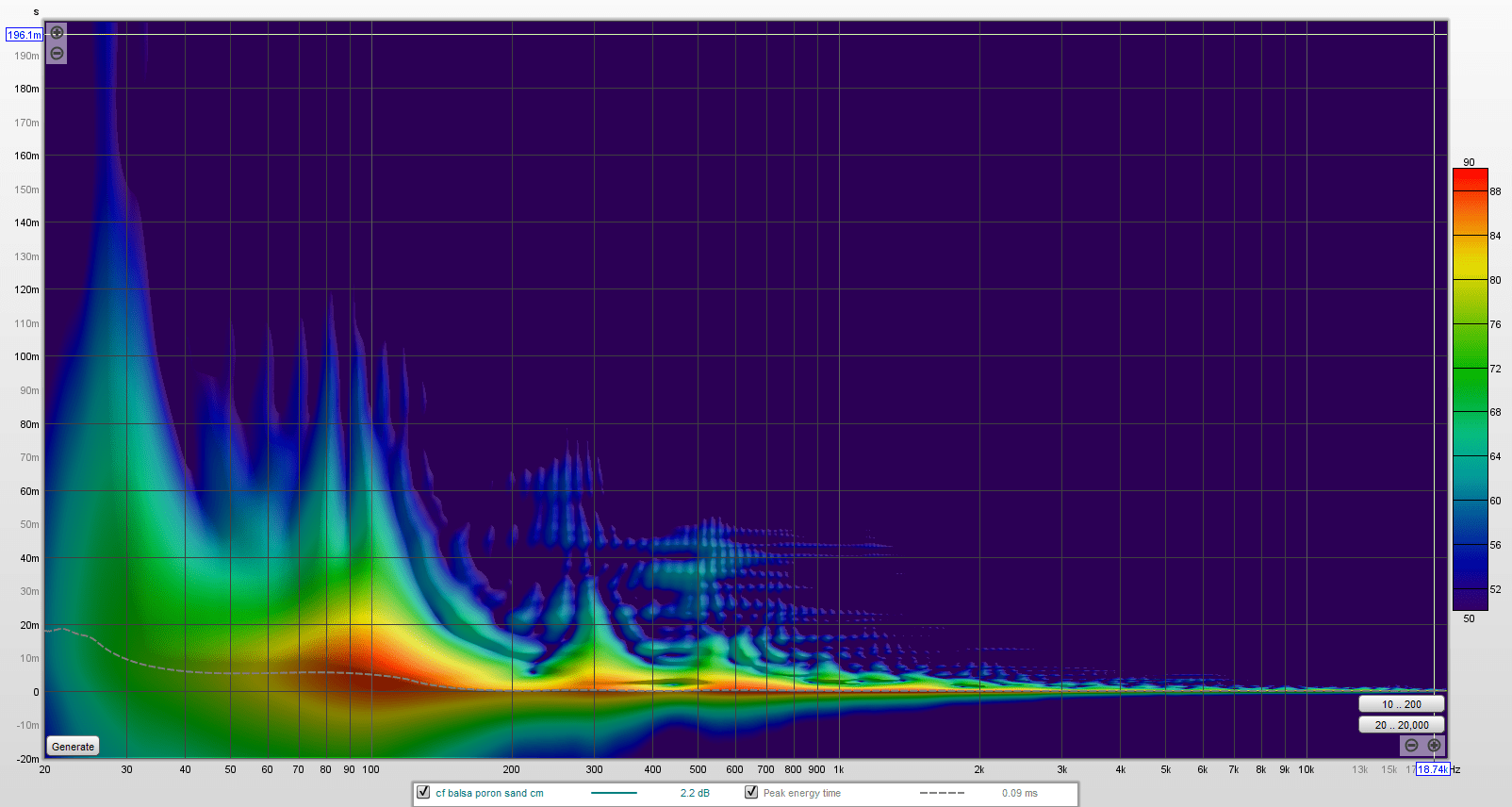

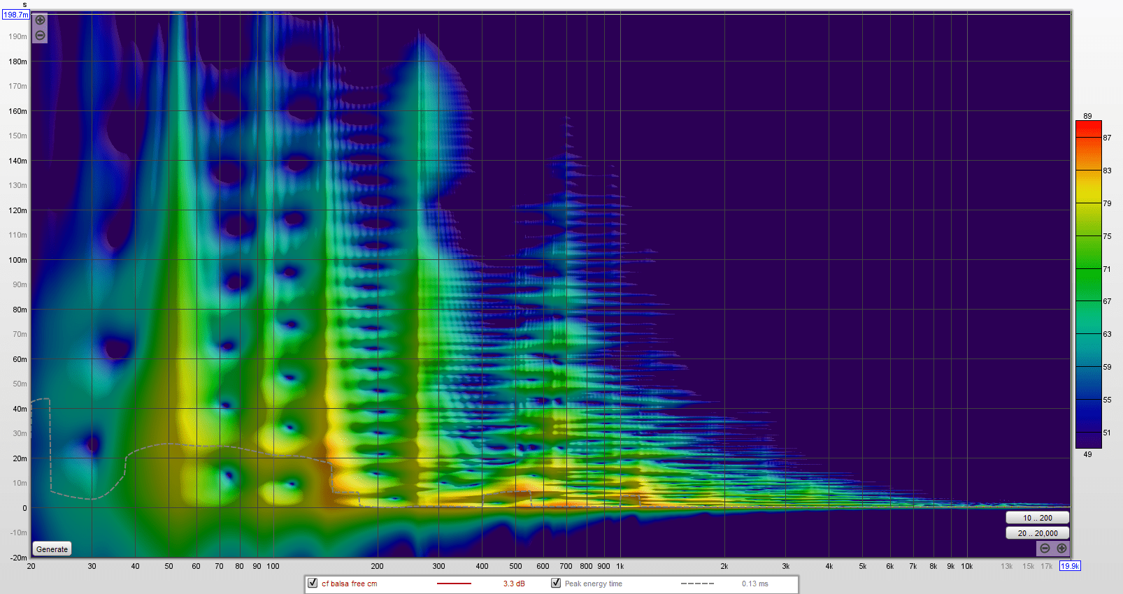

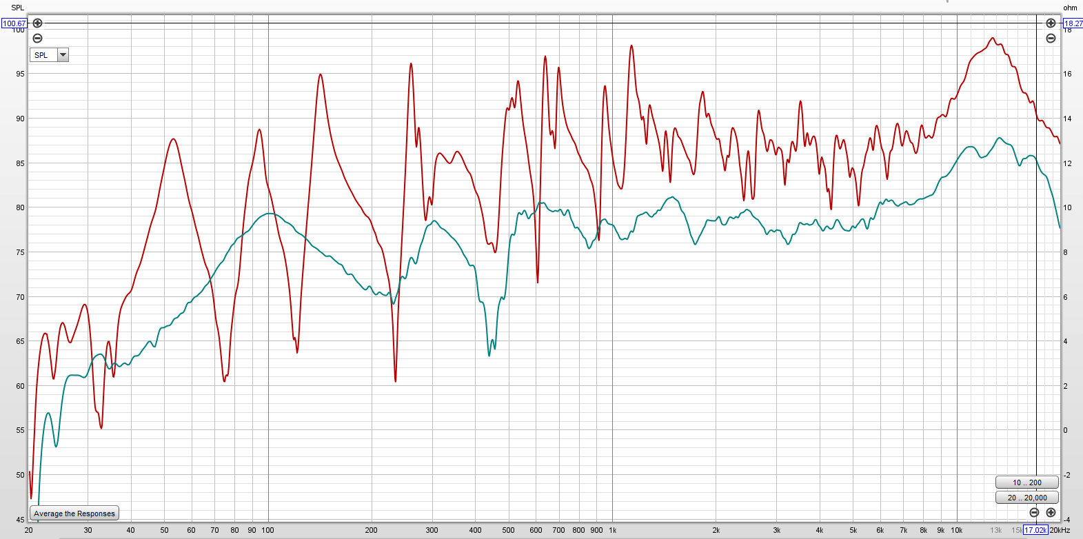

Here is a comparison of a "close mic" measurement of two identical panels, one hanging freely with no added damping, and the other attached to a frame around the entire perimeter with an effective damping foam. The "close mic" measurement gives a result that approximates the measurement you would get from an accelerometer and gives you an idea of how the vibration amplitude of the panel varies with frequency at the location of the mic. In these particular measurements, the mic was placed directly opposite the exciter, but other locations give results with the same basic character. That is, with an undamped panel (red curve), the vibration amplitude varies wildly with frequency. In contrast, the vibration amplitude of the damped panel (green) varies much less as a function of frequency. Basically, damping reduces the sensitivity of the panel to frequency, reducing its amplitude at resonances, and increasing its amplitude between resonances.
So yes, it affects the panel at all frequencies, and in a good way. With effective damping, there's no need for haphazardly adding weights or cutting angles, hoping (mostly in vain) that it will help reduce a nasty resonance at one frequency without simply moving it to another.
Spectrograms of the same two measurements are show below (undamped above, and damped below). Everyone should decide for themselves which is more likely to faithfully reproduce a recording.

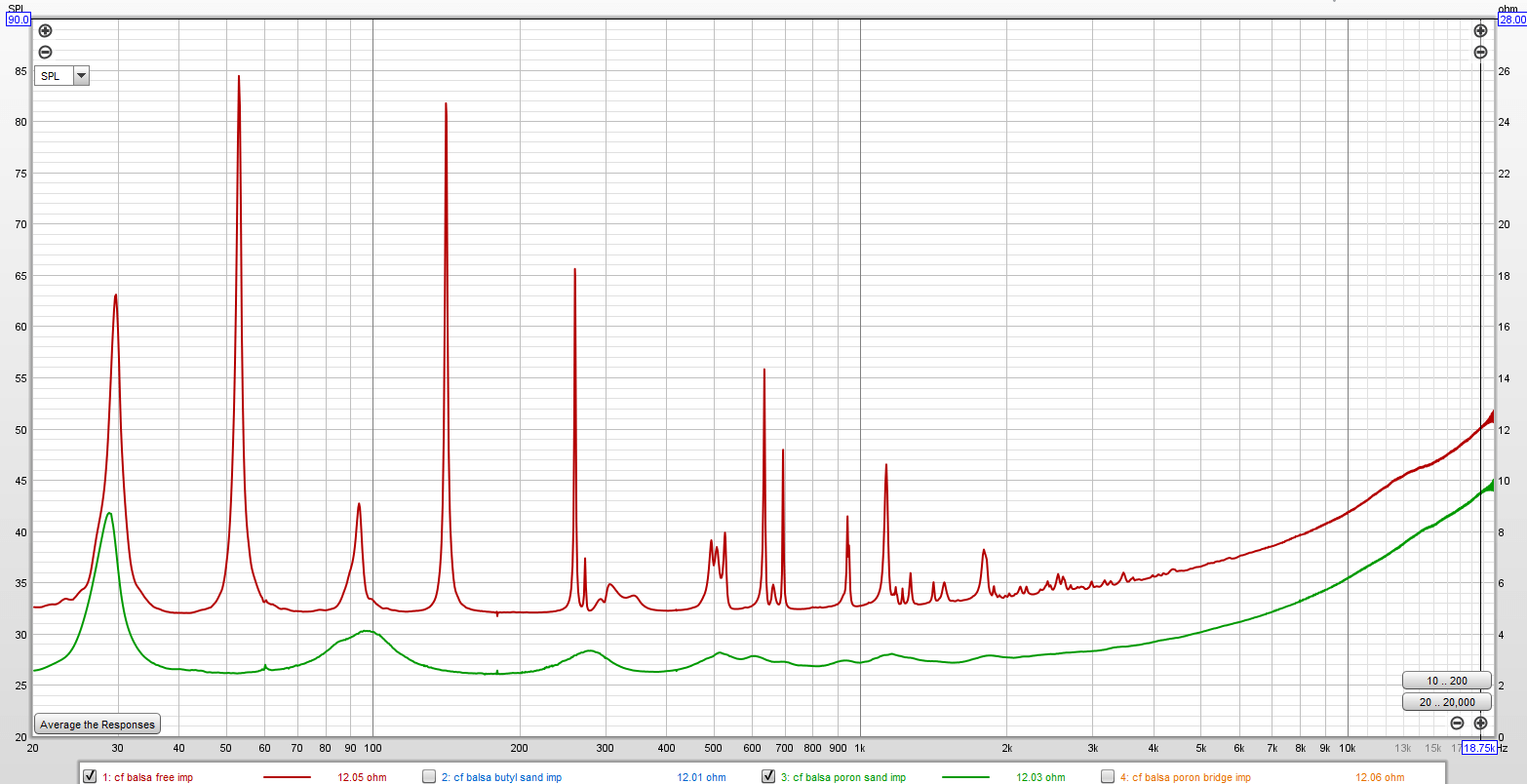

And just to be complete, the final plot below compares the impedance curves for the same panels (again offset for clarity). It should be clear which is which. Both results, (close mic, and impedance) suggest that the impact of damping is strongest at lower frequencies. If you use your panel only for higher frequencies, maybe you can get away without damping. But if you want to use your panel in the lower range, where modal density is low, I suggest to consider added damping,

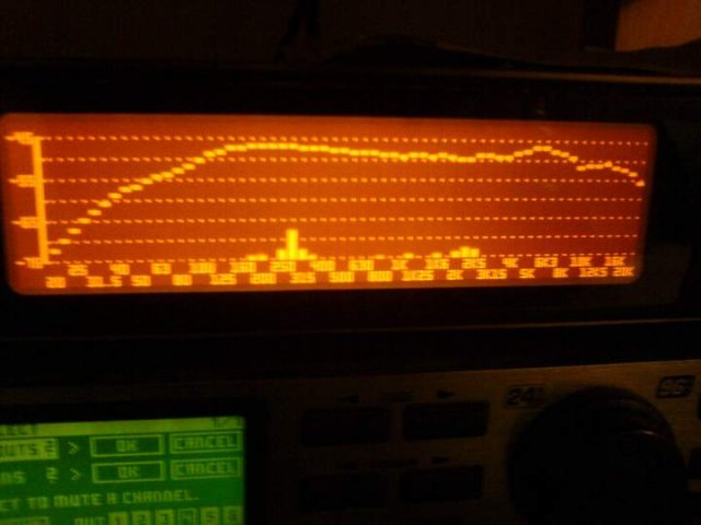

It amazes me that the so called professionals on this forum do not understand the meaning of self noise.
Does wood sound like wood, does metal sound like metal, does concrete sound like concrete?
Here is a heavily damped free floating panel frequency measurement i made about 15 years ago , mmmmmmmm is it not wonderfully smooth ?
It is a dream come true 😍
What do you think it sounded like?
Steve.
