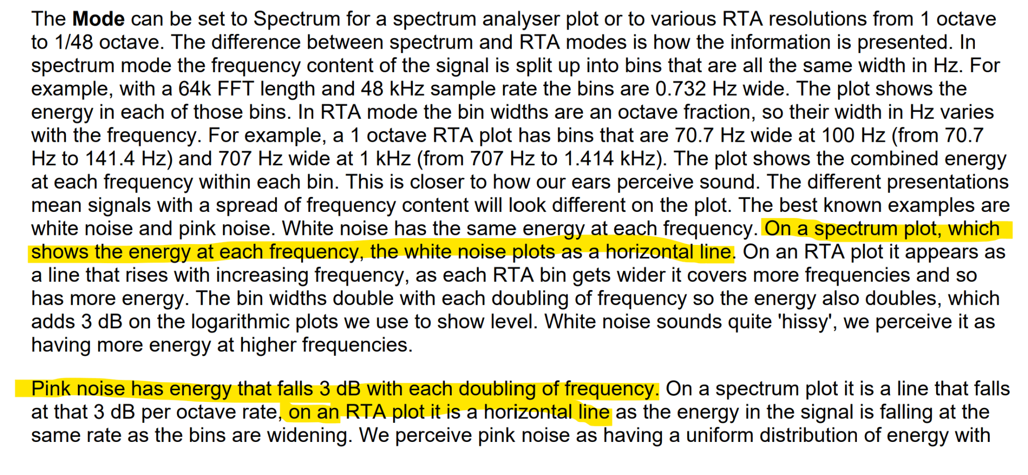

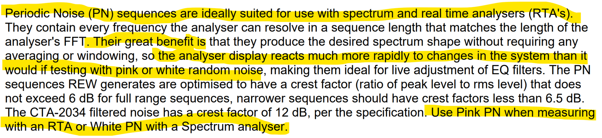

1. Difference between pink noise and white noise, and it's not just an arbitrary thumb-suck:The full spectrum aspect of white is why I suggested using pink isn't a good idea. Pink mean checking that the speaker is producing a true pink spectrum.

White noise consists of equal energy per frequency and pink noise consists of equal energy per octave.
https://audiouniversityonline.com/white-noise-vs-pink-noise/

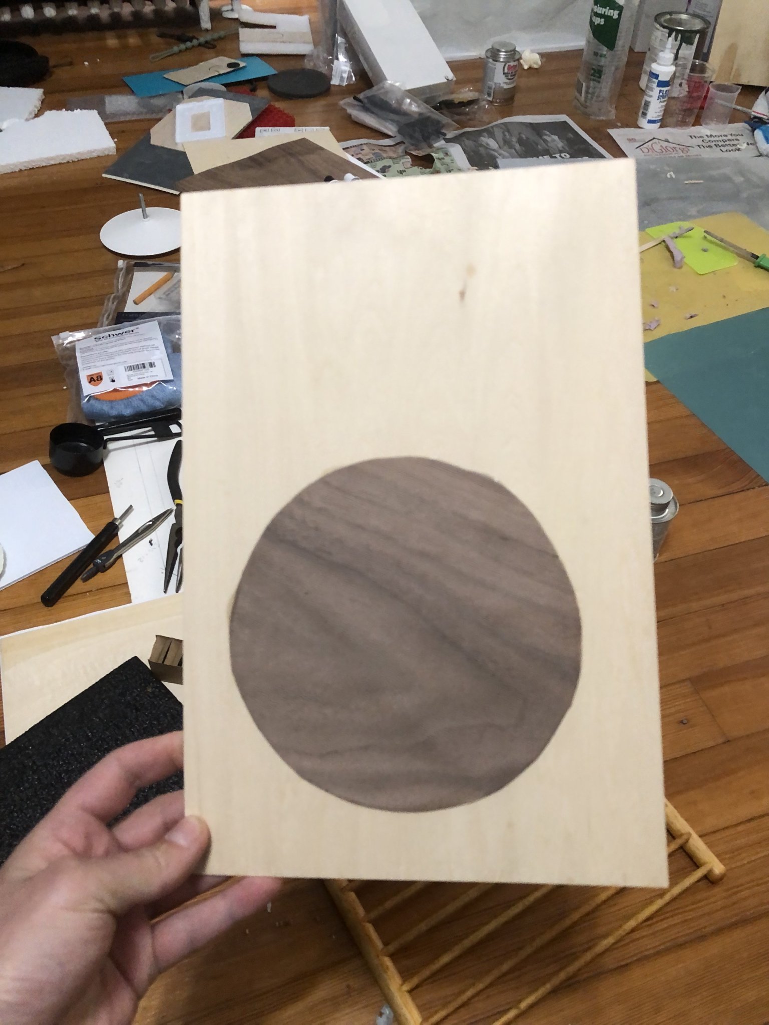

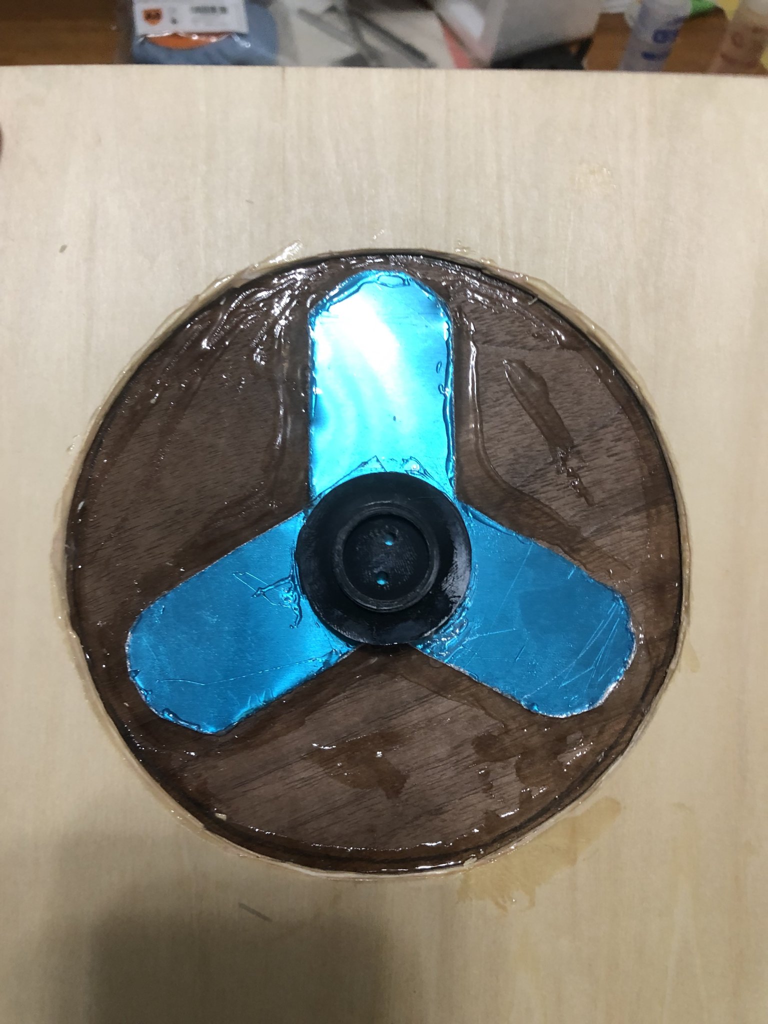

Weight mitigation:
You can use a small part of a denser material (garolite, aluminum, carbon fiber, cardboard for example) on a surface to get a portion of its sound profile without covering the whole panel and weighing it down but to get the most audible resonance profiles from the material, it needs to be where the exciter is attached to, as in exciter then aluminium then your composite panel.
For example, a normal panel might be:
20x30cm panel made from fibroid fish paper then 3mm aramid honeycomb then walnut veneer sealed together using rubber cement.
To add some of the higher frequency resonances from garolite, or some of the flat midtones of basswood, you can make a flat disk (5-10cm), or a tri-armed brace (pictures provided). Attach that to the panel, and then attach the exciter to that.
example: Tri-arm of aluminum on walnut veneer on basswood with epoxy
View attachment 1173256 View attachment 1173257
Does this "composite board" have video or sound (Youtube, FB)? Is there an SPL curve?

@xsuper9988 thanks for asking.
No I’ve not done any YouTube videos but I could give it a try.
I have an SPL curve the composite and it’s sub components.
But for examples sake it’s probably cleaner if I make a new panel tomorrow and do measurements/photos/videos as I do it.
That photo of the triarmed thingie above (does that shape have a name?) was part of my tweeter quest. Sadly its strength is not as a tweeter. But the aluminum on the veneer did have a great sound and volume, however it needed to have its edges fixed to stop the distortion from the thin wood flapping at lower frequencies. Attaching it to the basswood panel like that allowed it to emit sound from the basswood with any extra energy it had.
I totally got too messy with the epoxy on that specific experiment and so the resulting sound is more influenced by that than it is meant to be.
Ill do a fresh one with carbon fiber (2 swelling peaks and dips) and cardboard (spl starts high and tapers down as freq increases with a couple of plateaus).
It’s 6am here, so once I shoo my family out the door to school and work by 9 I’ll go do the experiment.

Hi Jamie
I'm wondering about boundary effects/interferences brought about by all the interfaces involved in these multilayer/multi-join panels.
We know that density and thickness changes cause issues with reflection, velocity differentials etc within the panel..Seems like you have a rich mix of all of these here.
And I still can't get to grips with how the waves are transferred evenly past the slots to the outer surfaces of the panels in the case of the ortho planar springs.
Any thoughts/explanations?
Eucy
Eucy
@Eucyblues99 well yes it’s kinda crazy right?
The composite lamination panels have all of the layers vibrated from the same point, even if each of those layers transfers the waves at different speeds, when they are layered you end up seeing an averaging effect.
This is noted in one of the papers I posted a link to recently. So that’s part of the effect I suppose.
From observation, A portion of why the orthoplanar spring works to flatten the response is because it is reducing the transfer of the low hz frequencies by converting it to heat via the spring much like damping does. Thus it puts the lower frequencies on a similar spl to the higher frequencies.
It’s possibly obvious But I don’t have a background in audio engineering or physics. So I have few fundamentals to work from. I am reading a lot of research papers right now to catch up with the state of the art and help guide my experiments.
So I don’t have an answer for how it’s all working specifically.
I can only describe what I am seeing.
So far most of these discoveries have been a surprise.
I have a umik-1 for measuring and I have a 6 way audio switcher with an exciter on a cable connected to each of the 6 channels. And so I can connect and disconnect several things at once, listen/measure to them individually or together. So i guess it made it easier to notice the changes between runs and therefore patterns that came up.
Concerning the use of white or pink noise that was recently discussed, I don't think one other is "better". For me, the important thing to understand is what to expect the analysis curve to look like like with each of them. If you are plotting frequency response using a spectrum analyzer, white noise should appear as a flat horizontal line, while pink noise should have a response that falls with frequency. On the other hand, if you are plotting frequency response using an RTA, pink noise should result in a flat line, while white noise should have a response that rises with frequency. When I'm doing tests using noise, it's simpler to look for a flat line than to look for the correct slope, so I tend to use pink noise with an RTA analysis mode.
Below is a snip from the REW help file:
To be a little more specific, I typically use pink periodic noise, rather than random pink noise, for this reason:
Although I will admit that sometimes I find pink periodic noise give me a little feeling of anxiety sometimes! Anybody else feel that way?
Eric
Eric
Eric, I find that I can use white PN, live, and get exactly the same FR as a straight forward log sweep (given the same smoothing.)
I generally use pink noise for bandwidth-limited sub-woofer tests, or for background noise masking.
How did you manage to get a flat response from pink noise in speaker tests?
I have a sticker on my pc screen display with these written on it:
Linear sweeps and white noise:
flat on FFT
rising at 3dB/oct on RTA
Log sweeps and pink noise:
dropping at 3dB/oct on FFT
flat on RTA
FFT: bins of constant width in frequency
RTA: bins of constant width in octave
White noise: equal energy per Hz bandwidth
Pink noise: equal energy per octave bandwidth
George
flat on FFT
flat on RTA
George

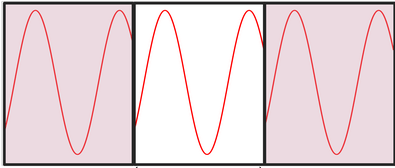

Digital signal processing being based on a way or an other on FFT, making the signal periodic avoid any question of window or what is known as window leakage. The secure way to understand FTT is to imagine it sees the signal as if it is periodic. So if the signal ends at a different value it finish this create a jump (see below) and creates artifacts (not real spectral content)
2 solutions :
- a window function that forces to 0 the beginning and the end
- a signal having a periodicity in an integer relation to the FFT length
