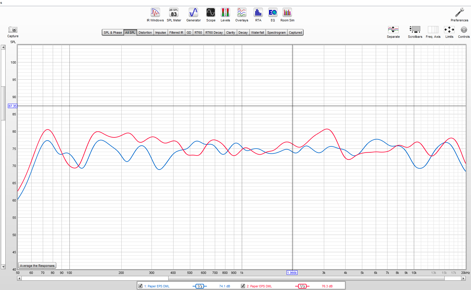

What are the blue and red traces?

Red and blue were right and left speakers. I'd built two of them. I think the one used slightly more glue to stick the paper to the EPS, but I don't remember which is which. I'll have to go back to my notes.Your famous compound... that I don't understand how it works!

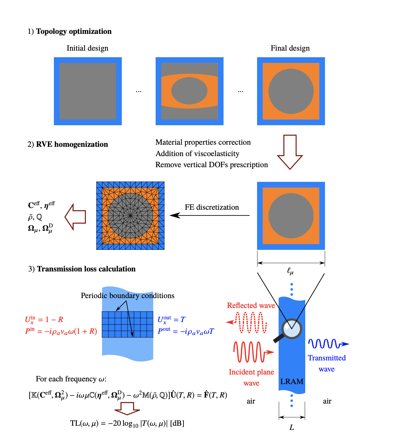

First, though, I don't think that calculator is what you want. The calculator is based on longitudinal pressure waves, but those are not the waves that produce sound in a plate. The waves that produce sound in a plate are the transverse bending waves, that (unlike longitudinal waves) are a function of plate thickness and frequency.
If what you want is to create a resonance in the plate at around 7000 Hz, you can do that by sizing the plate correctly. I did a quick FEA model of a 3 mm thick glass plate (simple supports) and it gives the 1,3 mode at 7000 Hz with lateral plate dimensions of about 78 x 107 mm, for example.
But you don't need FEA to get this result, there is an analytical solution here for the modal frequencies of a simply supported plate:
https://www.comsol.com/multiphysics/eigenfrequency-analysis
look for the section titled "Plates" around 2/3 of the way down the page.

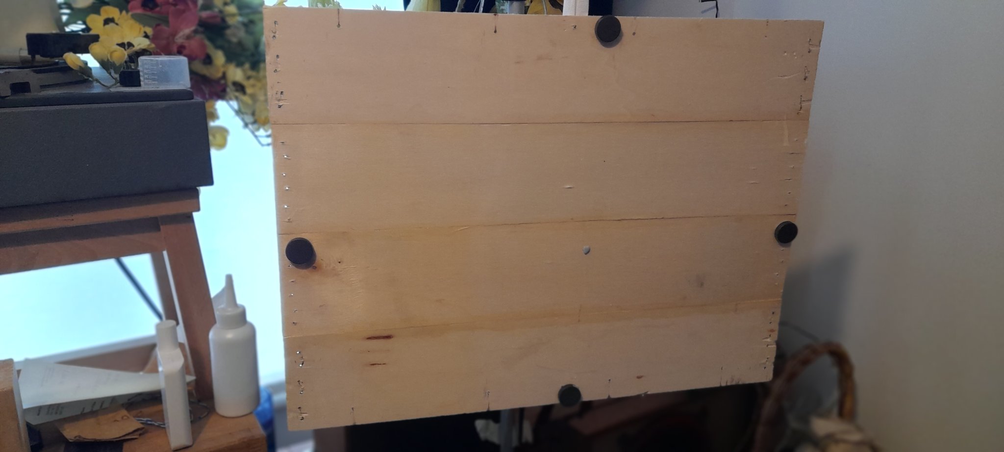

I spotted this article on line yesterday,and at the bottom of the article there is some laser graphs showing a distribted mode panel .
If you look you can see the pistonic area in front of the exciter coil.
But what I found interesting was the cross shape caused by the first direct reflections to the exciter.
If you look at my photo you can see my crate ply panels with the weights I use to prevent exciter/panel noise, which for some reason was very bad on this panel material?
It also helped to fill in the low frequency dips for better low frequency performance.
Is this a coincidence that I chose these positions for best sound ?
These points would also make good points for mounting the panel ,two for the price of one.
I will leave you to debate, if you are interested.
