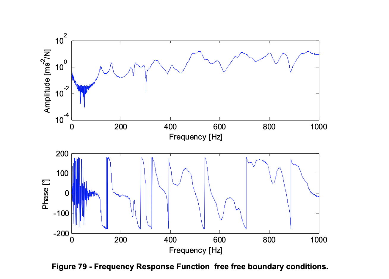

I'm curious if the impedance peaks correlate with panel natural frequencies. Did you (or would you) do some tap tasting to find the natural frequencies?
Eric
I made some tap tests on samples of PP ( a square and rectangular shape) but not on the shape of the panels... I was wondering how to do it... As the exciter was only temporary attached (double side tape), I can quite easily make a tap test with the membrane with the suspension. As the mass and the stiffness of the exciter change the modes, I can make a test with it in place. What conditions would you like to see?
Christian

Hi Christian,I can quite easily make a tap test with the membrane with the suspension. As the mass and the stiffness of the exciter change the modes, I can make a test with it in place. What conditions would you like to see?
Christian
I was thinking of the tap test with everything exactly as you did the impedance test. With the membrane on the suspension and the exciter in position on the plate. I would suggest tapping and mic-ing at the exciter position first, to see if any of the peaks you saw in the impedance test correspond with the frequency peaks you observe in the tap test. I think your impedance test showed five strong peaks below 200 Hz. Does tapping show the same five peaks, or at least the strongest of them?

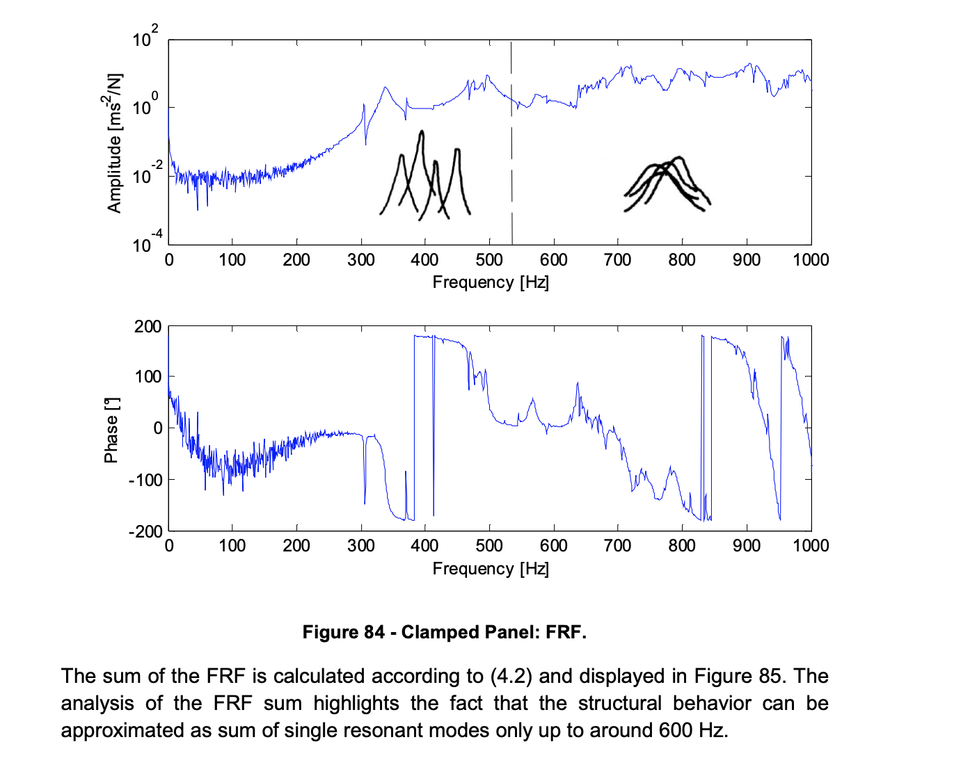

i have been looking into this further. I think i have found out what is happening when i make the ortho-planar spring, and then damp it with neoprene.I wonder if filling the spring slots with silicone or similar would be as effective as the neoprene?
In this publication, the authors have found a way to create and calculate a frequency band gap in a metamaterial, by cutting parts of a 1cm panel away and replacing it with a viscous material.
https://arxiv.org/pdf/2108.06171.pdf
What I found by accident, they were already modelling mathematically.
so to answer your question above, yes it will be effective, but the sound may be different. as in, the neoprene is a viscoelastic foam, and a silicone is an elastic sheet based on the research foams have a non-homogenous structure and thus transfer vibrations in a different way to homogenous structures like a silicone sheet or gel.
Briefly (from what i understand) it describes how the shape of the inner vibrating plate dictates frequency that will be attenuated, and the viscosity of the material around it dictates the width of the band gap it produces.
With the ortho-planar spring i cut into the panel:
- When i make the arms of the spring flexible, it is behaving like the viscous material does.
- When the arms are of the spring are quite stiff still, and the rubber is added to them, then it is also dictating the band gap.
When considering the SPL graph of a commonly used exciter like the dayton ex32u2-4 as an example (30cmx30cm foam core board, infinite baffle) It shows high spl for lower frequencies, and it slowly reduces as the frequencies get higher.
So I assume the reason i am getting a flatter response on my panels with ortho-planar springs is two reasons:
- The higher frequencies are maintained while the lower frequencies are attenuated by a few decibels.
- The higher frequencies are easier to produce for the exciter on this smaller more mobile disc at the center of the spring.
Some new terms:
- The DML panel that we put the exciter on is called a phonotic resonator
A novel metamaterial configuration is presented that combines hybrid attributes from acoustic metamaterials and phononic crystals. The dispersion characteristics of the system, referred to as the phononic resonator (PR), is shown to vary across a wide spectrum of behaviors that can, via optimal selection of inertial and stiffness parameters, be tuned to resemble a locally resonant mechanism, a phononic system, as well as a uniform homogeneous lattice. When coupled with damping elements, the emergent dissipative effect, known as the metadamping phenomenon, of the PR is shown to exceed that of a statically equivalent acoustic metamaterial under certain conditions which are highlighted here. The metadamping amplification is verified in finite PR systems via a power flow approach that depicts the spatial rate of energy dissipation along the length of a 100 cells phononic resonator. - The addition of a cut away damped section is called metadamping
The first notions on the beneficial effects of viscous damping in acoustic metamaterials were reported by Hussein and Frazier (Metadamping: An emergent phenomenon in dissipative metamaterials), who introduced the concept of metadamping to refer to the damping emergence phenomenon produced as a result of combining the effects of local resonance with viscous dissipation
as a side note: this same research paper (page 147) actually points out how dips in the frequency graph are from a coincidence phenomenon, where overlapping modes cancel each other out, which is a problem I had recently.

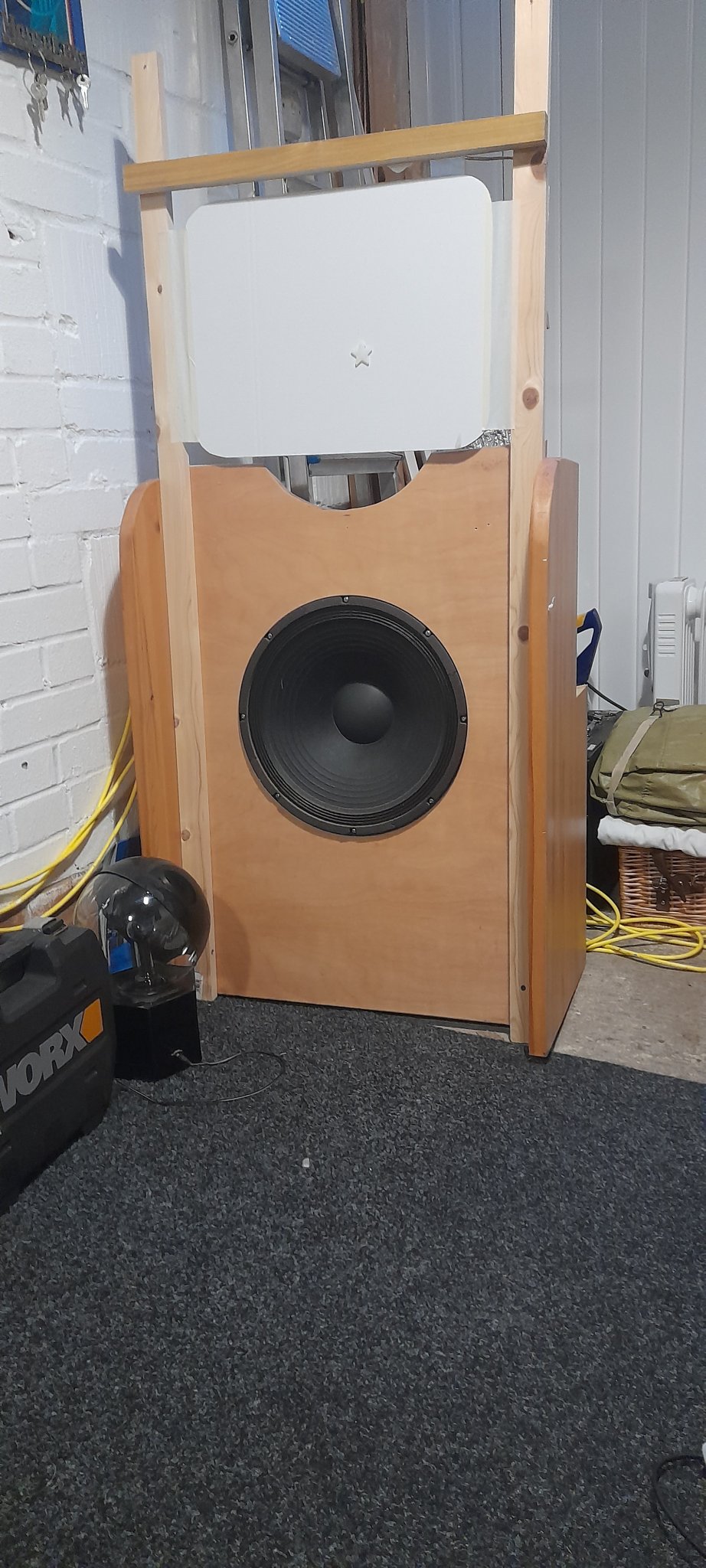

Today I visited my friend that I have not seen for about 3 years, what with one thing and another.
I said I would post a picture of his panels with open baffles, for low end duties .
They sounded very nice and we listened to various types of music.
The panels are about 2mm thick cc.
I took a photo of the panels to post here, it wasn't till I got home that I realised I could have recorded them playing 🙄
We were talking too much , three years is too long.
Steve.

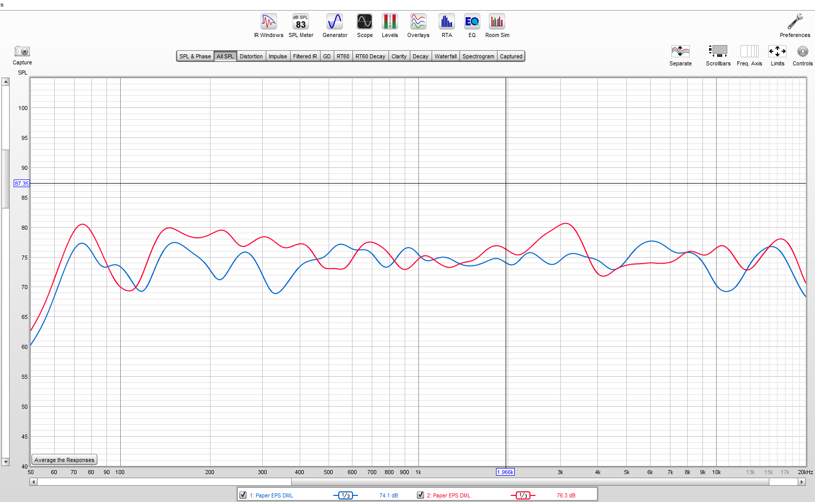

Yes! damping the sides smooths the frequency response out, see images below.It was 5.6 mm 5 ply poplar. I'd have been happy to use thinner if I could get it in 5 ply. This is not to say you can't use 3 ply, but it doesn't work well for my particular design, for reasons I explained in this post:
https://www.diyaudio.com/community/...s-as-a-full-range-speaker.272576/post-7326424
For the surround I used 3M Extreme double sided mounting tape. I chose it because it had good damping properties, or at least I thought so at the time. But now I think I have a better handle on how to assess damping ability, and now I see it as decent at damping but far from the best.
So I'm heading in the opposite direction. I think energy dissipation at the perimeter is a good thing, and that the real challenge is to find materials that provide sufficient dissipation, rather than avoiding those that cause too much.

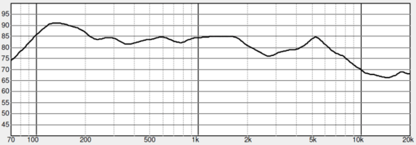

Hi Eucy,Are they not vented already?
Yes they are. From my different tests (plywood or PP), it is clear the hump comes from the rear. Some resonance in the venting path (volume, section change...) is a good candidate for explanation. A specific test should prove it (or discard) the hypothesis.

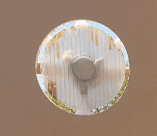

One of my very first experiments was a polycarb disc (100mm dia) mounted by "legs" of hot glue, in a 20mm EPS-paper-skinned panel.My second and more favorite option for dml panels has been by cutting ortho-planar springs into the board, and then covering it 3mm neoprene.
Got a very nice result too.
I think it might be working on the same principles as your ortho-planar design?

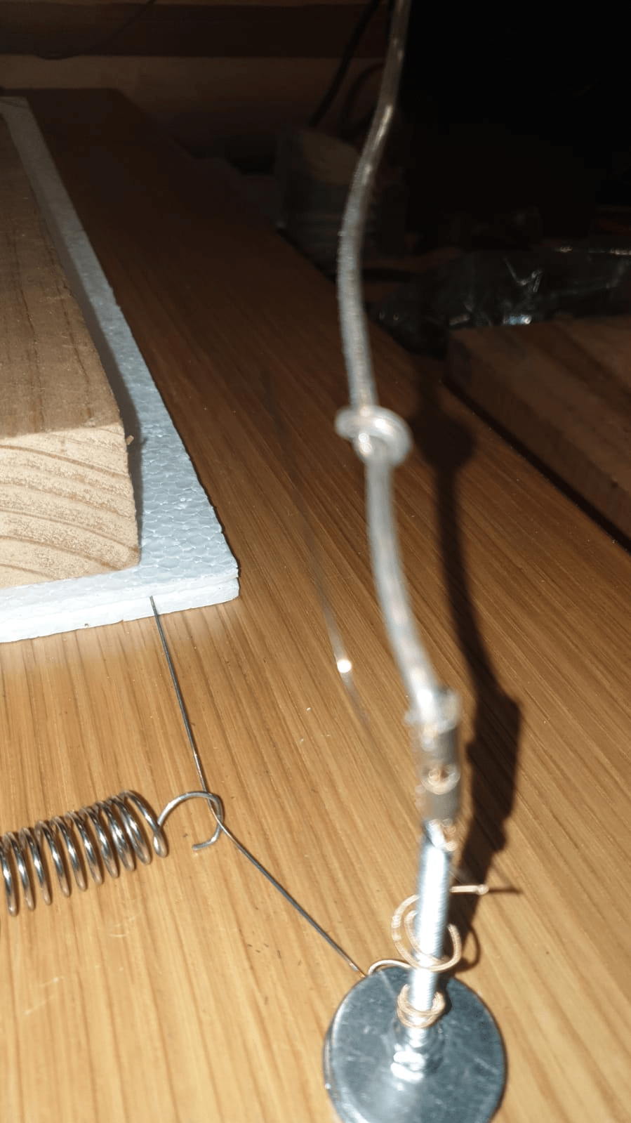

That's a sheet of 10mm-thick EPS rapidly becoming 2 sheets of EPS just-under 5mm each.
I cannot find 5mm EPS anywhere in this wonderful country of ours. And 24V/100VA transformers and nichrome wire are out of the question for the time being.
What to do...
I had a few guitar strings and an old stage monitor amp lying around in a gig bag. So a guitar 'B' string (nickel-plated steel, 0.3mm thick, 3.5ohms per metre) seemed just the right thing, and the amplifier could deliver a clean 100W (which was way too much anyway) into 4 ohms. So I fired up REW's sig gen with a 400hz sine wave (why not?) and got me some 5mm EPS panels from a 10mm panel.
Now the next problem is to laminate 0.5mm veneer onto EPS. That's a very serious PIA: Cold glue will not cure in a laminate press (no airflow). Solvent glue eats the EPS. Water-based PVA makes the veneer expand and wrinkle. Epoxy resin leaks through the veneer and sticks to the press itself, but it's too heavy anyway and doubles the weight of the panel. Contact cement either eats the EPS or it makes bubbles under the veneer.
Back to the drawing board.
