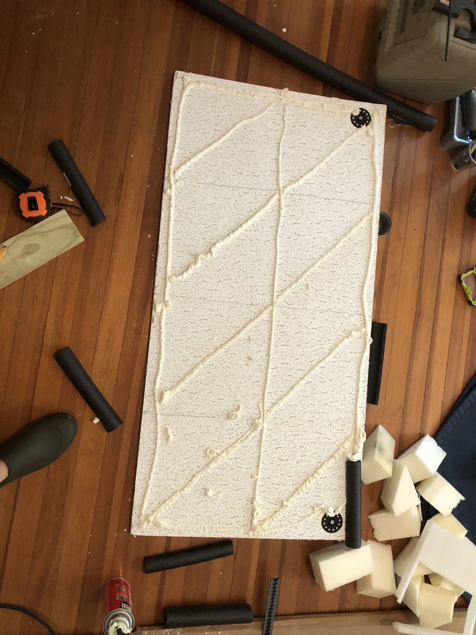

I spent a while today building 60x120x8cm sound absorbing panels so I can get a more accurate reading.

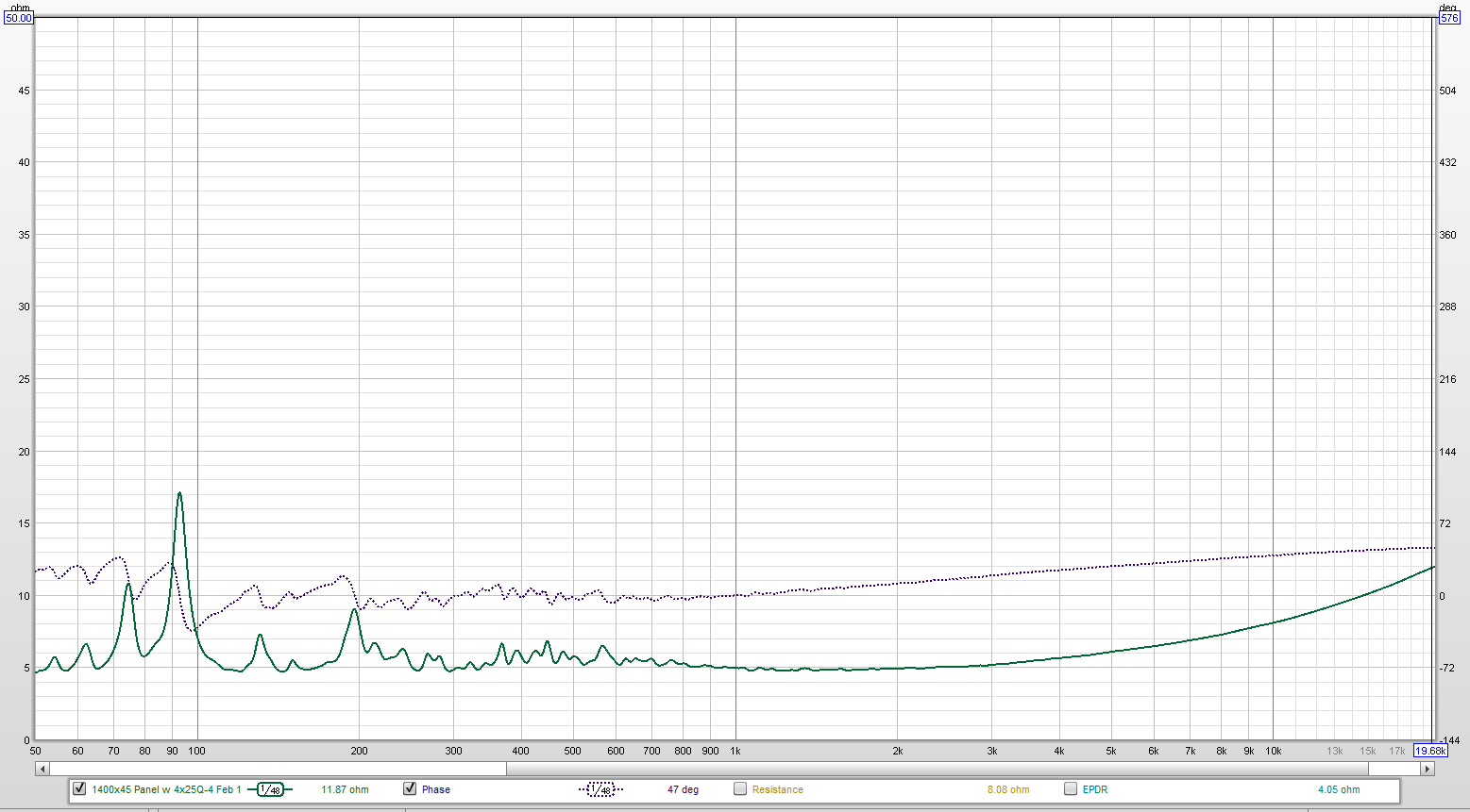

Hi Christian,
Here's the impedance and impedance phase curve of a panel with 4 drivers on it. No cross-over. Green curve is impedance, the dotted curve is impedance phase.
The important thing to note is that eventhough there are several peaks in the impedance response, they are minimal, a few ohms at most, and nothing like the massive swings presented by piston speakers and their cross-over networks.
If I had to add cross-overs to the drivers in the curves shown, then besides amplitude changes in magnitude to the individual drivers, there would be at least 90° opposing phase shifts at their associated cross-over points. Bessel or Linkwitz-Riley filters attempt to address this problem, but the over-all, relatively flat system impedance phase response would be negatively affected.
To me, it's anathema to introduce standard cross-overs into DML panels, but I do agree that there are ways of cheating a bit, and adding passive components (shorting caps! 😎 ) to modify driver responses a bit without stuffing up the impedance phasing too much.
IMO Mechanical "cross-overs" (ortho-springs) are a much better way of retaining DML action while separating the panels into their own bands where they work best.
