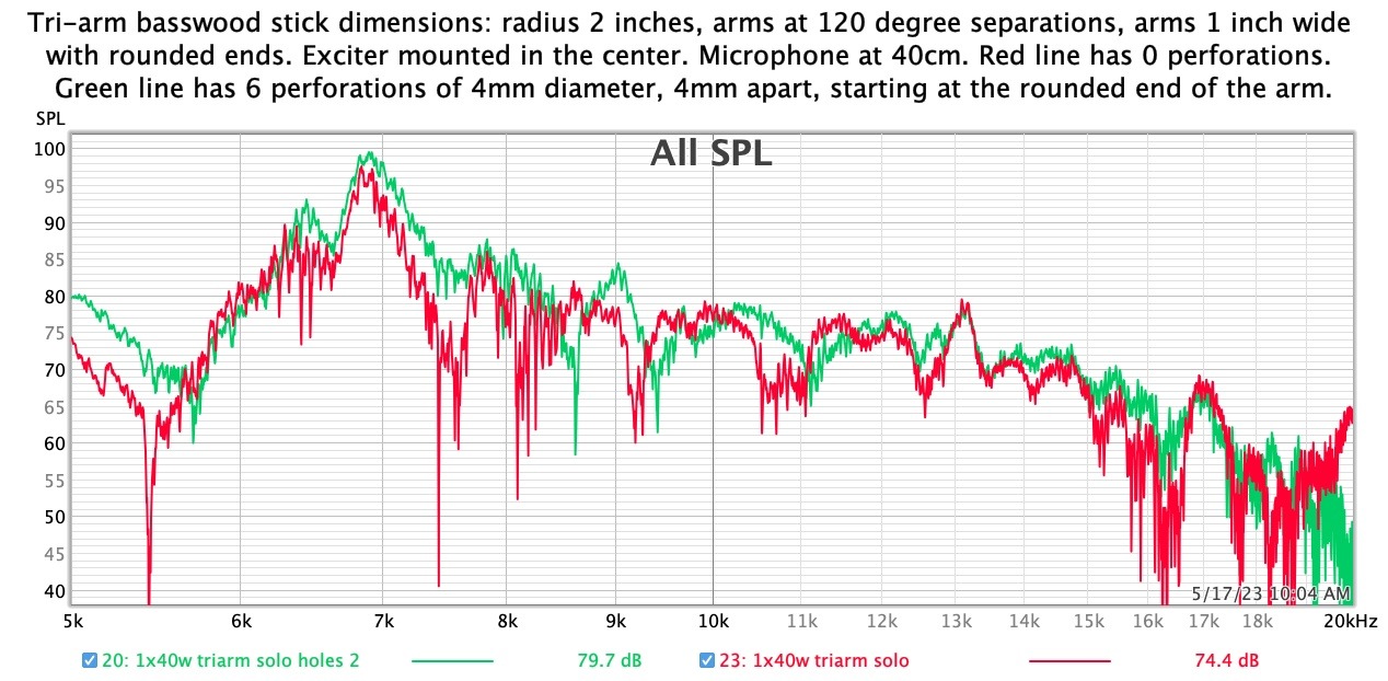

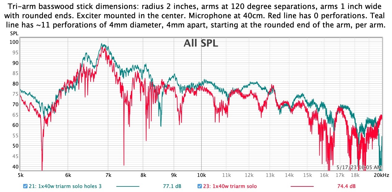

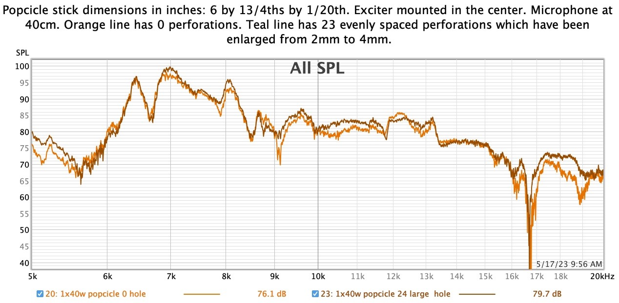

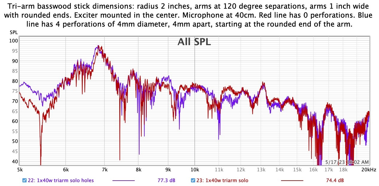

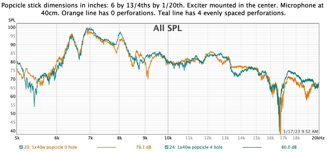

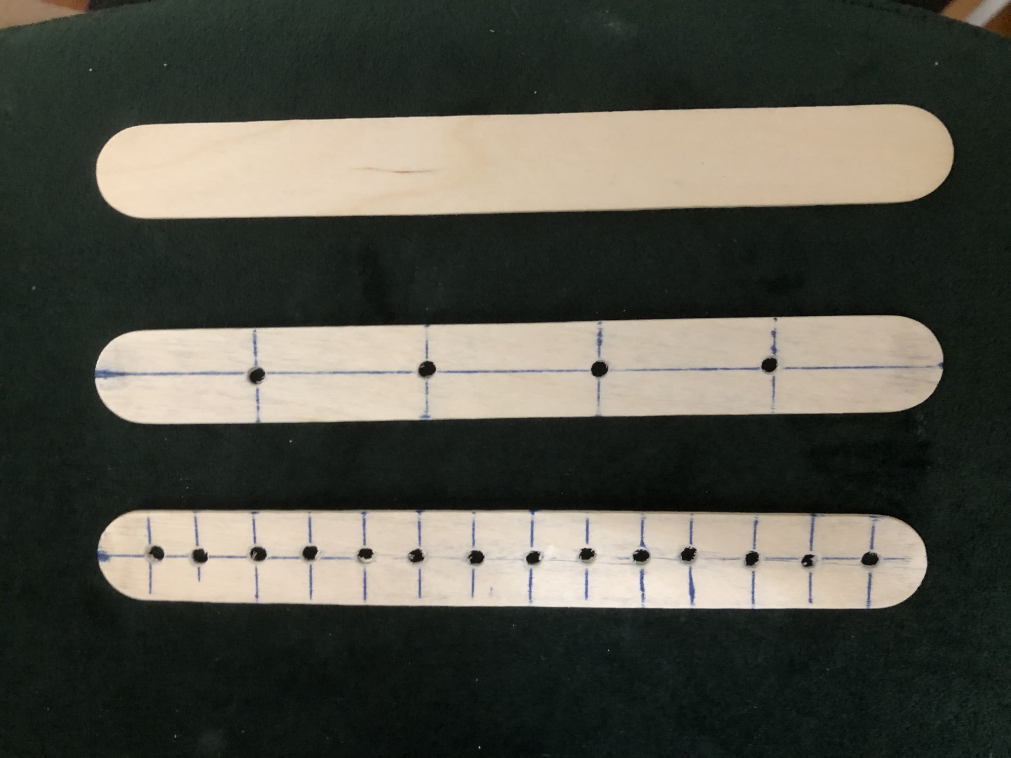

Hi All,
I'm back after the weekend and have been testing some new changes to panels after reading a paper on 'resonance phenomena in acoustic wood boards'.
As per my other posts my current short term goal is finding a way to make a dml tweeter, and near the start of that article i read that they had noticed that that the resonant frequency of the board moves to a higher frequency on their perforated test board.
So i read on.
This is what I am after I thought, and went and made up a series of tests...
I don't know if any of you have tried this before, but the results are very repeatable.

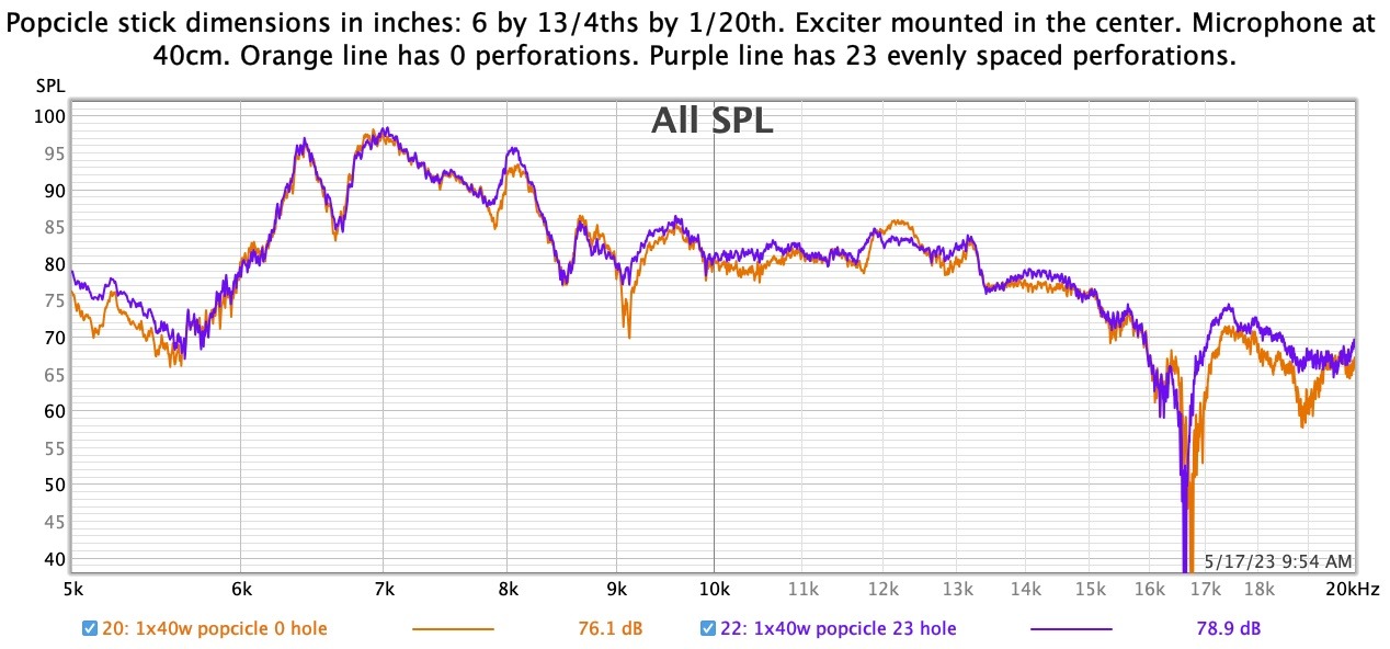

Here is an example of the difference it makes:
In the image below looking at the results over 3khz, you will see a large improvement in higher-frequency amplitudes, AND in its smoothness. The many ups and downs that you see in the red graph shrink to almost nothing in the green graph.
And the same with Popcicle sticks (which are the best tweeters i have found yet)

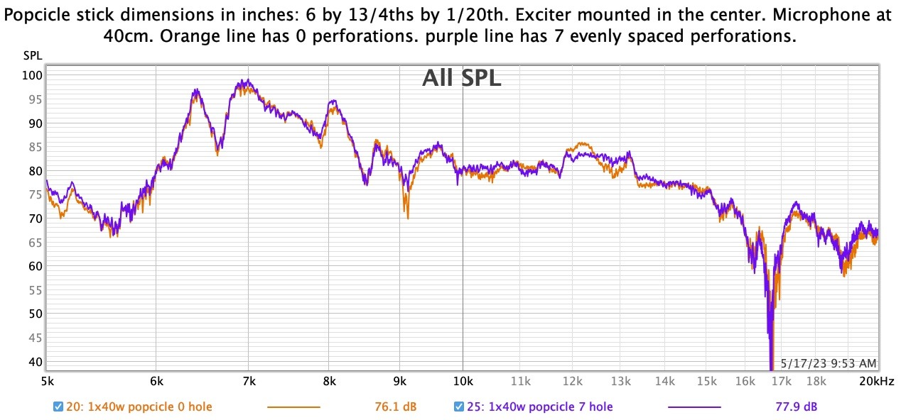

0 holes vs 4 holes:
0 holes vs 7 holes:
0 holes vs 23 holes:
0 holes vs 24 holes that are 2x larger.

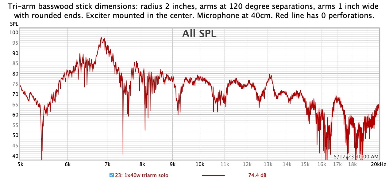

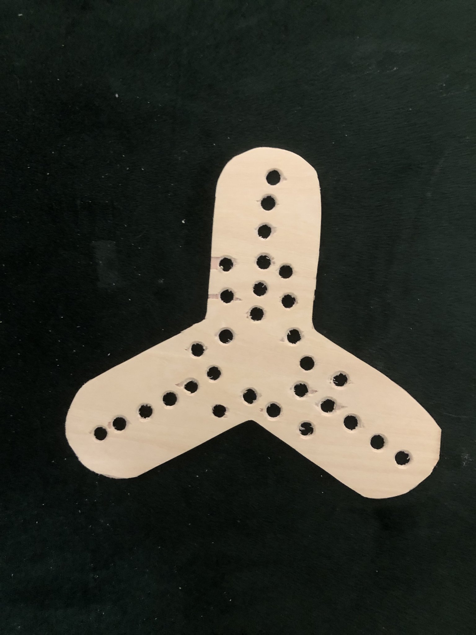

I further experimented on another small piece of basswood cut in a triarm shape (whatever that shape is called, i label it triarm here)
This is the 'before'.
0 vs 4 perforations per arm.
0 vs 6 perforations per arm:
0 vs 11 perforations per arm:
The trend is that the SPL variation is reduced, the peaks and troughs are flattened, and the amplitude of the SPL is increased.

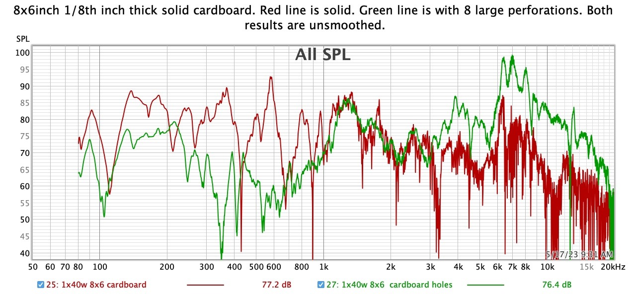

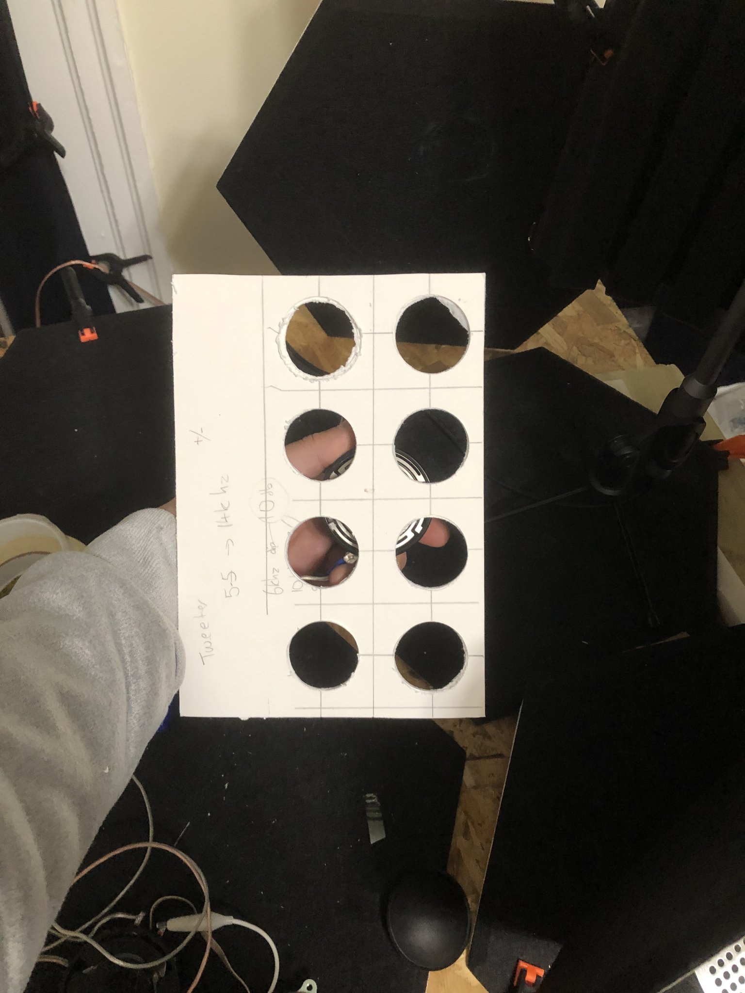

I also tested a 6inch diameter circle of basswood, and a 6inch diameter 3/4ths inch XPS board circle - same trend. I can post those results too on request.
So the good news is by having a strip of basswood cut with a lattice, I now have the tweeter that can give me an SPL of ~80 from 6000hz to 15000hz.
