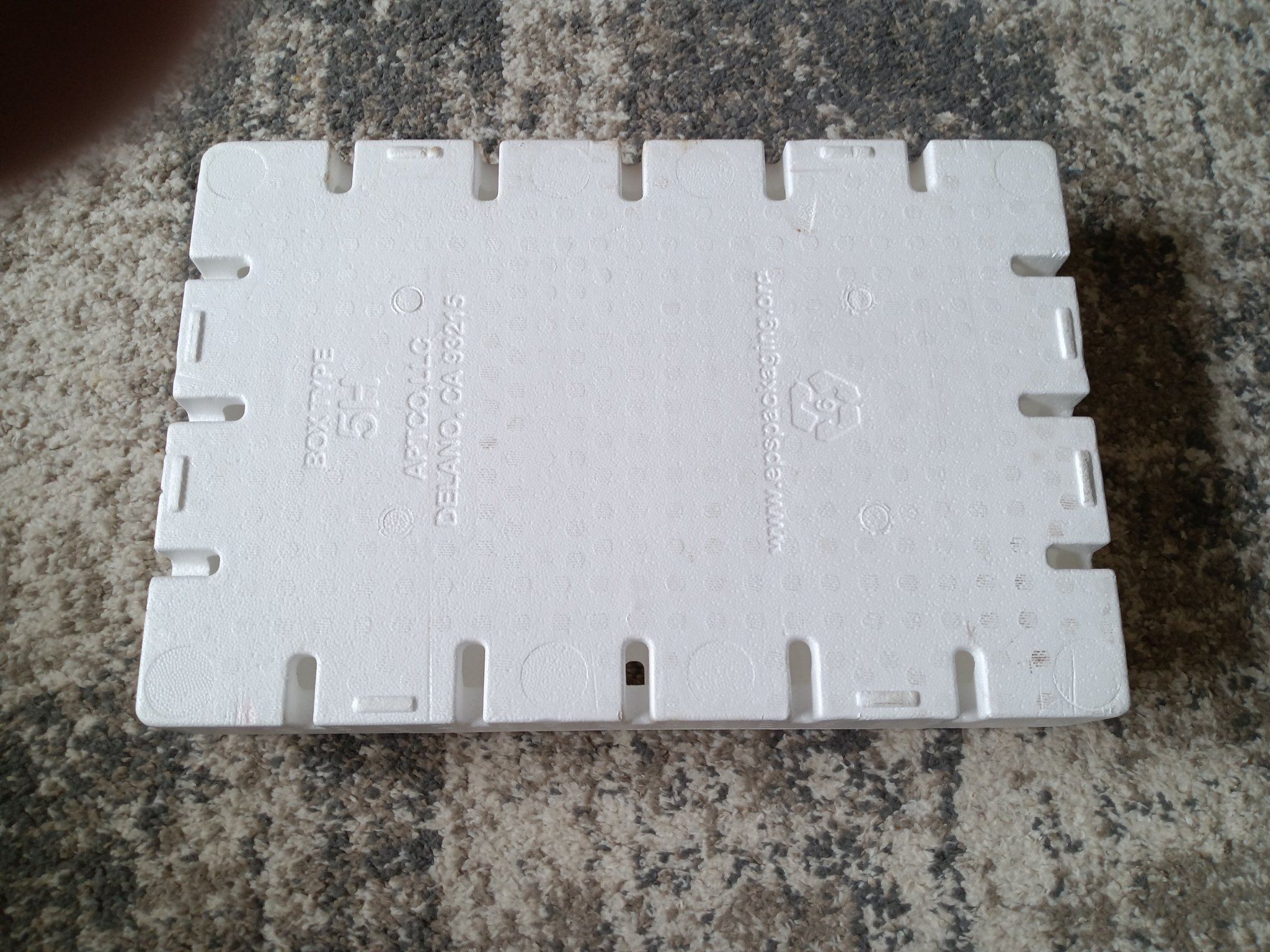

You can get free high density EPS from your local food store as some fruits like grapes are shipped in these EPS containers. Most times they just throw the old containers away.
Not to mention that the carpet enhances the EPS. 🤣🤣🤣
On a serious note there are indentions from the letters and smaller circles which need to be sanded down for a flat even surface. I hate sanding EPS as it gets all over you as the fine dust particles can be dangerous if inhaled as it can damage your lungs so a good mask and eye protection is required.
