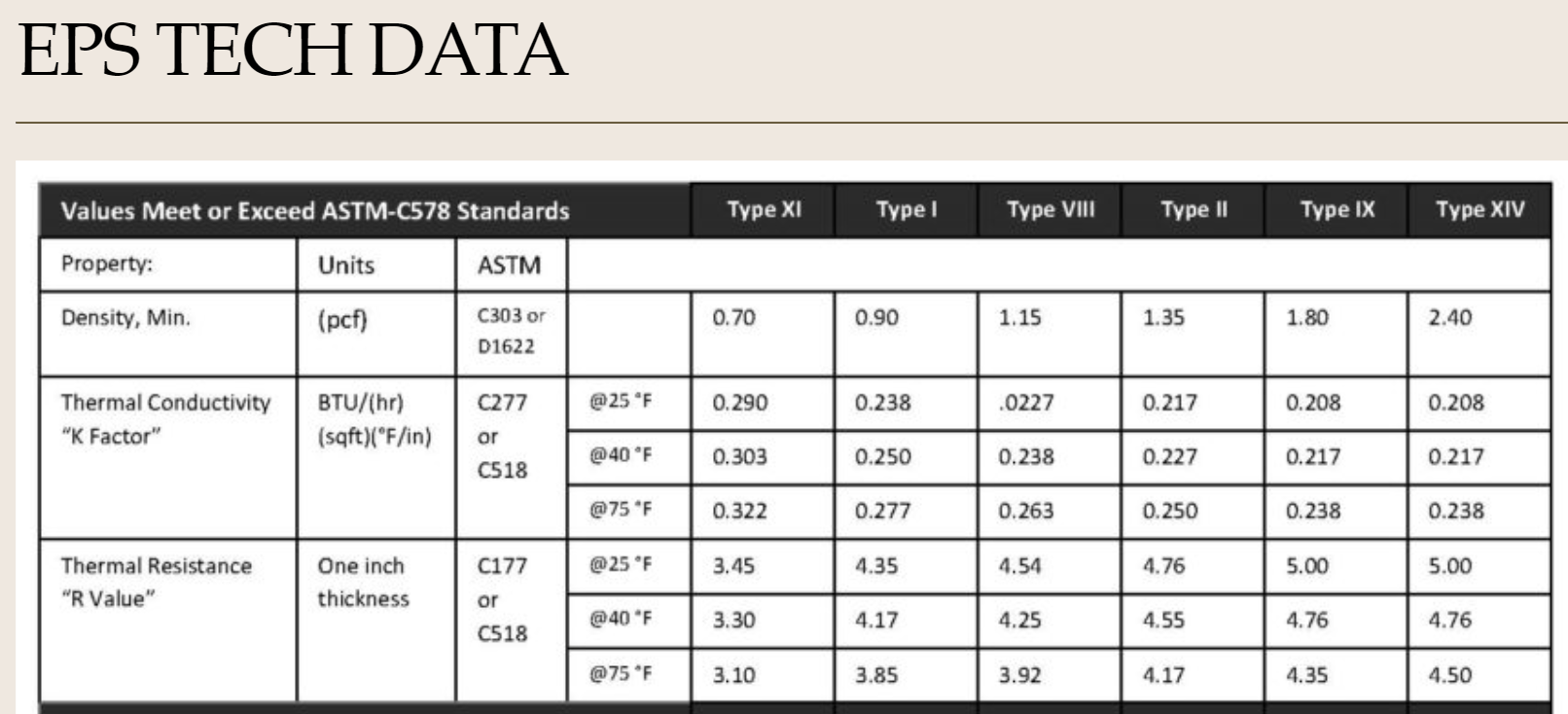

https://www.foambymail.com/polystyrene-foam-sheet.htmlAre you sure it is 3 lbs? View attachment 1177370
If not mistaken it goes as high as 5lbs. but not many make this high density.

I looked around a lot, and 50 kg/m3 is the highest I have found, which should be the same as 3lbs.https://www.foambymail.com/polystyrene-foam-sheet.html
According to this article it can range between 12 and 50kg:
https://www.bpf.co.uk/plastipedia/polymers/expanded-and-extruded-polystyrene-eps-xps.aspx
EPS packaging in the top range of density is very rare. I got one sheet when I bought a fridge that might be similar to my 25kg/m3 plates, but that is a special application where a thin sheet with high compressive strength is needed. All other EPS packaging I have come accross seems to be 20kg/m3 or less. I find it extremly unlikely that someone would use top grade EPS for fruit.

Also I swore I read an article on EPS that said they go as high as 5lbs, I just cant find it anymore.
Then around 2 years ago I found some EPS square 12inchX12inch sheets 1/4inch thickness on Ebay that said 5lbs density. So I quickly snatched those up before someone else bought them as that was the only ones left and I wanted to see what 5lbs density was all about.
Compared to my 1/2inch 30g density EPS these 1/4 inch 5lbs density is around twice as dense as the 30g. In fact its so dense it reminds me of those thin balsa hobby woods they sell in craft shops. Now there is a down fall though because 5lbs eps is so dense you lose sensitivity just like with wood materials. Its also less lively but a bit more accurate sounding. For me I prefer a livelier sound with better sensitivity which is why I prefer the 30g 1/2inch EPS sheets over the 5lbs density.
Its like the Goldie locks and the three bears analogy. The material shouldnt be too soft or to hard/dense but JUST RIGHT. 😆
I just found this after making this post and this chart goes up to 4lbs. So I am sure I didnt imagine 5lbs. 😀
https://omnexus.specialchem.com/selection-guide/expanded-polystyrene-eps-foam-insulation
Ok, interesting, I have only seen XPS in those densities, but glad it doesn't seem like I have missed out 🙂
