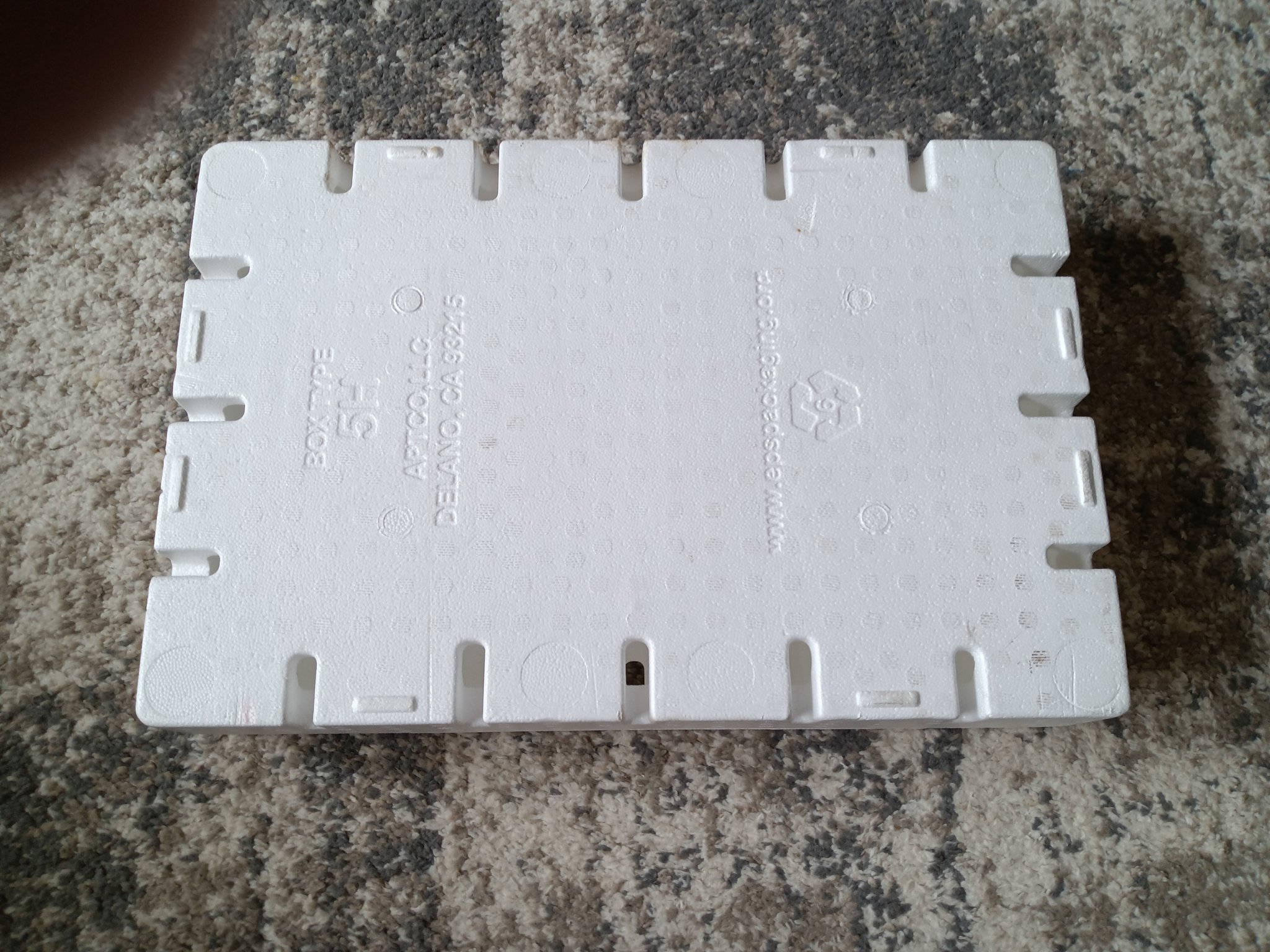

Hi AudiofrenzyYou can get free high density EPS from your local food store as some fruits like grapes are shipped in these EPS containers. Most times they just throw the old containers away. View attachment 1176431
Not to mention that the carpet enhances the EPS.
On a serious note there are indentions from the letters and smaller circles which need to be sanded down for a flat even surface. I hate sanding EPS as it gets all over you as the fine dust particles can be dangerous if inhaled as it can damage your lungs so a good mask and eye protection is required.

Hello Audiofrenzy,You can get free high density EPS from your local food store as some fruits like grapes are shipped in these EPS containers. Most times they just throw the old containers away. View attachment 1176431

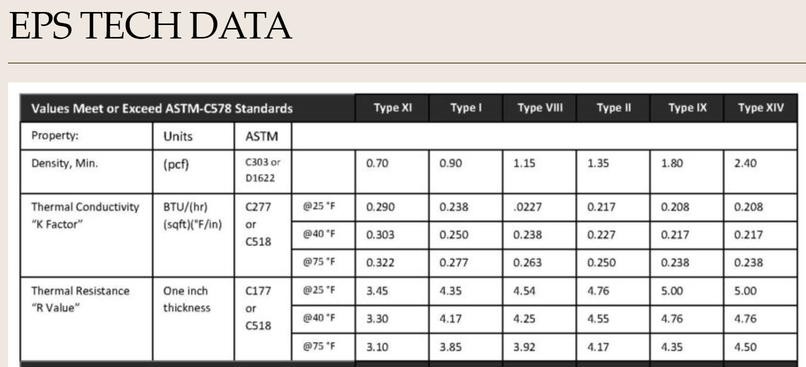

I got some EPS (clean!) containers from the fishmonger near my home. The first evaluation of the density shows more a low density than high density.
Which density is this one?

I assume polished means sanded? This only pertains to EPS material.Hi Audiofrenzy
What is the biggest difference between "polished" and "unpolished" surfaces?
If you look very closely at any EPS material you will be able to see the tiny beads all bunched together. You have to lightly sand the surface until you no longer see any of the beads, instead it will be one uniform surface.
If you look at XPS you will not see any beads bunched together but rather one uniform surface.
EPS material is better then XPS because the beads make it easier for the vibrations to penetrate through the panel due to gaps between the beads. The problem is the surface of EPS needs to be one uniform surface which is why it should be sanded.
So when both sides of EPS are sanded they will have a uniform surface like XPS while in the middle core of the EPS will still have pours beads for the sound to travel through more easily.
I dont know exactly the density of the EPS container but when I compared it to my high (3lbs) density EPS sheets they seem pretty similar in density.Hello Audiofrenzy,

1. High density EPS (3lbs)
2. 1/2inch thickness.
3. Sand both sides of the panel surface lightly enough so that you no longer see the beads. Start with 100 grit and smooth with 220 grit.
Are you sure it is 3 lbs?I dont know exactly the density of the EPS container but when I compared it to my high (3lbs) density EPS sheets they seem pretty similar in density.
