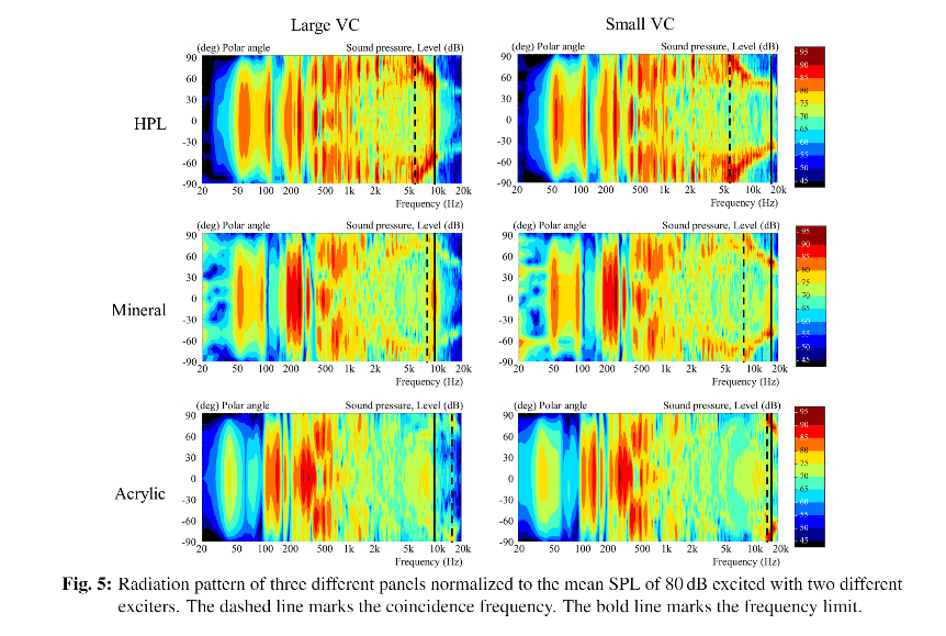

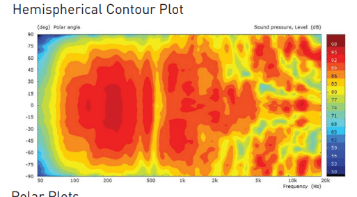

Still, technical papers talk about the large increase in efficiency at fc, along with an increase in off-axis output (at 90 degrees to the panel). But even when I "know" (from calculations) approximately where fc should be, I have never be able to "detect" these features in my own panel measurements. It would seem like fc should show up as a clear spike in the SPL when the mic is positioned at 90 degrees. I've tried many times on many different panels, to find such a spike in the response, but I never saw anything that stuck out as clearly as I had expected. Most recently, I tried with a glass plate, for which the properties are pretty well known, and hence my estimate of fc should have been very reliable. Still, I observed no clear spike in the off axis SPL anywhere near the expected fc.
This image directly below (from a paper by B. Zenker) shows several hemispherical contour plots of different panels, which do show some pretty characteristic features at fc (indicated by the dotted lines). At the indicated fc, the output peaks in intensity at +/-90 degree angles. And above fc, the peak output (in dark red) moves to smaller and smaller angles. A similar characteristic is seen in the plot at the bottom for the Tectonic DML 500, which seems to show the same characteristics starting at about 6kHz.
But with my simple tools (a mic and REW), I have yet to be able to clearly distinguish fc by any direct measurement. If anybody ever finds a simple way to clearly identify fc by direct measurement, I would love to hear about it.

Yes I also looked for sound at 90 degrees (ie parallel to the speaker) as shown in the zenker plot, and I found nothing. But our equipment is relatively primitive!
The theory predicts zero far field radiation for an infinite panel, finite panels radiate due to edge and corner modes as we’ve discussed.
DML design seems to be largely about finessing these relatively weak sources of sound. Mode whispering, if you will. ☺️

I can say also I was also not able to find an evidence of the fc as Eric said in the conditions (ie a living room) or tools (mic, REW...) of a DIYer.
Christian

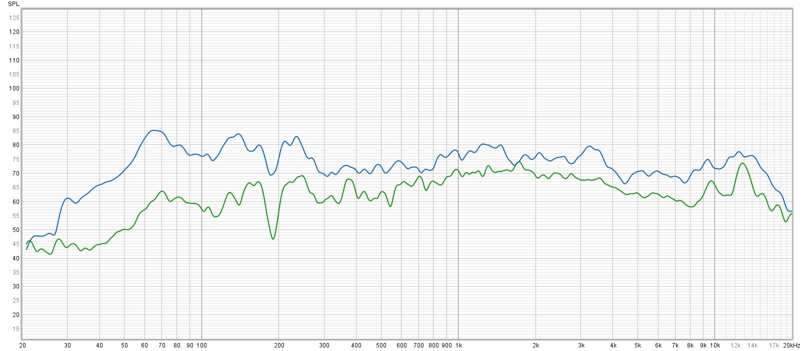

Perhaps you should look at the in-phase and anti-phase measurements of a pair of DML panels? Second comparison with 1/12 octave smoothing

Can you explain this? What is the coincidence freq here (3.5 k?) ? Why does this technique reveal it? Why is one lower SPL? Is the exciter on the mic side or reverse side, and does it matter?
Let's try as I understand it: if you carefully read the explanation on Goebel's website at my link, you should have paid attention to the concepts of coincidence frequency - this is the frequency at which the phase velocity of the bending wave becomes equal in value to the phase velocity in air. And thus, from this moment, the piston mode of operation of the membrane begins to appear. Moreover, this process does not occur abruptly, but gradually with a further decrease in frequency. The measurement graph of panels connected out of phase as a whole has a lower sound pressure, which is quite logical due to mutual subtraction. But there is no subtraction at the coincidence frequency point, and therefore the pressure at this point is the same. In this case, it is a point with a value of 1.7 kHz.
The exciters on the panels are on the reverse side of the microphone, but in theory this does not matter for the observed effect.
