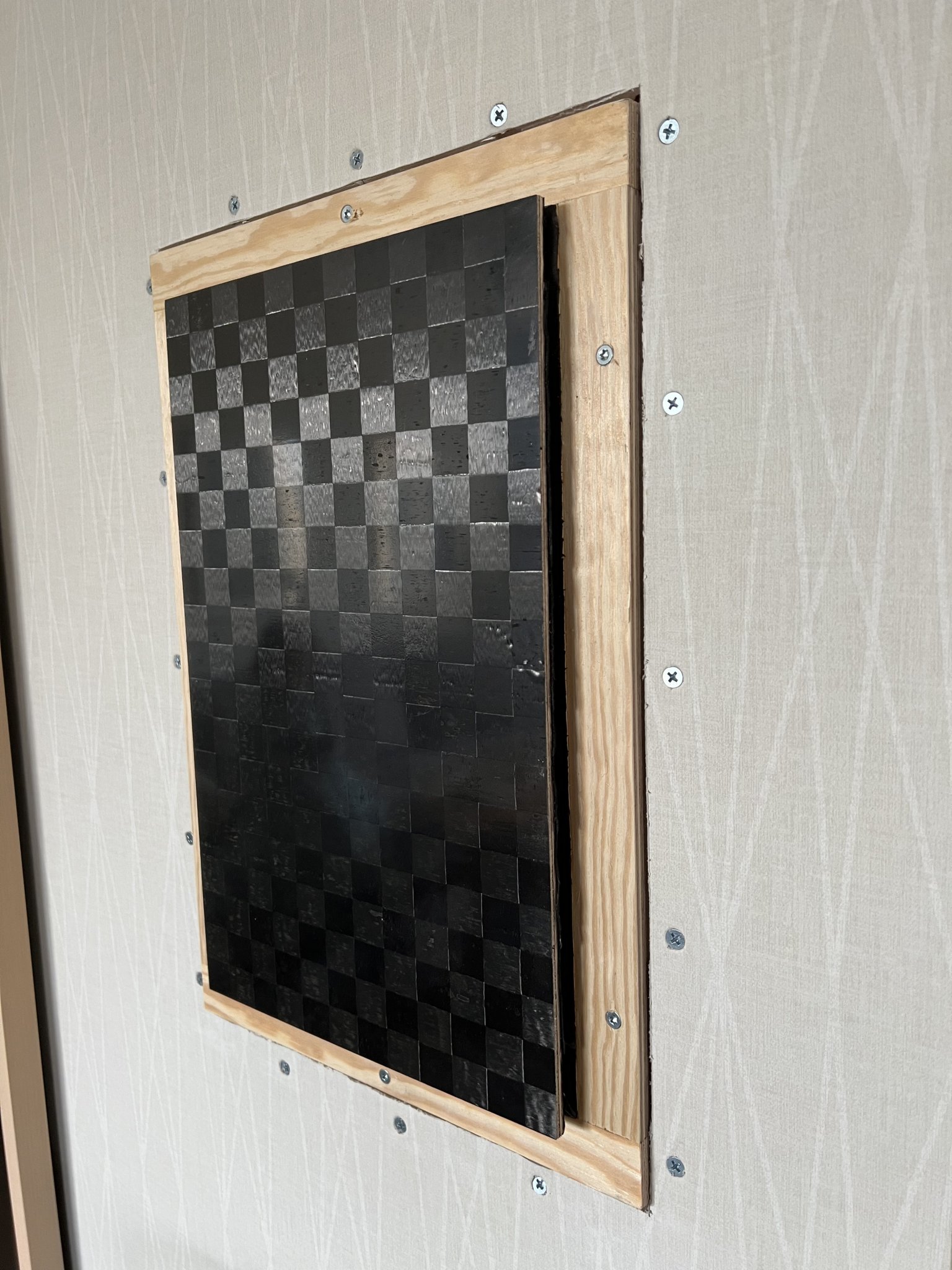

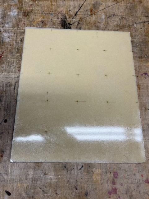

It’s the same construction but bigger. So it’s about 50g. 912 cm versus 500 cm2.I just checked, 10g is 2 A4 printer paper. 26g is just 5 A4 paper. Is your 2nd project panel that light too?
It’s calculated from
Balsa 100kg /m3
The carbon fibre is 80g/m2, laminated with epoxy it’s 140 g /m2, I’ve assumed 160 g/m2.
I might have underestimated the amount of epoxy being used.
Small panel 26g and the larger panel 50 g.Hat was the finished weight of the panel? Thanks
And, your placement of 6 exciters is not according to any patent. 🙂It’s the same construction but bigger. So it’s about 50g. 912 cm versus 500 cm2.
Balsa 100kg /m3

Sandasnickaren, you have made a great job!Small panel 26g and the larger panel 50 g.
Which exciters do you use in the 6 exciter model?

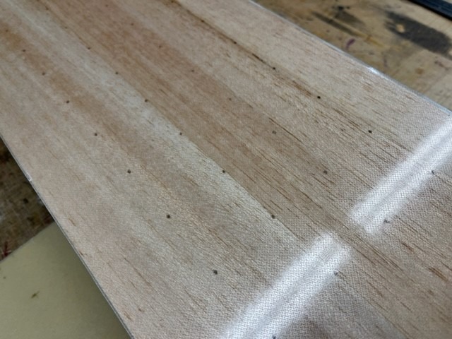

Thanks.I do it one step. I’m using a slow setting epoxy which gives me 4 hours to complete the bagging. Yes, I’m using glass plate on the front side.
I’m planning to , in future, laminate the carbon skins separately and then in the final step combine them with the balsa core. The resaon for this is to minimize the amount of epoxy penetrating the balsa. My understanding of the requirements on the panel is to have as stiff skins as possible and as low density in the panel as possible (I might be wrong here…).
I have tried laminates with softer skins ricepaper, silk and glass fibre none of them had a decent frequency response above 10Khz.
Check out the textreme carbon fibre it has some unique properties.
Concerning the goal of stiff and light, I think you are 100% correct, at least with respect to efficiency. And "light" is even more important than "stiff", so yes, minimizing excess epoxy (weight) is a worthy goal. But I don't think it will make the panels sound any better other than to make them louder. So if you are already satisfied with how loud they are, then it may not be worth a great deal of extra effort to further minimize the weight.
That said, one method of minimizing epoxy weight (possibly), is to drill an array of holes in the balsa. Then you can do your "one step" process and still (theoretically) pull excess epoxy out of both carbon skins. Too bad I learned about this method only after I had made my carbon panels! I did try it out on the two panels pictured below. The first is fiberglass/balsa and the second is fiberglass/divinylcell foam. This method seemed to work pretty well, although I can't say for sure it works better than any other way. This is probably the method I'll use if I do another set of carbon/balsa panels.
I also tried some methods to seal the balsa (i.e pore fill), but the things I tried added weight of their own, and I ended up at about the same final weight, and a more complex and time consuming process. So I gave up on that route, at least for now.
My main carbon supplier does carry the Textreme. It does look good. The spreadtow that I used was the Hexcel Primetex, which seems to have the same features (for a bit less $$), but there may be something I'm missing. I noticed they have a Textreme 60g High Modulus spreadtow that might be really great option, but for about twice the price of the 80g standard modulus. If only I had unlimited time and money to try them all!

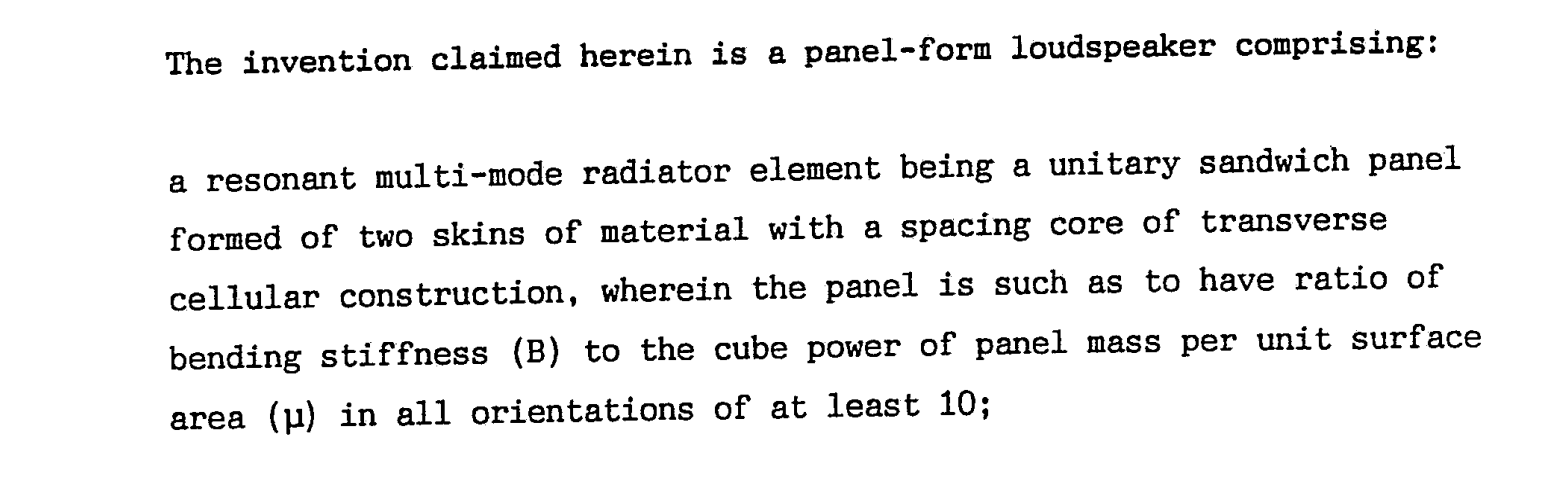

This concept goes back (at least) to this patent by Heron, which was he precursor to the NXT patents, I believe. But I think others like Bertagni were aware of it earlier.So, the lightness of the panel is the most important factor, other than how it is made - a composite. 🙂
https://patentimages.storage.googleapis.com/9a/43/32/b09245ff903cac/WO1992003024A1.pdf
Eric

By the way, on the question of pore filling, you have to spray that on. Göbel mentions that it could be ~2g. The idea here is not to let the epoxy going into the main membrane, balsa, and changing its parameters. This matter is also mentioned in Herger's patents. (By the way, I'm glad that @Sandasnickaren joined this thread because of those "Russian patents" #8,070 ).
On the matter of lightness of the membrane, paper cone in standard speaker drivers, mylar in planar types, bypassing the 'coil former' in some way - eliminating that with chemicals under the very thin aluminium flat printed coil, pasted to mylar with spray glue, etc.

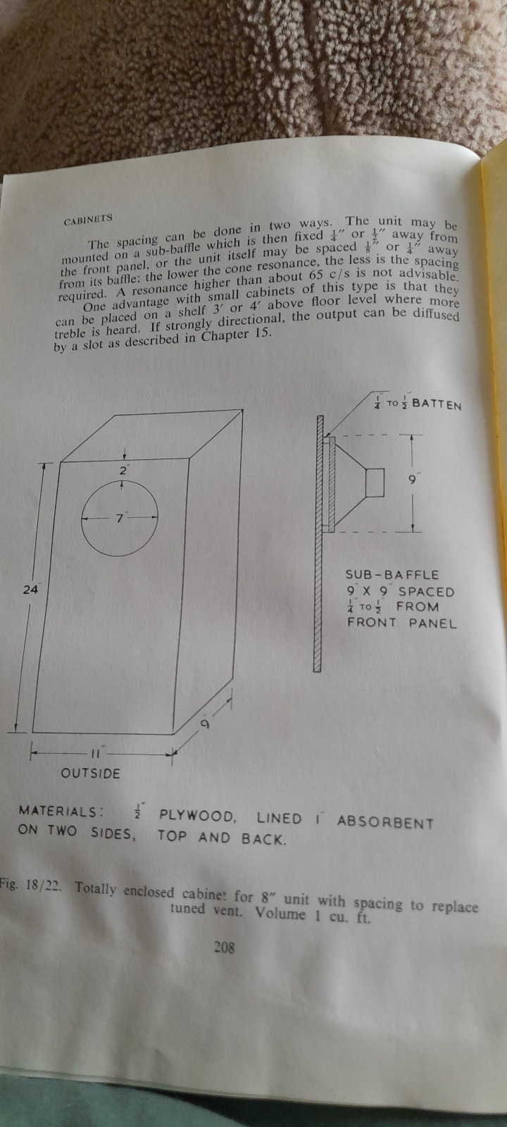

From G A Briggs book.
This short section on mounting a speaker drive unit to a cabinet without the need for a port could easily be adapted for a free edged panel Or even a lightly mounted panel that allows air movement from the side gaps.
Although of course, you would loose the rear radiation from the panel.
Ps.
Probably something BMR users might want to try.
I used this method many years ago in my very small 2" coned surround sound speakers to good effect.

Part of what gives DML's there unique sound signature is that the rear/back of the panels radiates sound. Take that away and the sound drastically changes.
Actually, thinking about it ,I might have used the method in the second picture for first testing 8" drivers
Except instead of the mounting the driver on the back of the speaker baffle, I mounted it on the front.
I Basically just turned the drive unit around so that the magnet was on the outside of the speaker.
While not ideal, it did allow me to test the theory easily with spacers ,to get the right spacing.
Although with my small surround speakers the xo was quite high , but the sound improved so much that I could actually listen to music on them without being annoyed 😁

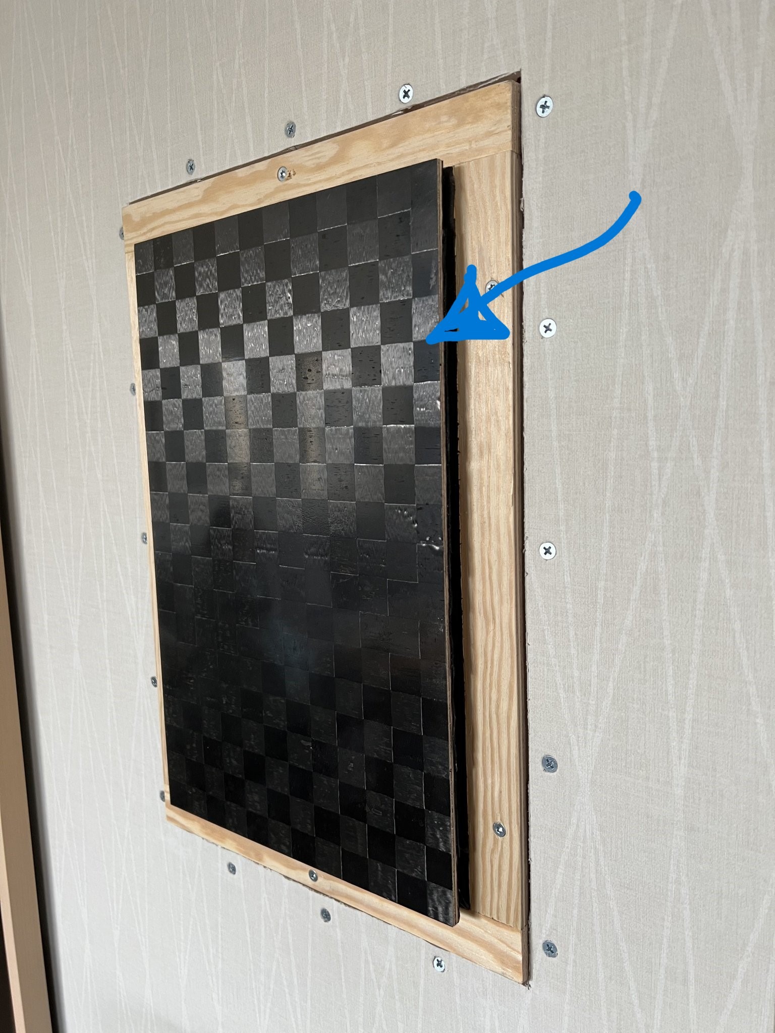

No it’s a new innovation😉And, your placement of 6 exciters is not according to any patent. 🙂
Very glad you joined this forum.
The reason for placing them like this is the Piston mode. It was the only way I could think of to achieve symetrical drive of the panel.
I dont know if there is any penalty in the dml mode? It doesnt seem to, considering the frequency response and distorsion. Maybe some of the wiggles in the frequency respons are due to this. But I wont know before I remove the speakers from the wall and measure them outdoors.
Well, you are going to use them indoors, so the measurements are not the most important matter, but how it sounds to you, and your wife/partner. 🙂No it’s a new innovation😉
What's interesting is, the transverse waves made by 6 sources at the same time are fighting each other on the same plane and still gives nice output. At what distances, they are placed on the panel? Have you put a rubber puck inside the bobbin/coil-former under the exciter? Do you have the angled lines/cuts on the perimeter of the panel as Gobel's? If so, at what angles, at what distances?
You've left the edges free,
