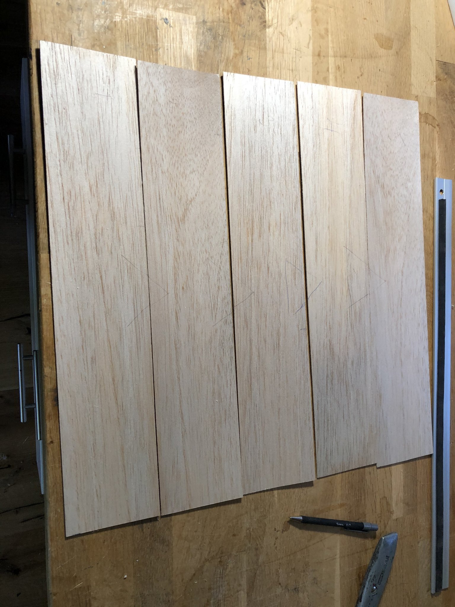

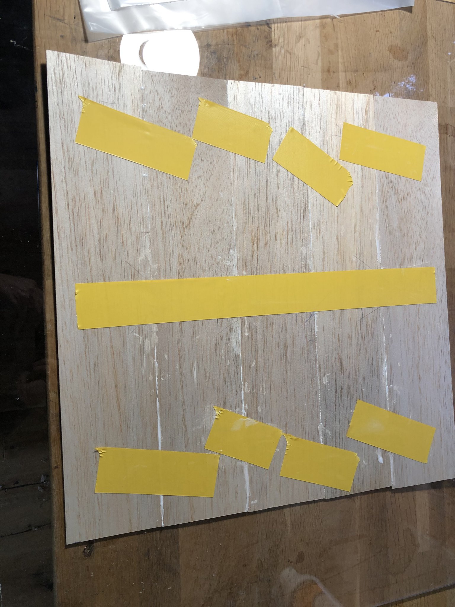

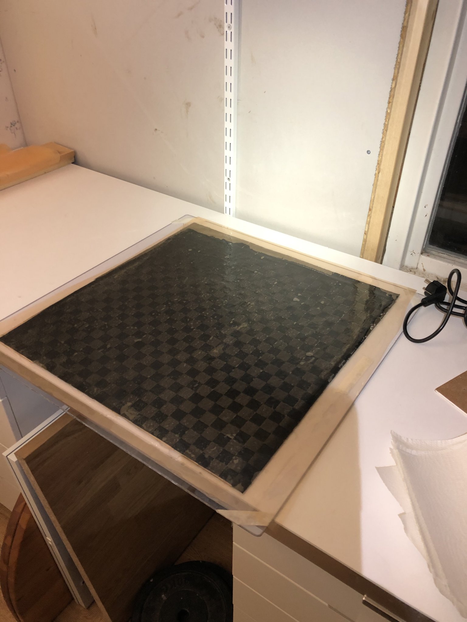

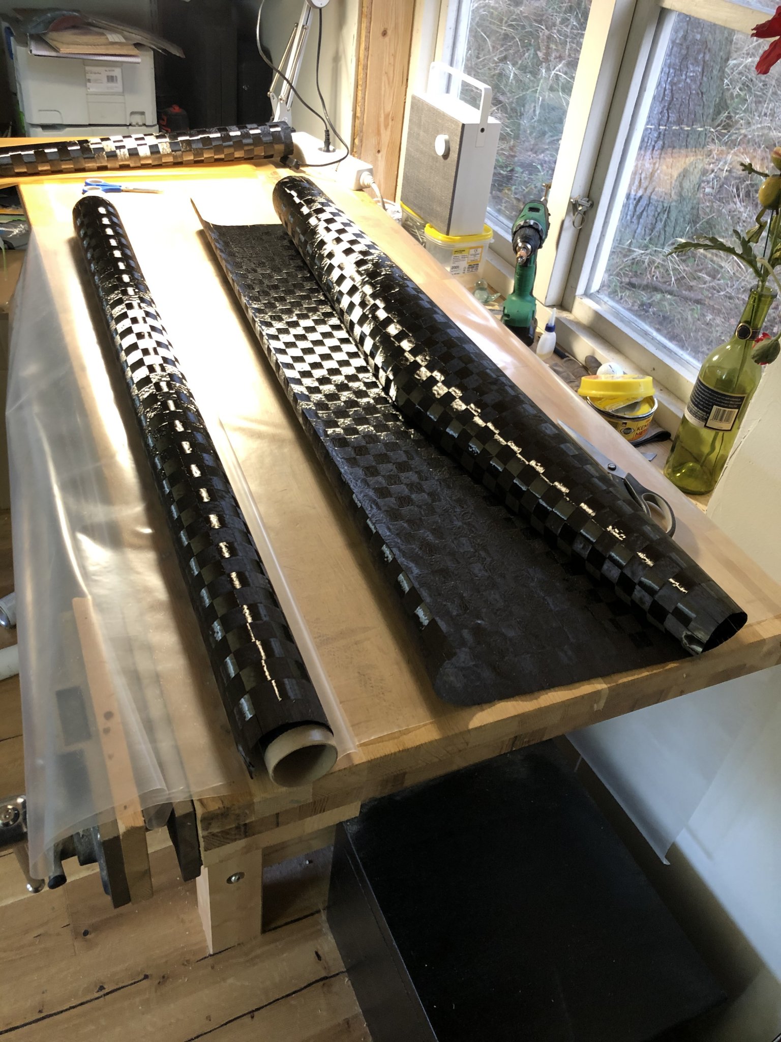

The sandwich is made out of 2 x 100 mm balsa sheets glued together edge to edge.
I am using Textreme 80g/m2 for the carbon fibre skin.

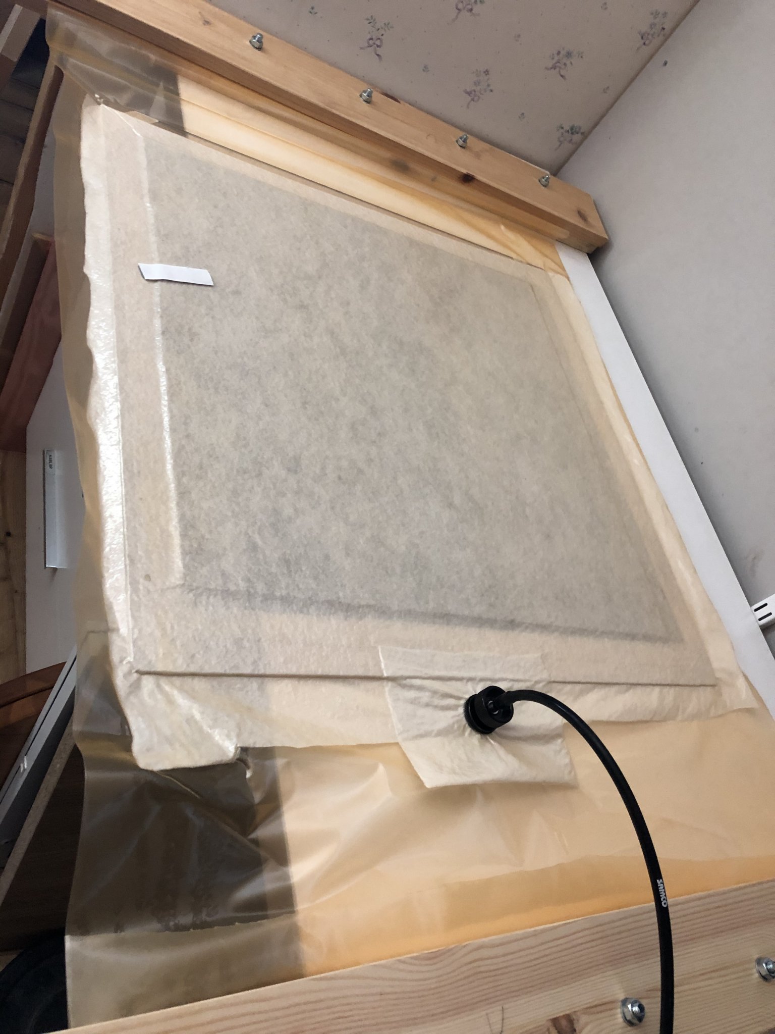

The balsa and the carbon fibre skins are laminated with epoxy in a vacuum press. I’m using a vacuum press as already have one.
Sand
Thanks for the description and images. Your panel making process looks very familiar to me! I am curious about some details:
Do you make the whole panel in one bagging step, or two?
I tried several procedures, and had the best results (for me) so far with two bagging steps. First with the face carbon layer and balsa, then a second for the back layer.
One nice feature of the two step process is that I could avoid gluing the panels together first. I just taped them together from the back and laid them on top of the face layer. Then, after the epoxy cured, I could remove the tape, and sand the back of the balsa flat before applying the back layer of carbon/epoxy.
Plus, I'm too slow at spreading epoxy to get get both layers wetted before the first one starts to cure!
Glass plate on the face side?
I made my panels with heavier CF skins, but would have used the same as you or similar if I had found it at the time. Now I'm getting re-inspired to get that thinner fabric.
I'm very interested in any techniques you may have learned that helped you improve your CF/balsa bagging process.

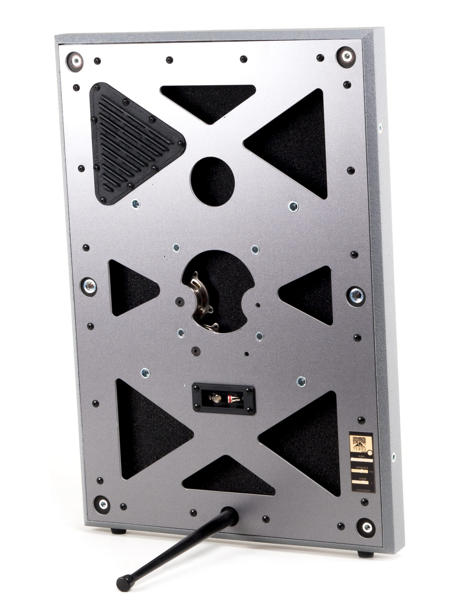

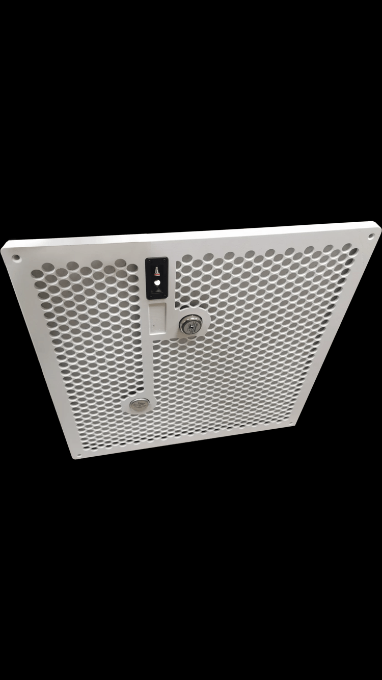

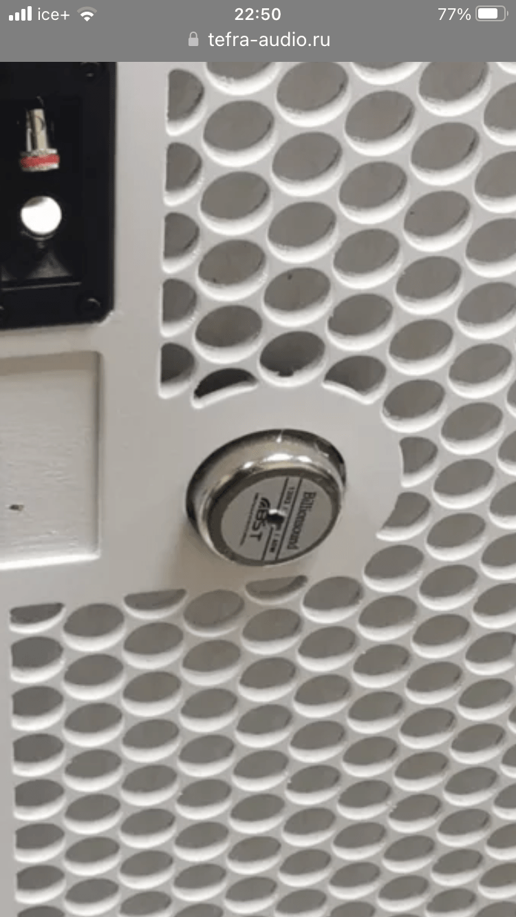

They order directly from Billionsound who makes dayton audio exciters.Any images of this claim?
Lenta.

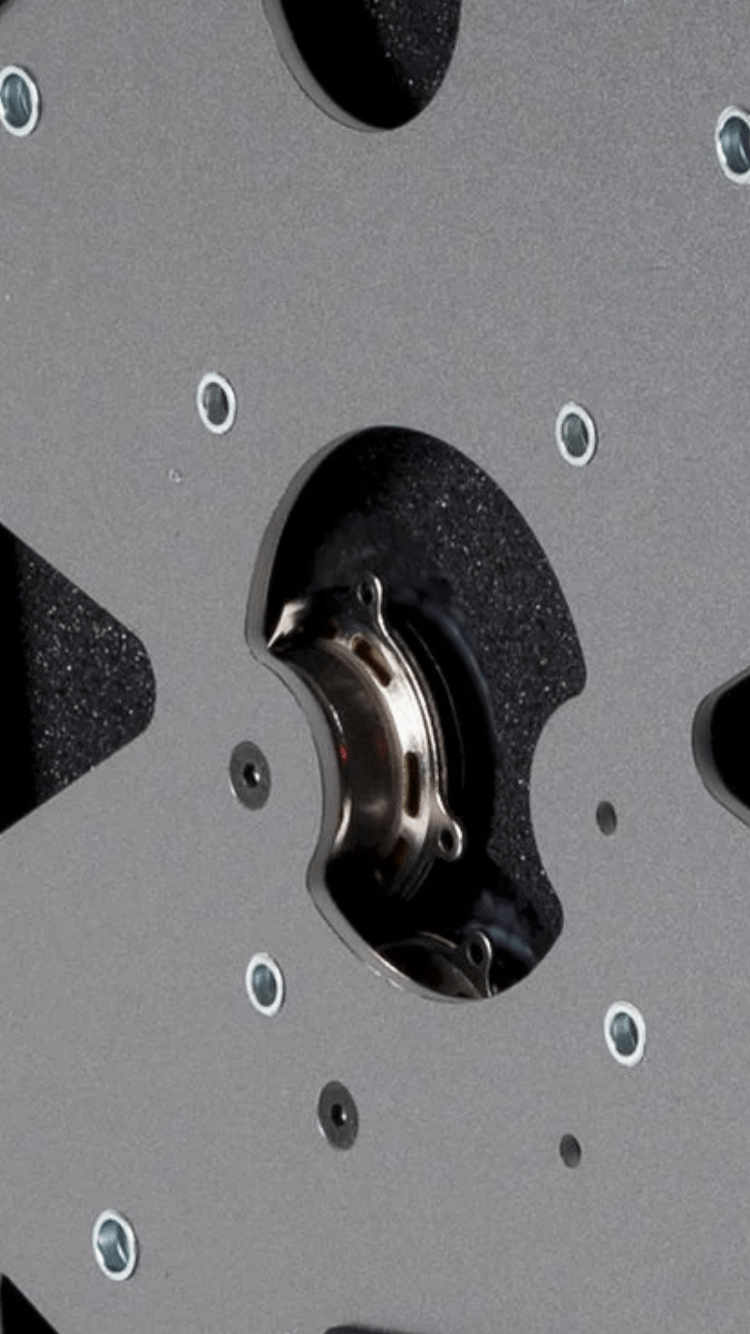

Are those exciters in the pictures using the new screw on feet, for easy replacement I presume?
And what is that black triangle cover in the top left ?
Steve.
Steve.
THat looks like the DAEX30HESF-4They order directly from Billionsound who makes dayton audio exciters.
Billionsound is an OEM manufacturer, and will make a product with anyone's name. They will make exciters for your specifications too. Looks like Billionsound owns all patents to products they sell as their own. Does Dayton Audio has any patents?They order directly from Billionsound who makes dayton audio exciters.
Billionsound's patented product list page 1 to 9. You might recognise some of them. Does Dayton Audio has any patents?

I do it one step. I’m using a slow setting epoxy which gives me 4 hours to complete the bagging. Yes, I’m using glass plate on the front side.Sand

Did you add a pore filler on balsa, before you used epoxy on it?I’m planning to , in future, laminate the carbon skins separately and then in the final step combine them with the balsa core. The resaon for this is to minimize the amount of epoxy penetrating the balsa.
By impregnating the core with pore filler before coating with the textile material and the resin, absorption of the resin and adhesion problems are avoided.

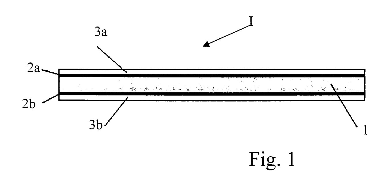

I read that in that Oliver Göbel patent you linked,No, could be an alternative method to try.
[0045] A pore filler 2a, 2b is applied to this core 1, on which there is a coating 3a, 3b made of resin and a textile material, which is referred to below as the top layer. The pore filler 2a, 2b and the coating 3a, 3b are on opposite sides of the core, respectively upset. Alternatively, the coating 3a, 3b can be applied directly to the core 1 or a coating 3a can only be provided on one side of the core 1, with a pore filler 2a being able to be located between this one coating 3a and the core 1.
And some place earlier,
