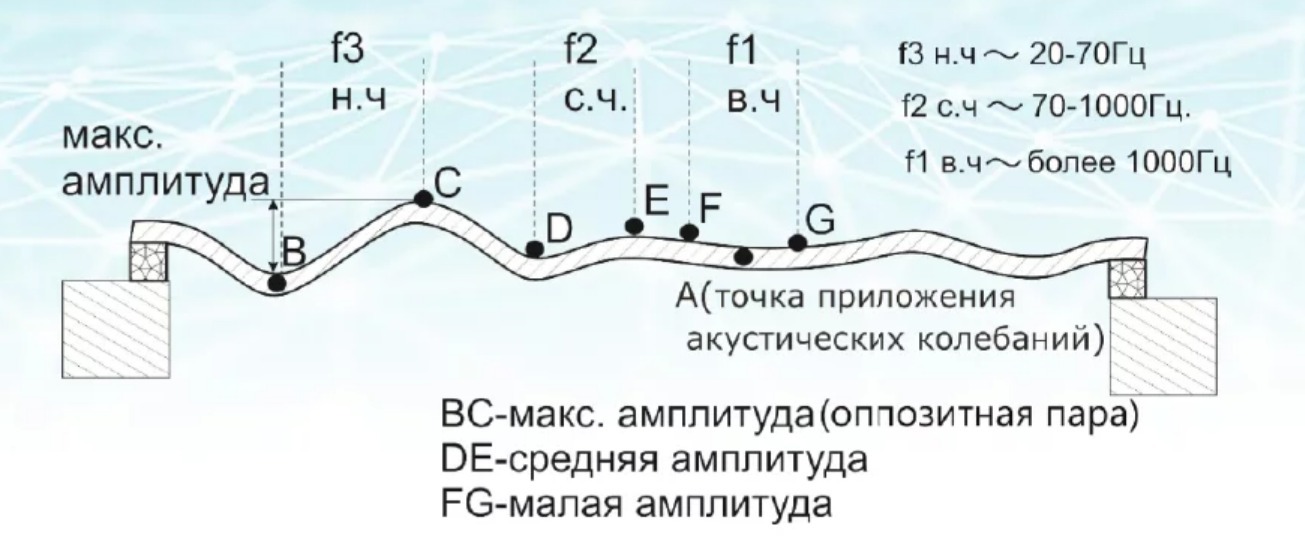

Here is the Google auto translation of Transverse Technology. It is patented, still searching for the patent. If anyone can find it, I'd be be happy to read it.
Here's one of the images,
Another image is in post #8,047, which was used in another patent.
If anyone can understand the science in this, I'd be quite glad to know the how and why.

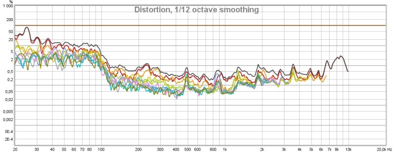

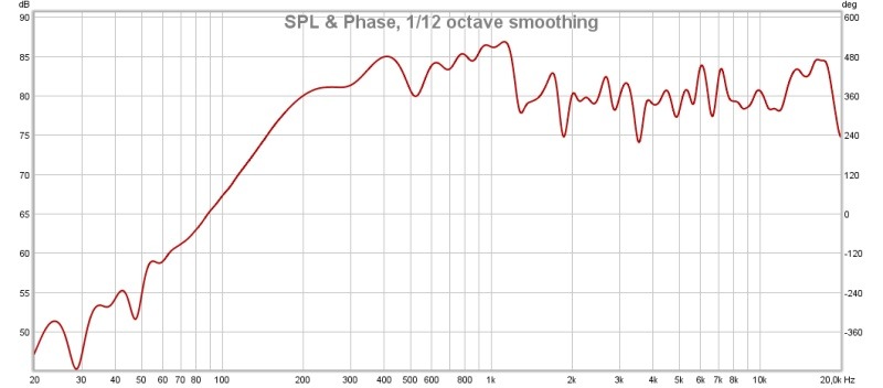

Some measurements done from 1m in a room. There are some room influences in these measurements even though they are windowed.
I have done some measurements outdoors, but I cant find them. The peek between 200 and 1000 is less pronounced in those.
see these as indicative.

Great job. That's a pretty smooth response, and nice low distortion. Well done.Some measurements done from 1m in a room. There are some room influences in these measurements even though they are windowed.

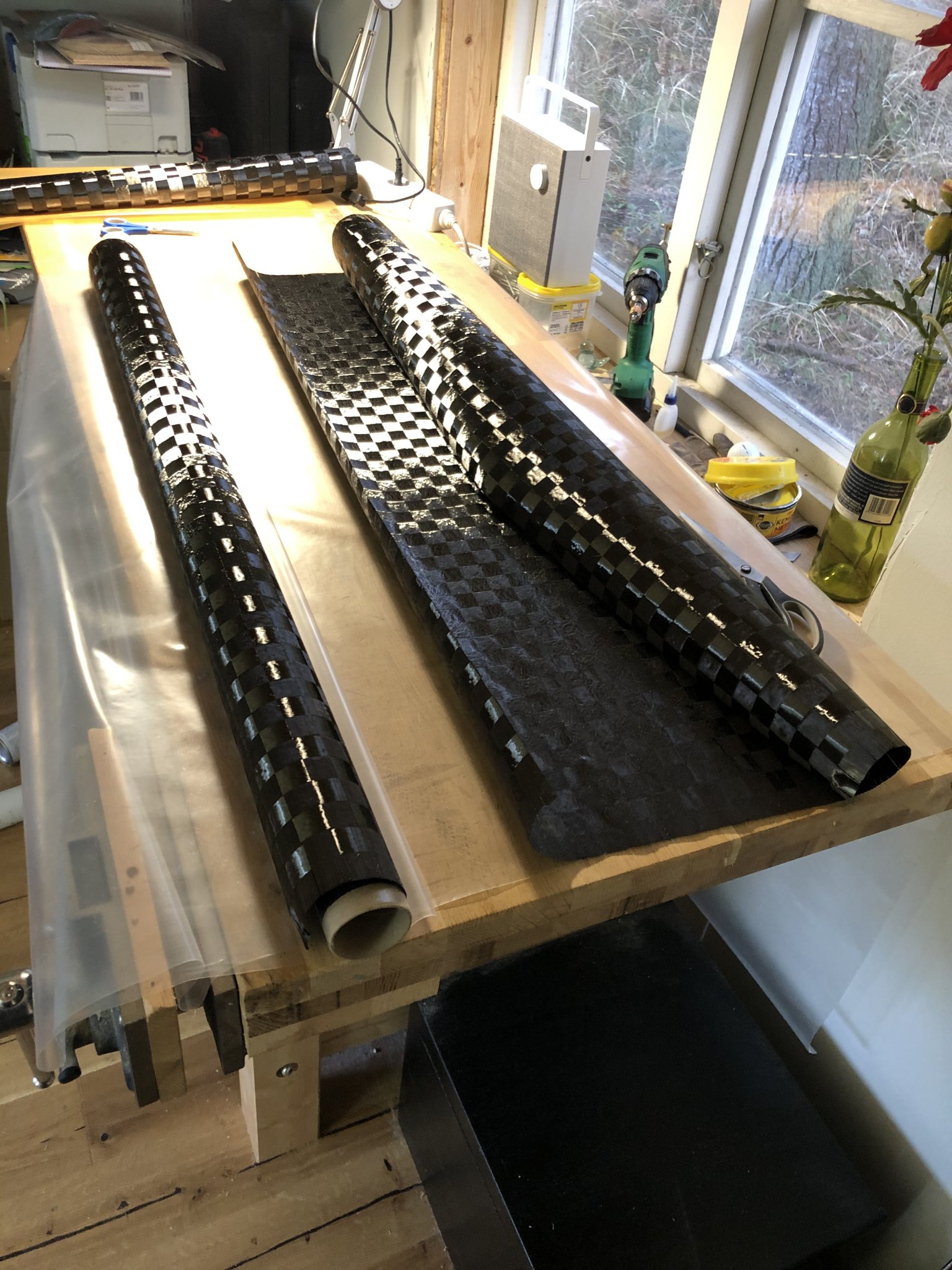

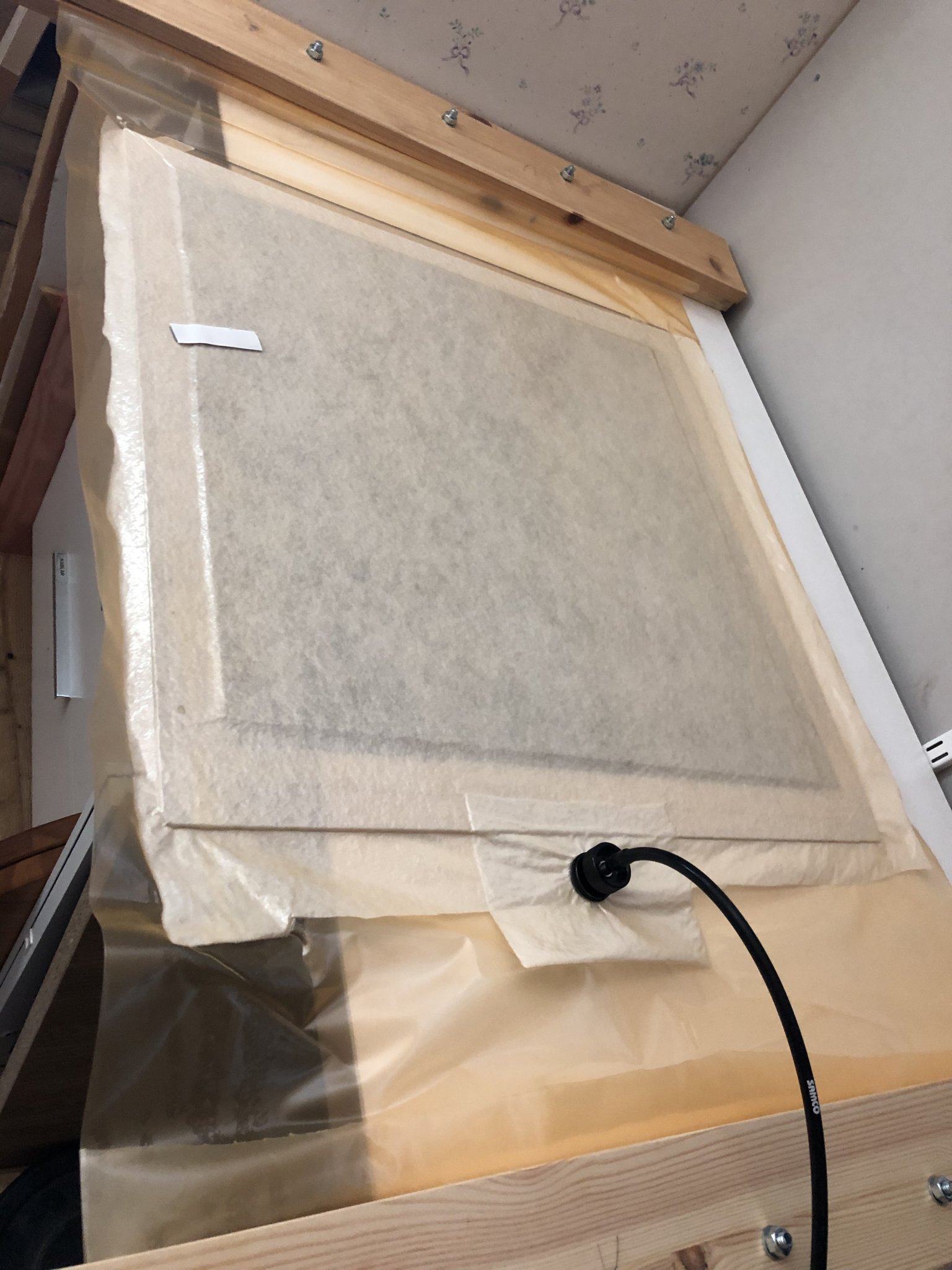

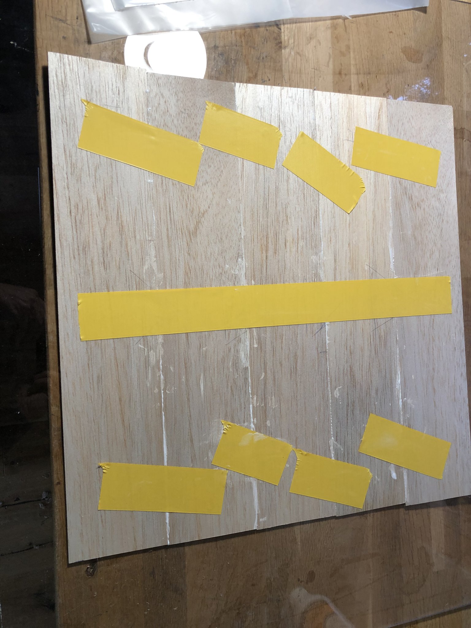

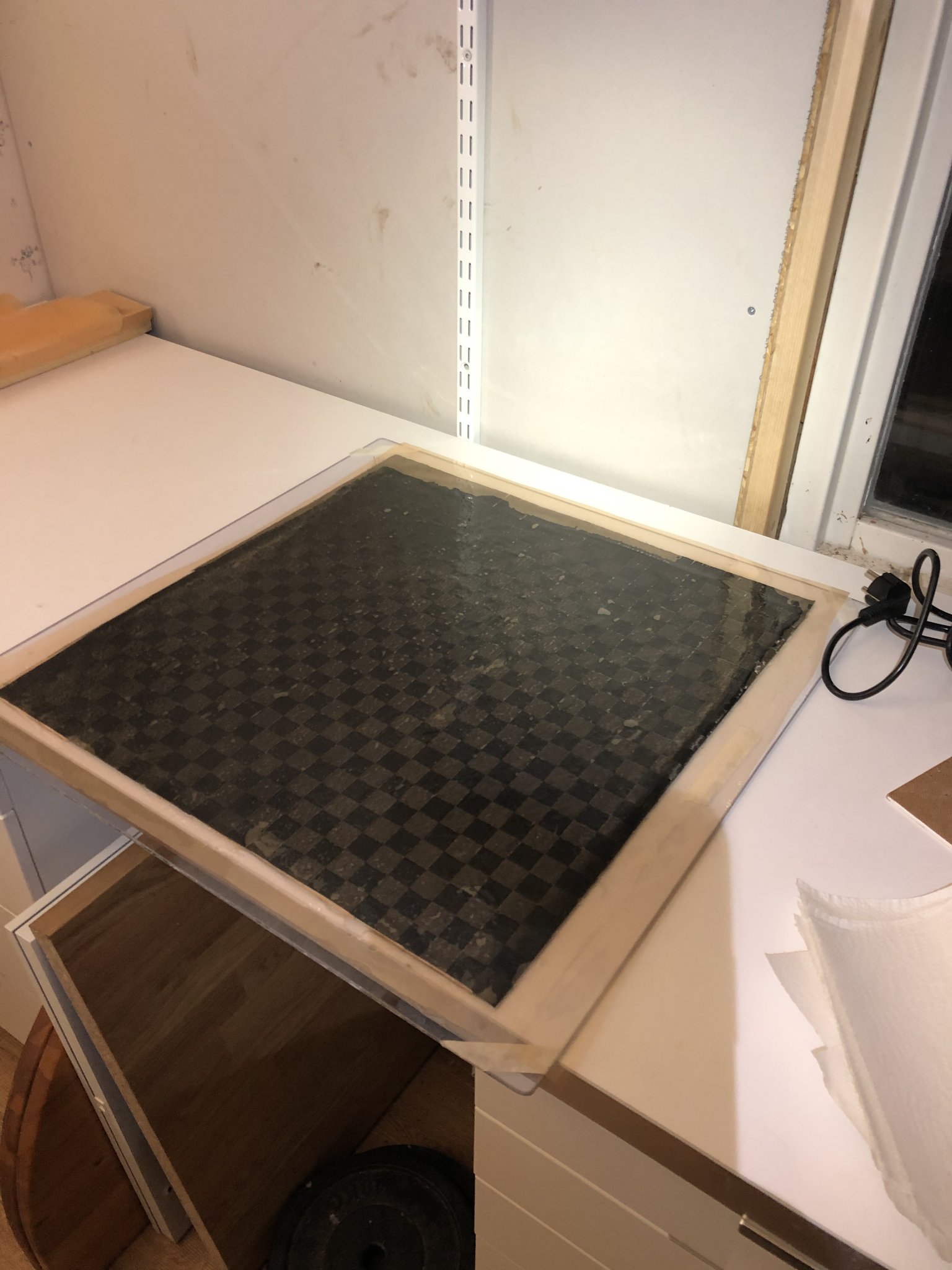

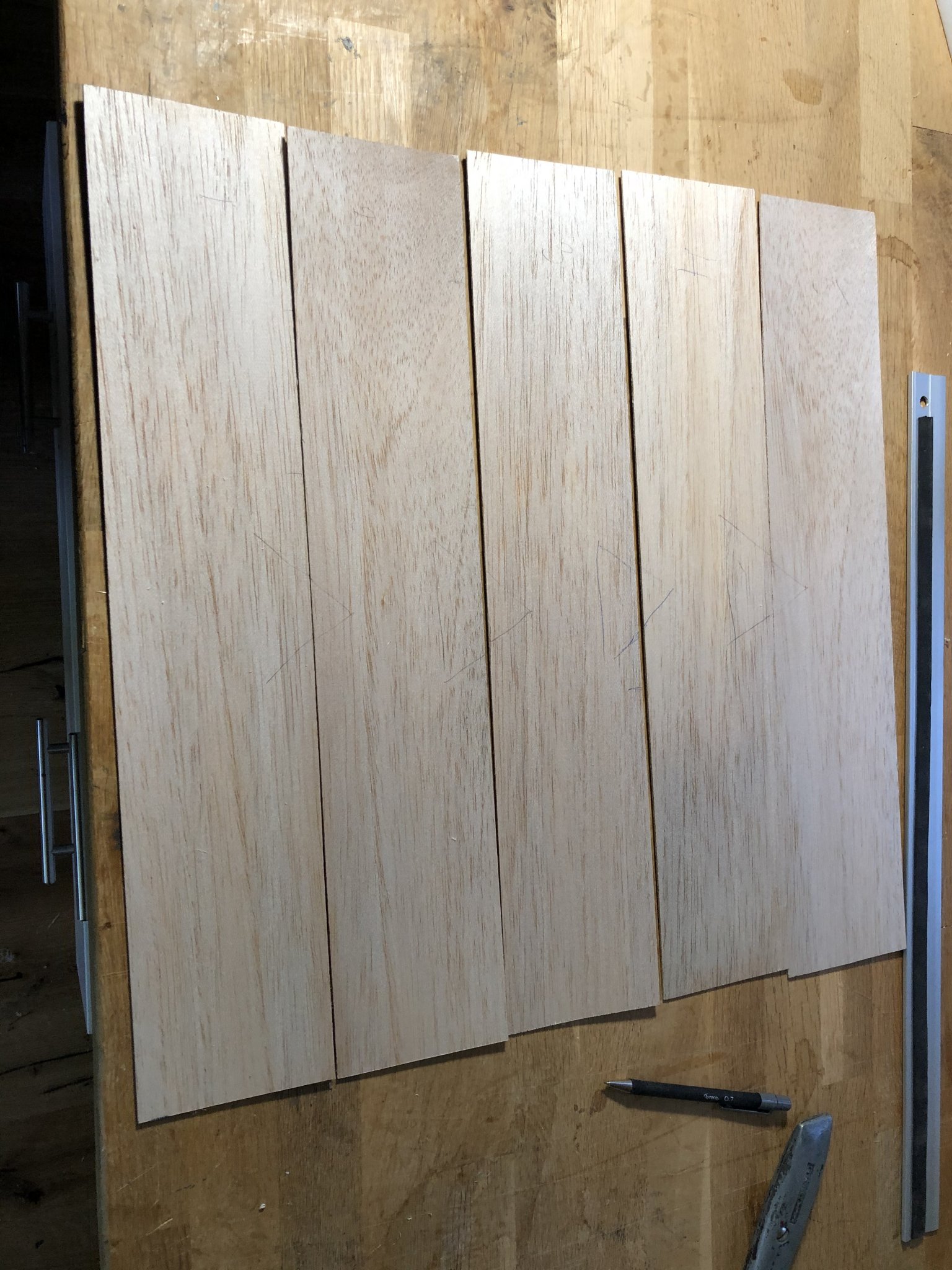

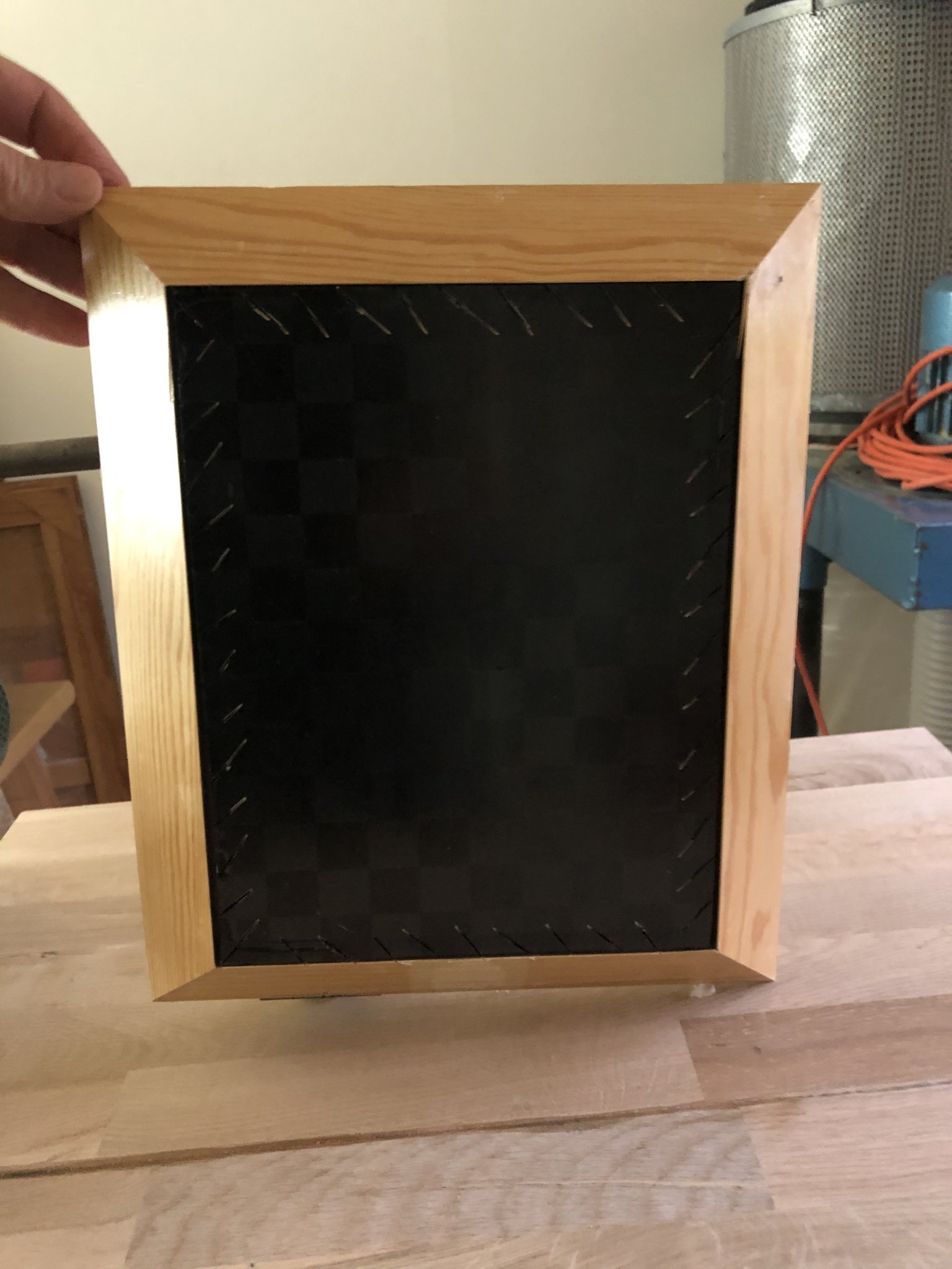

The sandwich is made out of 2 x 100 mm balsa sheets glued together edge to edge.
I am using Textreme 80g/m2 for the carbon fibre skin.
The balsa and the carbon fibre skins are laminated with epoxy in a vacuum press. I’m using a vacuum press as already have one. I beleive one can use som flat boards and clamps to achieve the same result.

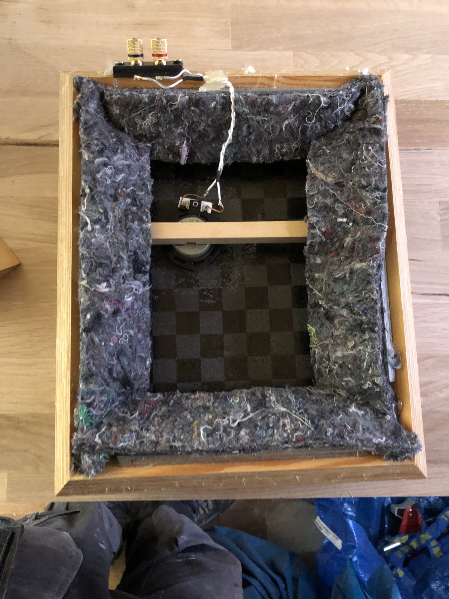

The design is more or less based on the göbel patent.
The size is 190x 250 mm.
The cuts on the panel edges is taken from the first göbel product.
The frame is angled 45 degrees to minimize diffraction.
The padding on the backside is also to reduce diffraction.
There is is a EPDM 8x15 mm rubber between the panel and frame to reduce reflection from the edge of the panel and to reduce vibration from the panel in to the frame.
The exciter is tectonic TEAX25C10-8/HS high power 20w. It’s placed according to the patent.
The exciter body is fixed to the frame. The reason for this is that I had problems with my first implementation. I heard increasing distorsion after some time and I also verified it with measurements. The reason for this was that the exciter body was hanging down. Which was easily verified by holding the exciter in the rigth position by hand. Thus the included support.
I am very pleased with sound!
It’s very transparent, Can play any type of music jazz, classical, metall, small groups, large groups, electronic with ease.
Can play very loud.
Imaging is excellent.
Needs support of a woofer.
