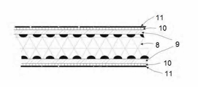

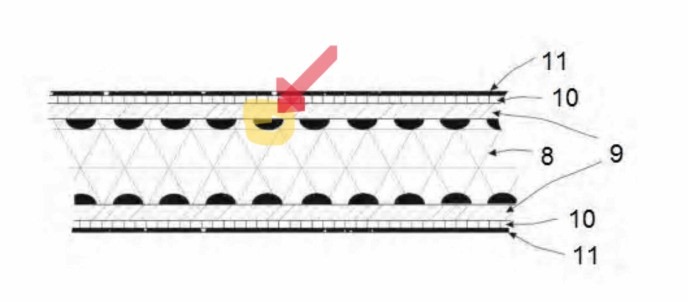

Few images from that patent which might give some ideas,
Best, of course, is to read the whole patent, maybe using Google translate. From this patent came their first Mescalito HiFi speaker, most probably. Their videos are short, showing mostly how they work, not how they are made. The patent tells you how they were made, and with a image of the product. Maybe, the inventor must produce a working product to get a Russian patent accepted, not just "I claim, we claim" with other country patents.
It is a honeycomb panel when finished, and the main sound transferring membrane is paper , on both sides. You'd have to read between the lines to catch some of the inventor's thoughts. Danilo Herger is not a Russian, so you can find the German or US patent somewhere. I'll find the Russian patent that's used to make the Mescalito speakers sometime later, I hope. 🙂

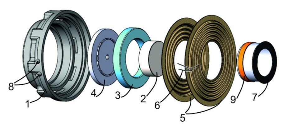

An excerpt from a Herger Danilo patent of 2021,
The rest you'd have to read with Google translate.
(Well, if someone here says they reached 20k...when the commercially available exciters can hardly reach 10k, no need of further patents. 🙂)
The proposed technical solution relates to acoustics. It is an electrodynamic drive for the operation of flat-type acoustic systems.
There are a number of industrially produced electrodynamic drives for the operation of flat acoustic systems from different companies: Dayton BST, Monacor, Visatone, Mechakustik, etc. Such loudspeakers are usually designed to operate in the mid-frequency and high-frequency ranges. The lower cutoff frequency of most loudspeakers rarely extends below 100 hertz. Less common are loudspeakers that can provide an operating range in a finished speaker system within 50 Hertz -10 kilohertz. Among industrially manufactured products, there was no such exciter that would provide the full spectrum of audible acoustic radiation (20 Hz-20000 Hz). As a result, industrially produced electrodynamic exciters from many manufacturers are unsuitable for creating a full-range flat-type speaker system. The frequency range of operation of such exciters entails the need to apply various measures to ensure the expansion of the frequency range of the acoustic system: such as the creation of multiband systems in which expansion into the lower and upper region of the boundary frequencies is achieved by using additional acoustic links, including complex systems of acoustic filters, or the use of additional electrodynamic exciters specialized for operation in a narrow acoustic range of the upper or lower register.

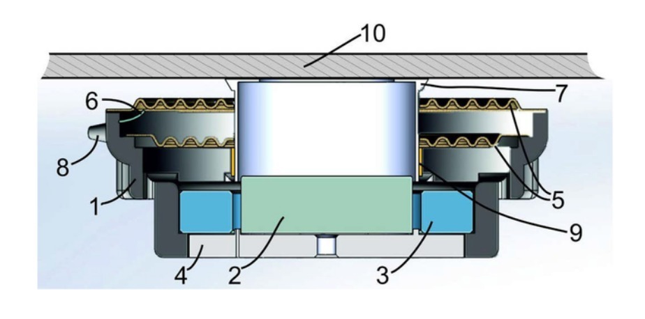

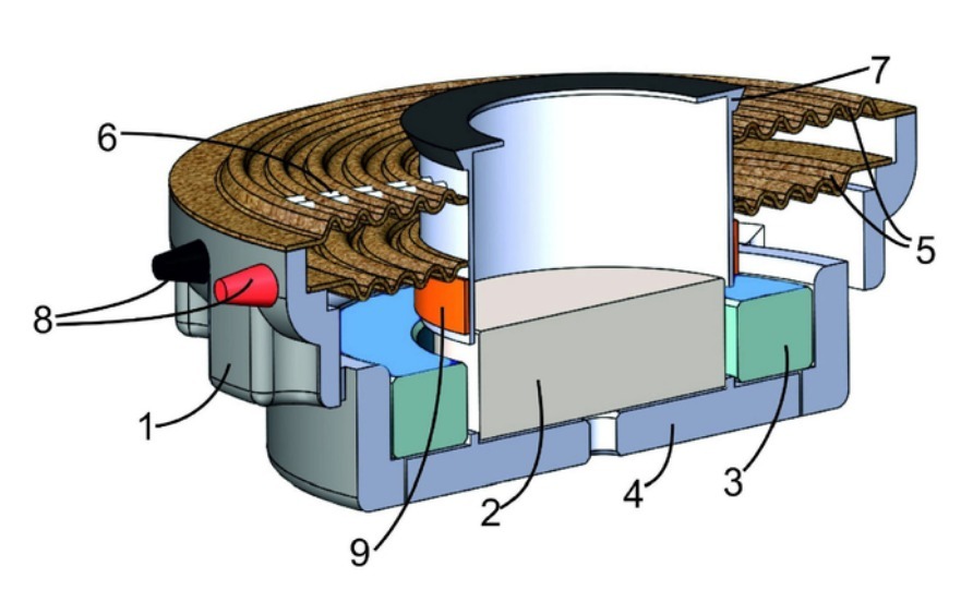

Further to post #8024,
Herger Danilo's invention.
1. Body,
2. Permanent magnet cylindrical shape,
3. Ferrite ring,
4. Steel washer,
5. The system for holding the coil within the magnetic gap in the form of two centering washers of different diameters,
6. Leading an electrical signal to the coil of wire,
7. Ring,
8. Contacts,
9. Cylindrical coil,
10. Sound emitting membrane
For the why and how, you'd have to read his patent. Wonder whether it is to be found in English or German.

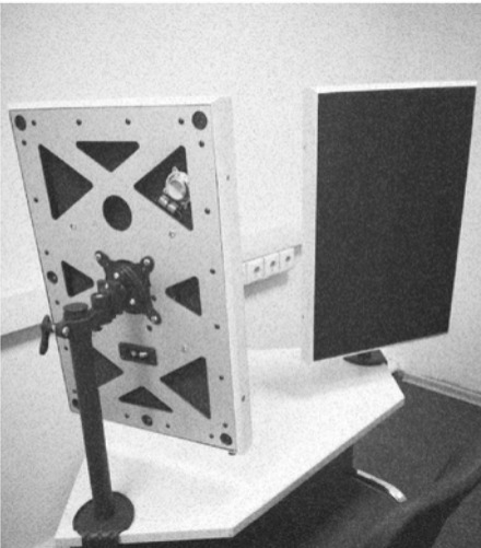

Some images,
Those, who had watched Mescalito videos might recognise them. 🙂
Some images,

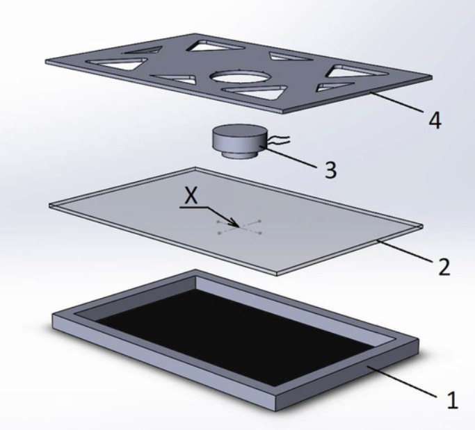

Further to post #8,030,

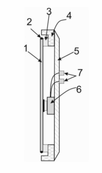

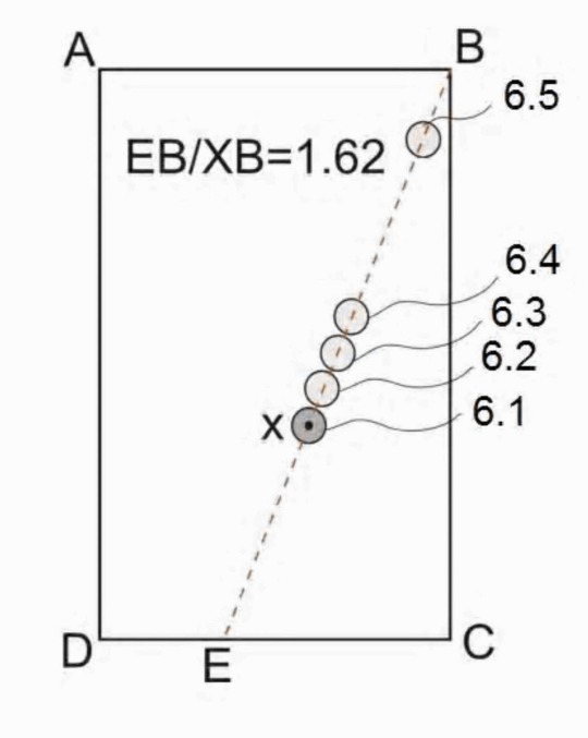

Practically everything in that patent can be constructed, except the transducer (3). They must be making the transducer by themselves.
Also, no idea what might be these black strips.For example, the driver of acoustic vibrations (3) includes one (or several) exciter of acoustic vibrations, containing a housing in which are installed: a magnetic system, a cylindrical coil mounted on a frame, a system for holding the coil within the magnetic gap, and flexible wires for supplying an electrical signal to the coil. At the same time, the magnetic system is made in the form of a permanent magnet of a cylindrical shape, a ferrite ring, in the center of which is installed, the specified magnet of a cylindrical shape and washers fastening them in a single structure, a cylindrical coil mounted on a frame is located above the cylindrical magnet and in the gap between the cylindrical magnet and the ferrite ring, the system for holding the coil within the magnetic gap consists of two centering washers of different diameters fixed at a certain distance from each other, in the form concentrically corrugated discs, with an inner hole attached to a cylindrical coil mounted on a frame, and an outer perimeter to the body, while flexible wires supplying an electrical signal to the coil are sewn into one of the centering washers and soldered to the coil terminals at one end, and to the outer contact group. The frame of the cylindrical coil is attached to the sound emitting membrane (2).
My guess is some sort of damping?
