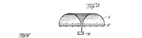

Lee De Forest patent fig. 8 gives lot to think about.
The point transfer of up-firing 'exciter' to an expanding curved panel - there's lot of 'points' on the voice coil bobbin.
By the way, I've mentioned the idea of transferring the sound to many curved panels, a bouquet of panels, (NBC logo) before I discovered Lee De Forrest.
