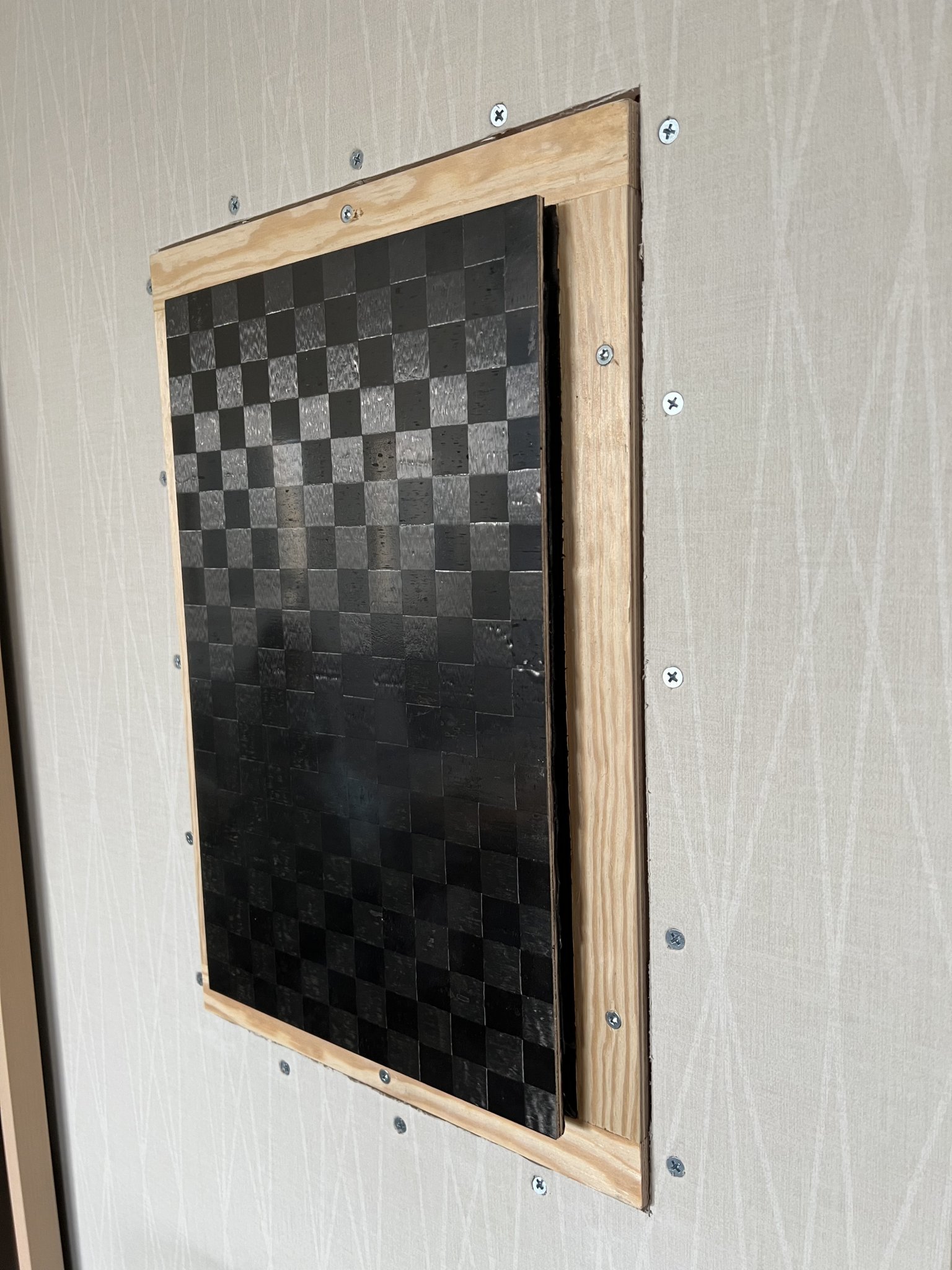

here are two examples. Recorded using an iphone. The speakers in the video are my latest project. They are actually a hybrid of DML and piston.
However they sound the same (above 250 Hz) as the speakers I showed in the previous post. The panel is built in the same way.

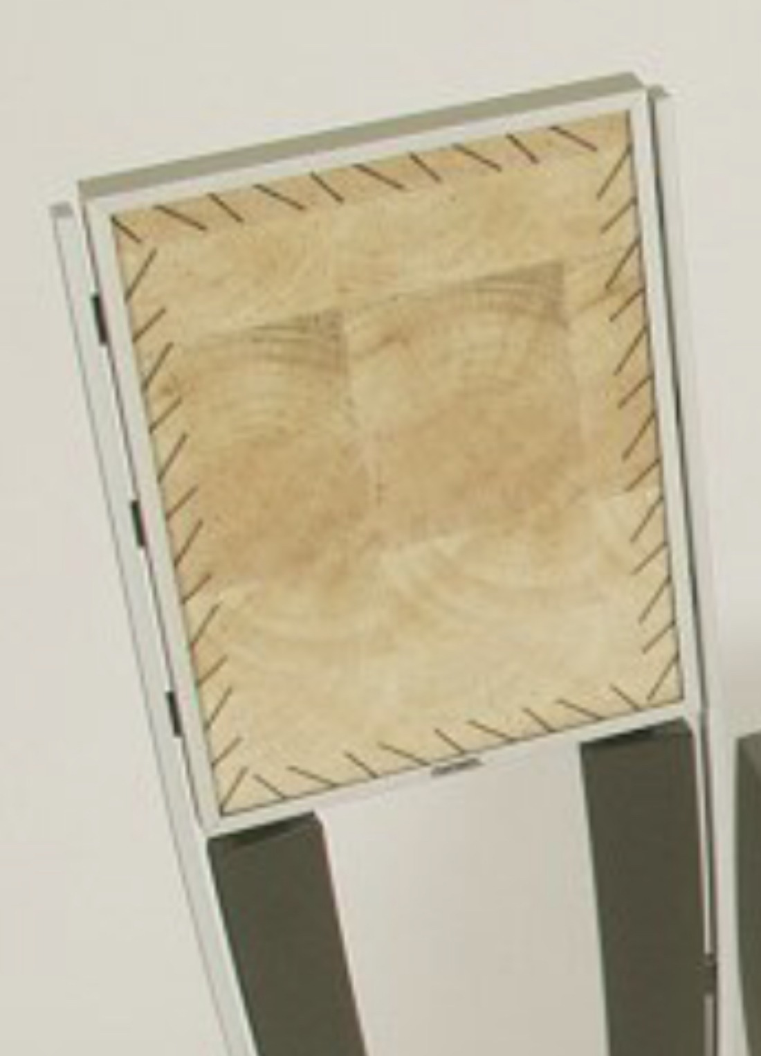

The question is "end grain balsa" in 1.5 or 2mm. Have you found some? Boards 10cm by 1m in different thickness are quite aesy to find.Looks like Aliexpress has. Hope it helps.
I can easily get 1.5-2mm balsa sheets, but I’m struggling to find end grain sheets at this thickness. See attached pic.The question is "end grain balsa" in 1.5 or 2mm. Have you found some? Boards 10cm by 1m in different thickness are quite aesy to find.
Sandasnickaren’s speakers sounded great, so maybe not worth the hassle trying to source end grain and just use standard sheets glued together, as Sandasnickaren has done. 👍I can easily get 1.5-2mm balsa sheets, but I’m struggling to find end grain sheets at this thickness. See attached pic.

Also worth considering is the density of balsa that can vary between 60 to 250 kg per kubik meter. I have used the ligthest I could find which was roughly 100kg/m3.Sandasnickaren’s speakers sounded great, so maybe not worth the hassle trying to source end grain and just use standard sheets glued together, as Sandasnickaren has done. 👍
I’ve considered making an endgrain core (I do have the equipment to do it). It would be intresting to see/hear if it makes a difference. Maybe later on.
What was the weight of the panel without the carbon film cover? Or, with the carbon film cover?Also worth considering is the density of balsa that can vary between 60 to 250 kg per kubik meter. I have used the ligthest I could find which was roughly 100kg/m3.

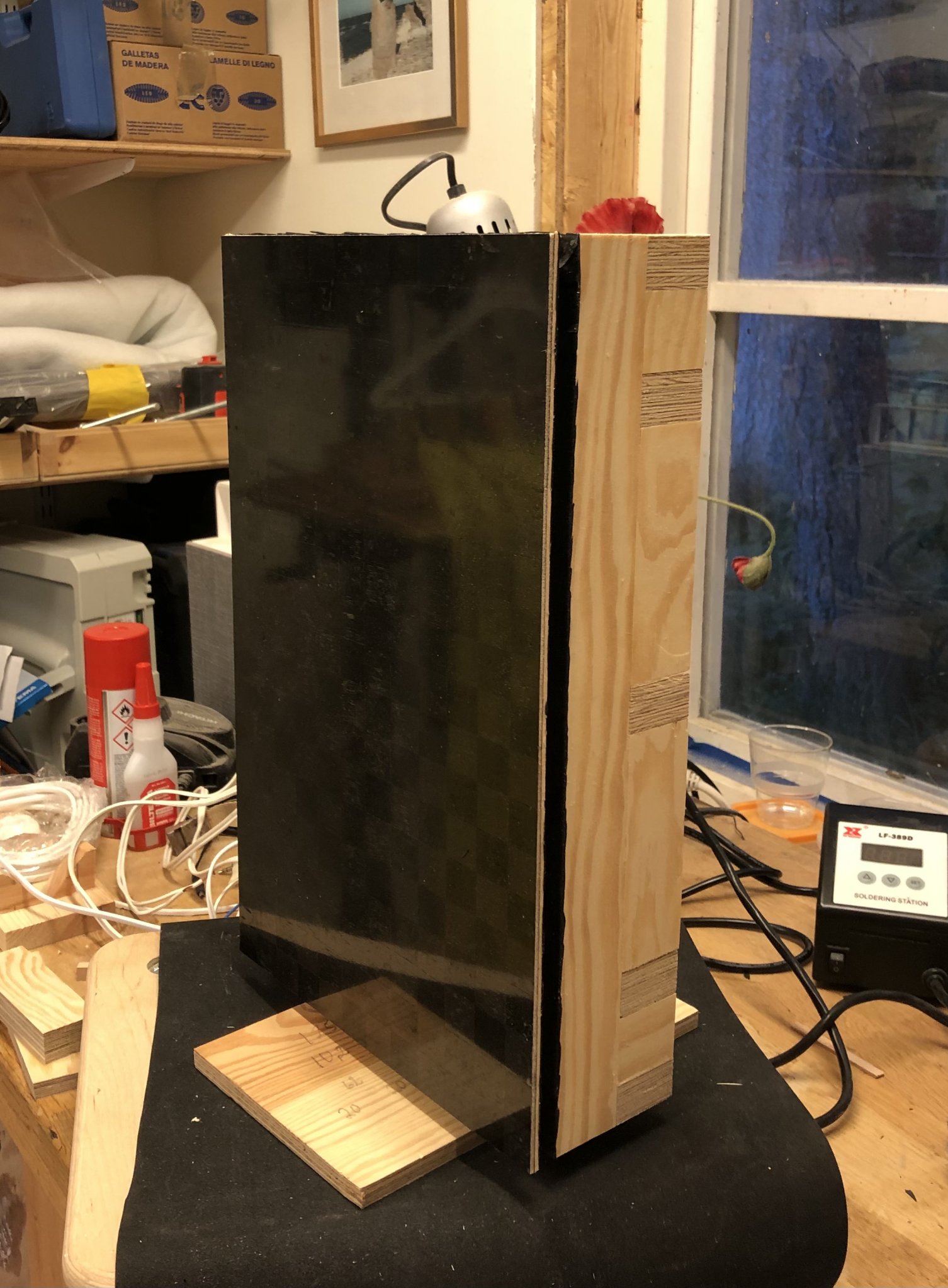

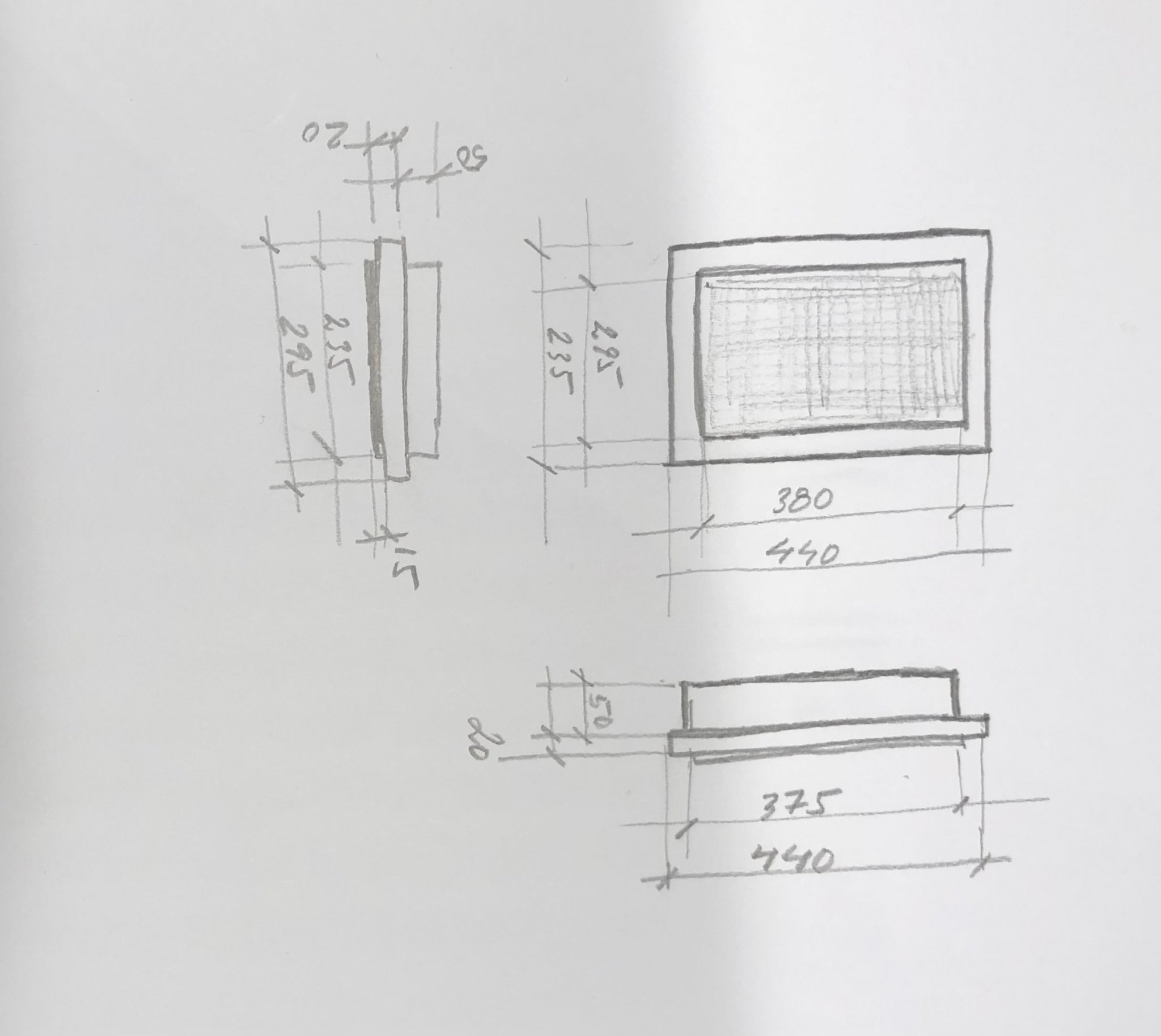

As requested,@Sandasnickaren
Lovely!
Would you like to talk about your latest project? That is, what's behind the panel, and so on...

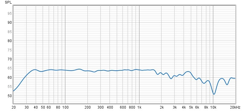

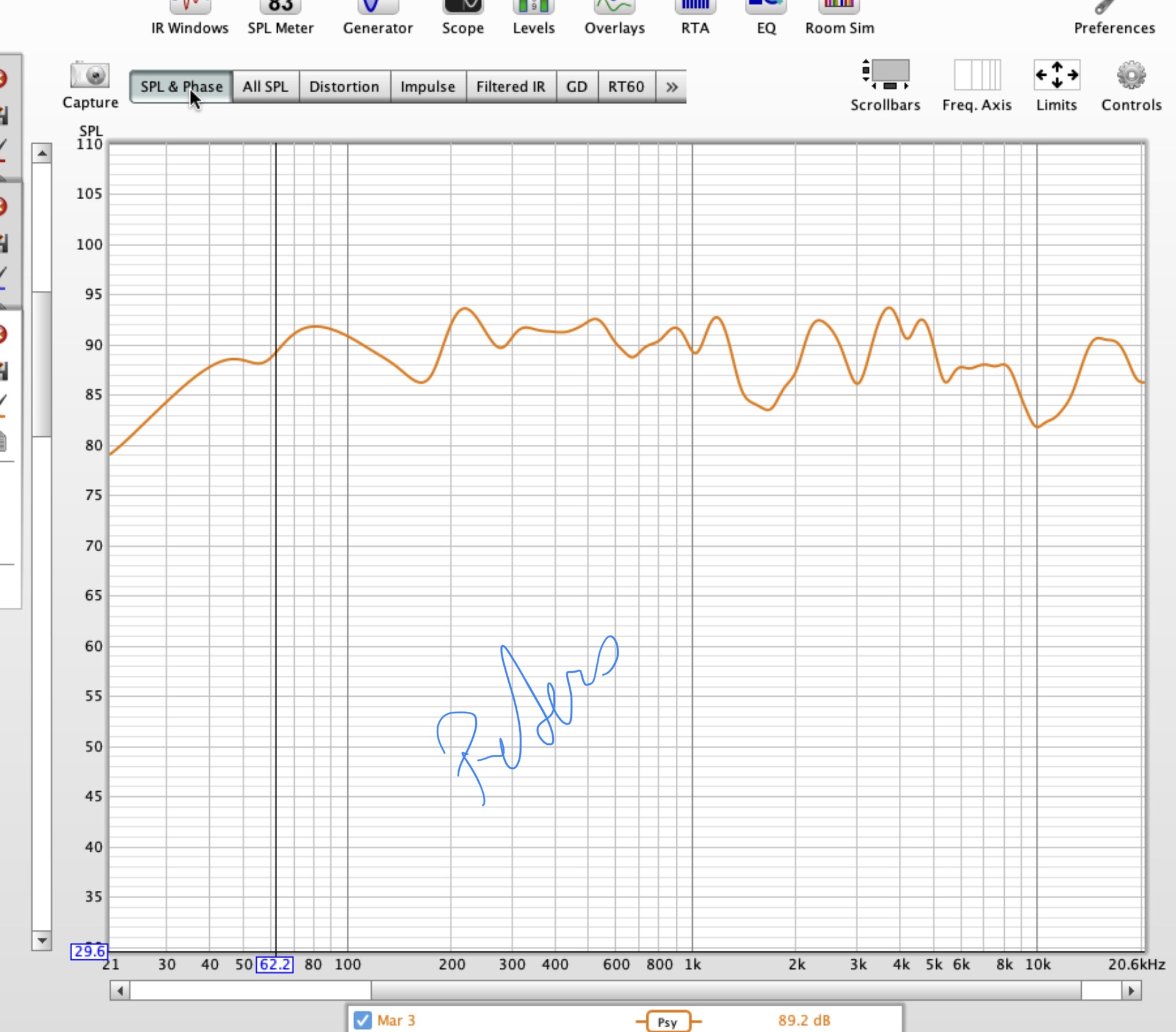

These are designed to be in a closed box or in-wall. I call them hybrid as they operate both as DML and piston. The size is roughly the same as an 15 inch driver ie SD 912 cm2,but the moving mass is only 60g and the BL 29 Tm. Xmax 10mm p-p.
There is a ”regular ” foam surround I made from 1 mm EVA foam. It’s U shaped.
I’m using 6 exciters to drive the panel.
’Frequency range when mounted in-wall is 30-20000 Hz. It’s most likely possible to push them down to 20 with a bit of eq.
measurements from 1m and nearfield few cm.

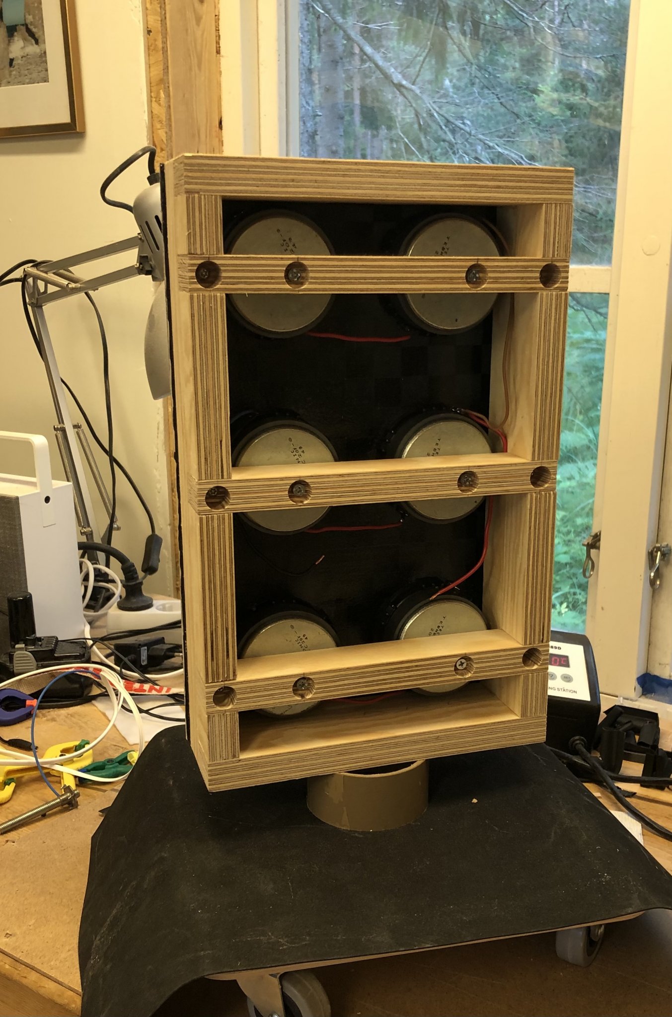

Can you give the dimensions of the box, length and breadth of the panel? How are the drivers connected?As requested,

balsa 10gWhat was the weight of the panel without the carbon film cover? Or, with the carbon film cover?
CF 8 g per side
in total 26g
I just checked, 10g is 2 A4 printer paper. 26g is just 5 A4 paper. Is your 2nd project panel that light too?balsa 10g
CF 8 g per side
in total 26g
You've 6 drivers. Are you using a crossover?View attachment 1126716
The voicecoilformer is glued to the panel.
Hat was the finished weight of the panel? Thanksbalsa 10g
CF 8 g per side
in total 26g
No, same signal to all six drivers.You've 6 drivers. Are you using a crossover?
