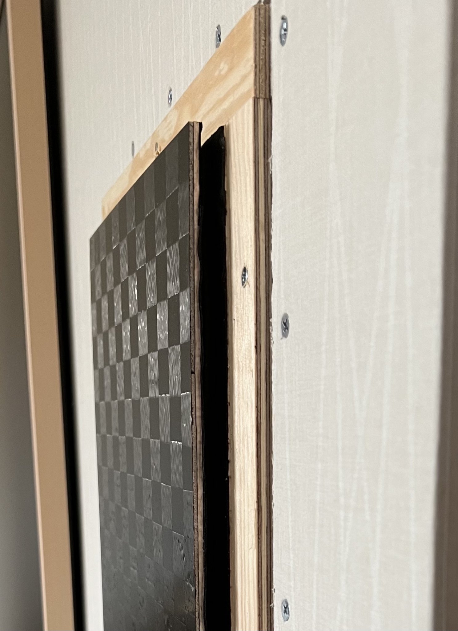

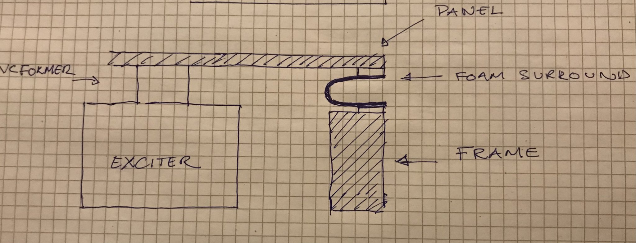

You've left the edges free,
View attachment 1126974 Is it because it acts more like a BMR?

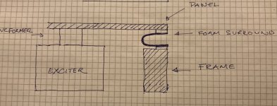

The edges is not free. There is a foam surround so they are in fact closed. Reason being that I wanted an output down to 30 hz.

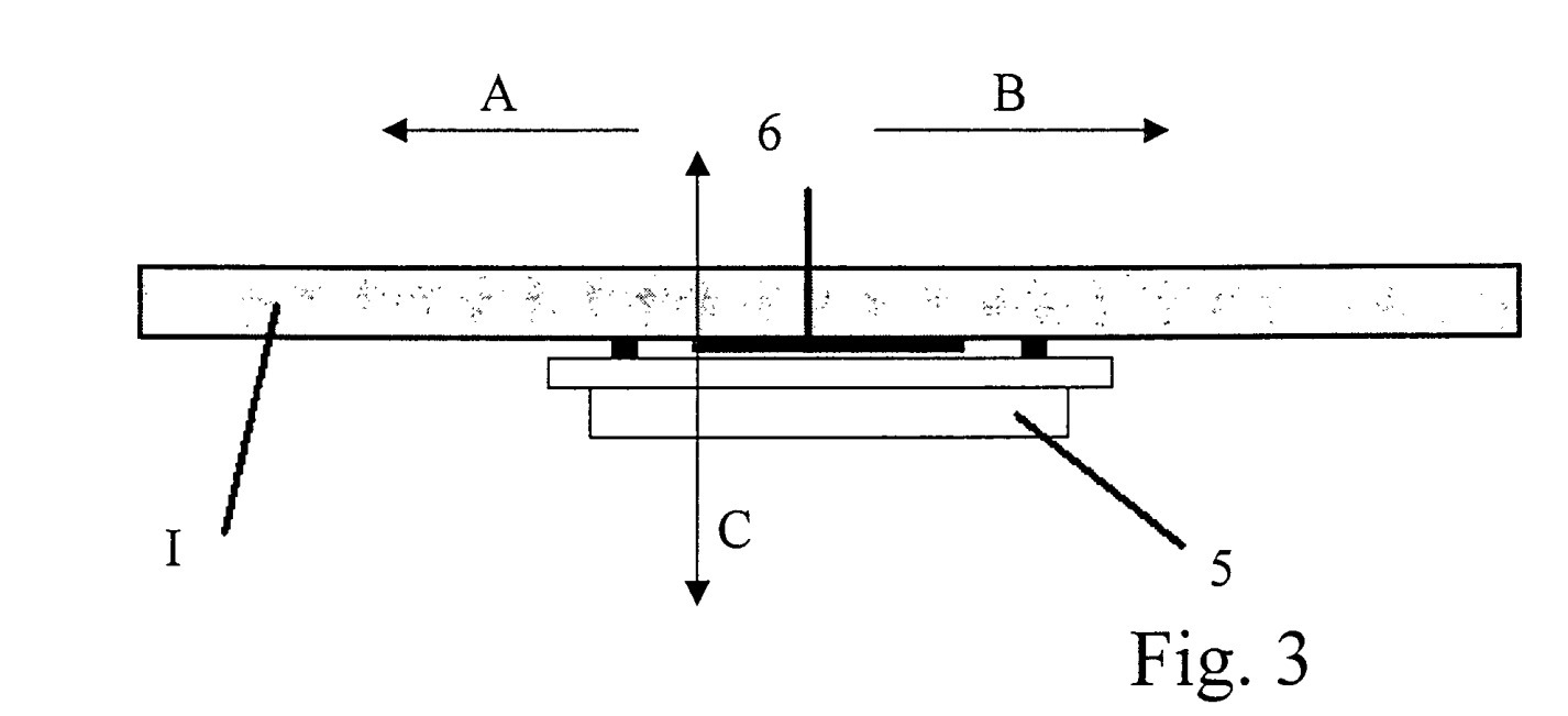

quick drawing side view.
No there is no puck.
Does the foam surround go right to the end of the panel? In the photo, it looks like the edge is jutting out from the frame (top corner). Isn't the edge of the panel open to the air?The distance is 120mm.
The edges is not free. There is a foam surround so they are in fact closed. Reason being that I wanted an output down to 30 hz. View attachment 1126982
EDIT: You've already replied to this question, so disregard the above questions. 🙂
I'll ask some more, though. 🙂 Hope you don't mind.

The reason for placing them like this is the Piston mode. It was the only way I could think of to achieve symetrical drive of the panel.
I dont know if there is any penalty in the dml mode? It doesnt seem to, considering the frequency response and distorsion. Maybe some of the wiggles in the frequency respons are due to this. But I wont know before I remove the speakers from the wall and measure them outdoors.
I also suspected that (because of the high driver/panel ratio) your panels can only operate as pistons for the lower part of the spectrum. But this also exposes the surprisingly flat responses of those exciters due to your close-miked measurements. It appears that the "break up"(?) beyond 1.5khz might be due to a combination of acoustic combing as well as panel resonances due to the symmetrical spacing of the drivers.
Are you able to do off-axis measurements to confirm DML action at higher frequencies? Do your panels sound the same whether on-axis or off-axis?
Does the box in the wall has the damping material on the back of the box, or just behind the panel? Maybe, because you put the panel in a box, there's good bass output.The distance is 120mm.

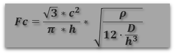

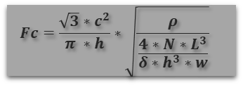

Here are some options depending which parameters you have on-hand.+ @Sandasnickaren
3 or even 4 parameters are linked to the bending stiffness and the areal mass : the efficiency, the coincidence frequency, the cut off frequency linked to voice coil mass, the modes linked to the area.
If the efficiency increases as the areal mass decreases, the cut off frequency is also supposed to decrease with decreasing areal mass.
So seems there is a trade off to find between efficiency and bandwidth.
Christian
Speed of sound in air, c = 343m/s
ρ = density in kg/m3
L, w, h, are panel dimensions in metres
D = Bending Stiffness in Nm
E = Young's Modulus in Nm
δ = Panel deviation under force in N
Take your pick, good luck! 🙂

I have a spreadsheet that is based on the equations in post #4180. Using that spreadsheet, I can estimate that the coincidence frequency (fc) of Sandasnickaren's carbon/balsa plate is likely in the neighborhood of 3800 Hz. Note that the bending stiffness estimate that I use neglects shear deformation of the core, and hence may underestimate fc.
And yes, Christian is correct that the tap test method can be used to get a pretty good measure of the panel bending stiffness, and that would be better than the estimate I get from my spreadsheet.
My carbon/balsa plate has a bending stiffness of about 23 Nm. Sandasnickaren's is likely about 15 Nm, due to the thinner carbon layers (about 0.1 mm vs .23 mm and offset slightly by the thicker balsa core (2 mm vs. 1.6 mm). His panel weight is likely about 0.61 Kg/m2.
Using those estimates in this equation (where B is bending stiffness and m' is panel weight per unit area)
gives fc=3775 Hz, give or take....
Eric

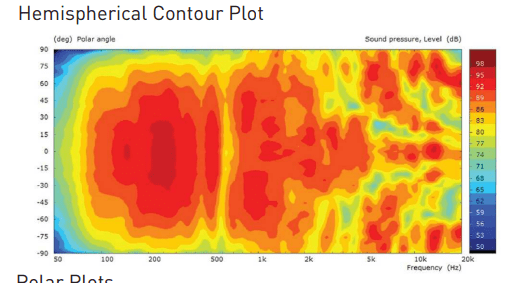

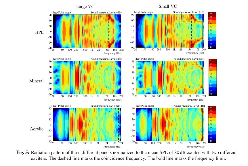

It's a funny thing about the coincidence frequency. For all of its supposed significance, it's actually pretty hard to detect experimentally (at least for me!).My understanding of the theory is that there is almost no sound output below the coincidence frequency.
The early literature suggested exactly what you wrote above: i.e., no significant output below fc. But that is clearly not true, as most DML's operate largely below fc. For example, one of the NXT papers implied that their panels were designed to have fc "outside the audio range" (presumably, above it).
Still, technical papers talk about the large increase in efficiency at fc, along with an increase in off-axis output (at 90 degrees to the panel). But even when I "know" (from calculations) approximately where fc should be, I have never be able to "detect" these features in my own panel measurements. It would seem like fc should show up as a clear spike in the SPL when the mic is positioned at 90 degrees. I've tried many times on many different panels, to find such a spike in the response, but I never saw anything that stuck out as clearly as I had expected. Most recently, I tried with a glass plate, for which the properties are pretty well known, and hence my estimate of fc should have been very reliable. Still, I observed no clear spike in the off axis SPL anywhere near the expected fc.
This image directly below (from a paper by B. Zenker) shows several hemispherical contour plots of different panels, which do show some pretty characteristic features at fc (indicated by the dotted lines). At the indicated fc, the output peaks in intensity at +/-90 degree angles. And above fc, the peak output (in dark red) moves to smaller and smaller angles. A similar characteristic is seen in the plot at the bottom for the Tectonic DML 500, which seems to show the same characteristics starting at about 6kHz.
But with my simple tools (a mic and REW), I have yet to be able to clearly distinguish fc by any direct measurement. If anybody ever finds a simple way to clearly identify fc by direct measurement, I would love to hear about it.
I was really thrilled when I realized that the simple "tap testing"(Christian mentioned in a recent post), revealed so clearly the modal nature of these panel speakers, and allowed the identification of mode shapes, modal frequencies, and even provided a simple way to determine the elastic properties of panels. I felt like my eyes were finally opened to what these panels really do.
But regarding fc, I still feel blind.
