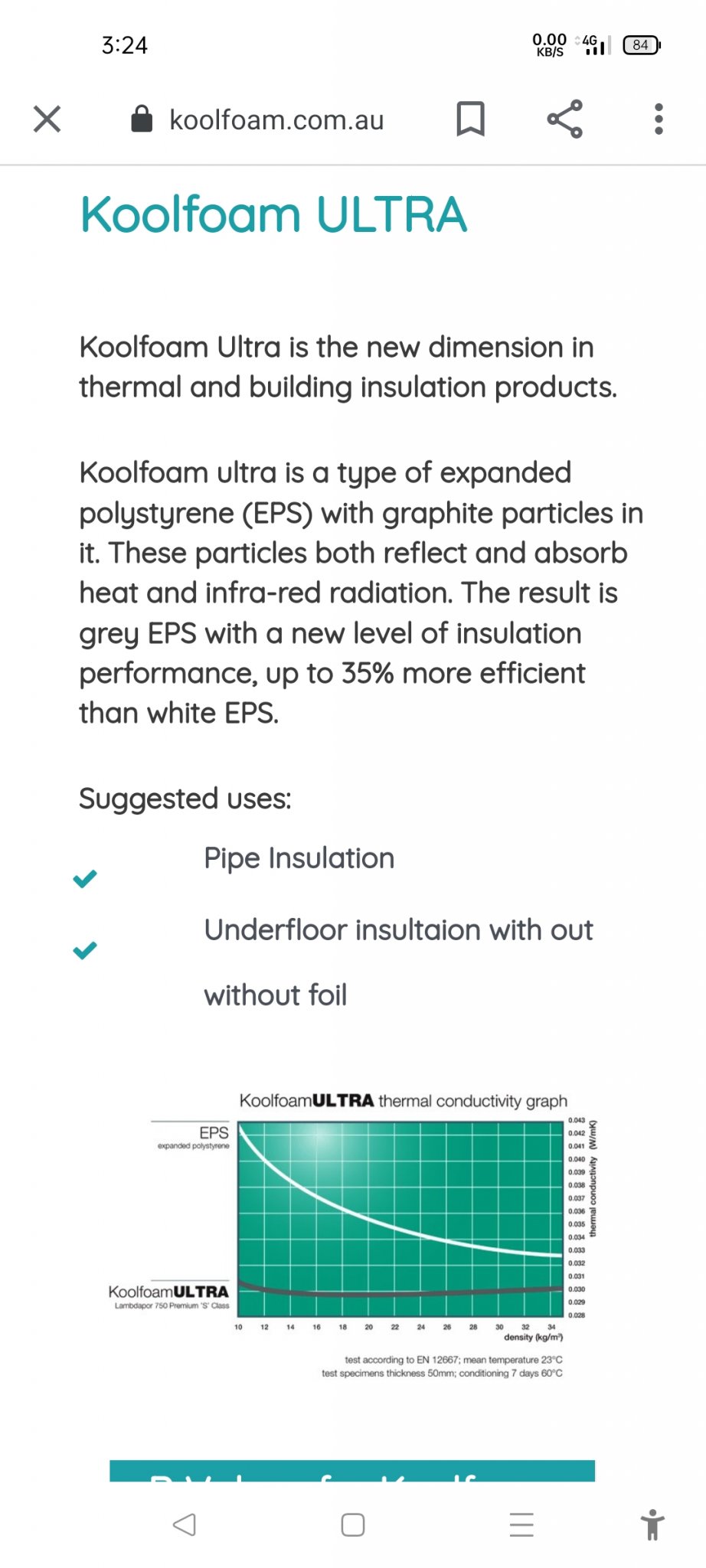

It is graphite enhanced EPS, but cannot figure out the density from the info on the page. It says 1.13 kg/me, but not at what thickness. The one I use is 25 kg/m3.Leob.
I noticed this product on line, I believe it is similar to what you are using.
It is in a size I have used before and am interested in using again.
for 7 panels it is only about £22 but for 8 it works out at about £48 both with delivery?
If you think this is the same as your eps panels ,I might give them a call and confirm the prices .
Steve.
https://ewistore.co.uk/shop/external-wall-insulation/eps-insulation-1-board-0-72m2/
Seems worth a try for sure if one can order thin plates in low quantity.

I find it hard to source graphite enhanced EPS Neopor (GPS) materials in Australia. The closest material is XPS - available in 30mm thickness with a density of ~ 32 kg/m3.

Thanks! The difference between graphite enhanced EPS and regular is not that great. I found that the Neopor sounded a bit tighter than the regular EPS I had, but it might be a bigger difference between regular EPS of different makes and density than between graphite EPS and regular. I don't have enough experience to tell really. So it is probably worth looking for GPS, but I think any EPS you can find in thin sheets (20-25mm seems good) and reasonable density (20-25 kg/m3) without buying bulk would be worth a try.First of all congatulations for your 'festival'/large venue achievement using DML panels. Wish I was there...

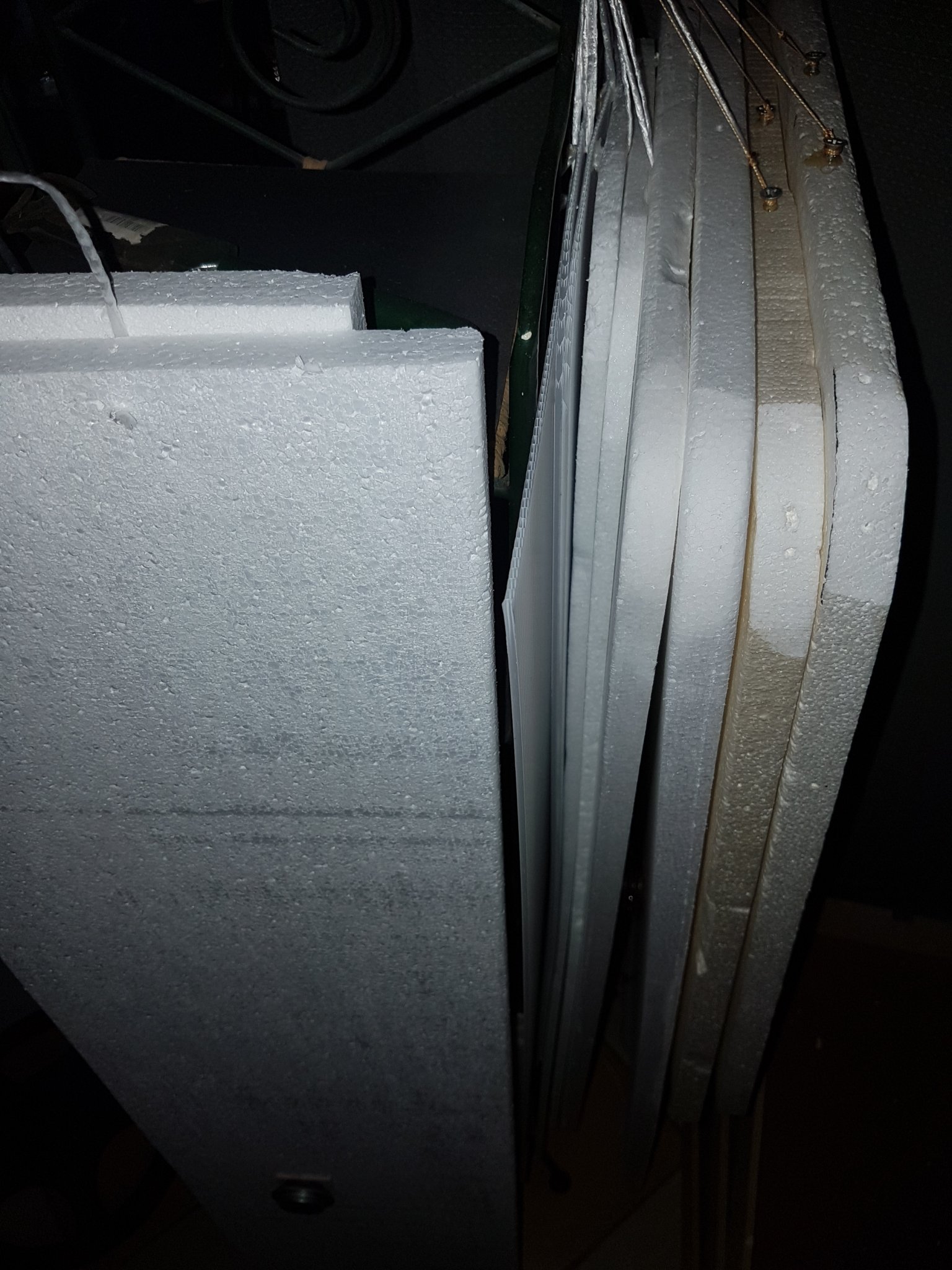

The best one is an air-conditioner packing board I pick which at 41kg/m3 (pic2). It sounds so GREAT but there're no way to get this in a bigger side. It's original size is 59x38x1cm. I have to cut it in two to be L and R. Fortunately the sound signiture image size don't change just loss some low end. Smaller size also make the sound stage a little deeper. It's my default panel now.

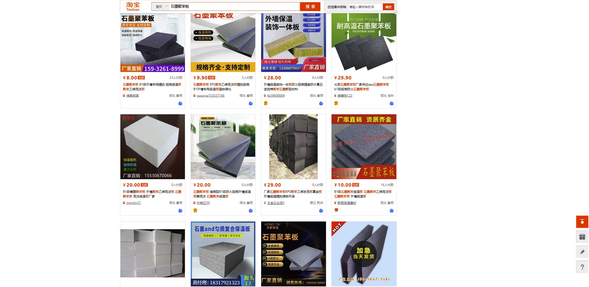

I also want to try the graphite one but they're all comes with 5cm thick.
Tried seveal thickness of xps too but all sounds like toy even apply a "deep" sanding to remove the skin totally. Give up.

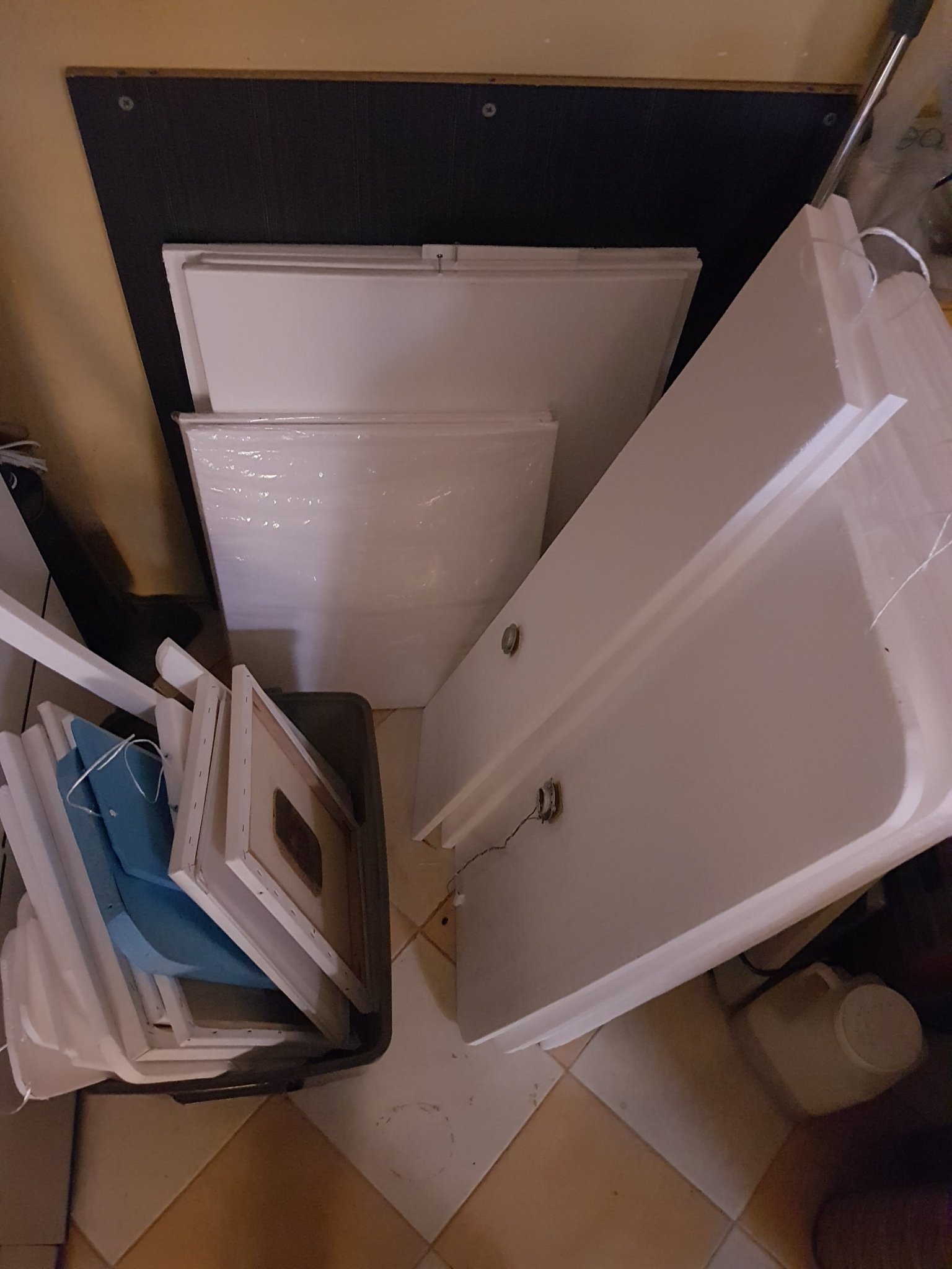

OH dear, someone's room looks similar to mine, nice collection of panels.
Personally I'm not sure that the heavier EPS panels do sound better than the lighter EPS ?
I was getting some very good sounds from some low grade 1cm EPS packing material with a coating of 50x50 pva.
But which ever, EPS is my favourite.
Steve.

Sound Better is just represent my peronal perference. Not measurement wise.Hkguy6.

Other corner and stuffs.
The last pic is my peronal best sound settings up to now. But not for daily listen because space. 🙁
