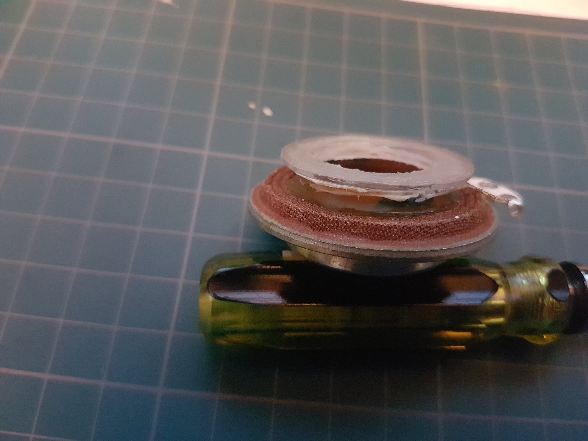

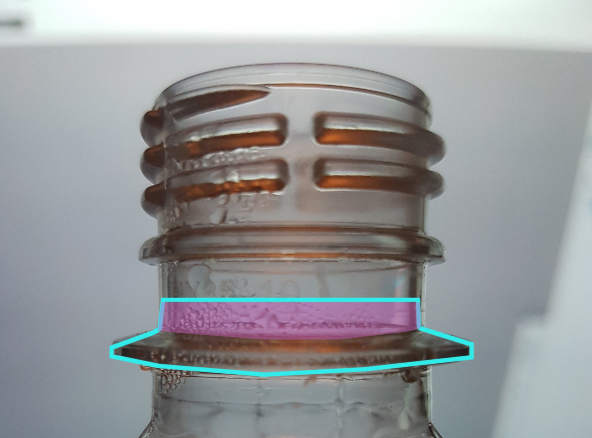

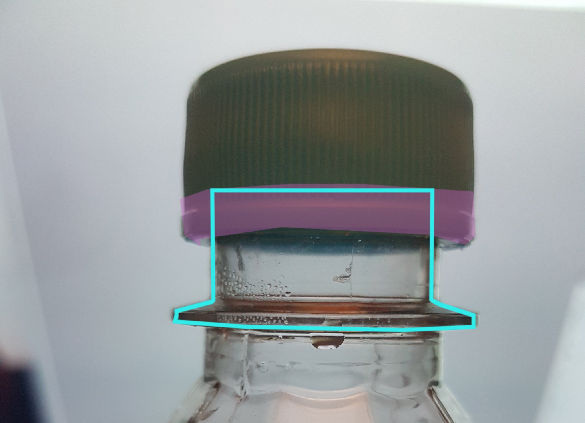

Exactly my thought seeing the picture. The point is about the cap. Is it a plastic suitable for gluing?
The orginal disk also a plastic, so I think it's ok for gluing. Some sanding also help.
My idea is:
1. Just replace the demage disk by the blue line part. Pink area glue into the voice coil.
2. or, Screw mount system. Pink area of the cap glue into voice coil. Blue line part glue to panel.

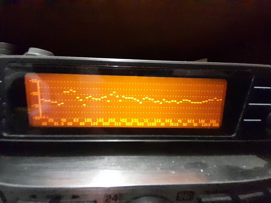

This picture which I think I posted before?,is of one of johnnogs proplex 2ft panels, with the exciter just plonked in the centre.
With no eq or damping but with an excellent response plot.
Strangely I can only hear clean sounds with no ringing 🤗
The tectonic link explains why.
Under ,how dml works.
The last computer animation at the bottom clearly shows the impulse in the centre of the panel with the dml actions there after.
Steve.

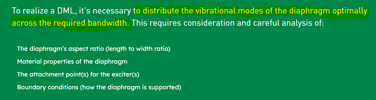

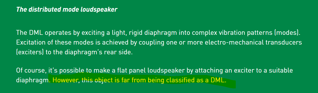

I would never have said it, but Tectonic don't think your panels are DML's, Spedge. Flat panel loudspeakers yes, but DML no.
Now that part seems vaguely familiar...hmmm...where did I read that before??
I do wonder how many of us comprehend this simple fact: the primary effect that virtually every design factor we ever discuss in this thread is that it influences the set of natural frequencies of our panel.
Panel stiffness, density, anisotropy, thickness, size, aspect ratio, stiffeners, added masses: The main impact (by far) of modifying any of these features is to influence the distribution of the panel's natural frequencies along the frequency spectrum.
Likewise, the type of suspension chosen: free, hinged around the perimeter, clamped around the perimeter, or whatever. The main impact of the suspension mode is to determine the distribution of the panels natural frequencies along the frequency spectrum.
Yes, sure, the suspension has a big impact on damping, which has important influences, but first and foremost, suspension determines the distribution of the natural frequencies.
Exciter placement too. For light panels, the exciter placement influences the distribution of natural frequencies. And for all panels (heavy or light), exciter placement determines which of these natural frequencies will be emphasized, and which will be deemphasized.
In other words, to design a DML is essentially to select (either by accident or on purpose) a set of natural frequencies than can be coerced into producing a reasonably flat frequency response over some particular frequency range.
