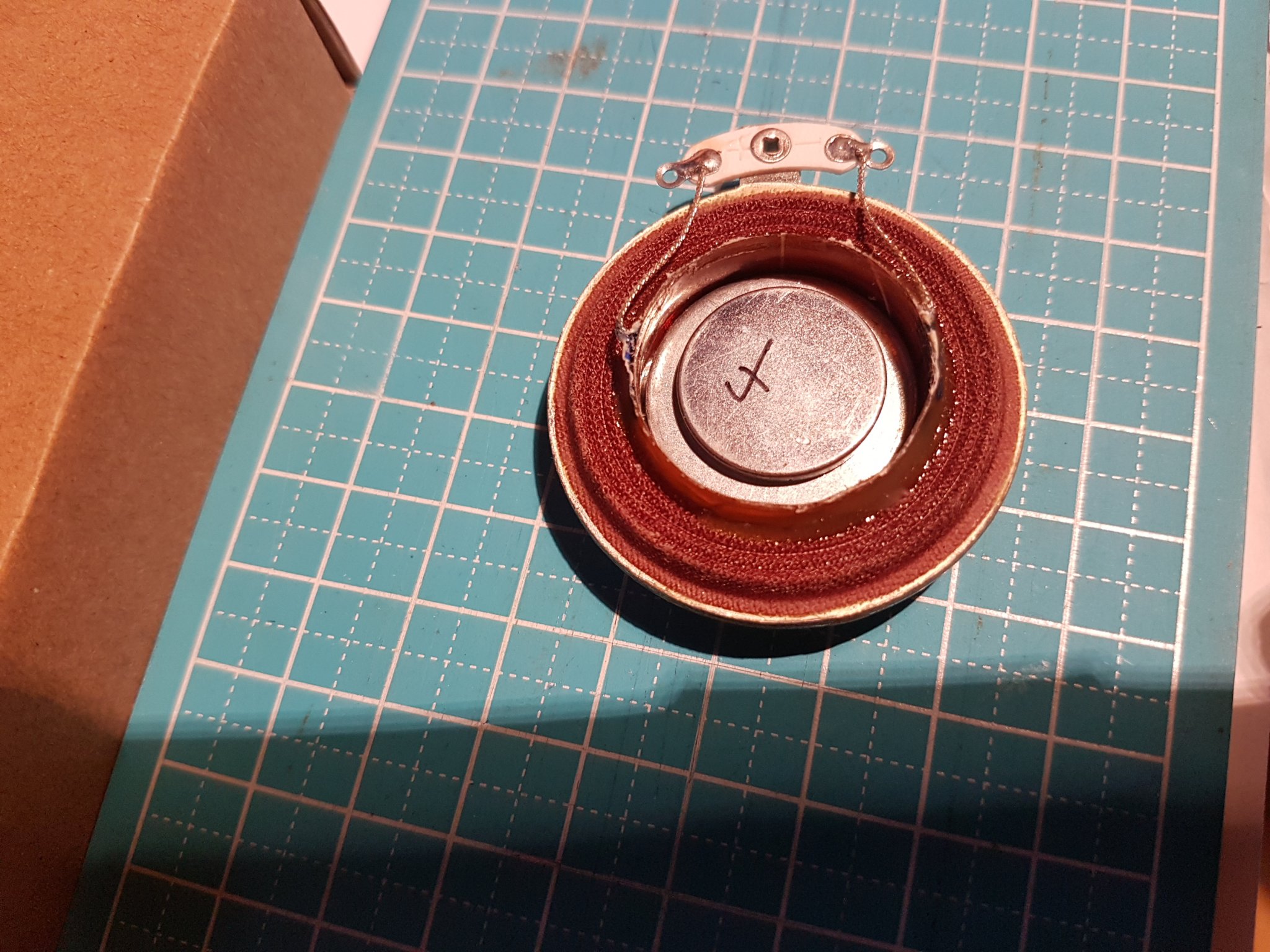

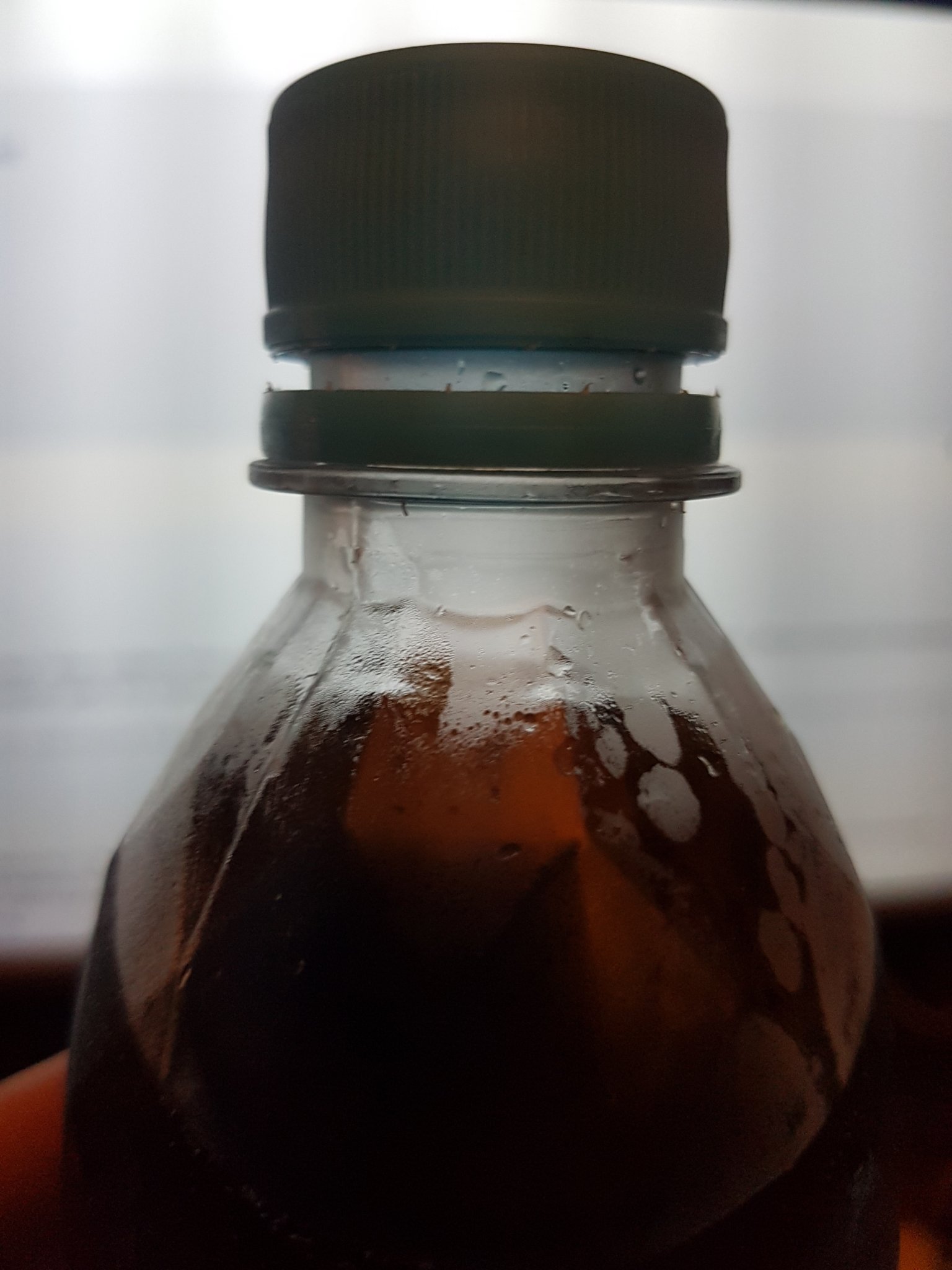

2 of my excitor's voice coil disk demaged. Just saw a replacement on this bottle.

Interesting! Please post after repairing and which glue you use (super-glue?) Might it be a way to reinforce this interface for a better force transfer?
Super glue maybe too brittle for vibration. I will try pva first.
However this bottle let me thinking another diy. The Dayton new screw-mount system.
The bottle actually has screw ring and mount disk all together. Just the screw-line maybe not fine enough for the shallow voice coil. Let see.

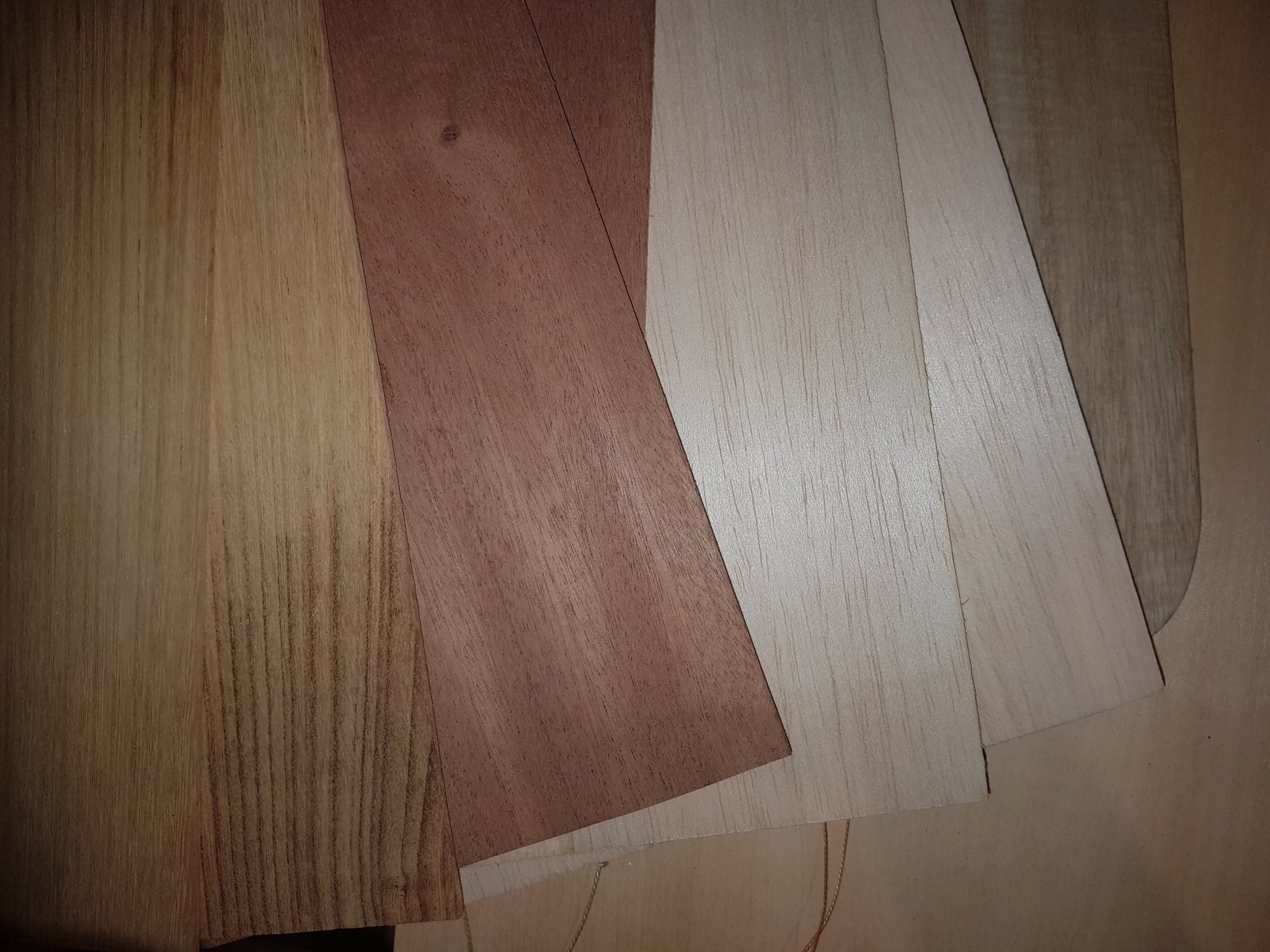

Hello hkguy6;
Wondering what the dimensions and thickness are in your third Picture. The EPS and the wood panels.
Pete
eps: 40x100x2cm 15kg/m3
wood: 23x45x0.2cm
I found the eps size different not change sound much as the wood size.
Wood type also a matter. I tried around 8 types of wood they are all different.
The wood I used on the third pic is from a dollar store. Don't know what wood is it, not a ply.
Exactly my thought seeing the picture. The point is about the cap. Is it a plastic suitable for gluing?
