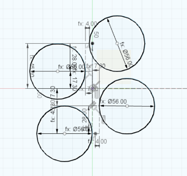

Thanks! I made a parameterized template for positioning exciters in Fusion 360, but not sure how to show that so it makes sense. Here is a screenshot from fusion, but is is very hard to read:Thank you Leob
Really impressive.
Would you mind to post some technical details : position of the exciters, position of the foam (seems very little on each vertical sides) and may some pictures here in case the video are not accessible for long.
Just added the link to your post in the "history file"
Christian

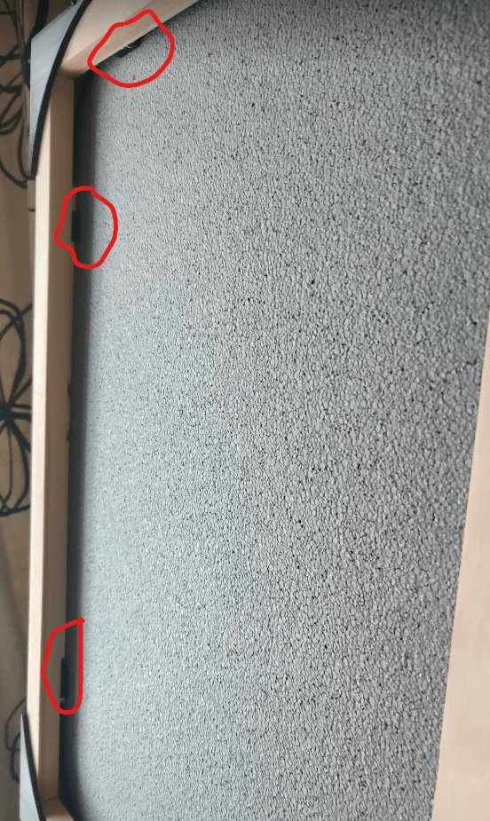

Didn't spend a lot of time tweaking it to find an optimal configuration though, but also didn't notice that big differences when trying slightly different positions.
For the suspension I added small 2cm strips close to the corners:
Again, didn't have much time to really tweak the position and length of the strips, but was happy with the results like this.
Modifying suspension seems to have the greatest effect on the FR, and I think that if I really spent time optimizing that as well as exciter position and plate dimensions I could probably reduce the EQ needed a lot. Now I need to do 10dB cuts in the low mid to get a flat response, which is double compared to Tectonics recommended EQ curve for the DML500.
Still have to dig out those response graphs and will make another post with more info then.

Yes, my initial tests was with similar suspension where everything except the corners was clamped. Maybe that is good for a 3.6mm thick nomex/carbon plate, maybe their suspension is a lot less rigid, but the 25mm EPS seems to need a lot less clamping with the foam I used.Thanks Leob
I have also the experience that the suspension modify a lot the FR which makes sense when we think that the suspension controls how the waves are reflected at the edges in a frequency dependent way.
We see from Tectonics documentation their panels have some material on 50% to 60% of the edges.
It is currently a question for me how to go on on that. Some finish elements analysis allows to deal with the panel dimensions (see Veleric work)... but for the suspension how to limit the test/error processus?
Christian
It is reasonably easy to modify the clamping, and I hope just moving them around will result in changes in FR that makes some sense. Will be a slow process though, with a lot of trial and error. But I see no alternative than making small moves and recording the results, other than making a simulation.
They do sound really good and loud as they are, and I'm not sure if spending a lot of time fine tuning of the plates would actually result in that much of a difference in practice.
I can probably get a little bit better sound and higher SPL with a few days of testing and adjusting. But it will take a lot of time to make them perfect. As we say in programming, last 10% of the work takes 90% of the time.
