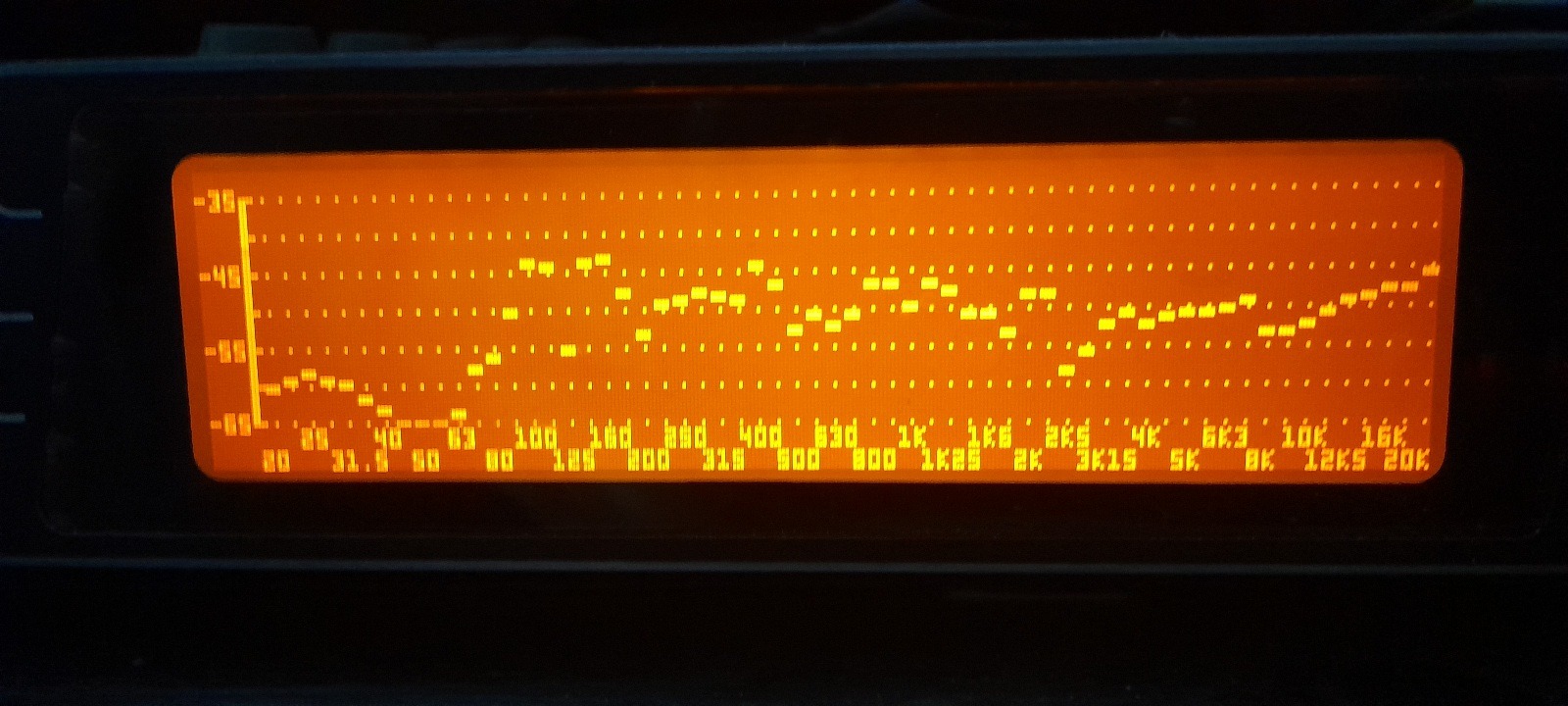

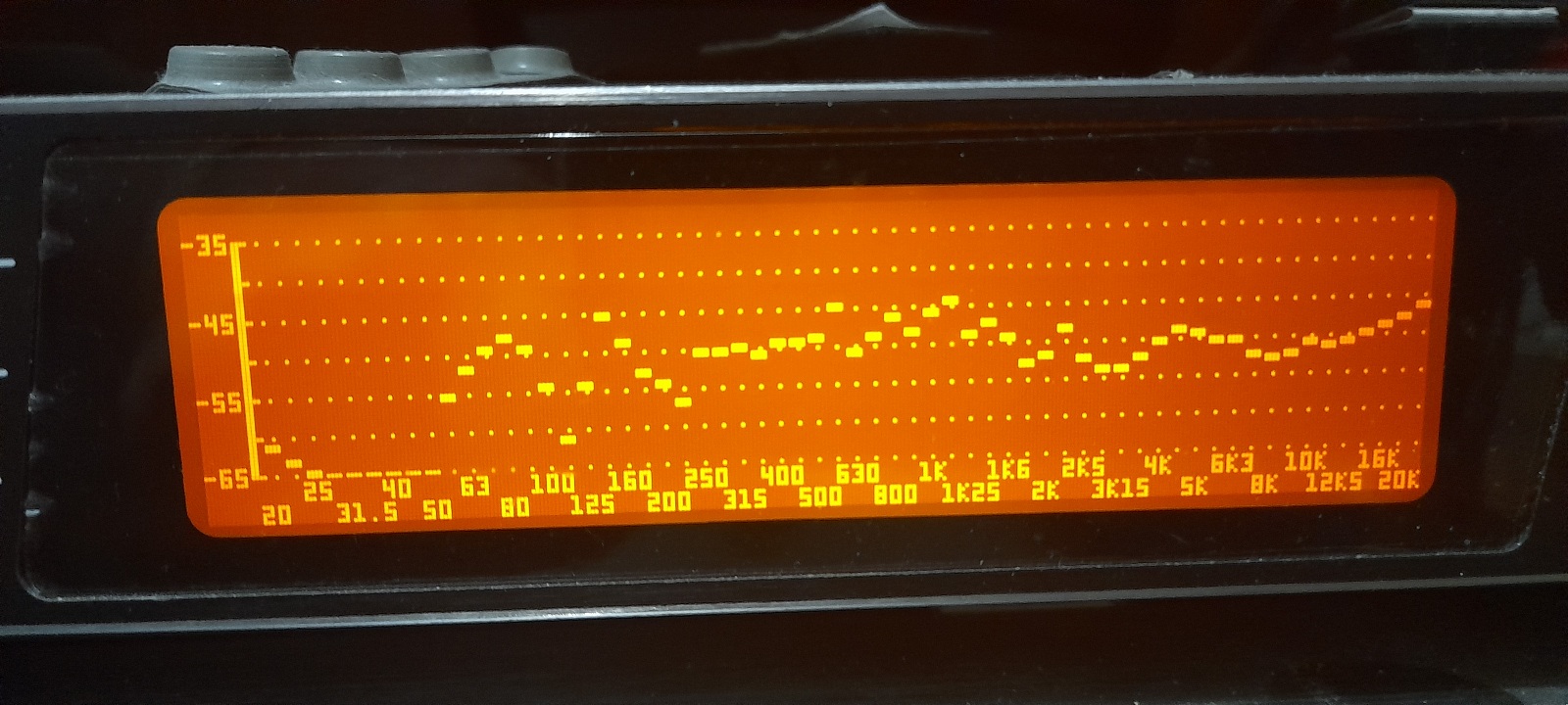

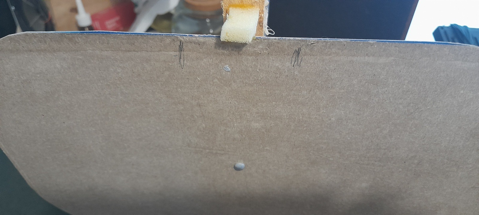

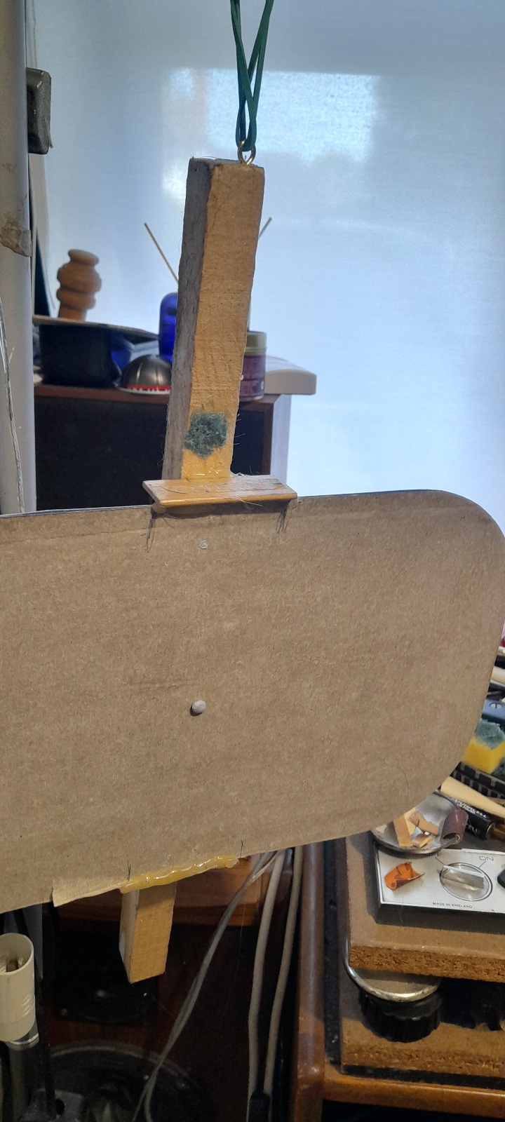

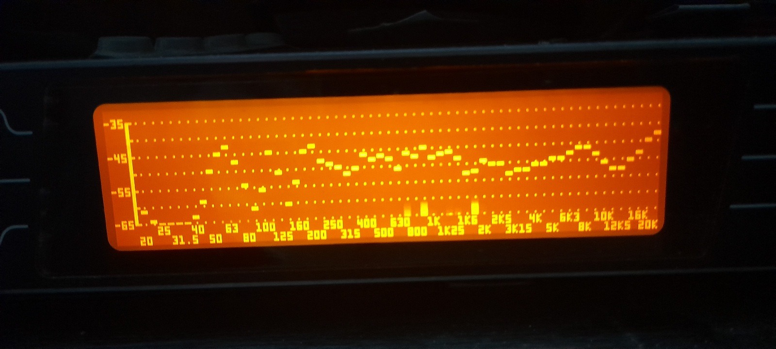

OK, I thought I would use some bracing on the sides of the panel to increase the performance below 300hz ?
Pic 1
Is a strip of wood used for bracing.
Pic2
Is plot without any bracing.
Pic3
Is plot with bracing.
Pic4
Is very light bracing ,foam strip.
Pic5
Is the foam plot.
As can be seen in pic 2 and 3 the bracing has moved the about 50hz resonance up to about 100hz, which has also moved the resonance about 100hz up in frequency too.
The very light foam has moved the lower resonance up to 70hz or so and the other resonance up to about 140hz.
Can we see a pattern here.
The resonances are being crunched up above the 100hz point filling the dips in the sub 300hz area.
But everything below 100hz has gone !
I also tried much thicker foam with the same outcome.
I prefer the sound of the panel with the resonance left at 50hz for full range.
But I can't say I like the idea of moving the resonance up into the lower midrange, just to fill in the dips ?
It does change the sound of the whole panel.
I might get away with the thin foam strips though ?
But for what purpose?
Steve.
