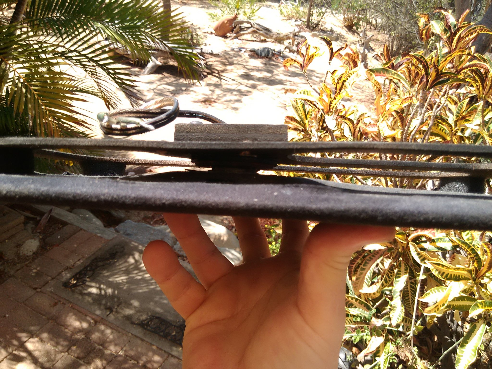

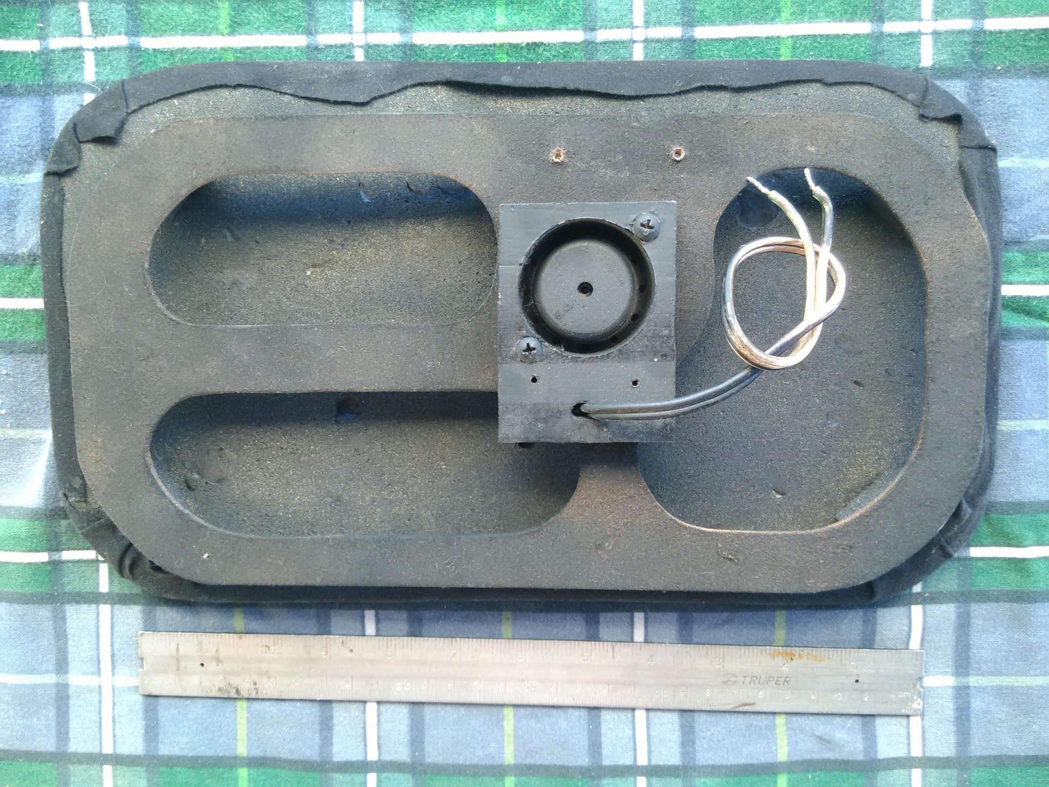

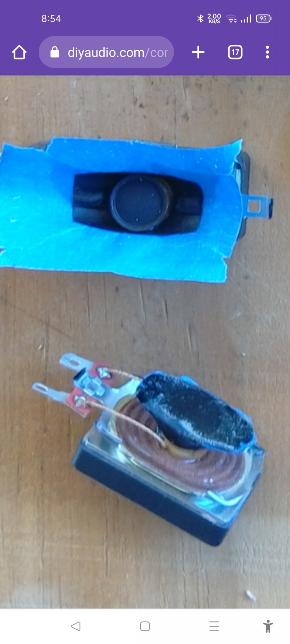

The left over cone acted as a cup that I filled with epoxy achieving the same thing as in your picture. I just don't see a homemade coming close to a true exciter in any fashion, you will always be leaving a lot off the table.

Was the high diy one 14w as shown in the photo?
No disrespect intended, but those two speakers don't look "exciting" (pardon the pun).

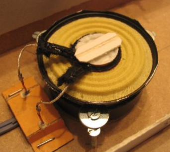

The idea to make exciter with a speaker is interesting. It could be a way to get higher force factor (BL) and maybe lower inductance in a 8 ohm impedance... which I think a way to get better HF.
Yes
From your pictures Toddincabo (#3076), I see the membrane was may be not completely removed so that the voice coil pushes the membrane through a flexible remaining part of cone.
See below how I dismount a speaker for an application close to that (at this time i didn't know the DML). I think I glued a disk (which material?) on top of the voice coil). With care, a small cylinder might be added.
I think there are 2 difficulties at least:
  • the voice coil end is close to the spider. Some very rigid interface part might be needed
Yes..I think a plastic cylindrical former with a flange for mounting is required
3d printing ?
  • an exciter is designed to accept an angle between the voice coil axis and the magnetic circuit, a speaker not. So it needs more precise position.
Hmm... you're correct, my exciters allow some wiggle...how do they do that? Big voice coil gap? That would adversely affect flux..
And of course a spine.
Yep
So not easy... but why not.
Yep again
I'd try with a reasonable quality speaker to get a decent foundation.
Worth at least one try

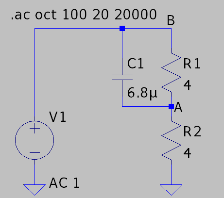

Hello Steve,
Have a look on post #5270 for tests and comment.

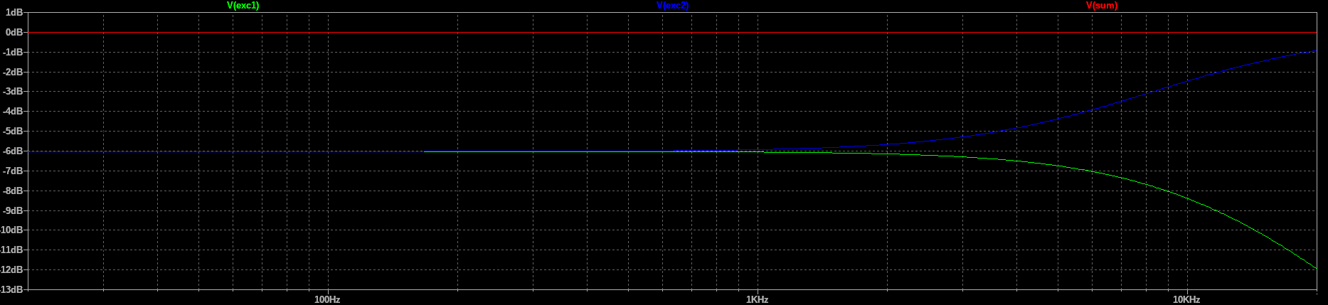

To be more clear, I made a quick simulation on LTspice.
Here is the schematics that models the circuit of the test above:
R1 is one exciter with a capacitor C1 across its connections
R2 is the second exciter
Below V(Exc1) is the voltage (so the level) across R1, V(Exc2) the voltage across R2. I show also the sum which is constant.
Sorry for the dark background. I didn't find how to change it
The impedance for the amplifier is not constant : 8 Ohms to fall to 4 Ohms (not shown here)
The R2 (Exc2) will work full tension in HF.
As the power is mainly in the low to mid frequency, the power handling might be improve also.

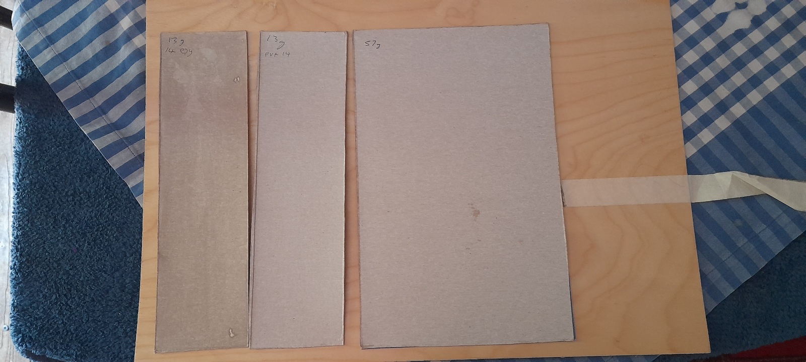

I made another panel exactly the same as the egg whites panel but using PVA throughout.
I also made some test strips of single .5mm to test increased weight and stiffness.
I coated one strip in egg whites and the other PVA.
The strips weighed 13g , when wet they increased to 14g each .
When dry again they each reverted back to 13g.
The two .5mm larger test panels weighed 57g before gluing and coating.
I coated both sides in neat PVA before sticking together .
When dry I coated the outside of the panel in 50x50 PVA and water.
The weight increased to 60g and when dry is now somewhere between 58g and 59g , my scales aren't that accurate.
So some useful stiffening with very little weight 😉
As I am typing this I was going to say the egg whites seem to stiffen the card more, but the egg whites card seems bulkier ?
So I just tested the thickness, and the .5mm egg whites strip does feel tighter in the gauge ?
So the egg whites does seem to be expanding the fibres and drying in that state.
Similar to expanding the grain on wooden instruments before sanding ?
But the PVA mix either shinks back or stays the same when dry ?

On your post 5270, what were your conclusions from the roll off applied ?
There does not seem a lot of difference , except for a slight increase between 3k and 6k ?

I wouldn't speak of roll off with this circuit (but i might be wrong in the meaning of roll off). The goal of the circuit is to keep the sum of the exciters output constant. In low frequency, both receive half of the signal, in high frequency, one is "short circuited" by the capacitor, the second receive the full signal so twice the signal at low frequency. 2 sources in low frequency, only one in high frequency. A bit schematic but it is the idea.
The measurements on both graph are:
  • red : only one exciter on the panel
  • purple/blue : is 2 exciters and the capacitor
  • other curves are 2 exciters without capacitors in different positions on the panel
The difference between the 2 graphs is in the second one a time dependent window is used so only the level at beginning of the pulse.
The conclusion is the 2 exciters plus capacitor configuration is the one that is the closest of the one exciter.
So if I come in the future to a 2 exciters configuration, I will give a try to the capacitor configuration
About the 100Hz, it was out the scope of the test. It is just a piece of XPS 9mm not really large.
Christian
I imagine a big slug of epoxy in the cone remnant would muck up the response somewhat...
Hmm. Not easy to judge like that... Each part has a stiffness and a mass; relevant or not in the range of frequencies considered. The cone acts like a spring between the coil and the panel. I did some test with additional parts between the exciter and a membram. Even if my perception of the part was "stiff", I lost something in the high frequencies; For the mass, I made test also; It is always incredible for me what we can add without changing a lot the FR. It has some influence on the time where the peak of amplitude is for mid frequencies (sort of resonance).
Hmm..my turn to Hmm...😀
I understood the 'funnel' was filled with epoxy? If so, then there's no spring effect and the added mass to the voice coil is significant and surely must affect acceleration / deceleration and hence at least hf response. (Epoxy SG is 1.1)
Similar to adding a number of washers to the panel at the centre of the coil.
The other effect is to significantly widen the contact area on the panel which further affects hf response.
Eucy
