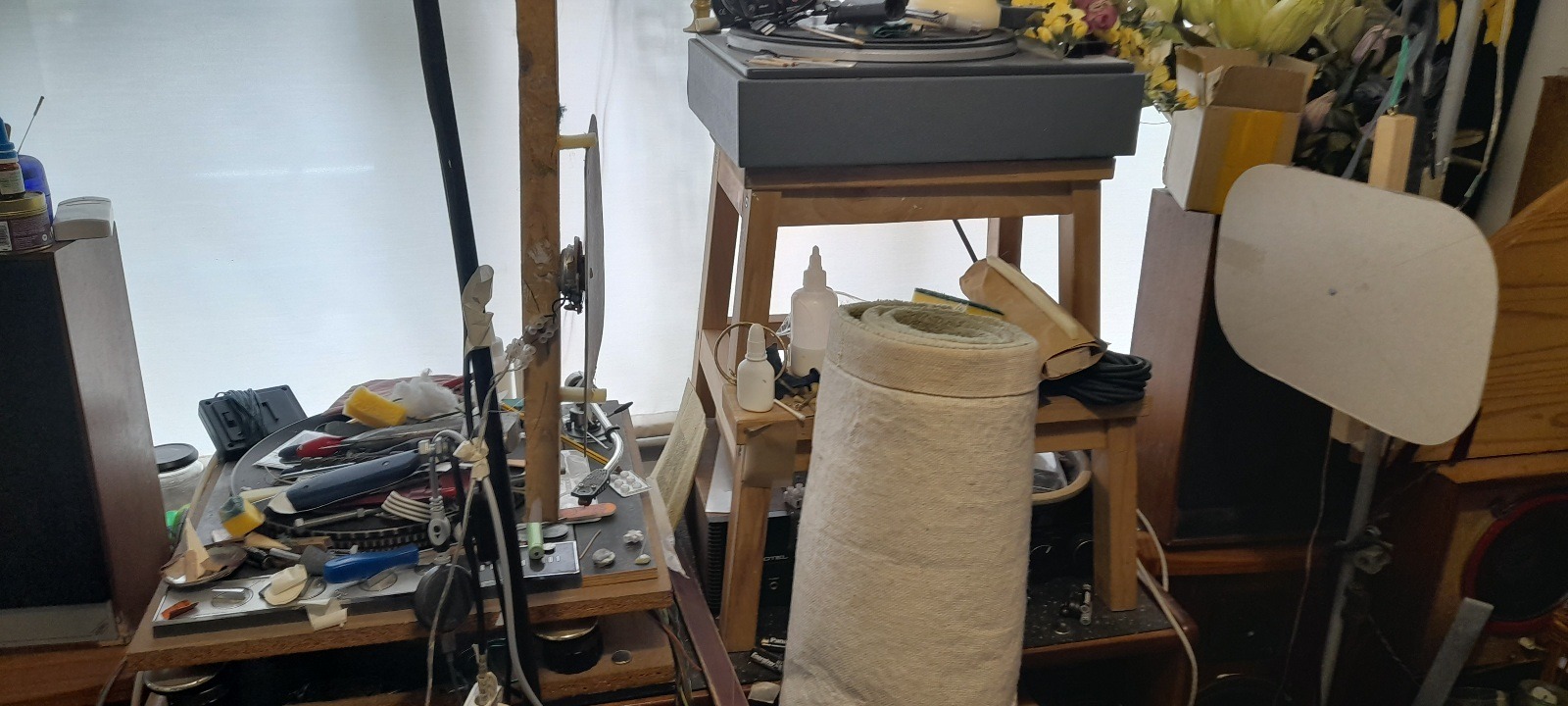

i recorded this the other day but did not get around to posting it.
it is still my card panels but i have propped the phone up on a rolled up rug.
i have been listening to this in the car and decided it was so good i had to record it.
two clips from the armed man : A mass for peace.
steve

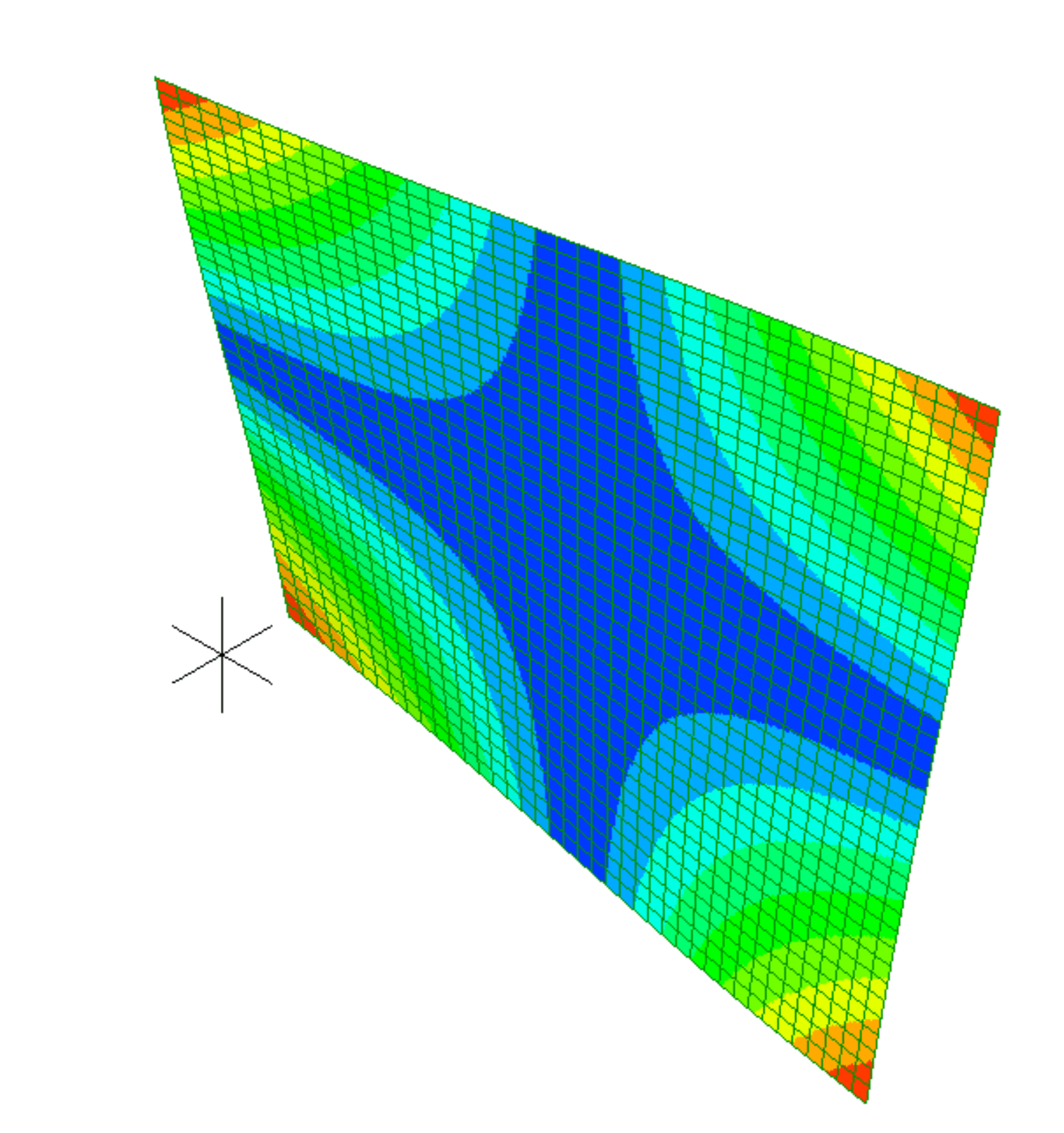

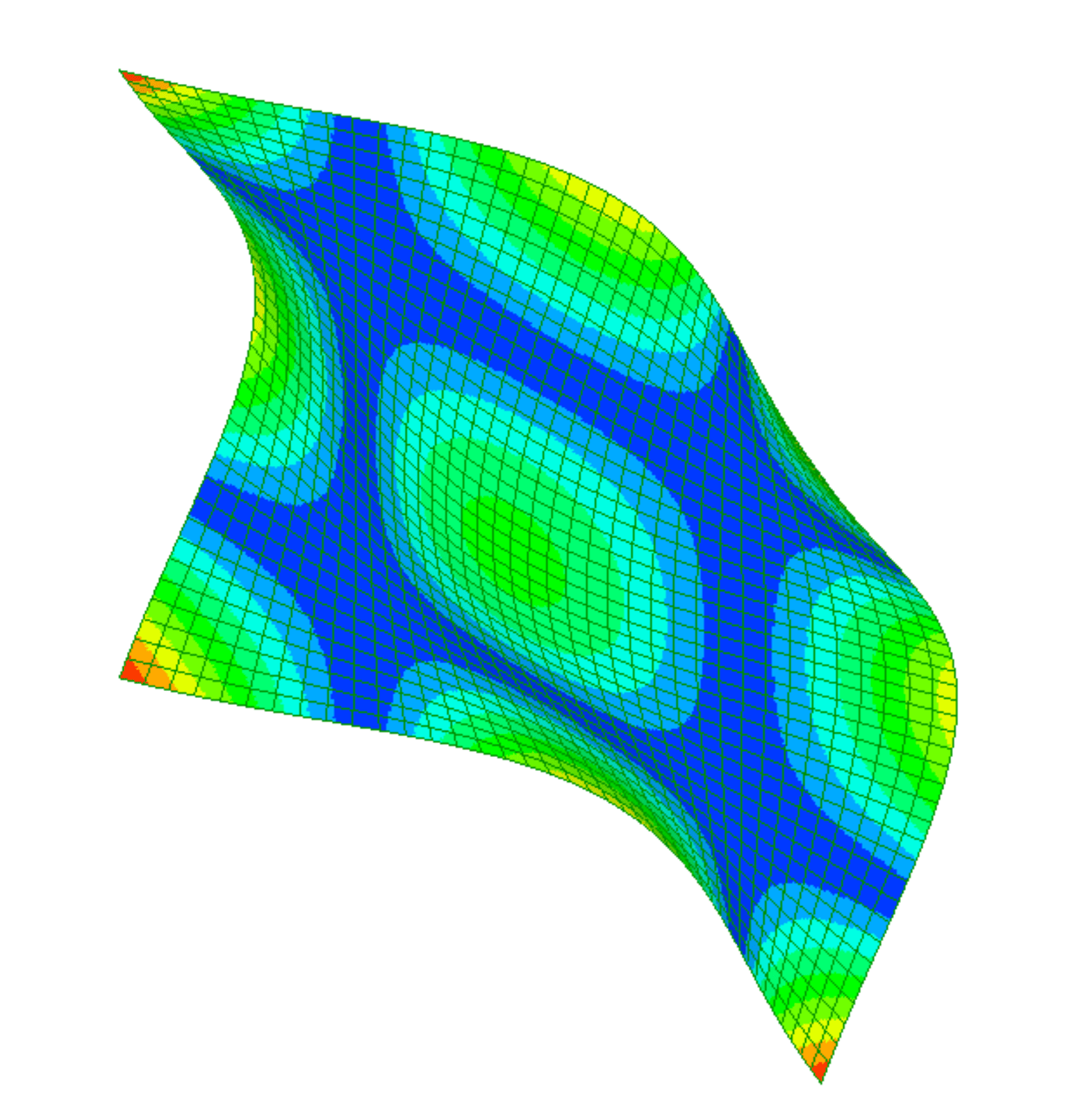

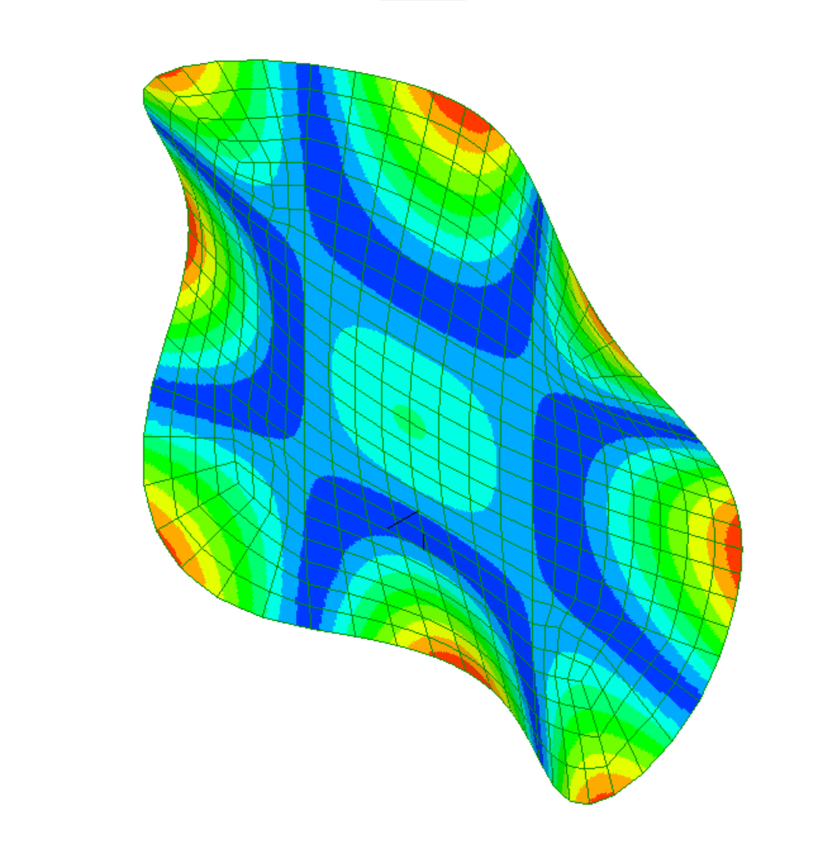

Leob, Hkguy,
I am pretty certain that any free hanging panel will have "resonances" at the corners, no matter what the dimensions.
I put "resonances" in quotes because technically resonances really don't occur at a particular place on a panel, but rather involve the whole panel. What I think you really mean is that for a free hanging panel, the corners will be antinodes (locations of maximum displacement) for certain resonant frequencies. In other words, the corners will tend to flap around wildly at certain frequencies. And that of course is true. In fact, for a free hanging panel, the corners will be antinodes for virtually every resonant frequency, not just a few.
Attached are typical mode shapes for a free hanging panel with square corners (first), for rounded corners (second).
In both, the corners will tend to flap, but with the rounded corners displacement amplitude (flapping) should be mitigated.
In most cases, I suspect the worst of the flapping comes from the fundamental, for which the mode shape typically looks like the third image. And often, this mode occurs at some low/inaudible frequency (i.e. below 20 Hz), so the flapping is all totally useless. So it makes sense for such panels to roll them off (i.e. use a high pass filter) to keep the lowest frequencies from reaching them, as Spedge often suggests.
Eric
Reactions: 2 users

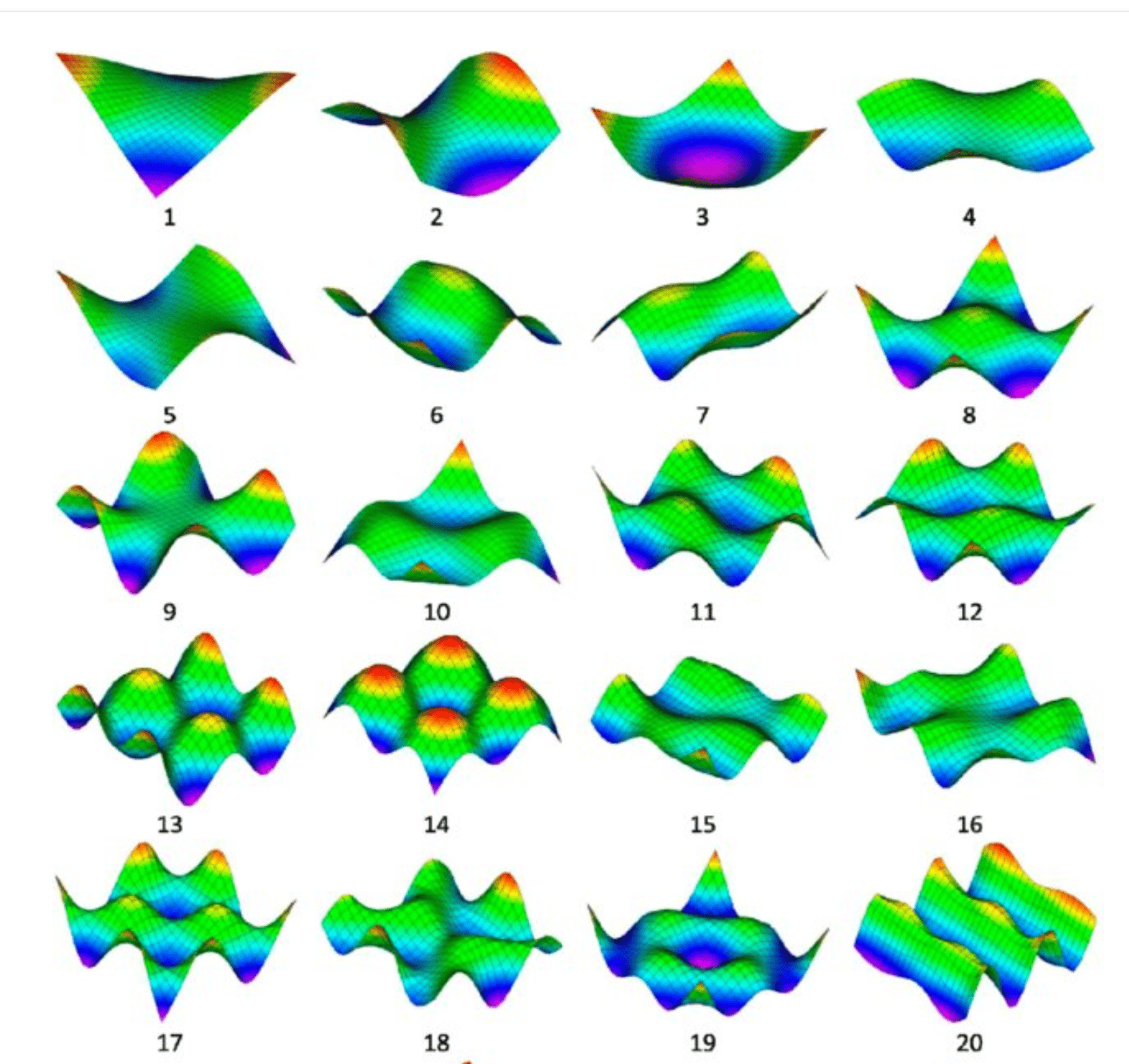

In case my attachments were hard to interpret, here's an image from another source showing the first 20 modes of a free hanging square plate, which are similar to those of most any rectangular plate.
Note how the corners are almost always the locations of the most extreme displacement.
Eric
